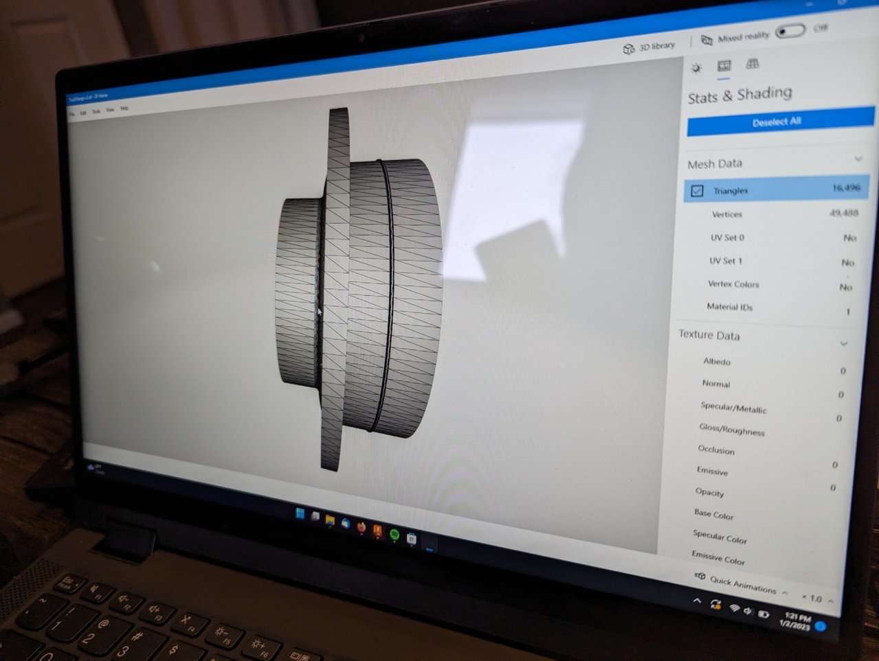

    Question for you gurus, what % infill should I use for an air intake adapter, that a hose clamp would tighten down on? And cheapest recommended material? From research the part would need to withstand a max of 200*F. Quote from craftcloud is looking at $68 with 20% infill for polycarbonate material

    Depends on a few things, like wall thickness, layer height, print orientation, and overall part size. PC should be fine at those temps. I'm assuming the clamped hose could end up putting a bending force on the piece too, as it bounces around. Without knowing those variables, I would still steer you closer to 35-50% infill just to be sure it is plenty strong.
    That being said, $68 is a lot of money for a piece of plastic. I'm tuning my printer now to be able to handle PC.

    Thanks! Ya and that's basically the cheapest quote I can easily get online for it. I tried asking a local place first and they quoted... $200 for PLA print after I asked what the cheapest the could do was. First quote they said $350 for abs print. hard pass

    Such is the nature of getting one-off parts manufactured from these kind of shops. In the grand scheme, $68 isn't much, but owning a 3d printer has totally skewed my perception of getting custom/prototype components made haha

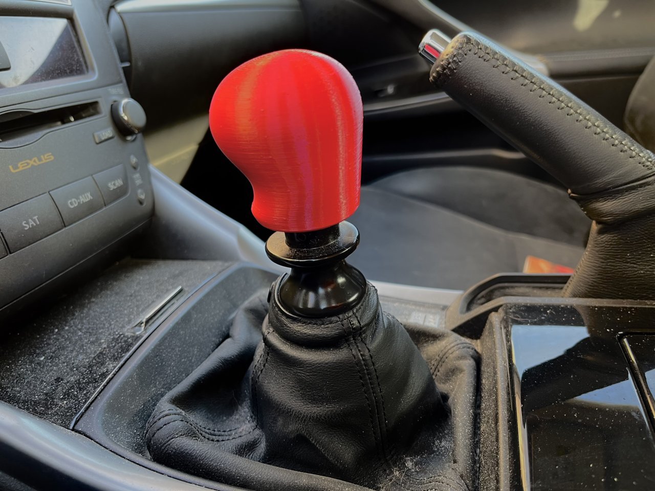

    Testing a shift knob to hopefully replace the stock one. Nobody really makes a knob that really works with the interior better than stock, but I also would like something a bit better.
    Not entirely sure, but it came out pretty nice. Going to tweak the shape in two areas and print it again before experimenting with wrapping the leather.
    Will probably make it out of steel if I like it in the end. This is quite a bit lighter than stock and I prefer the weight for shifter feel.
    (Please ignore the uncleanliness)

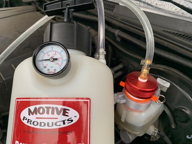

    I finally got back to making adapters to more easily fit up a brake power bleeder, like a Motive, to our master cylinders rather than use the PITA universal one with the chains. My previous design never worked consistently so it was back to the drawing board.
    I use this as an air source only, not to actually transfer fluid. The whole idea is to make it work with a screw on cap so the MC can easily be refilled as you do the job. The second adapter will also work this way by opening the clamp and removing the adapter temporarily. Files here:
    Toyota Tacoma power bleeder master cylinder adapters by raylo32 - Thingiverse

    Another way to do it
    Power Probe makes a Toyota adapter, model BA10
    problem is the end of Motive is a barb, tube, crimp, holding on in my case, European adapter
    while the BA10 comes with an air/pneumatic-style of quick connect fitting, that is what certain bleeders use.
    I need to figure out how to convert the Motive to use that, to make it connectable to the BA10.
    I know it's possible as this is exactly how my old co-worker's bleeder was set up, that I had borrowed before and used successfully. With his various tools being set up the quick connect of style, it allowed exactly that, quick connect ability to swap out between different adapters based on which make of vehicle the tool was being used to bleed

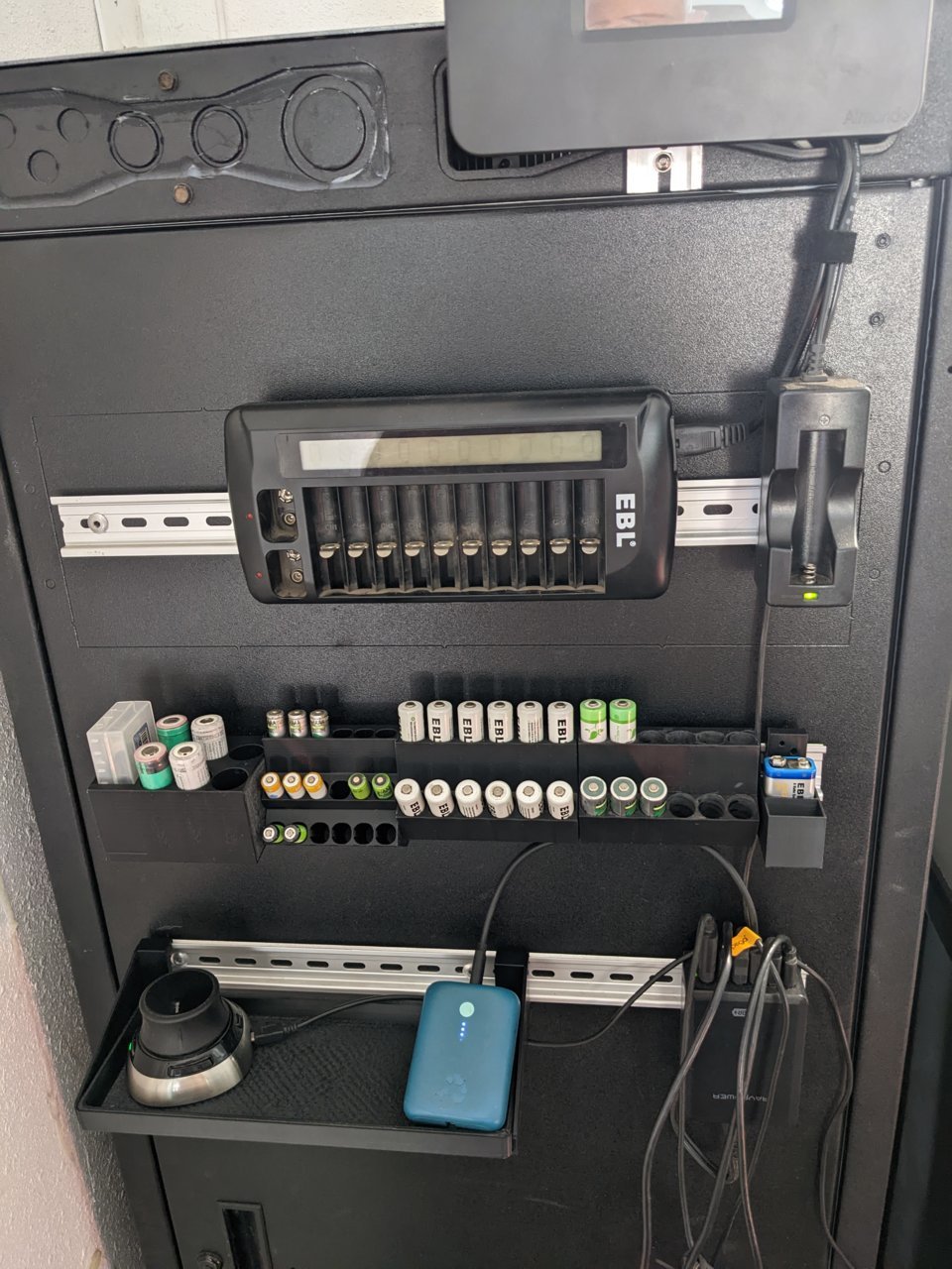

    My charging station.

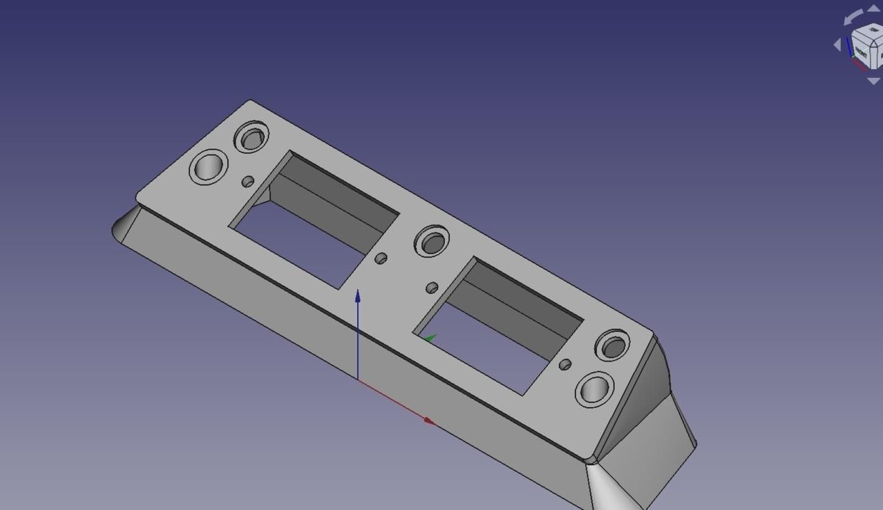

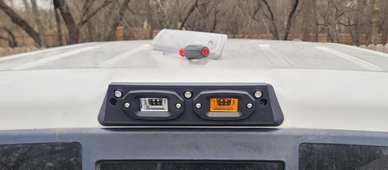

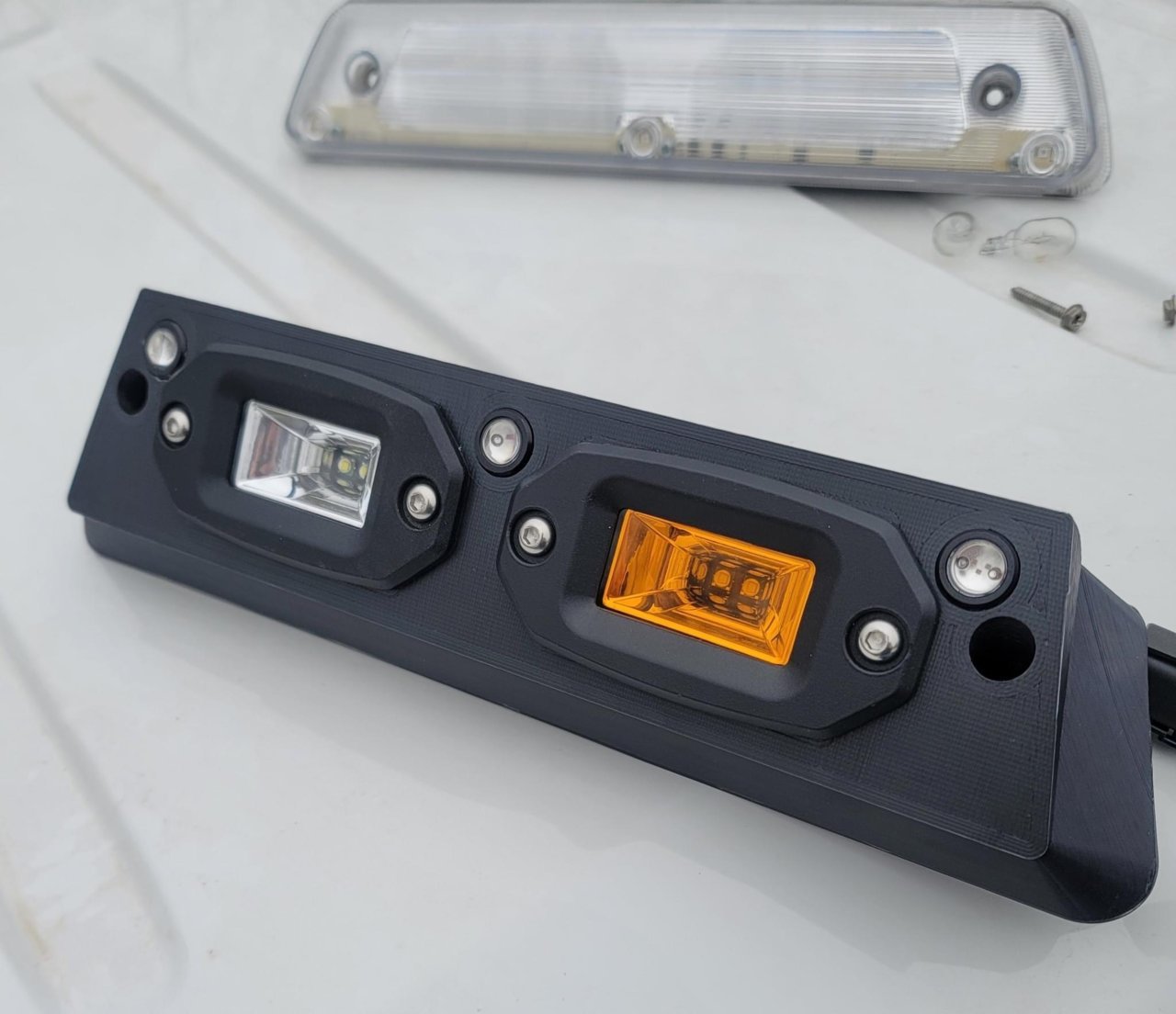

    Planning on designing and building something like this for my 2nd gen, and also designing pods that will mount under my bed rack and angle the light out the back of the bed. Ordered the actual lights today, so I can start measuring and designing. I'm debating if I should just lose the third brake light altogether in favor or a bed light, or add some small, round, red LEDs. I've had three situations in a couple weeks where having the bed lights would have been great.
    Images are courtesy of a gentlemen on an Overlanding group on FB.

    Nice design!
    Here are some ones I've seen for sale.
    https://www.evilmanufacturing.com/lights/2005-toyota-tacoma-third-brake-light-baja-designs
    https://mesocustoms.com/collections...tacoma-3rd-brake-light?variant=21236720435313

    i really wish my brother-in-law didn't live to far away i want to build something like this for my truck topper, just a simple couple of red LED for the high mount stop, and an amber and white strobe option for desert or snow.
