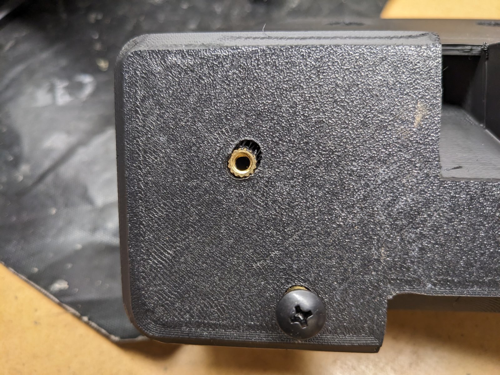

    Here is an accident I had last week. When I noticed it move I moved it back to where it should be. Saved it mainly for destructive testing at a later date. That said I screwed in a screw, grabbed it with a pair of pliers and pulled as hard as I could and it didn't even budge or make any cracking sounds. Couldn't get it to budge pushing on the screw with my fingers towards the screw up either. Going to need some leverage to really test it. This part has 1/4-20 printed threads too, so I wanna test those out for strength as well. That's another day though. The tools are a cold rainy walk away... Also, don't preheat the inserts... Put them on the tip, and then up against the part and they will heat up and start sinking in with some downwards perssure. If you let them sit on the tip for 10-20 seconds first they go in fast and can move sideways fast, ask me how i know! :rofl:Im setup at 4 perimeters on a 0.4 nozzle, so about 1.6mm wall thickness and a 8mm long insert. I'm quite impressed.

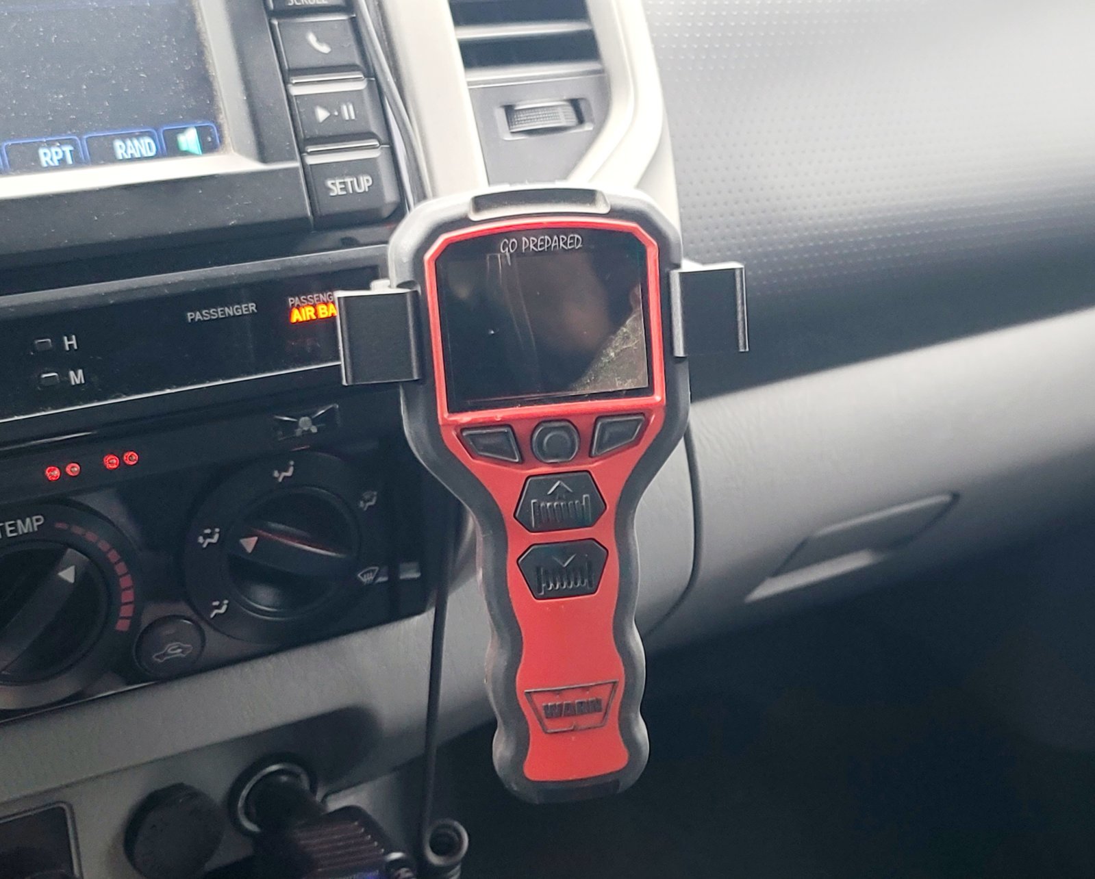

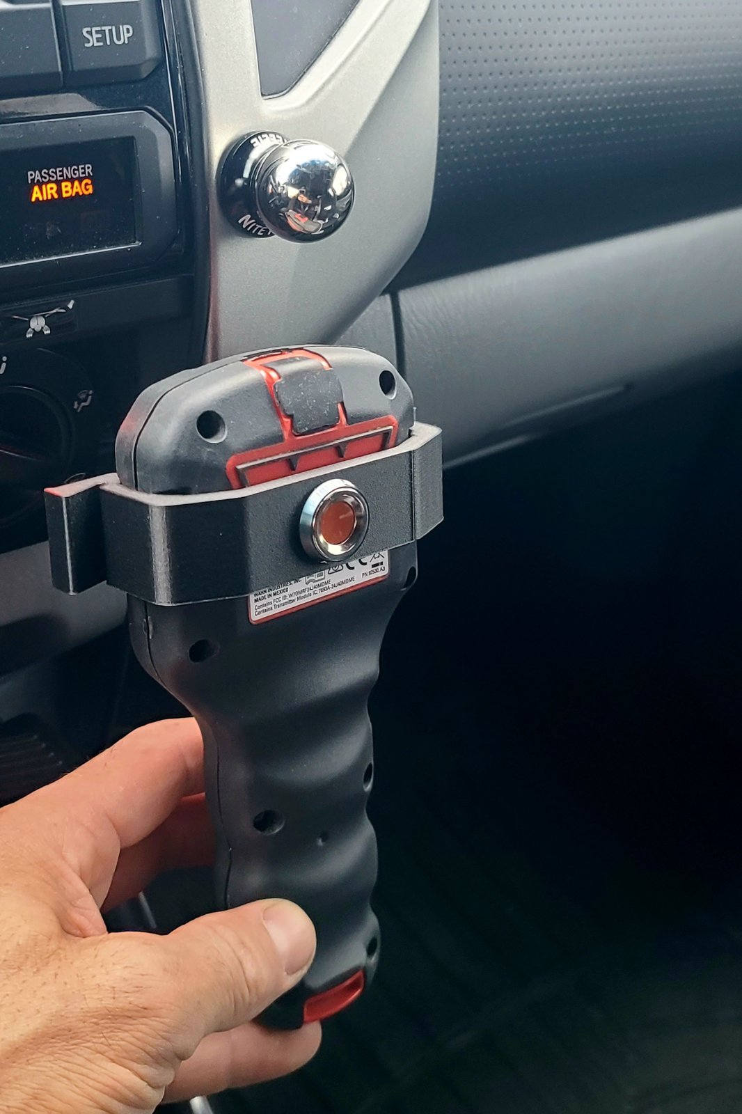

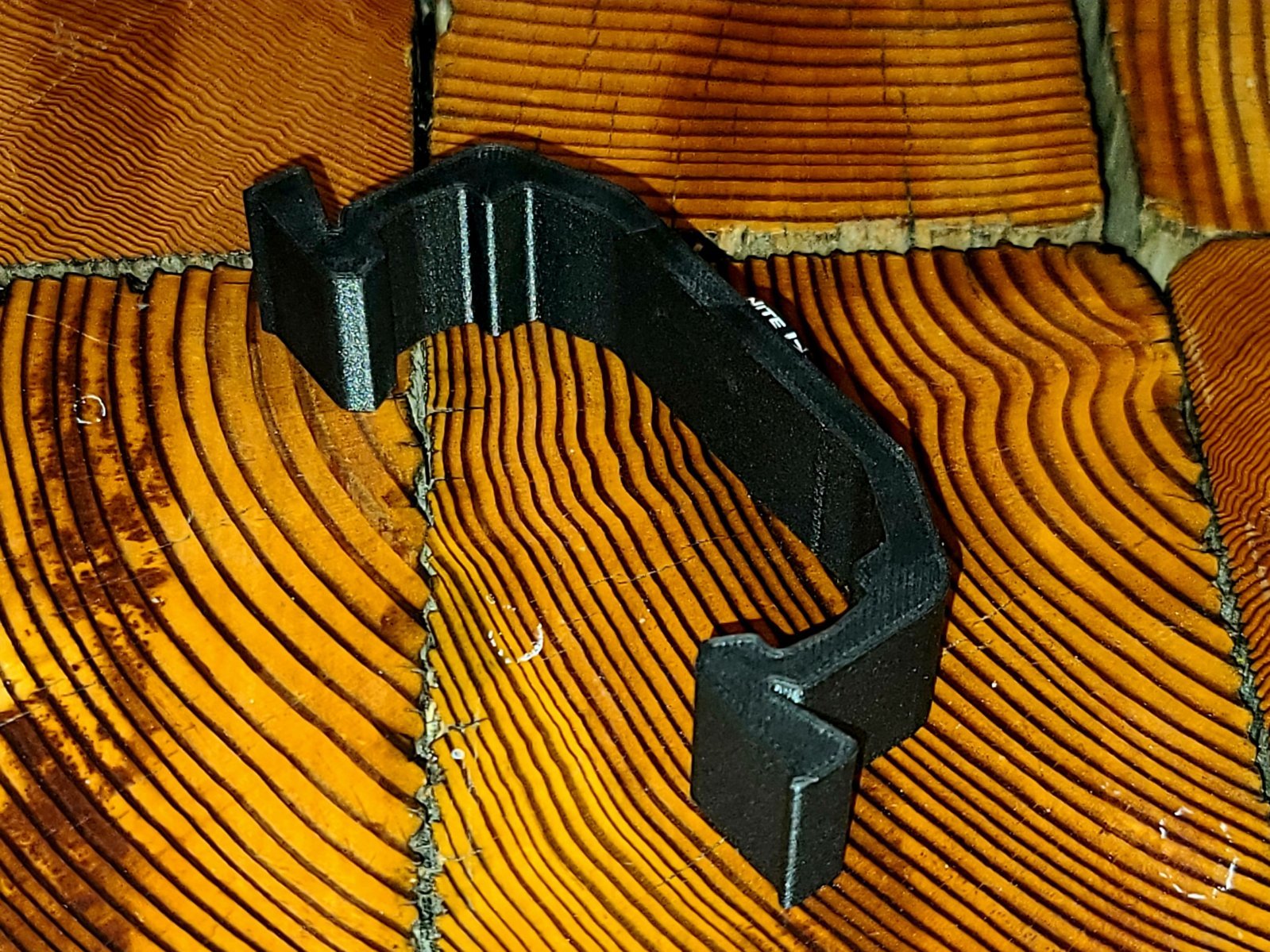

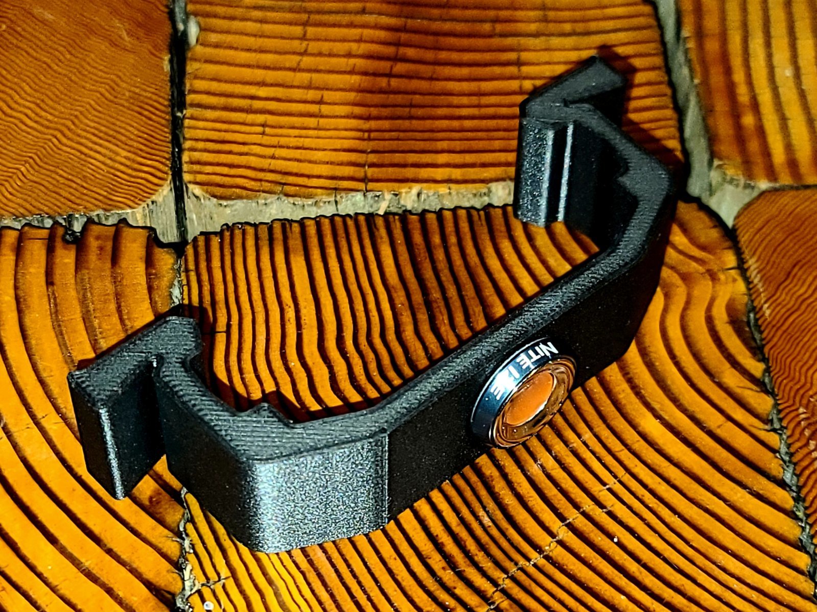

    Warn Zeon Platinum Winch Controller mount.
    Printed in Onyx (Nylon/Carbonfiber).
    I used a Nite-Ize magnetic mount to attach to the dash.

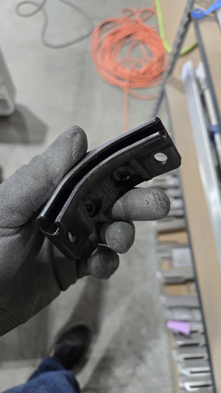

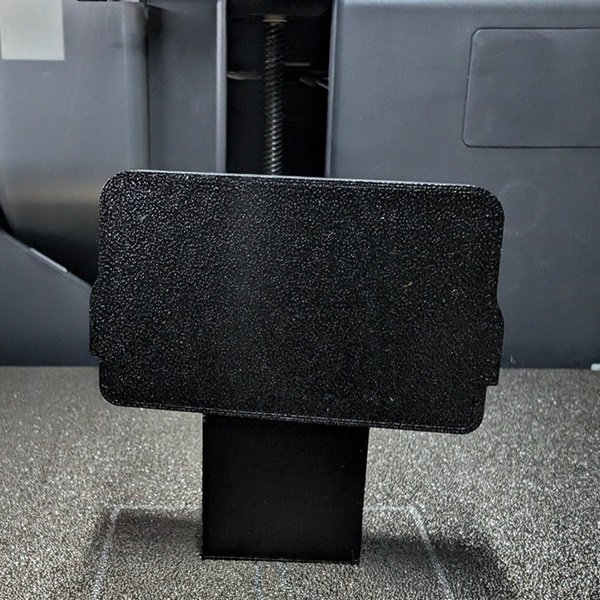

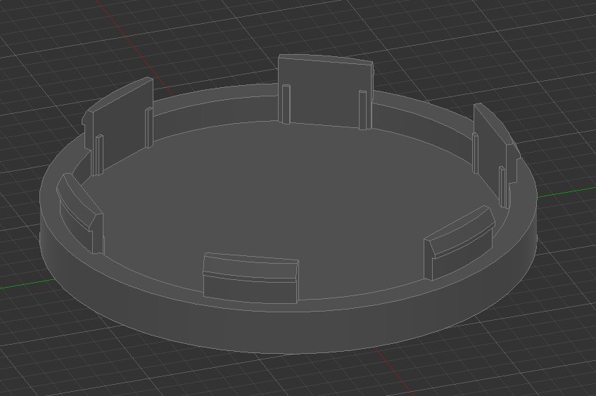

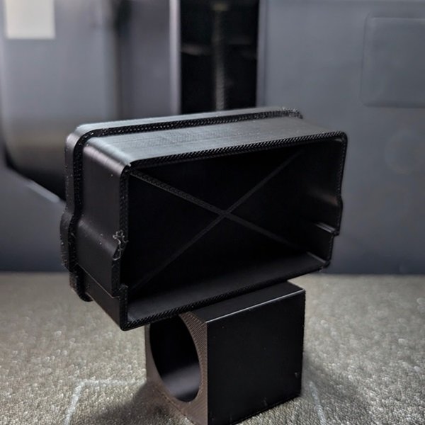

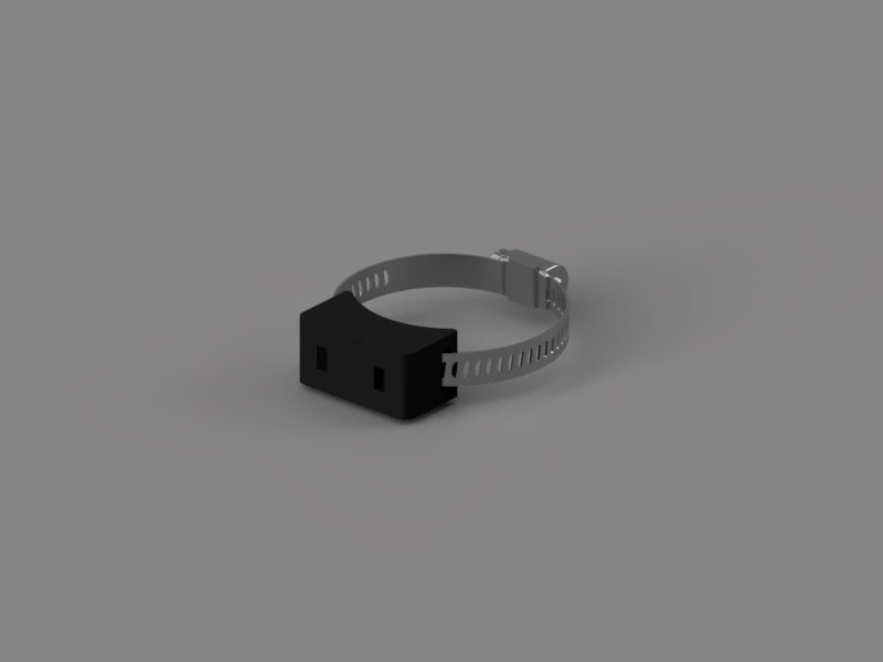

    Couple smaller items I am working on.
    Zip Tie Mount for 1.75OD Tubing
    Replacement Center Caps for my SCS Wheels
    2nd and 3rd Gen Frame Plugs for the front bar that is seen with aftermarket bumpers.
    Have some other things in the queue that I am working on here and there... but finally decided to start posting some of the smaller items.

    What filament are you printing these with?

    I do my initial test prints with Sunlu PLA+, once fitment is checked, design modifications are made, etc, and I am ready for production, I then print my production pieces with ASA.
