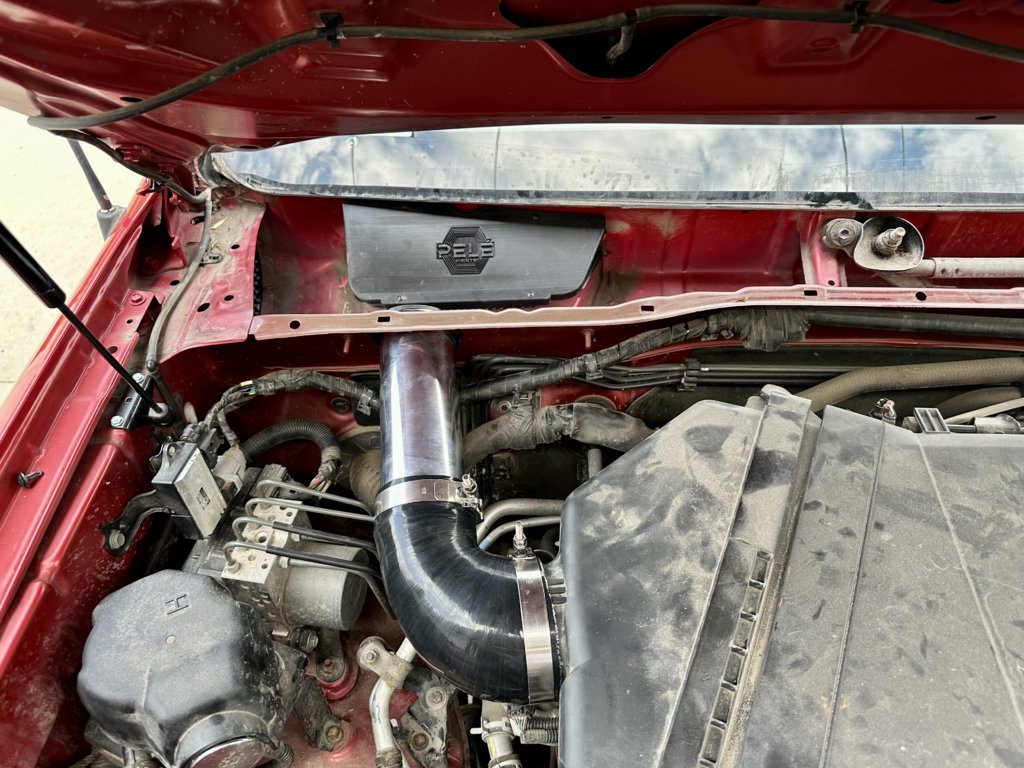

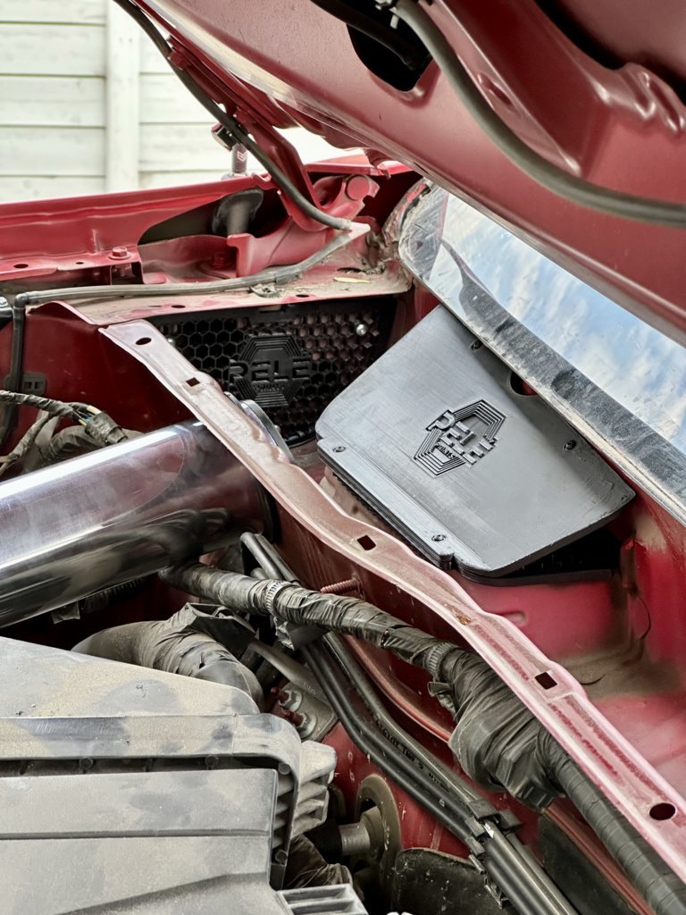

    I 100% agree with this. All of my Cowl Intakes and any other products that are in the cab are out of PETG.
    It is much easier to print than ASA, but I always struggle with the stringing.

    Cowl intake? As in under the hood?

    Yessir!
    It's a snorkel alternative. Click on my signature for more info.

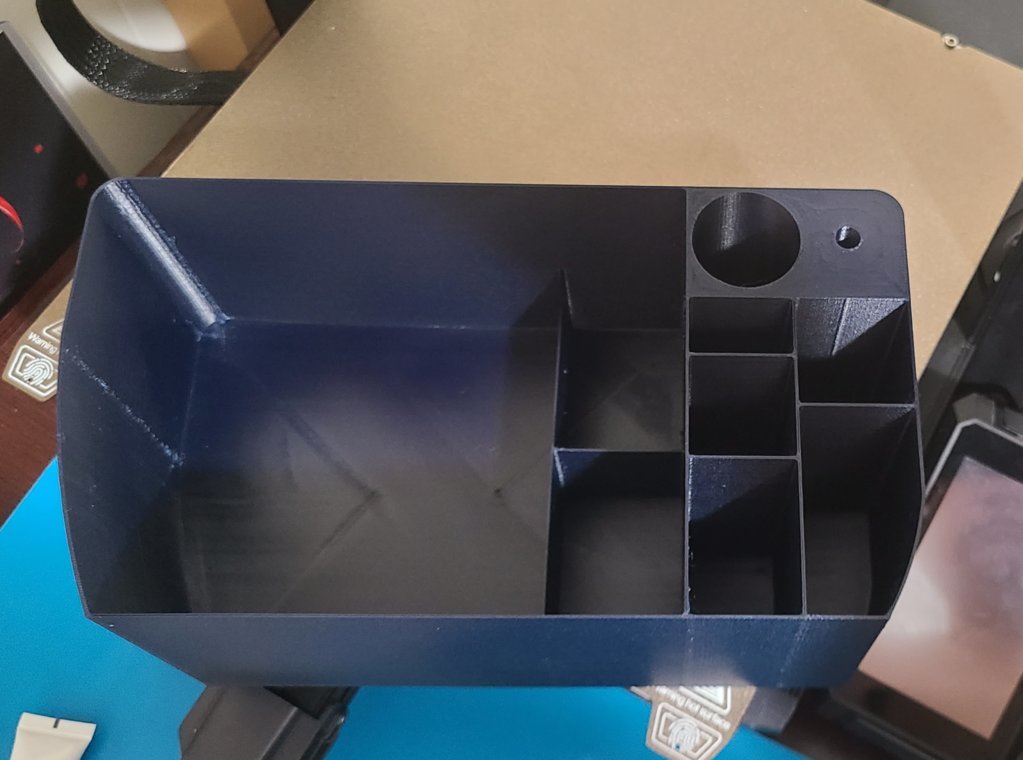

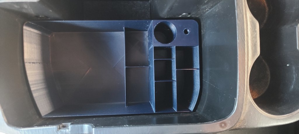

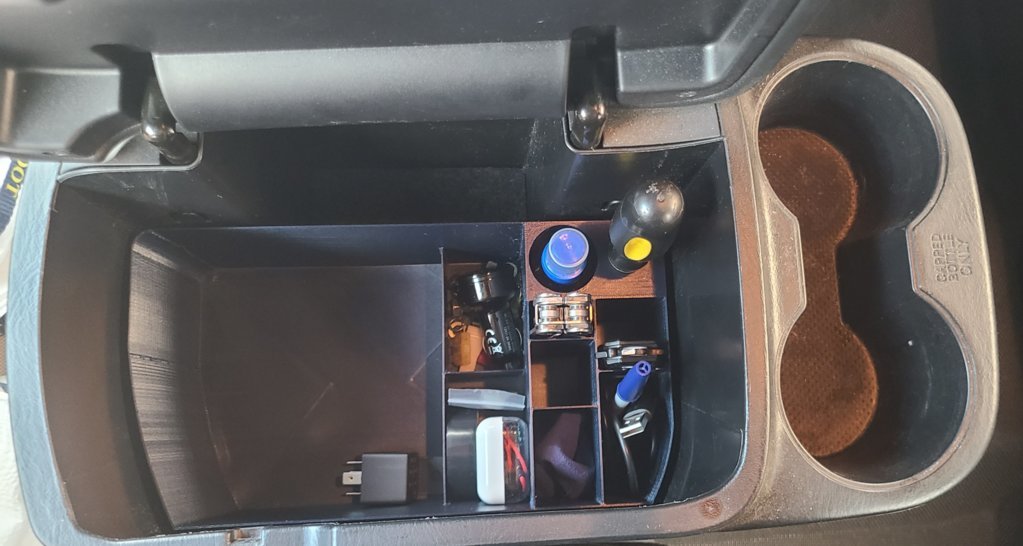

    Finally replaced my crappy generic organizer in the armrest with my 3d printed one. Printed from PETG Carbon Fiber.

    Thats sick. Nicely done. You should see if your slicer has a checkbox to stagger the layer start/stop points and blend that vertical seem on the left hand side running up it. Otherwise, looks like it fits great and looks great.

    Thanks. I was reading about the scarf seam today. I use the creality slicer and it doesn't have that function yet.

    You can also "paint" where the seam is. Maybe a corner would be best.

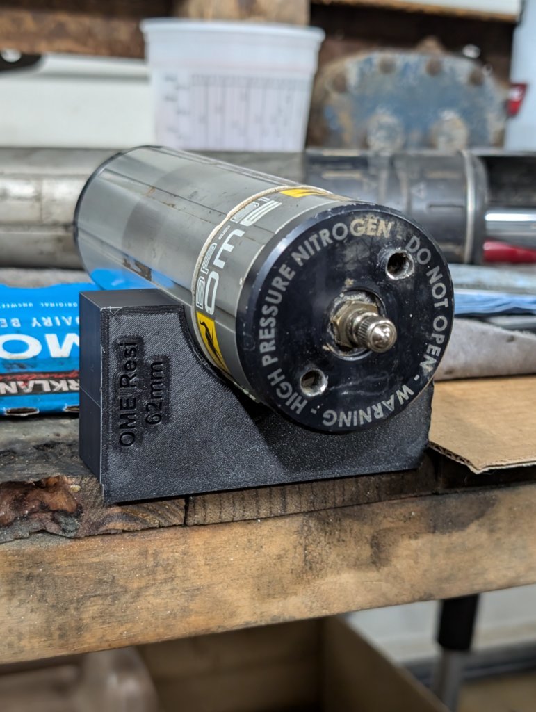

    Trying to get these damn BP51 apart.. The shop that "rebuilt" them had some trouble and tore up the pin holes and I assume they had the right tools.. Saw someone post on here about Shock body clamps, went looking for them, saw soft jaw clamps, went looking, found some on Etsy that were 3d printed. So here I am printing my own.
