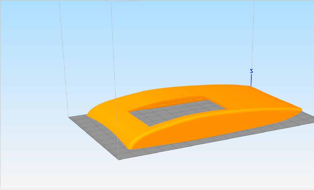

    I just started this print. We'll see in a day if all my lines line up so far, then I can finish the shifter curve, mounting tabs, and start adding features.

    It ended up detaching from the supports about 15 hours in. I think I'm going to have to add some solid supports/anchors in various places. It's a little tricky printing something so large that only touches the bed in 2 spots. Finish is looking SMOOTH though.

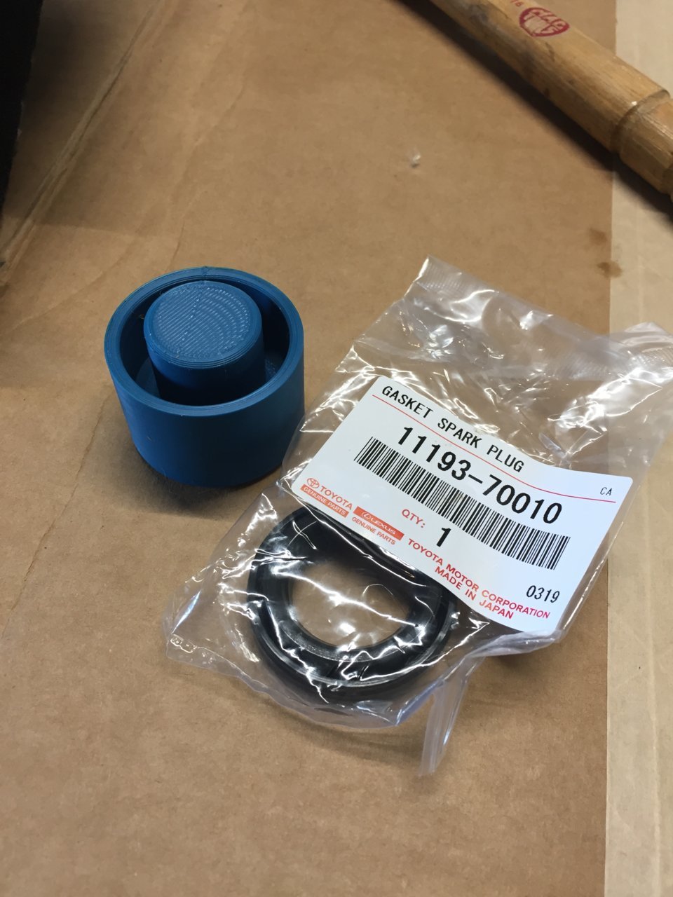

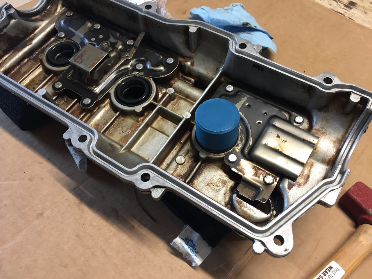

    Simple but effective seal driver for spark plug tube seals. Yes I could have used a 32mm socket but I don't own one and this only took about 15 min. to design and slice. Also, the inner "retainer" keeps the driver centered while hammering. I'm currently printing a driver for the rear axle seal, hopefully it works out well. Link to the spark plug version (https://www.thingiverse.com/thing:4498548)

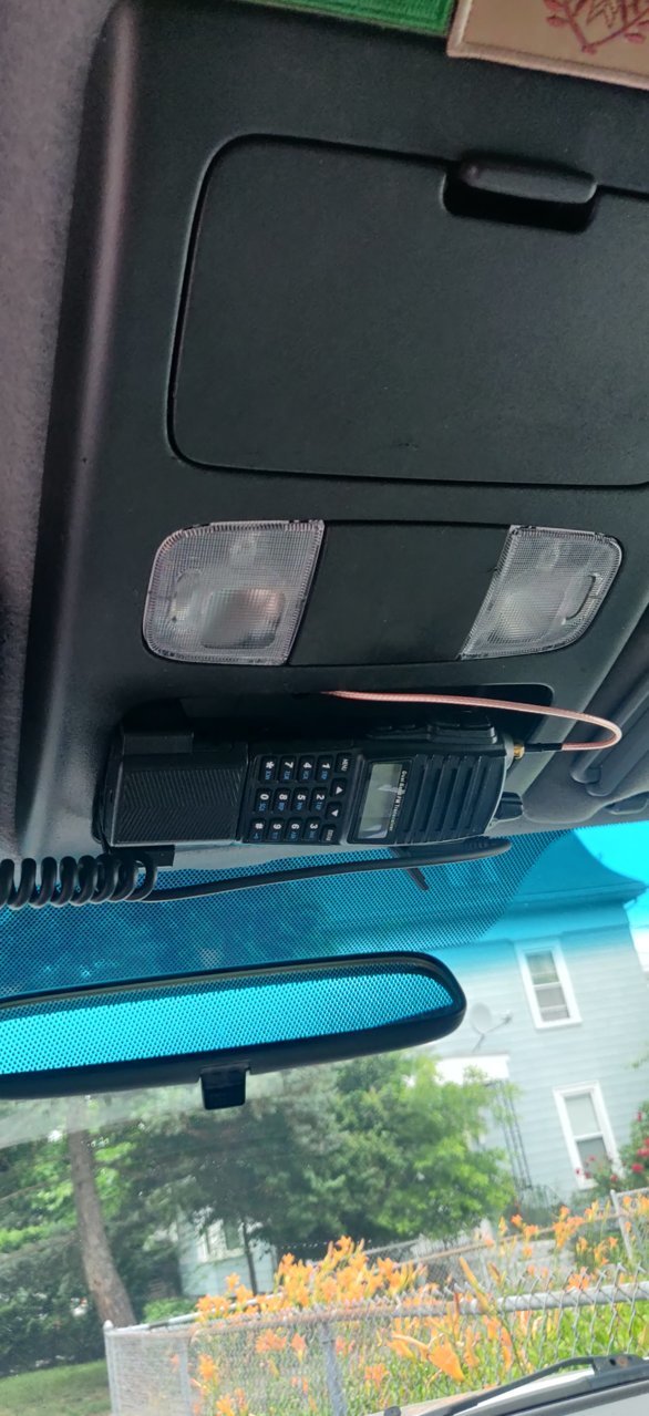

    I made a mount for my Baofeng UV-82. Took a few revisions but I'm happy with where it is.

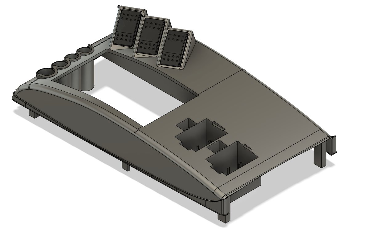

    The bottom profile ended up being a pretty close match. Added some ribbing to help the large contoured overhangs stay down better, and started adding features. Still have to add a flashlight pocket, cup holder, and 4th gear lockout once I get the shifter contour modeled.

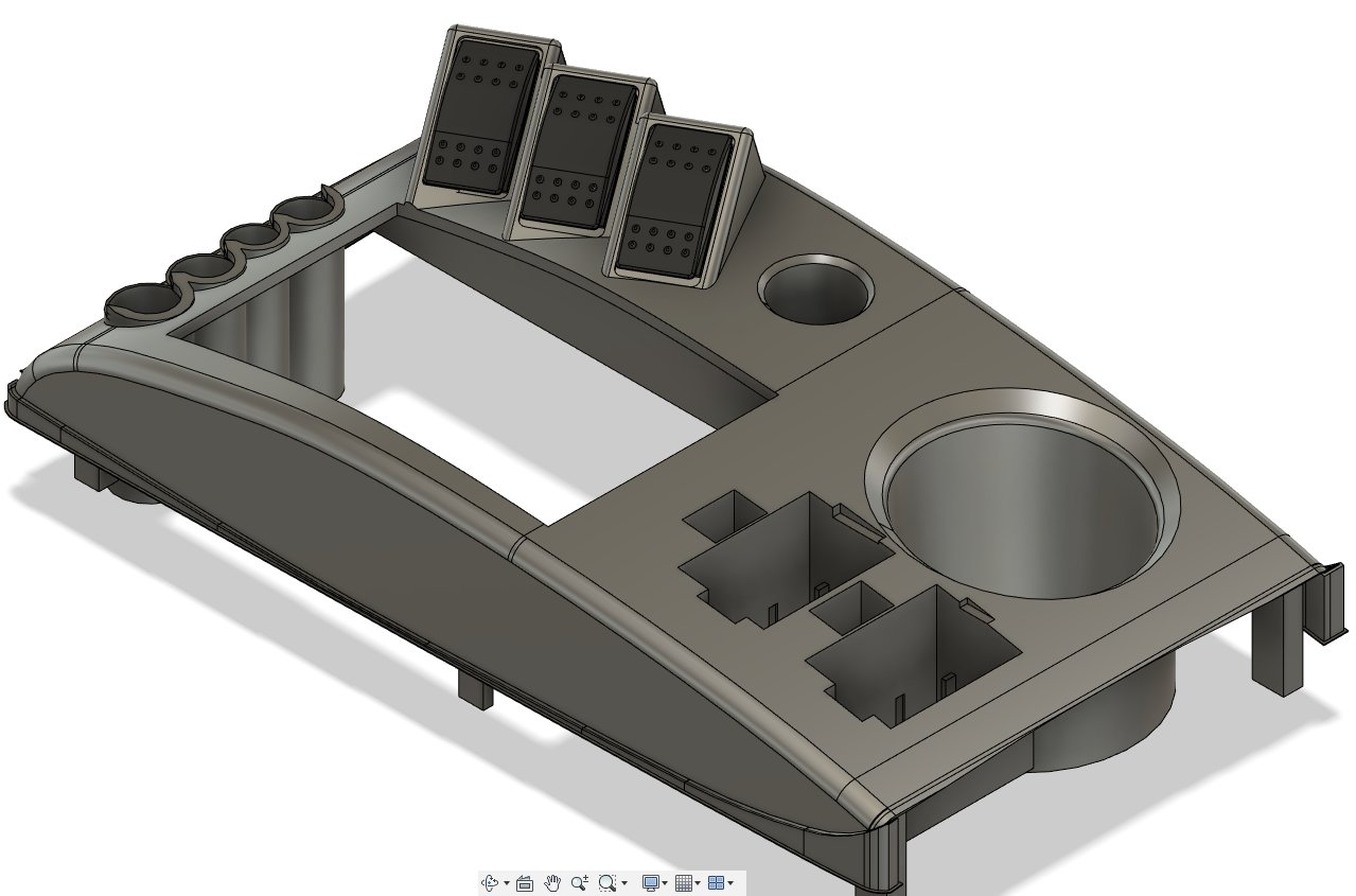

    Ok, got most everything I wanted added and started the print. Coin sorter, 2 Baofeng charging docks, larger cup holder, flashlight holder, and 3 Carling switches. Simplify3d says 36 hours, so more likely 48 until I find out if it all fits.
