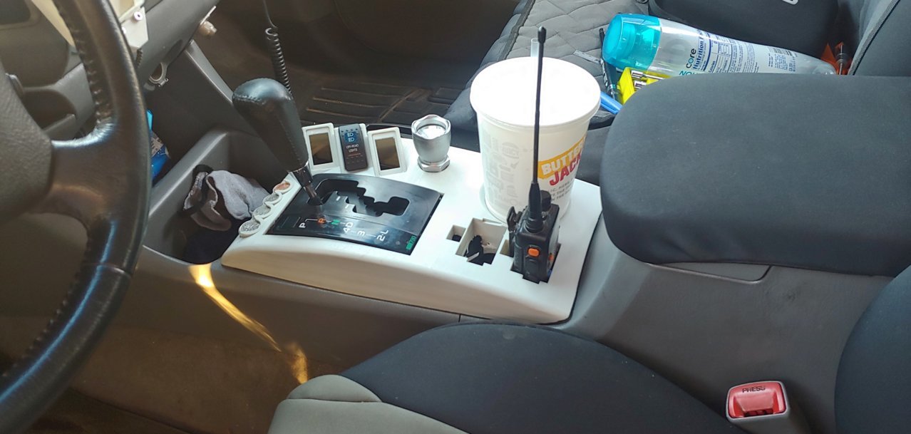

    I'm a little too sober, so I'm taking a break before performing some surgery. A little sneak preview though...

    I dig this a lot. How did you get the original measurements, 3d scanner?

    This thing is awesome!!!! I bet you could sell quite a few of those if you wanted to.

    No, I reverse engineered it. I will probably get a 3d scanner eventually, but my printer has not been run through any big prints yet, so I can't justify it yet. I think scanners only use at the moment is to use as a base to essentially trace and model over. All that I have seen export as stl's, and those are almost impossible to convert to a good editable model.

    That's the eventual and hopeful plan. Just got to dial everything in first.

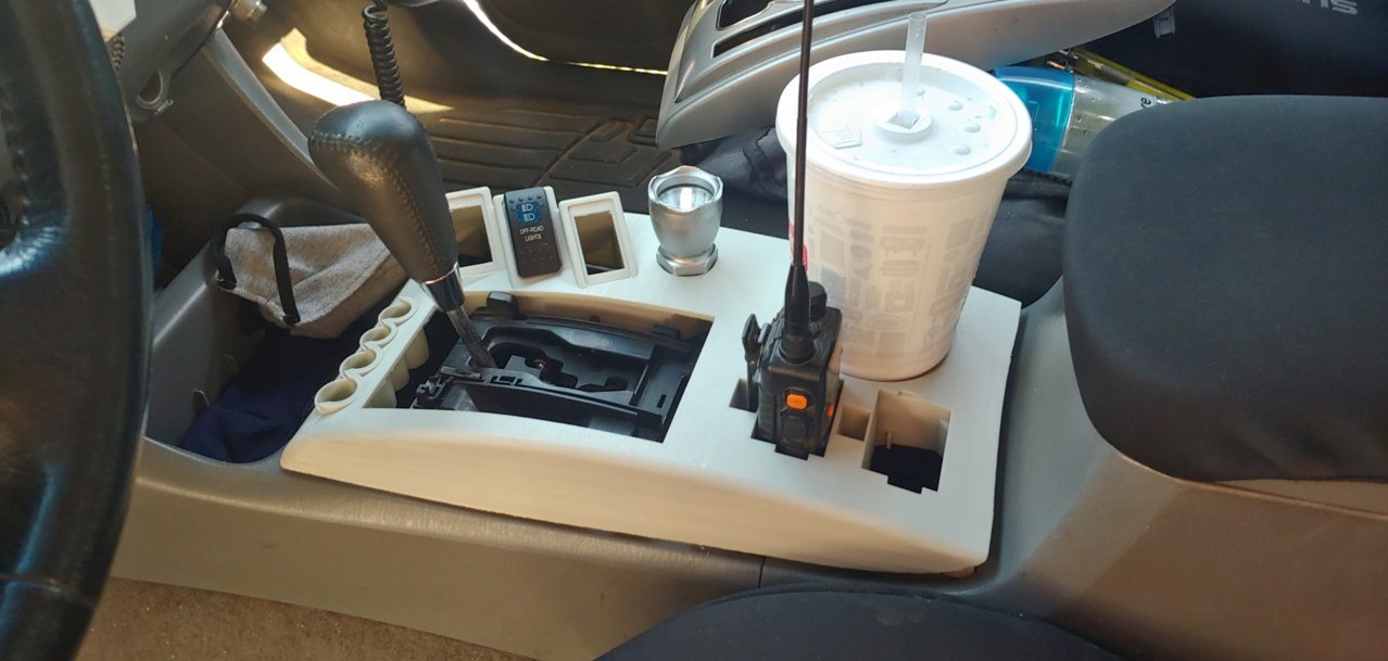

    So I did some cutting. Cut a little off the shifter guide to fit the coin holder. I'm going to switch the cup holder and radio charging bays to work with some of the clearances a little better and to avoid having to go too crazy cutting parts off the truck.

    I would buy one

    That coin holder is awesome -- Toyota should have put one there! These seemed like a very common feature on cars in the 90s, but you never see coin holders now.
    It always irks me when I see wasted space in car interiors. These days, everybody wants soft-touch this and leather that... Fuck that. I want gigantic cup holders everywhere. Not enough space for cup holder there? Well dammit, give me a cubby, a coin organizer, or at least some shit that lights up!
    They should really just let me design all the cars.
    ETA: Kudos for including pennies. Them's the best throwin' coins!

    I have (or used to have before covid) access to an incredibly nice laser scanner at work. 0.001" accuracy on almost any surface.
    It is incredibly powerful, but also generally a nightmare to use for reverse engineering. Sure, simple parts and features can be processed with its built-in software, e.g. cylinders, spheres, hole patterns... But for complex parts, I always had to write tons of processing scripts to crop down the data and perform fits on a feature-by-feature basis. So sure, I could scan a whole part in a few minutes, and get 10 gigabytes of STL data... But it would take several days of work to process that into an exact CAD design of the part.
    My go-to reverse engineering tool is actually a far-simpler (and less expensive) coordinate measuring machine.
    For the shifter console panel, I would take maybe 10 coordinate measurements along the top and bottom profiles and use them as spline anchors in CAD. Way easier than fitting a huge point cloud from a scanner!

    They wouldn't let me play with the cmm at work... I took a picture of a contour gauge against a scale. Used it as a canvas to create a manual point cloud. I'm more interested in a scanner to get certain curves and to map open areas behind panels. As I get more confidence in my printer with larger parts I'll consider it more and more I'm sure.
