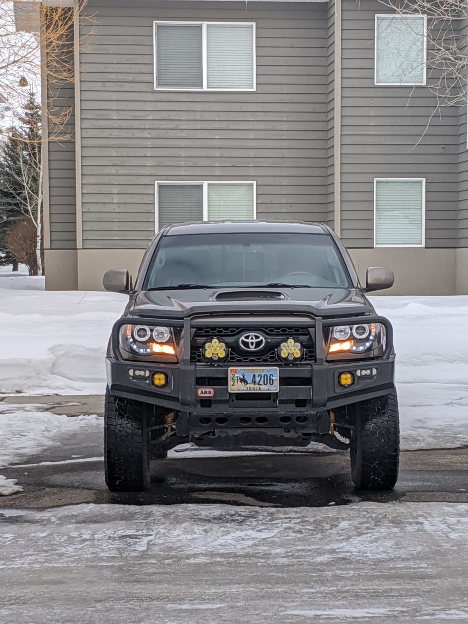

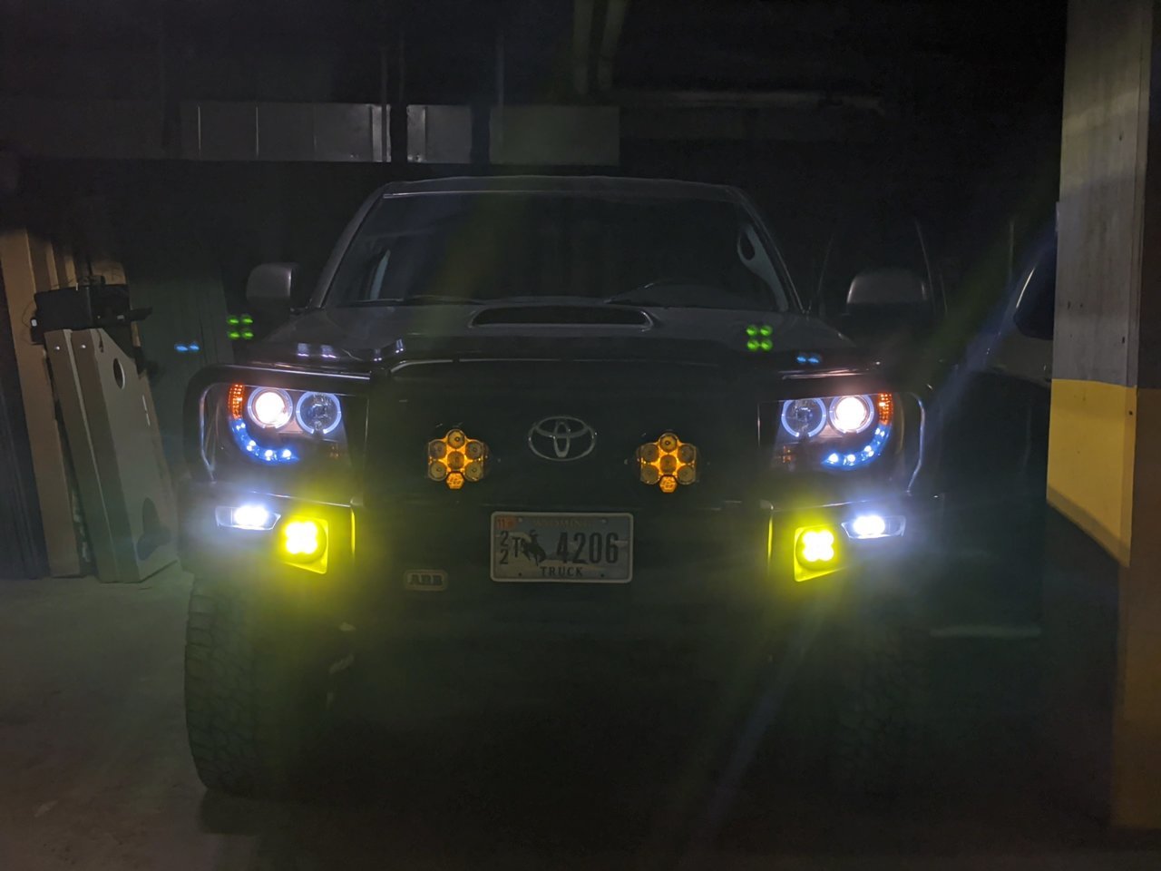

    Got the LP6S on!

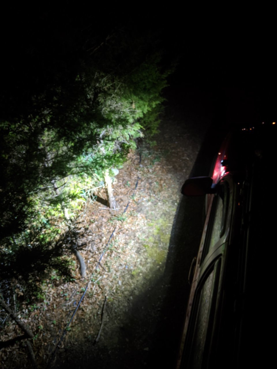

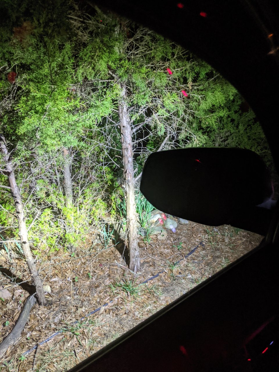

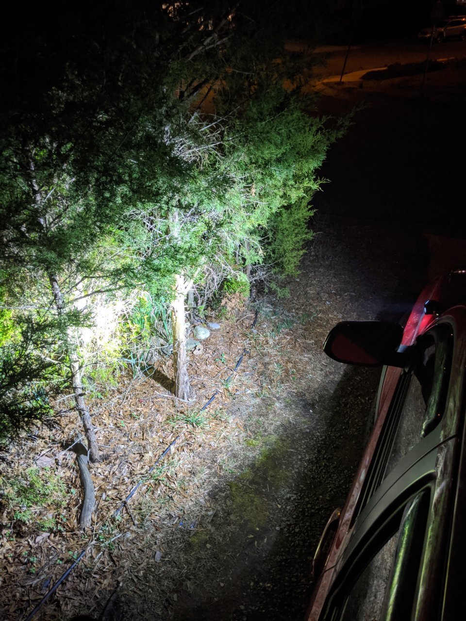

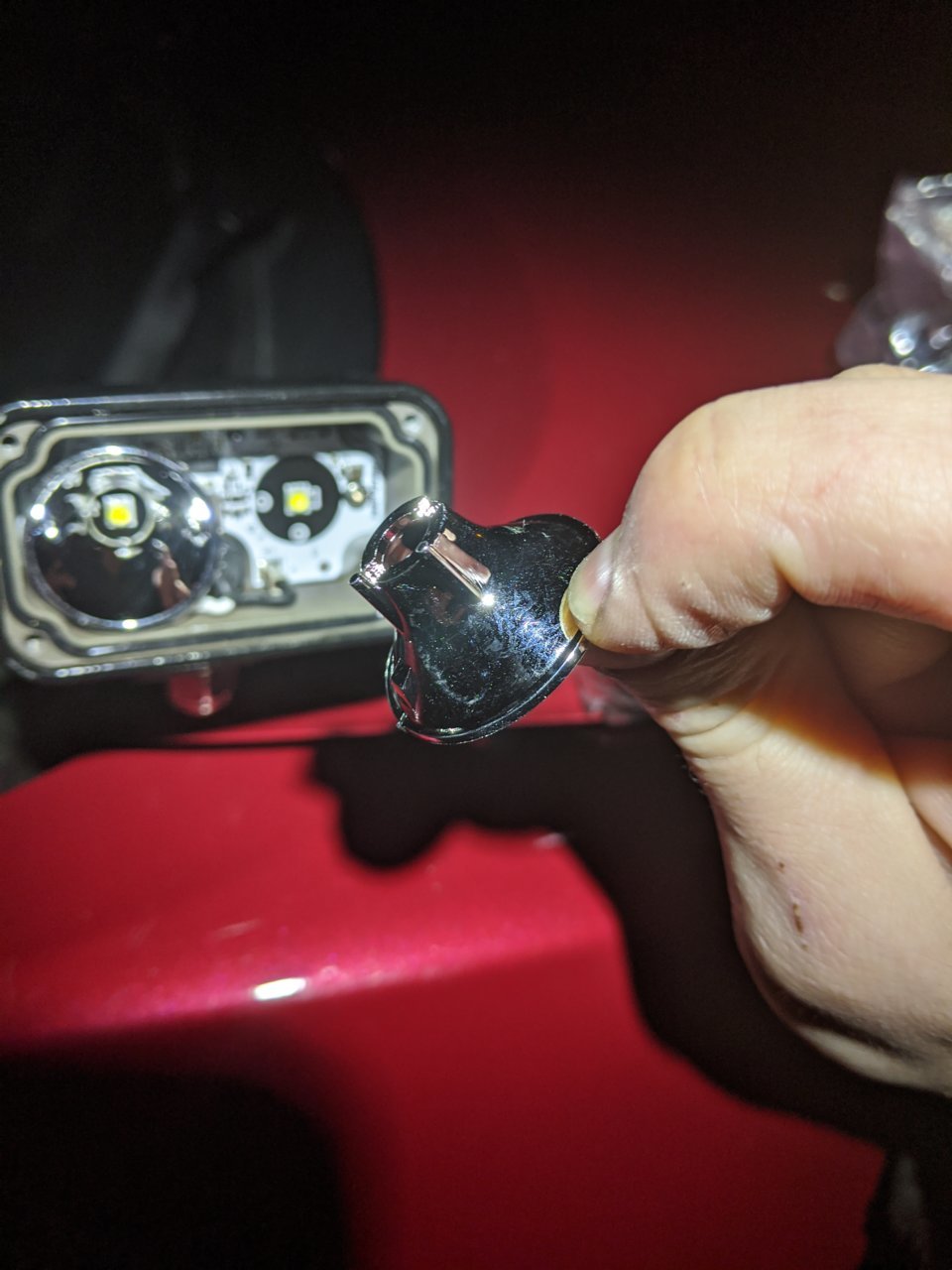

    I've got the S2 pros right now. They are great ditch lights. I had the driving combo and swapped the spot reflector with a work scene reflector.

    The spot is kinda wasted for how I have them aimed. That's why I just switched the spot reflector to a work scene reflector. With the D/C I just had a hot spot.
    You can see it there in the middle of the light pattern.

    I guess to explain more, the driving combo is one spot reflector and one wide cornering reflector. Now I have a hybrid wide cornering and work scene. Best of both worlds.
