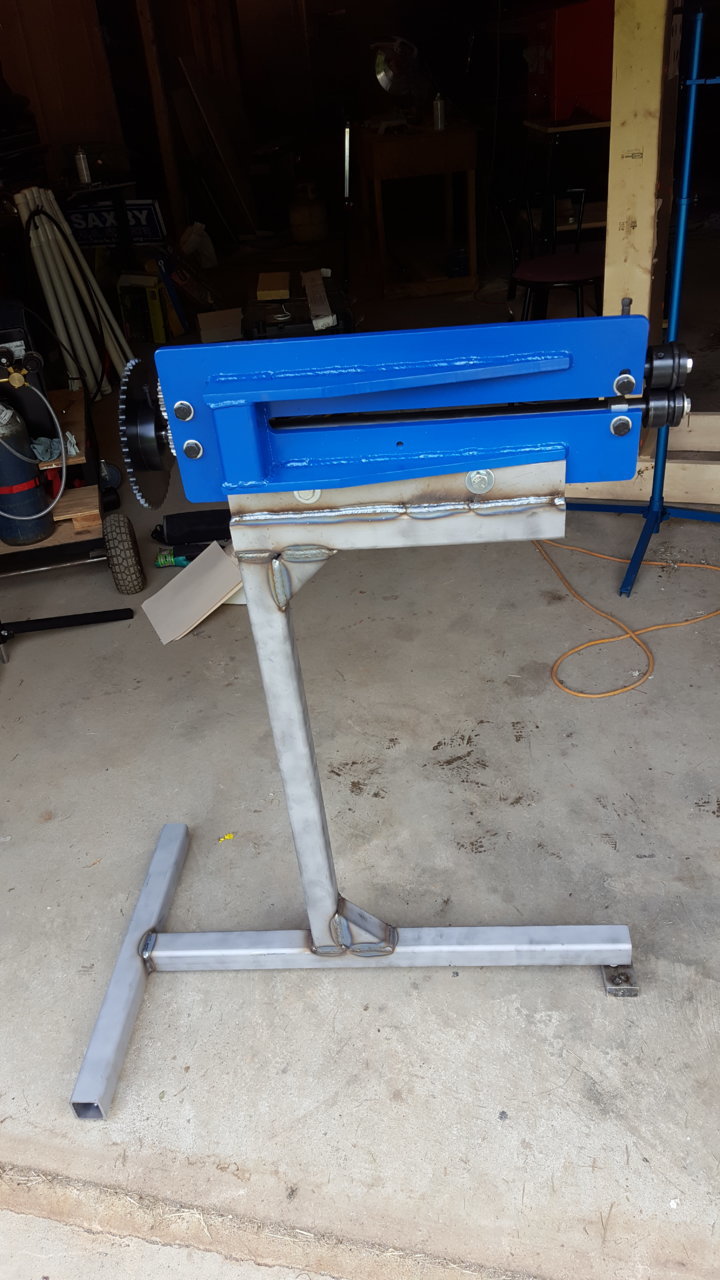

    So, I ordered a Woodward Fab bead roller. I plan to get a power kit for it so I can use it by myself, a table to support the panels, a fence to get nice straight lines, and a stand to hold it all.
    I know I will have to do a bit of custom work to make it so the fence and table can be used at the same time. I also know that I don't like the basic stand as I don't want to bolt it to the floor.

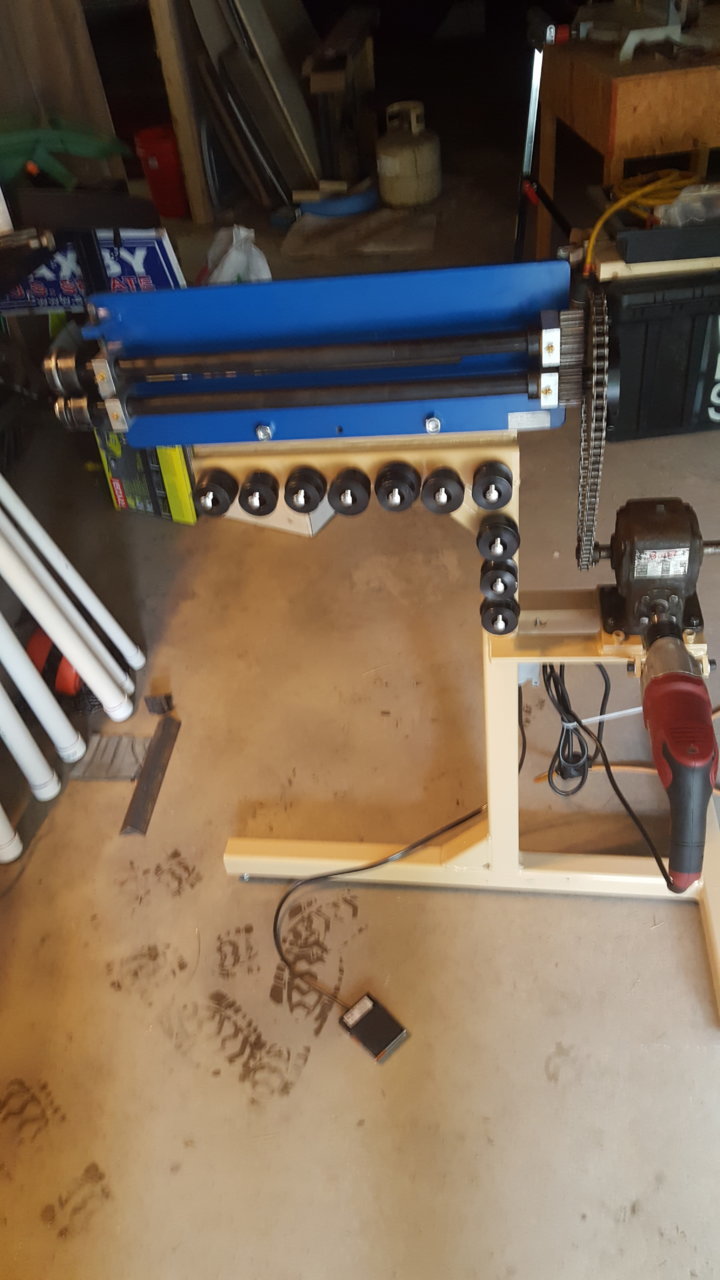

    I bought the Woodward Fab roller several years ago... and found the plate is too flexible for 18ga steel sheet...
    So I cut some reinforcement plates and welded to the back of the main plate to control the twist...
    I also welded up a stand for it and added a gear reduction box connected to the driving shaft by a chain and sprockets. The gear reduction box is powered by a cheap Harbor freight drill. I installed an outlet box on the stand to plug the drill into... the outlet box is switched through a foot pedal. This allows me to use both hands to guide the sheet through while powering the roller with my foot... I can turn it off and on at will...
    I've only used it a couple of times... but I did make a set of floor pans for a '64 Fairlane with it...
    I had to make them in sections due to the shallow throat of the roller... not a problem, it just meant more welding...

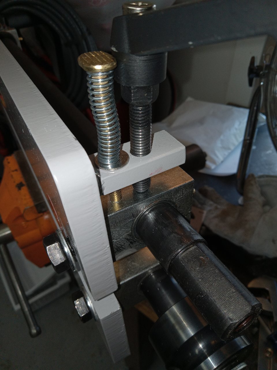

    Finally getting to working on mine. First modification is a return spring on the upper roller.
    I drilled and tapped a hole in the bearing block for a 1/4-20 bolt and added a compression spring. Now, the upper roller is automatically pulled up as I loosen the tensioner bolt.
    I picked up some 2" square tube to brace it, some heavy wall 3/4" square tube and 2x3 angle to build a fence. I just ordered the power drive kit from Summit ($425), but need to figure out how I want to mount it. Kind of thinking about building a work bench that it will sit into so I have a large flat table to use.
    Please excuse the mess.

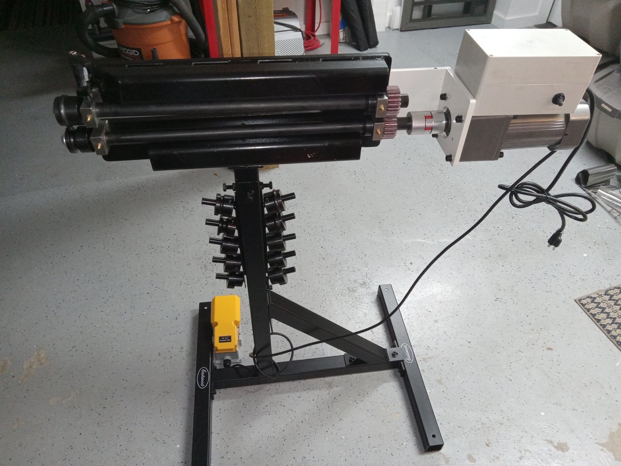

    Added some bracing to stiffen it up and put it on a stand with a motor.
    Prime use will be the floor of my car......

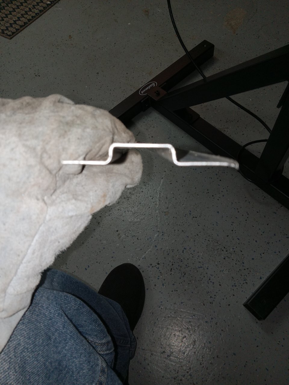

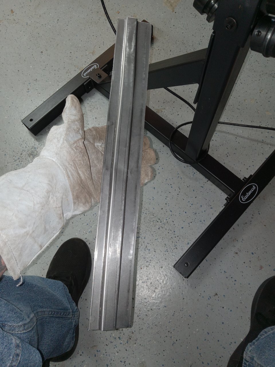

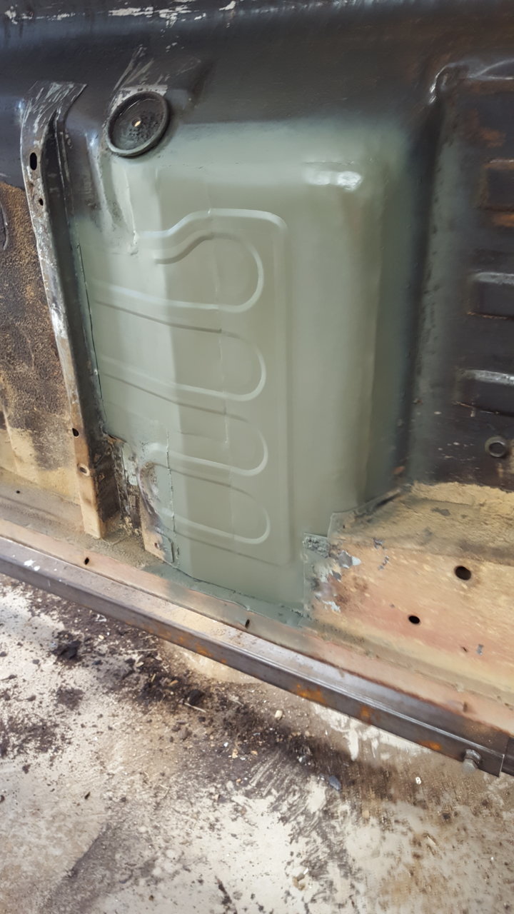

    First attempt at making hat channel. No guide line, just threw the scrap on and tried it. I realized I need better lighting, so I'll make sure I have guide lines and good light when I make some for use.
    Started at contact plus half then added had turn on each pass.
    Any tips yall have learned?
    I definitely like and recommend the return spring modification.

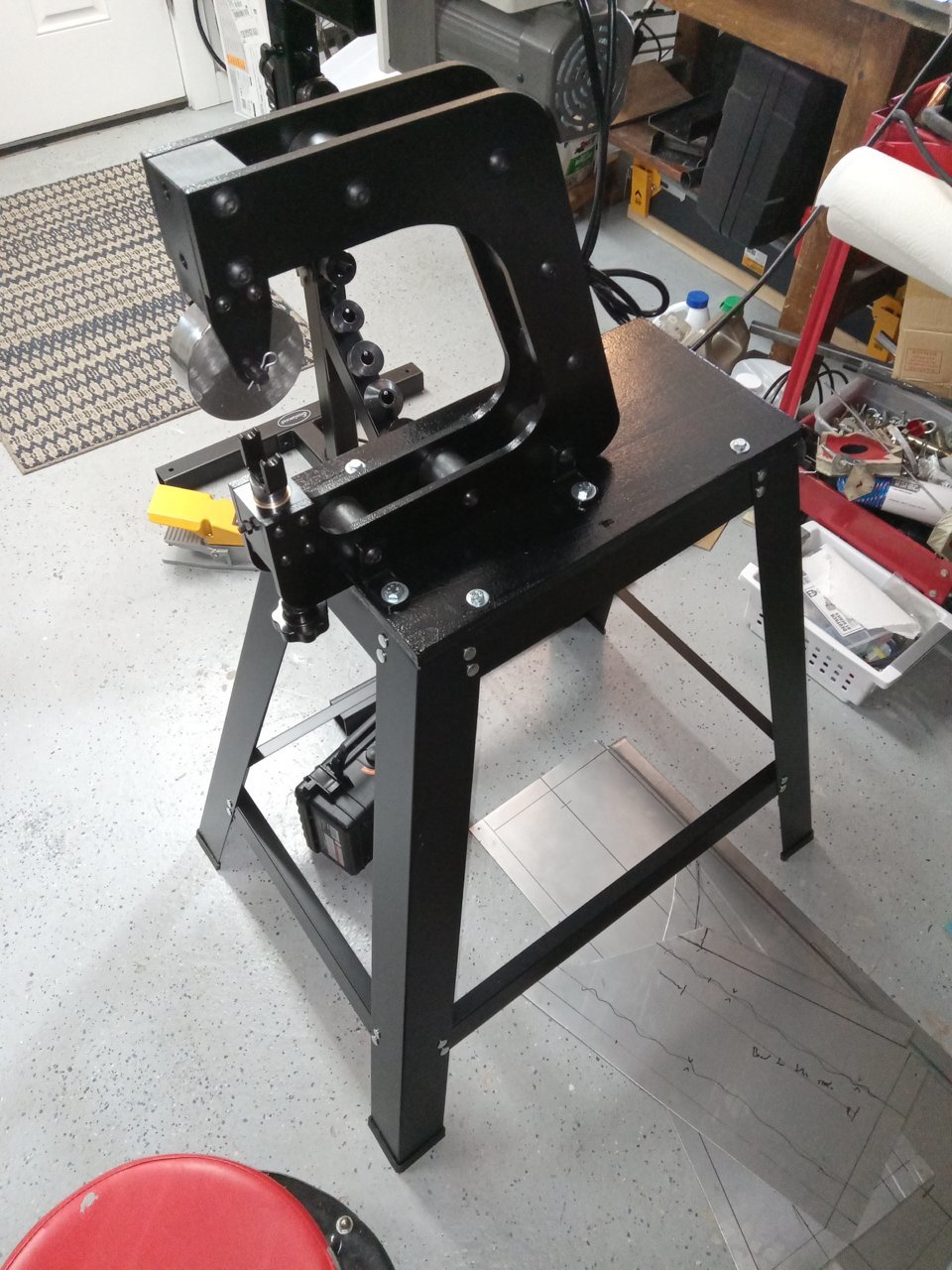

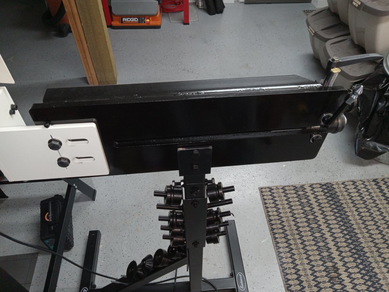

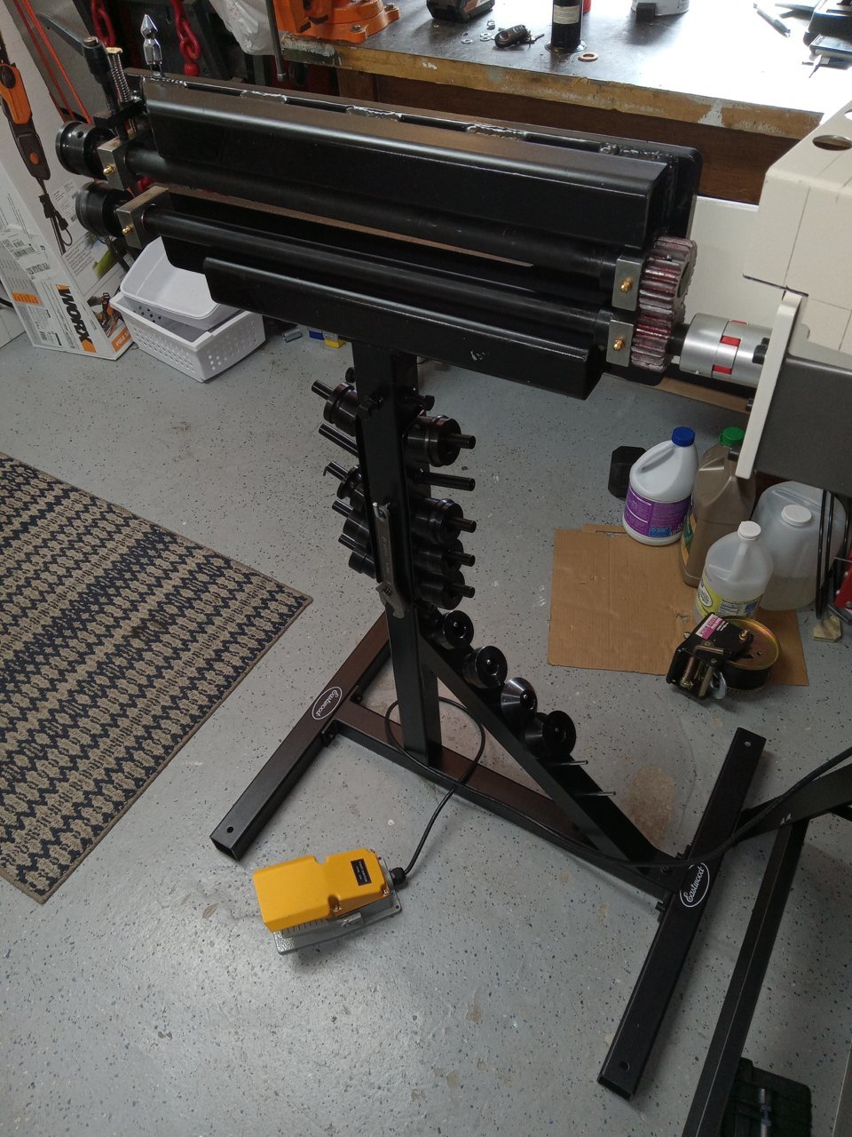

    Added a stand for the mini english wheel. Also got a box for the dies, set it up so they can be easily oiled in the box by adding a couple drops of oil to the foam and rotating the dies.
    On the bead roller, I added a L hook to hand the wrench, added 6x 1/4" studs to hold additional dies without having to switch them on the studs when I change dies, and added am arm to the bolt for the top roller to make it easy to tighten to roll. I did flub up the threads on the spike, but it had some weird British thread and I had to retread it to 3/8-24 but it tilted a little bit. Oh well.
    I also drilled new holes for the motor bracket to get it so I could use the 90* and tipping dies. Before, they hit the frame of it.
