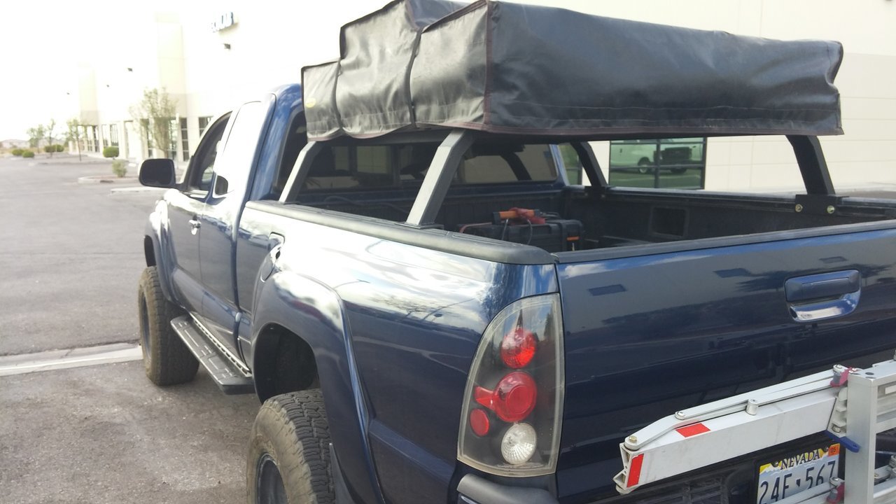

    At werk...

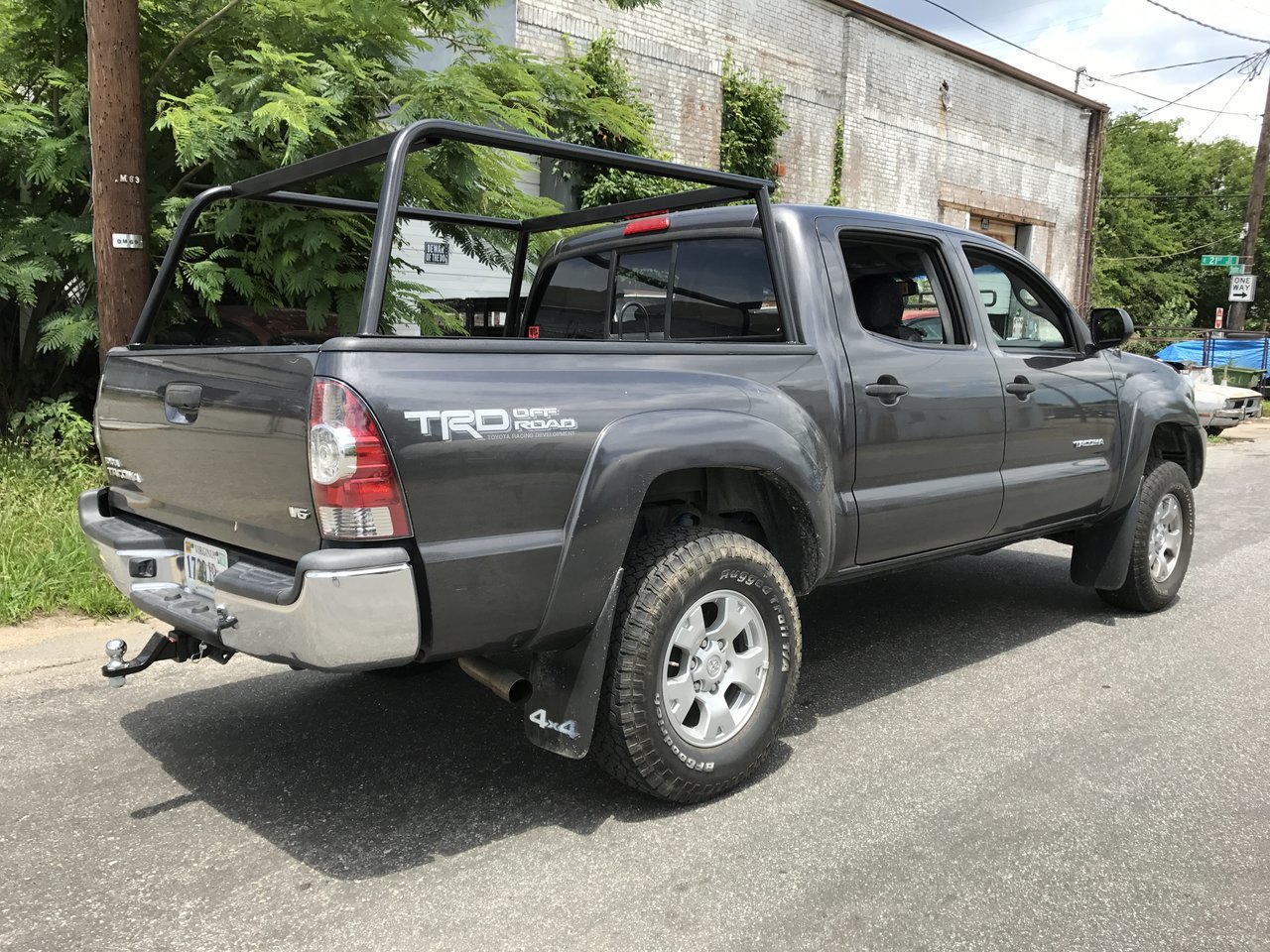

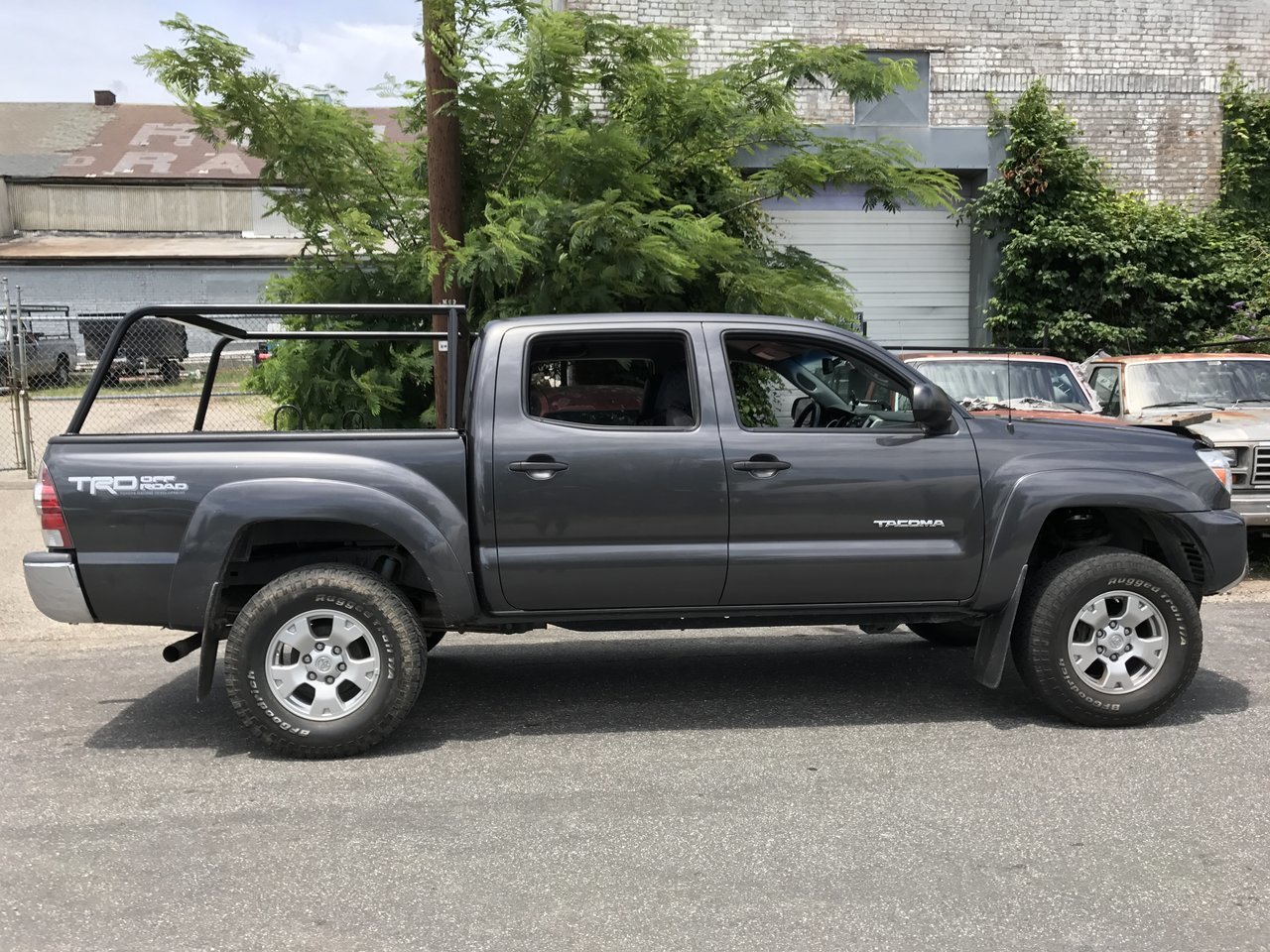

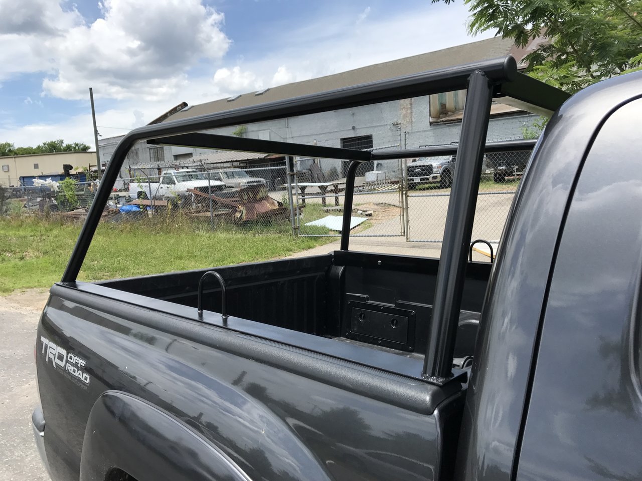

    Just finished mine for right now. It's my take on the CBI rack. It comes apart and since I haul motorcycles a lot the rear cross rail will come out and you can pull a bike in there. I'm going to go back later and add some mounting points for stuff like a hi lift and maybe a shovel but I live in the city and I don't really want to leave that stuff on there all the time because it will just be a target. Made out of 1.75" .120 wall DOM tubing and 2x2x.10 square stock. I just sprayed it with black lacquer so I can Weld on it more down the road. I also wanted it a little taller so I can put stuff like surf boards on the rack at the beach and have some shade. It does wobble a little when I hit bumps and stuff so I'm thinking I'm going add a diagonal brace along the cab up front to keep it rigid.

    Nice!! What height is that?

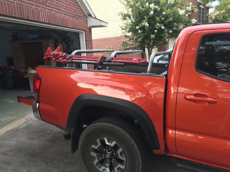

    what bed bars are those?

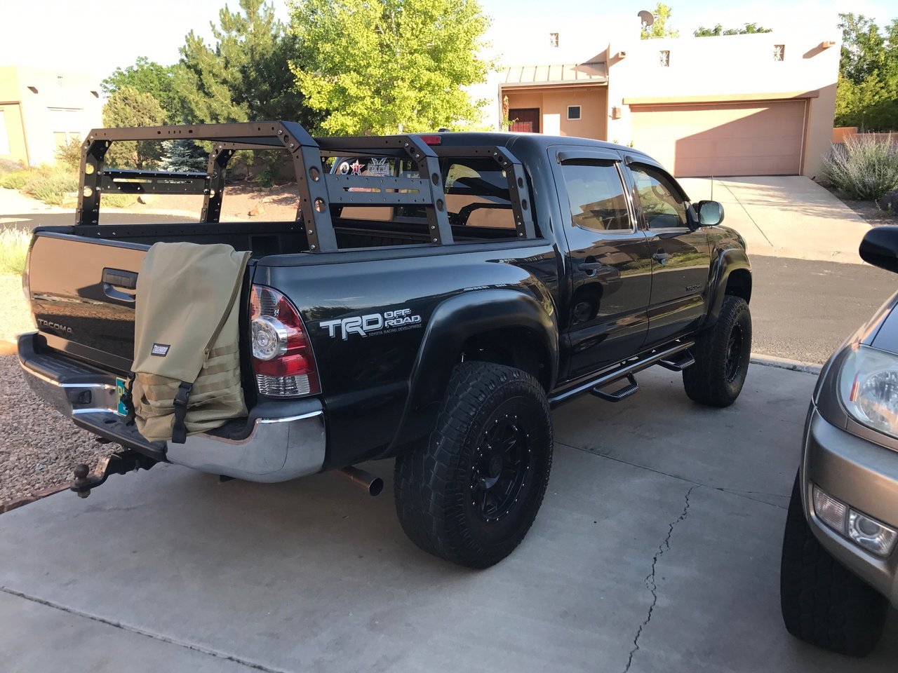

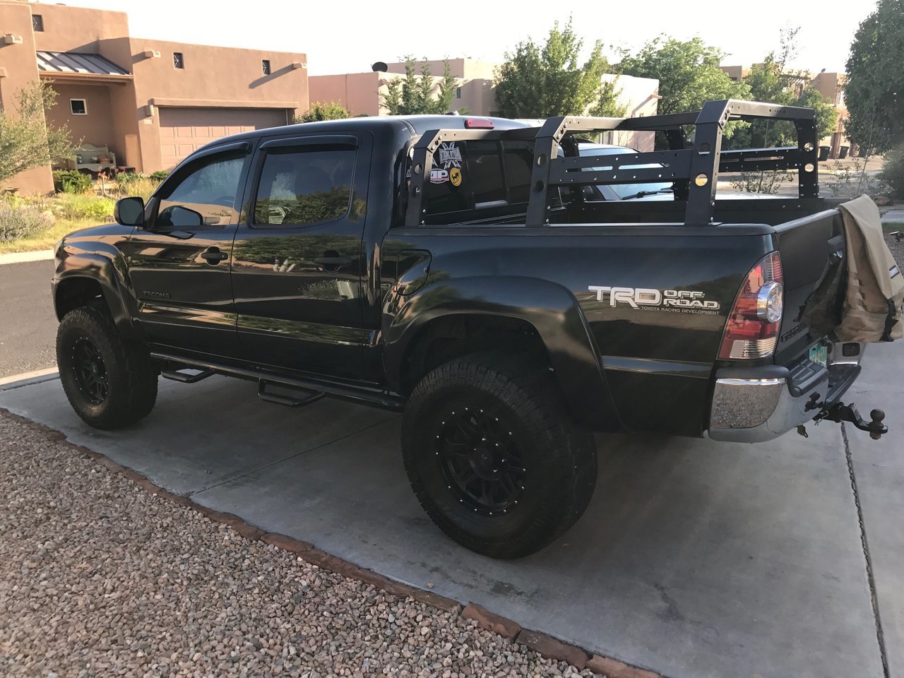

    Allpro apex modular

    They are my bars. Made em in my garage.
