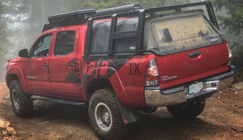

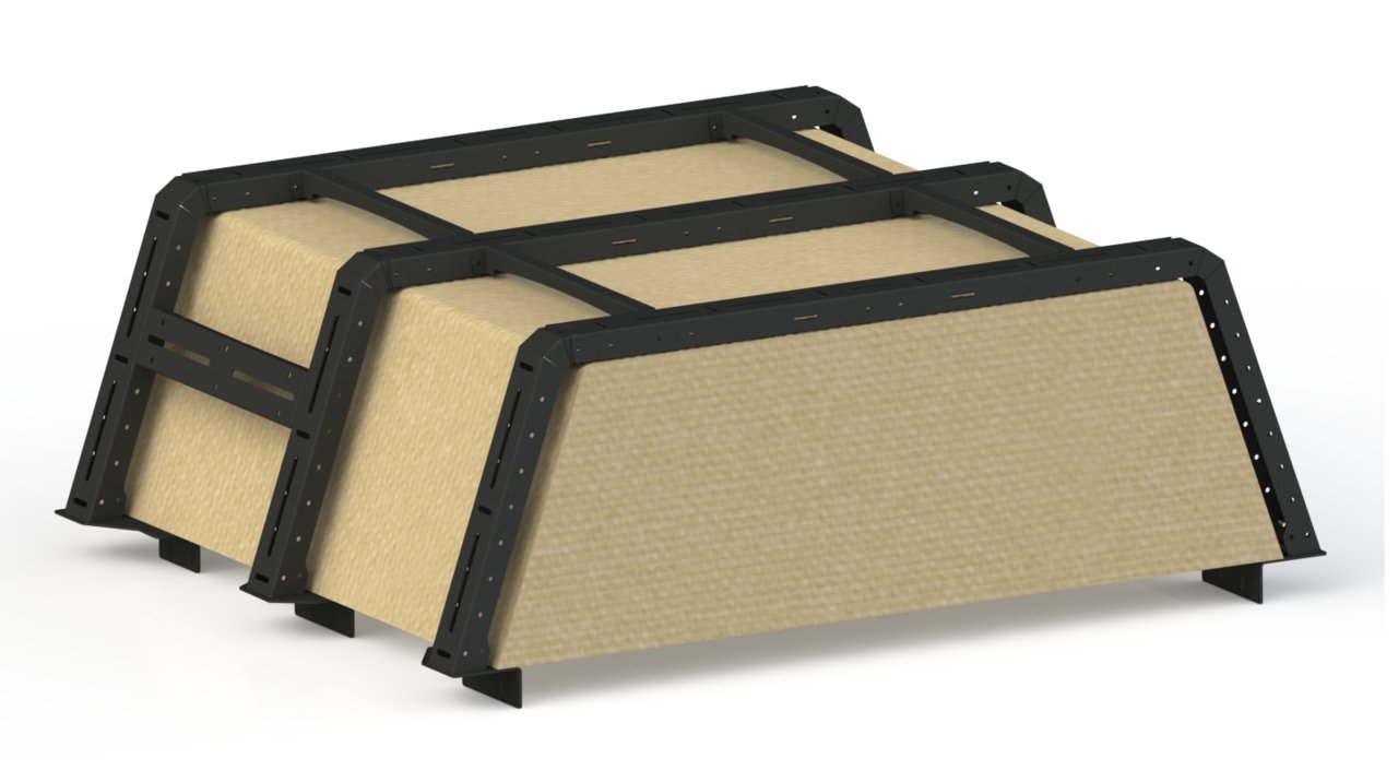

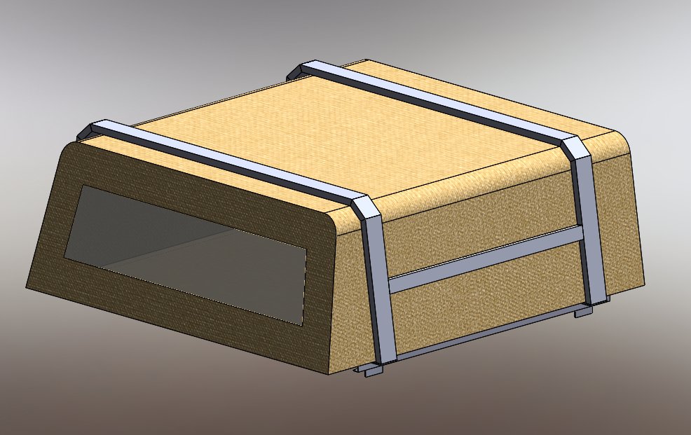

    Indeed!
    Find it here for 2nd Gen!
    Find it here for 3rd Gen!

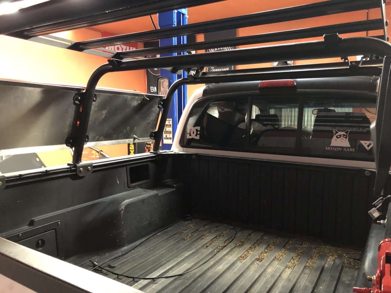

    I did this and it worked pretty well. I drilled my kb rails and used rivnuts so the rack would be removable. I use an access lite roll up cover and had to space it off the bed rails to get the correct mounting width. If you move forward please post pics of your setup!

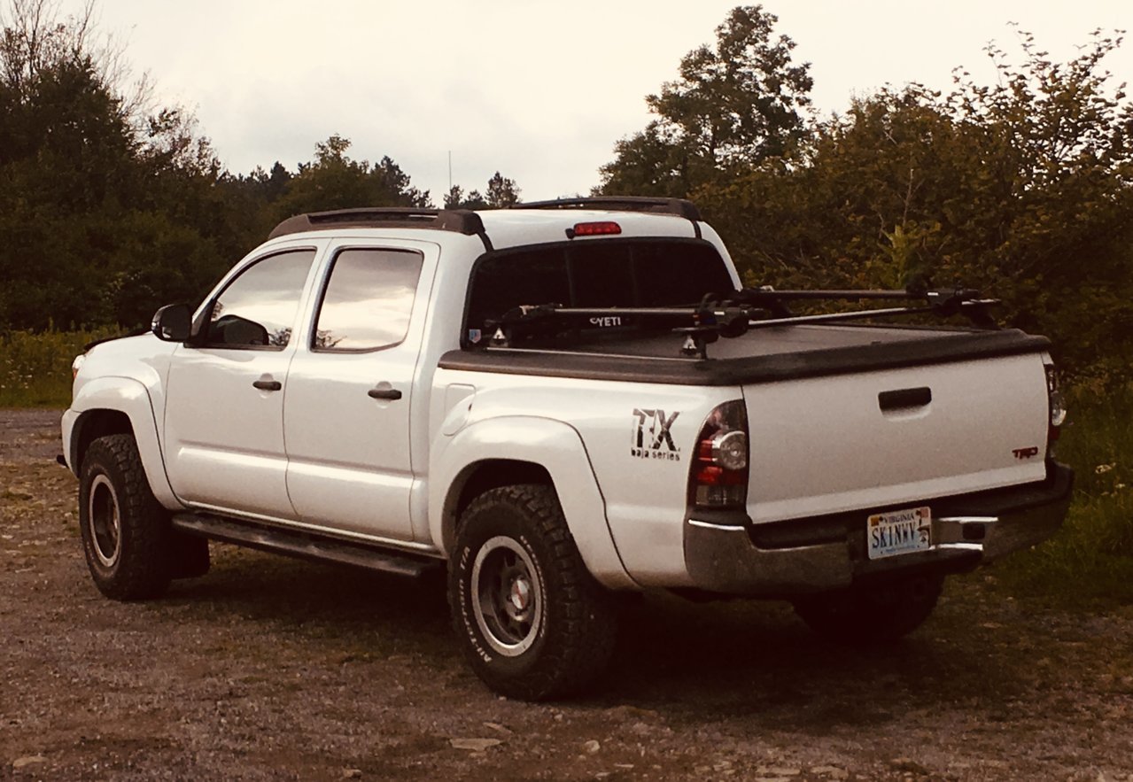

    Undercover w/ Yakima (custom tracks and foot)

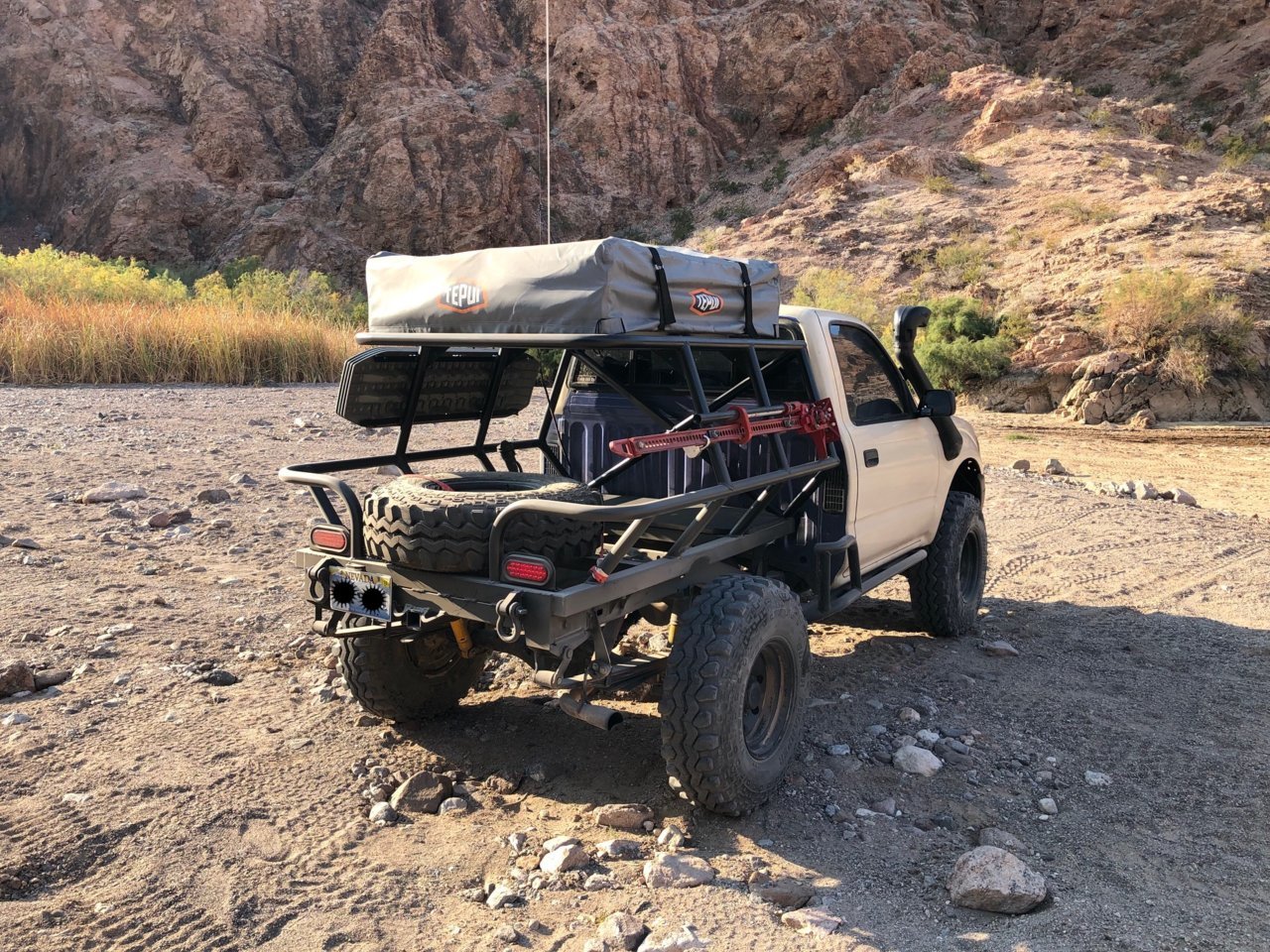

    Can 1st gens play?
    Im not even close to finishing the "rack". Still gotta add the cargo slide out & tool boxes.

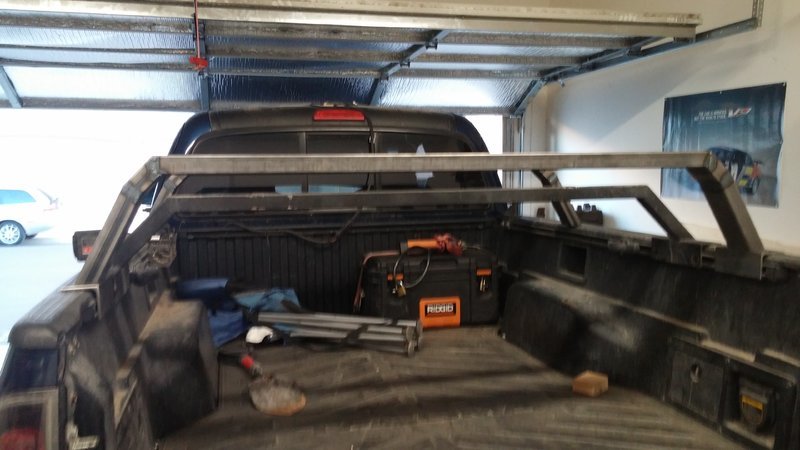

    Here’s my rack I fabbed up myself

    I'm about 2 years too late, but I love the way you made this rack. Wondering if you could tell me a bit about the material you used? Thanks!!

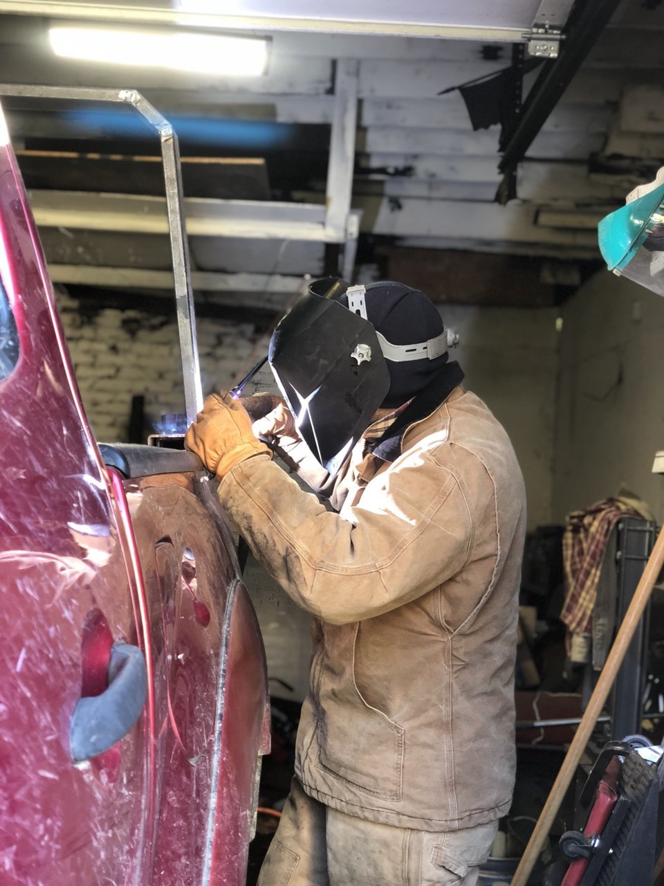

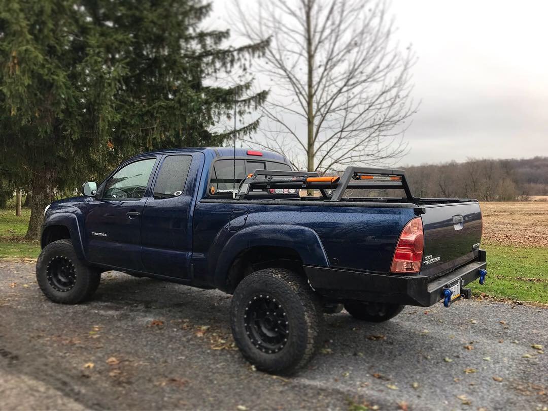

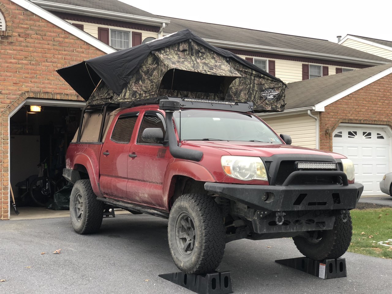

    From this:
    To this: @Arcticelf
    And this:
    And finally this:
    In roughly 30 hours!

    What gauge and square tube dimensions are you using?
  18. Dec 10, 2018 at 9:20 AM
    #1018
    Nimble9
    Nimble9 visit squareonecreations.com Vendor
    Oct 20, 2015
    #167184
    11,161
    Lebanon, PA
    2006 4x4 DCSB
    enough to have fun
    1x3 .125 Wall I believe, @Arcticelf would confirm

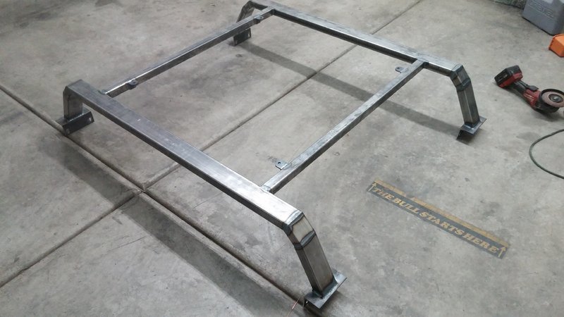

    Thanks! I actually ending up giving this to my friend and I built my own aluminum camper shell with a pop top. My friend that has this rack, put it on his shortbed after trimming the outside edges off the "feet". We might try to take it a step further and enclose it.

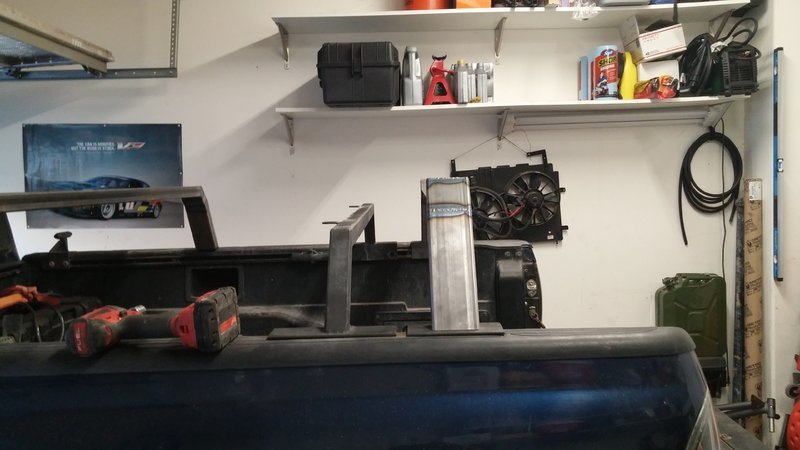

    Finally ordered up and installed my prinsu on my bed racks. had a local shop bend them since i don't have a bender but then did the rest of the fab work myself.
