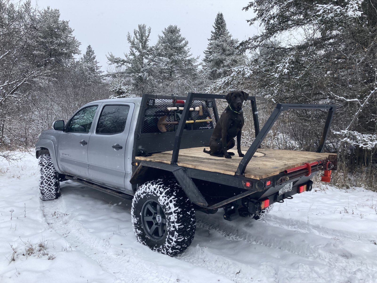

    With enough PBR you get a FBR Mine has evolved...

    Well done sir...
    Great looking dog.

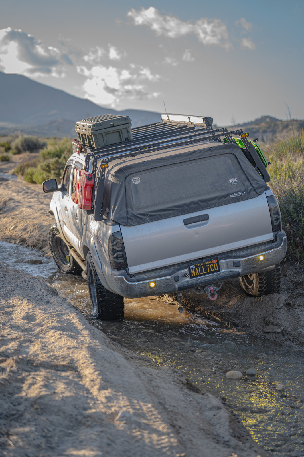

    2009 grey Tacoma off-road
    Prinsu roof rack Baja Ditch lights
    _DSC1034-2.jpgUptop overland ‍♂️

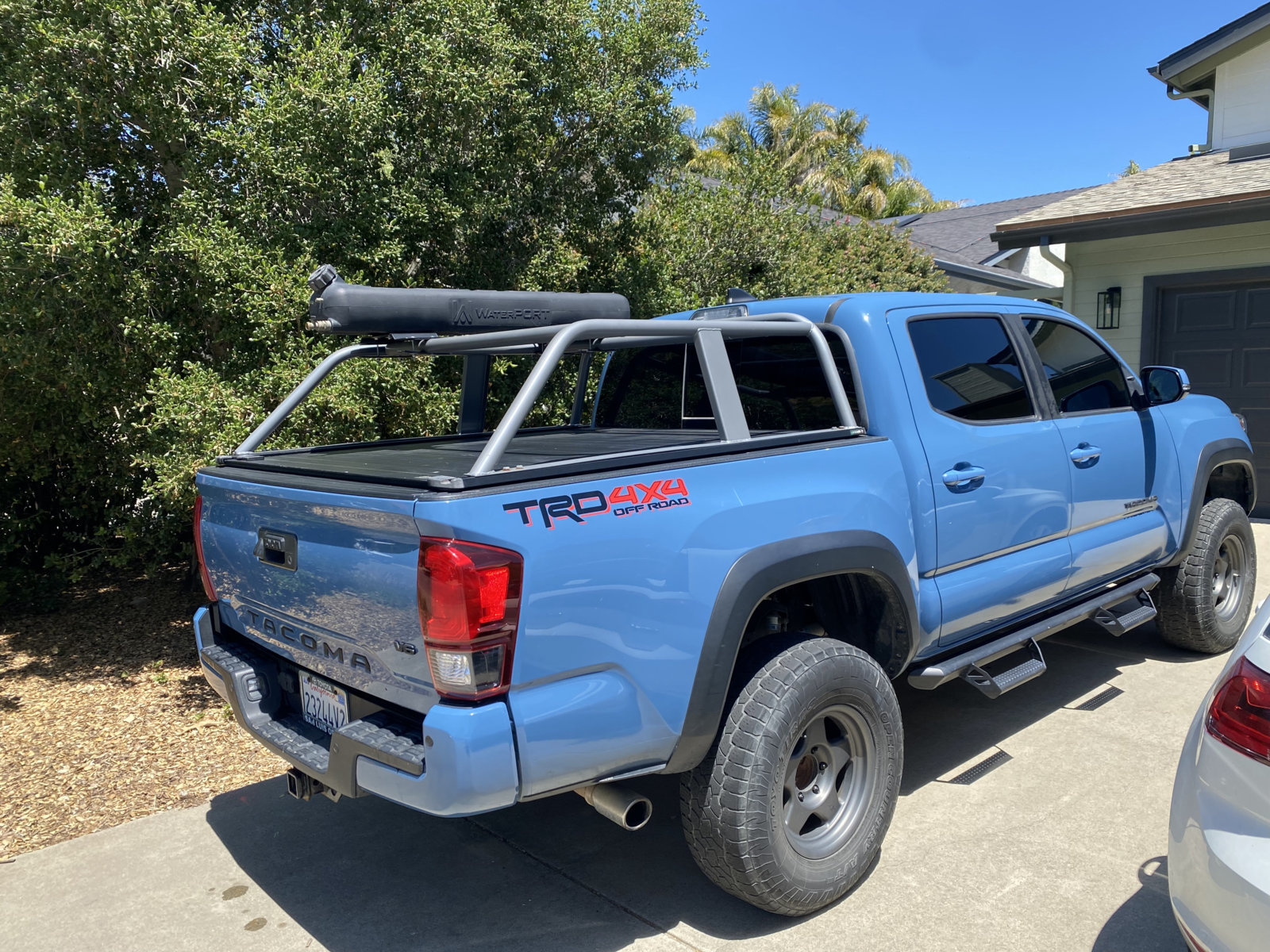

    2019 Tacoma TRD OR
    bilstein 6112, Deaver leaf springs, ~2in lift front/rear, Retrax HD tonneau with custom fabricated bed rack, SCS wheels

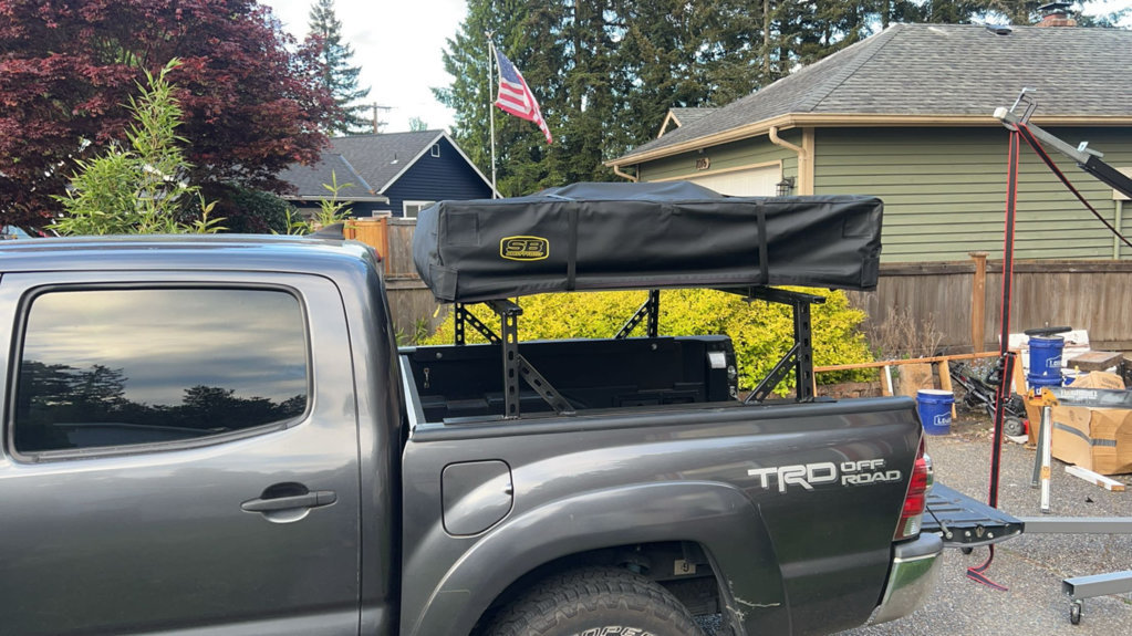

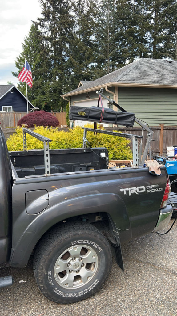

    IMG_1326.jpg IMG_1327.jpg So I went and snagged some freecycle 3x3x1/4 angle and some scrap 1-5/8 slotted strut and welded it together. Wanted the holes to be able to move and adjust everything anywhere (minus the height) but also provides tie off all over the freaking place. Rebuilt it 3 times mostly adjusting the height. Originally I wanted it with a tent no taller than the cab. But quickly found out that severely diminished the bed space, so I raised it up to be more ladder rack ish height.
    ill have to snag some photos of the current setup (lost the photos when my phone went into the lake)
