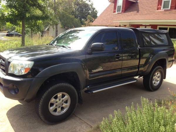

    Thanks to everyone on this forum, I recently did my own 2.5 inch lift and got a bestop to celebrate my '06 rolling over 130k...decided to keep her for a while longer yet.
    I thought I'd post some pictures of the top, along with some closeups of the back-rail. I've seen some confusion on how exactly to install it, and it took me a few minutes to get it right.

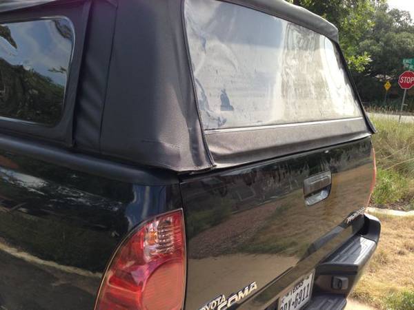

    Here's the truck:

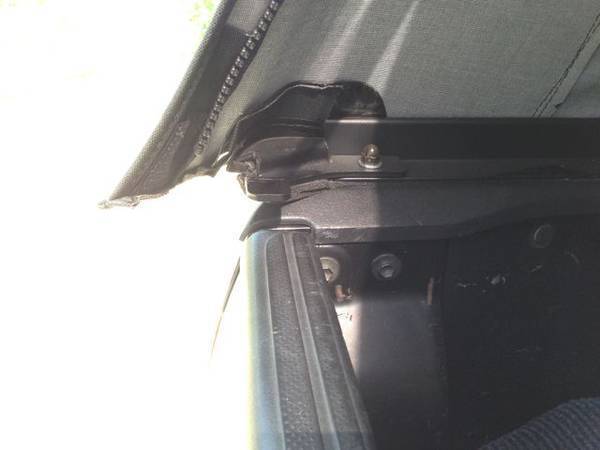

    So, the instructions aren't all that clear on how far back the top should go. They tell you how far forward, but really the back is the part with the smallest room for error. Here's mine after I adjusted it to fit better:

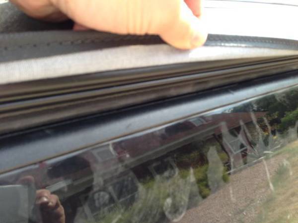

    Here's the rubber gasket actually hitting the tailgate, moving the whole thing back helped achieve this.
    And here's how far back the tabs on the rails go when it actually fits. I should note that I managed to lenghten the rails by 1/8 to 1/4 of an inch by bolting them together while using the maximum length that the holes allow (they aren't perfectly circular).

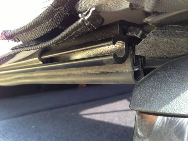

    This is the back window bar installed and hooked into the side rails, note the orientation:

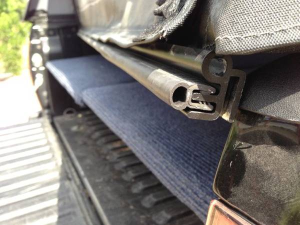

    When you unhook it and it hangs loose from the rear window, this is the orientation it hangs in before you turn it 90 degrees to close it:

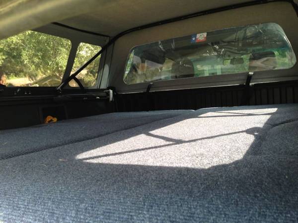

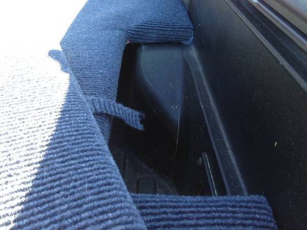

    And one last bonus image, the sleeping platform I built last weekend, used carpet and padding...luxurious.
