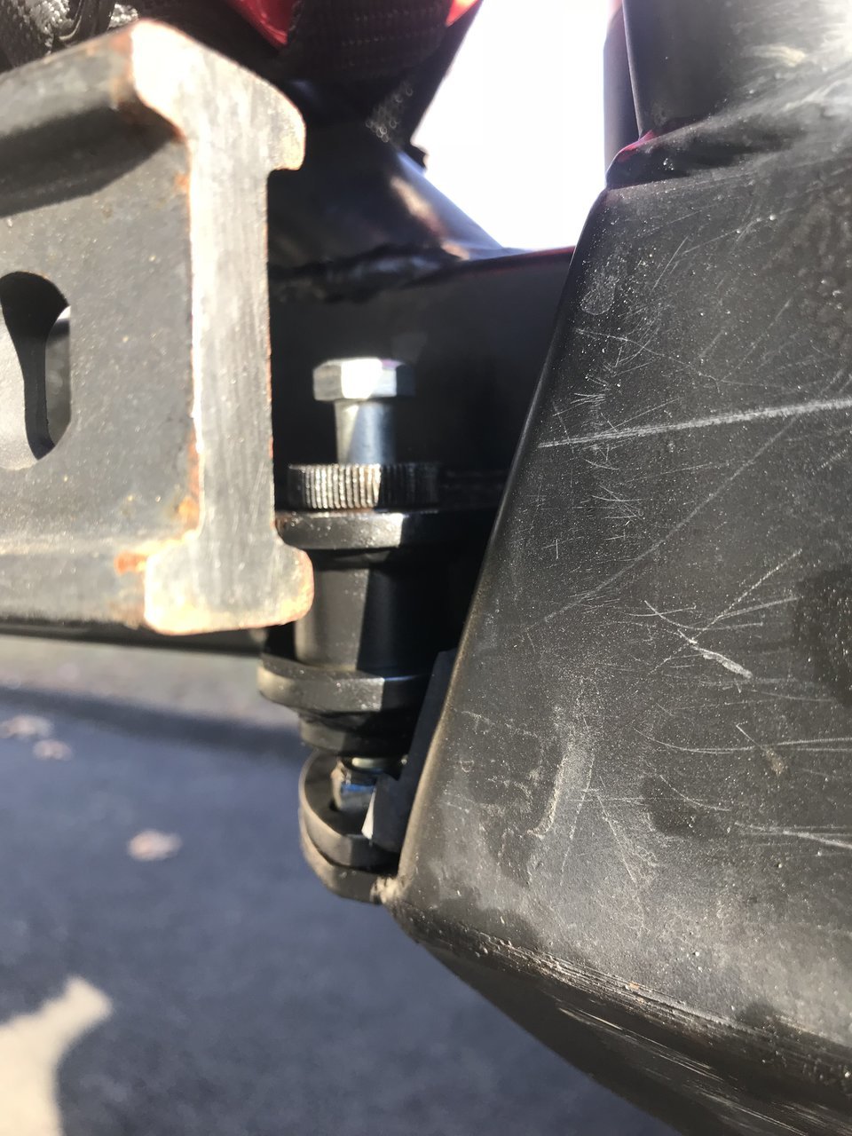

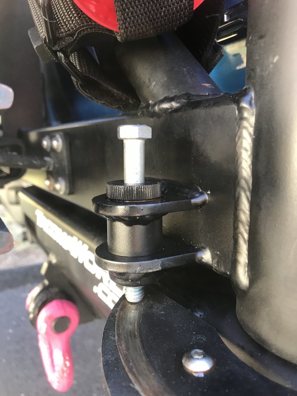

    Until I can get the release pin for a LOT LESS than $25, here’s my cheap-ass temporary solution:
    3/8” x 3” bolt from my nuts and bolts coffee can. Re-used pin spring and then added the 3/8” nut to retain the entire assembly in the sleeve.
    Works like a charm.

    I would just use that fix forever. :D
    Subway4X4 and bski22 like this.

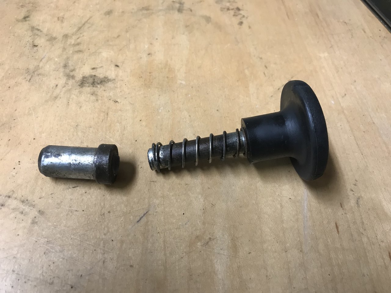

    This is what happens when you are a dumbass and drive off without securing the swingout.
    You shear the pin.

    Yeah. I’d probably get a more corrosion proof nut and bolt though.
    This regular zinc nut and bolt isn’t gonna last half the winter here in NY
    ChadsPride, Crom[QUOTED] and bski22 like this.
