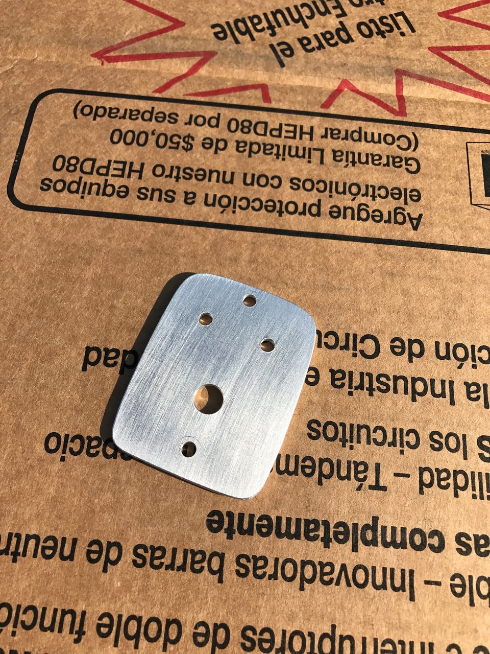

    http://www.pelfreybilt.com/product/camera-relocation-mount/
    Seems simple enough I may end up making my own because they say 3-4 week lead time on the website for this little plate... and you still have to extend your factory harness.[​IMG]

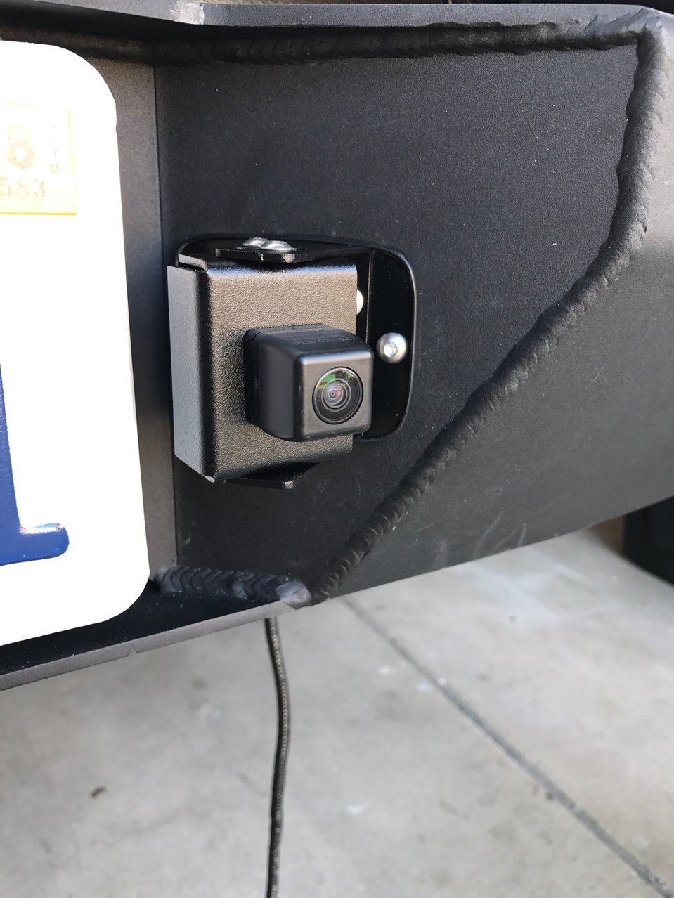

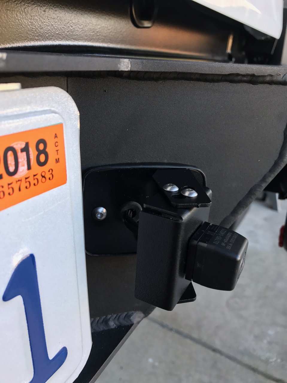

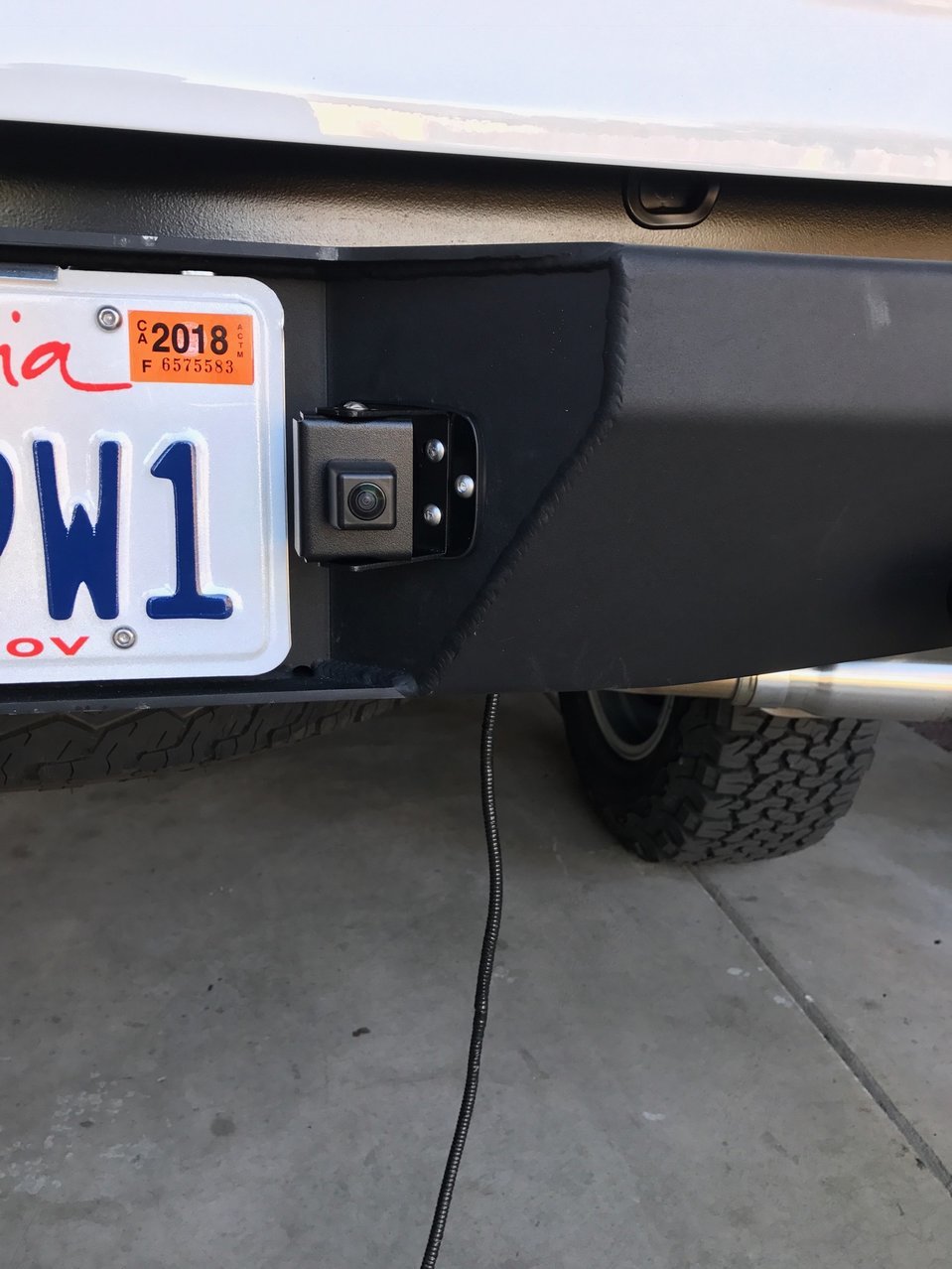

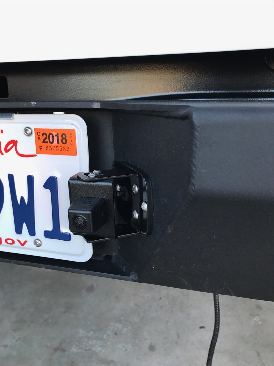

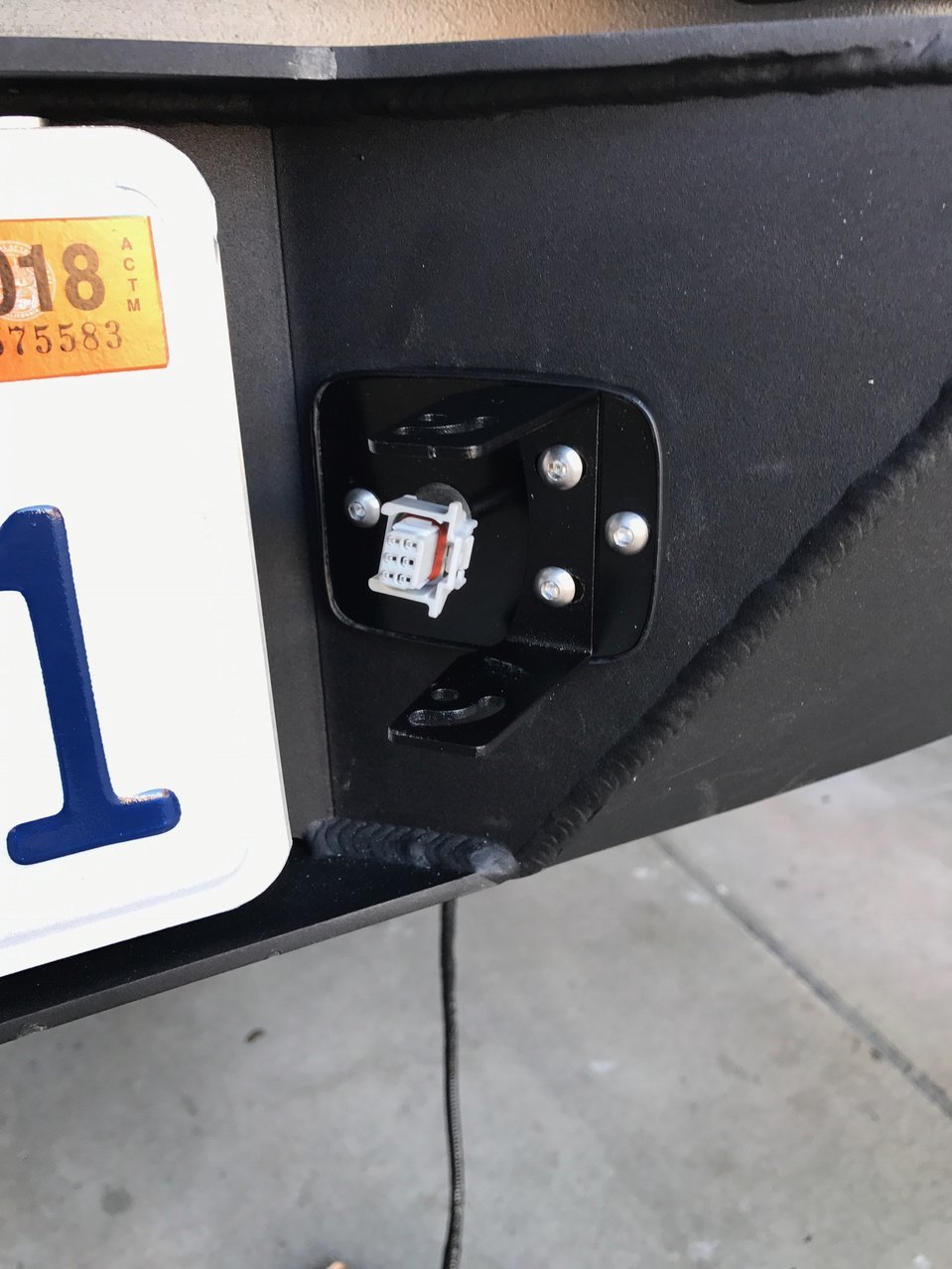

    Here's some pictures of Billy's BU camera mount and how I utilized it. It's meant to mounted on the swing out with self tappers and the wire harness secured in some way of your choice.
    This solution works for me but some would probably disapprove.

  10. Jan 11, 2018 at 3:10 PM

    I like this way so you don't have to extend your wire harness to the swing out.
    Yes- its TW... someone will disagree for sure
    ChadsPride and thebaker like this.

    One more follow up, Did Billy include this for you or did you have to add it on?
    ChadsPride likes this.
  12. Jan 11, 2018 at 3:25 PM
    #2272
    RCRcer
    RCRcer Well-Known Member
    Jul 14, 2015
    #159476
    879
    2015 OR DC
    Well...if the swing out hinges on the right side you probably wouldn't have to lengthen the harness at all. I had Billy hinge mine on the left and the harness would have definitely needed to be longer.
    I still cut the harness and spliced it back because of the size of the camera plug.
    I wanted to keep the camera and the was the cleanest solution for me.

    The camera mount was included with the bumper.

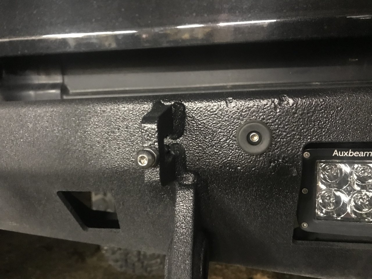

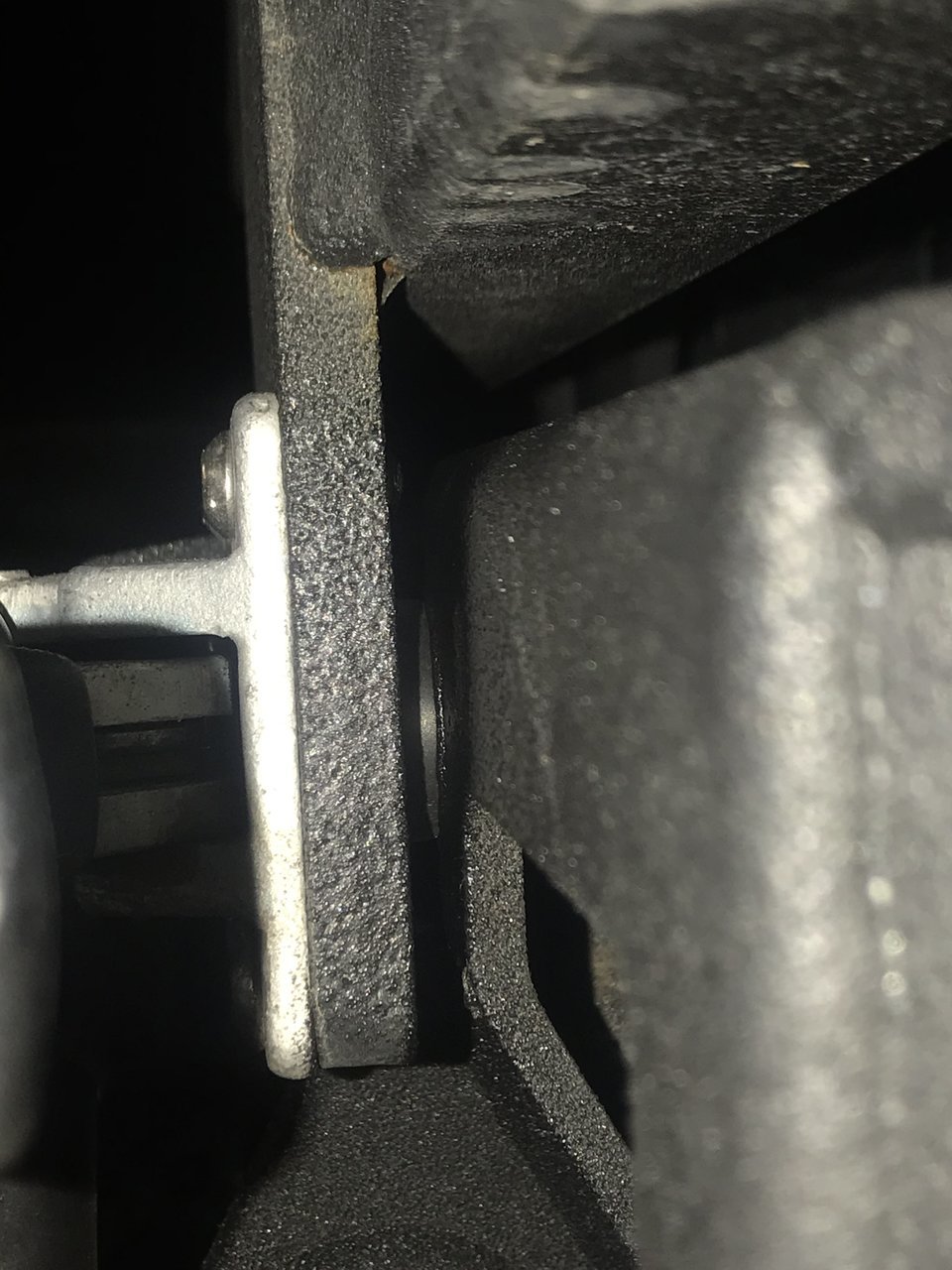

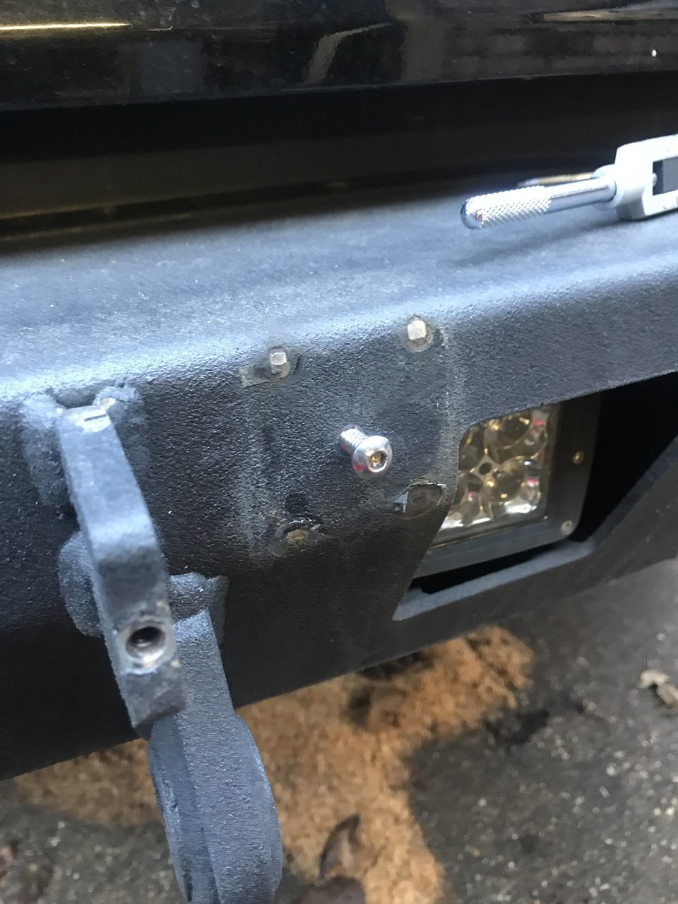

    I also changed up a small detail that had been annoying me. The rubber pad eventually fell off the goes behind the latch on the swingout where it gets close to the bumper. I thought I could just cut down the bolts that bolt the latch onto the swingout, but then it was squeaking and it annoyed me to death. So I just ordered some rubber feet that had a hole in the center for a bolt. It was a little thick, and kept the swingout from latching. But a little sandpaper to the back and voila....
    The swingout latches very securely and doesn’t seem to have any play at all now. You can see even after I cut down the bolts in the latch they still rubbed lol
