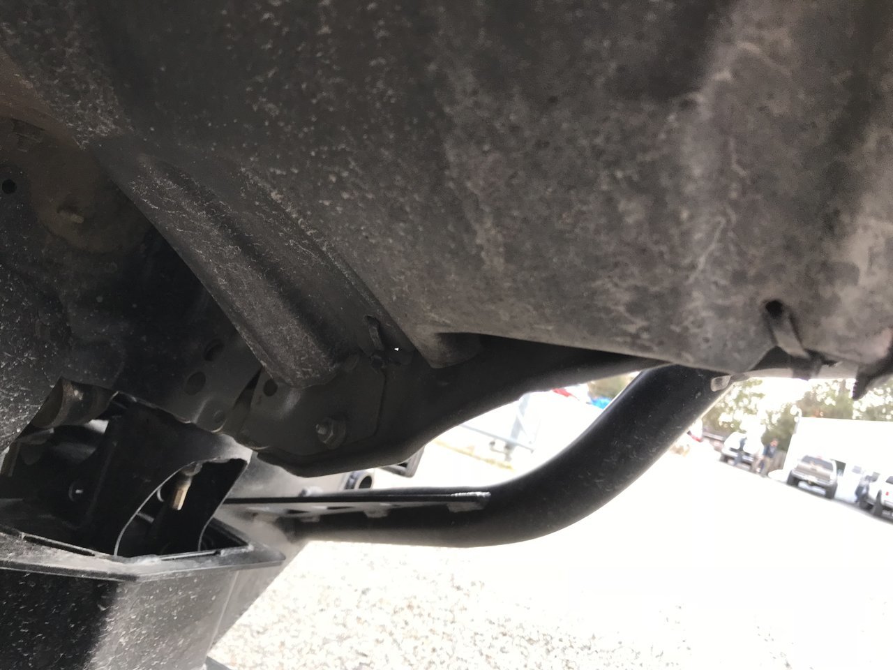

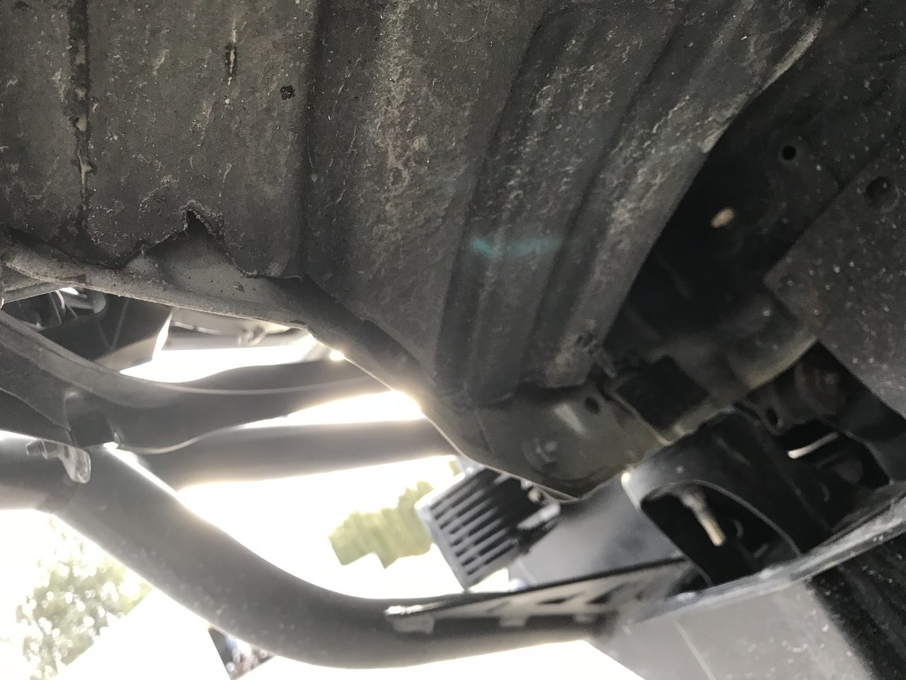

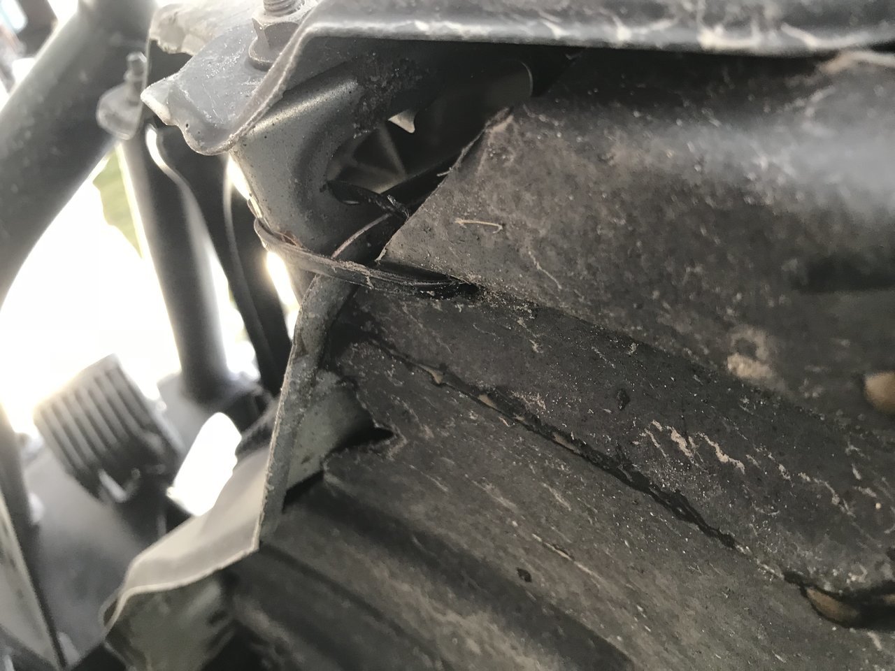

    A few things
    I will get you a picture when I get home tonight

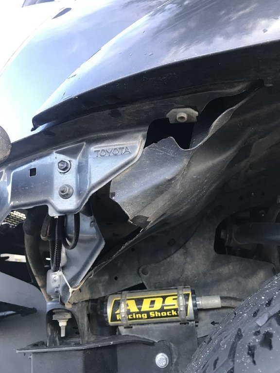

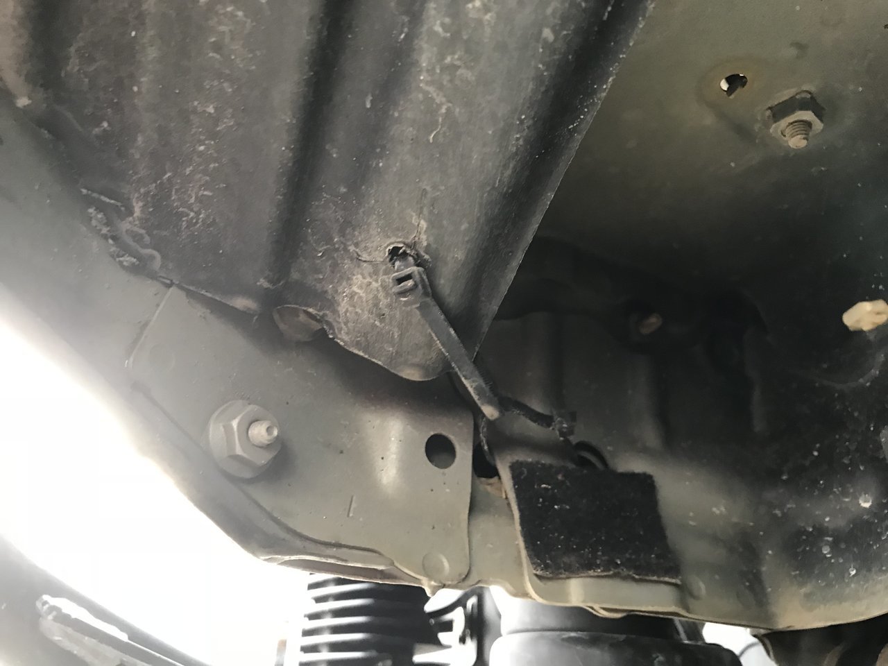

    Cut them and stuff/ziptie them up into the fenderwell body portion. Right below the head lights

    ^^ this. easy to cut and just shove up there. If you cut it with enough slack, it will just hold there fine but I added a zip tie so it doesnt come out (I cut mine on the shorter side so it doesn't just stay in place on its own).

    @ChadsPride its really easy to cut through (used some harbor freight scissors I had laying around) so just take your time and dont rush otherwise it will look like this.
    (I didnt realize how ugly I cut them until I took these pics this morning. Guess I'll be spending time cleaning it up some how this weekend.)
    Driver:
    Passenger:

    Thank you for the pics!!! Look like you have some sort of frame brace for the bumper.
    Did that come with it?

    yup. the frame re-enforcements are super beefy and does come with it.

    I cut them shorter than that and pushed them higher. There is a metal bar that is where you tuck the lip behind the. I used a zip tie or three to keep it up there

    Thank you so much!!! Although I just saw some pics above...Im still interested to see more.

    Frame/bumper reinforcement brace is beef.
    Considering the fact that I’m always winching myself or other trucks every other week (it seems), I’d have lost my bumper many times over if it weren’t for this reinforcement brace.
