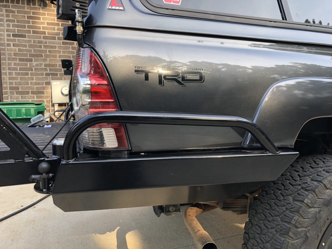

    His instructions say to cut even with the bottom of th tail light, which should be 17” below the top of the bed. I cut another .5” below the tail light because I thought the gap was to big the other way.

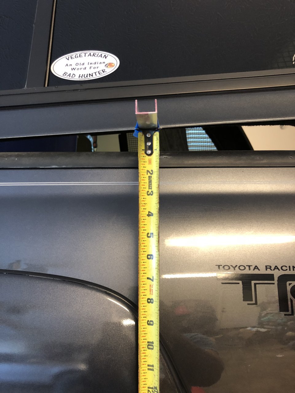

    Taping the end of the tape measure to something is a good way to measure. The picture shows painters tape, but I switched to gorilla tape. The body curves a lot in the area you are cutting, so I found it helpful to have both hands for marking the cuts.
