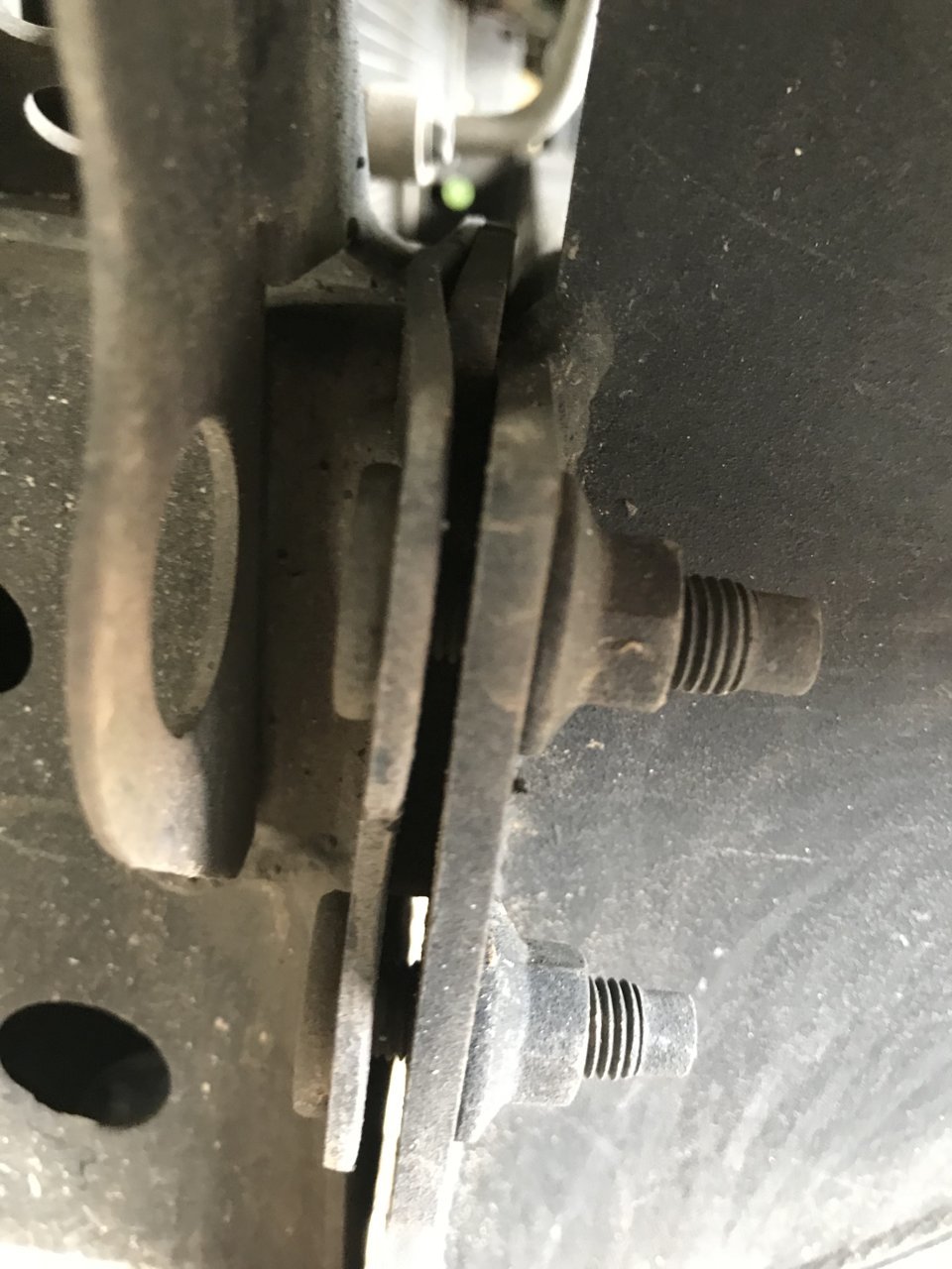

    About to install my bumper
    Can anybody show me where these 4 things go?

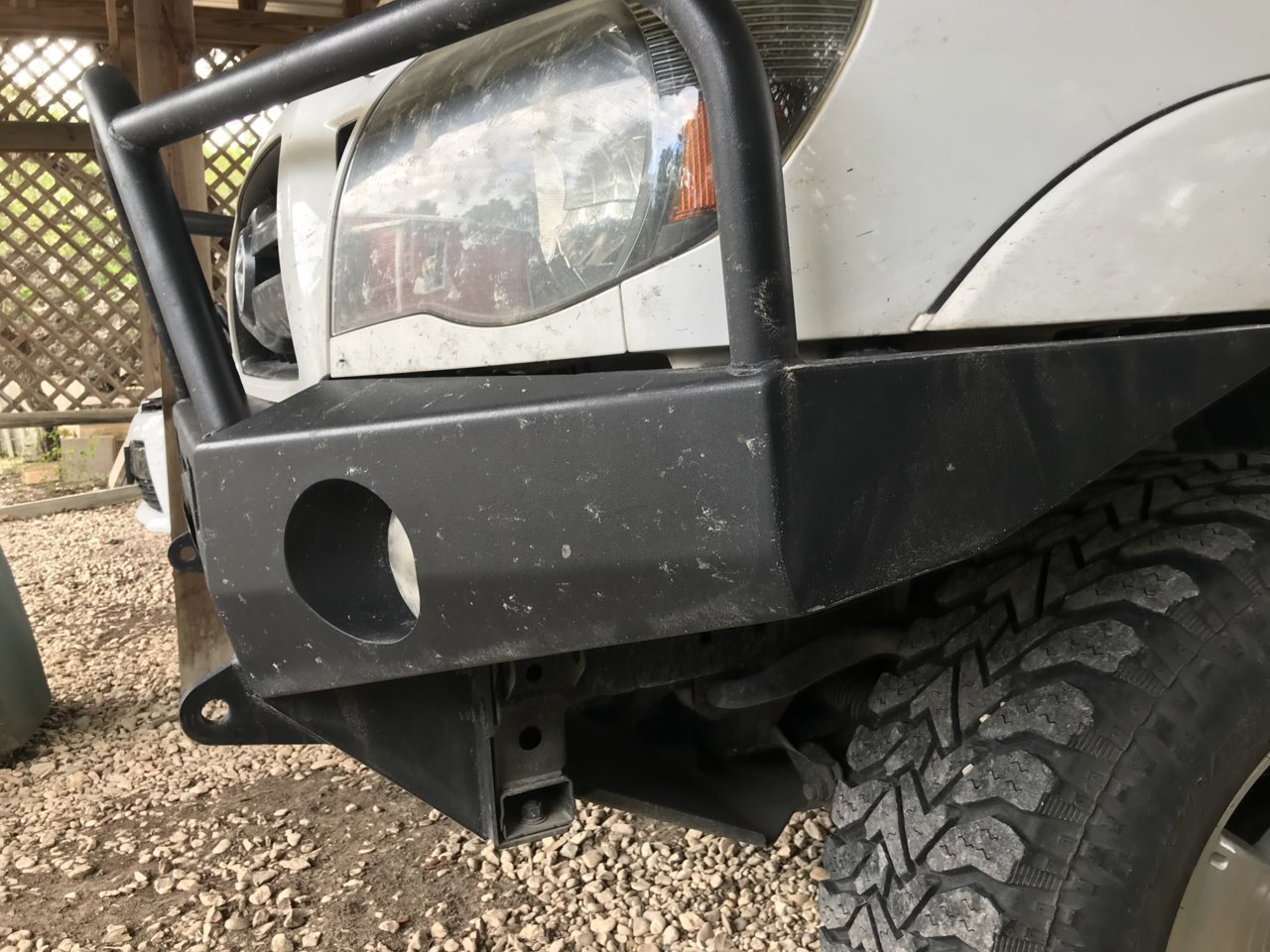

    But I have this bumper

    not at all the place for those lol. @ChadsPride those plates are for the extra bracing, the square ones slide into the from and act as a washer for the bottom side bolts and the oval ones go on the inside of the frame next to the motor for the braces and act as a washer.

    lol bro those are not where those go and if anything gave you a poor fit with leverage areas now. I recommend moving them as there should be zero gap between bumper and truck frame.

    ya no those go in the bottom bolt inside the frame, act as a washer. Your pic of the single nut inside the front frame rail has a good opportunity to pull right through with leverage like that and no washer.

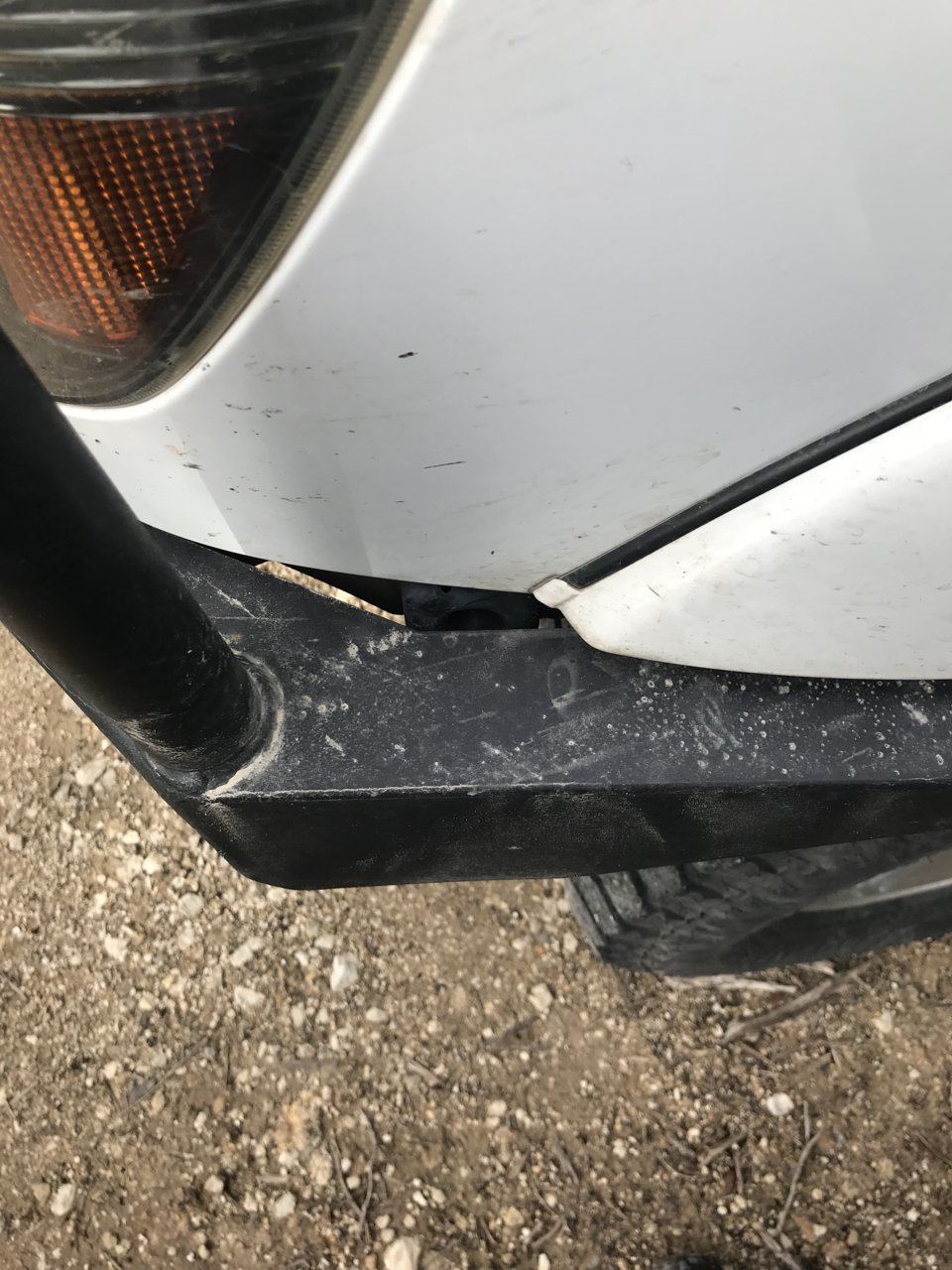

    I think itd cram the chit outta this

    It may not move much bc looking at the previous pictures you kinda bent the wings with the bolts sandwiching that plate in there, they may flatten out when you tighten it up or pound them back then tighten them to the bumper.
