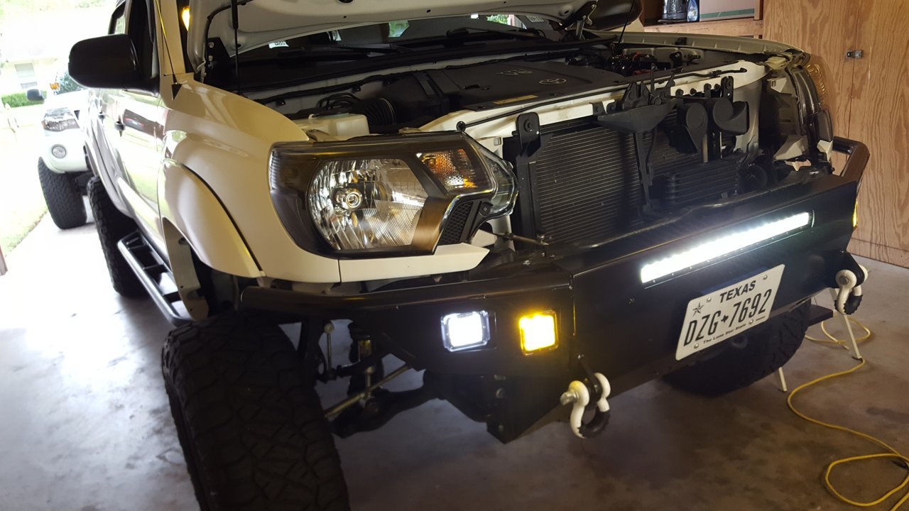

    The Plague....
    6 inch Douche Bag lift...what else do I need?
    I put my HC on a big piece of plywood sitting on two floor jacks. Just pumped both jacks and the bumper moved up and into place. I had some wiggle room with the bumper on the plywood so I could get the bolts in.

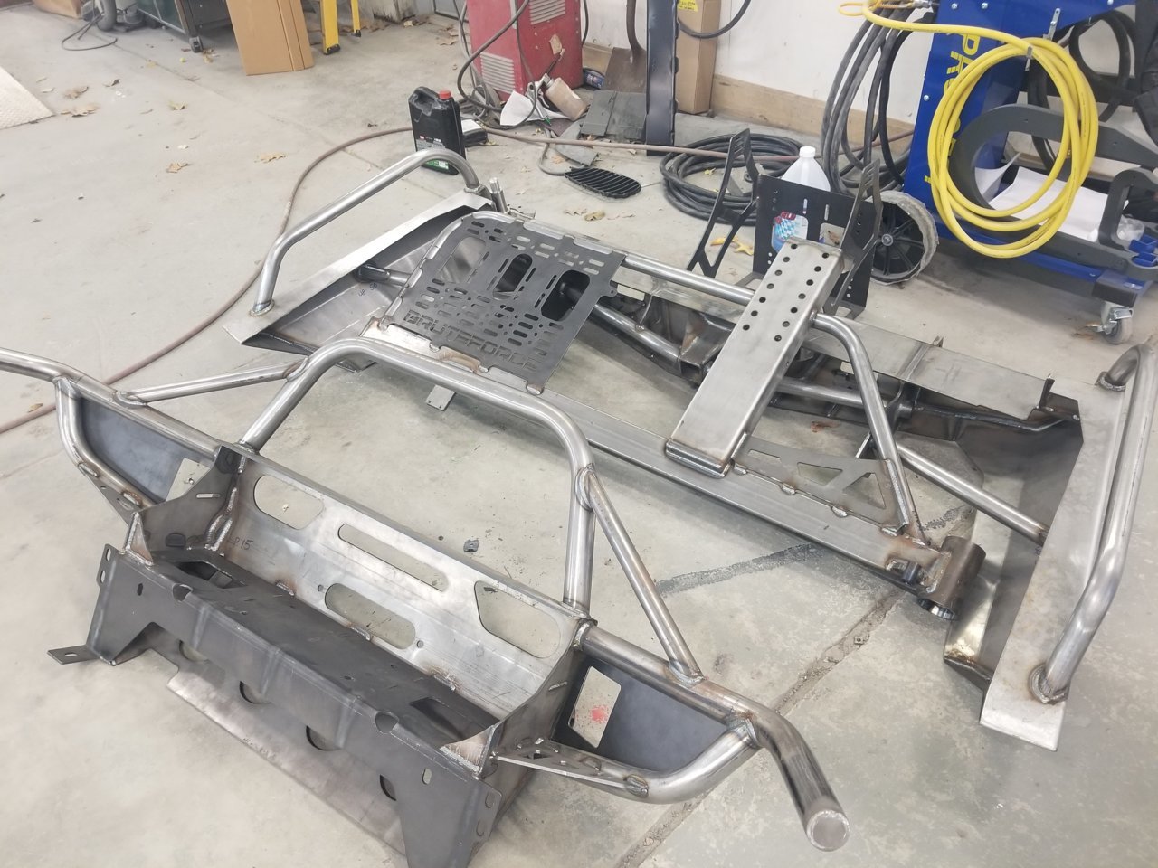

    6 weeks of shipping later.
    Where do these go?

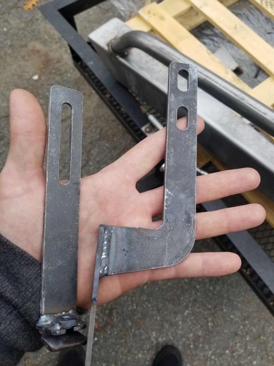

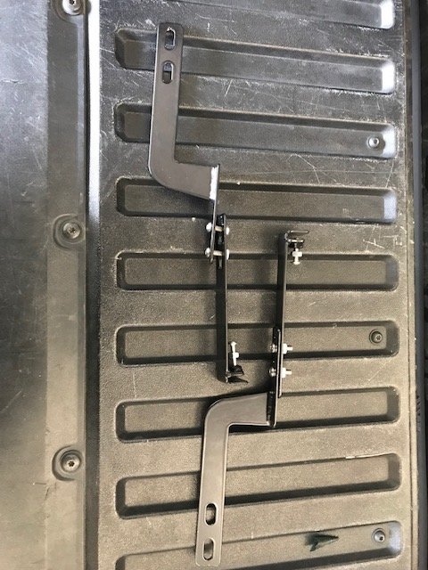

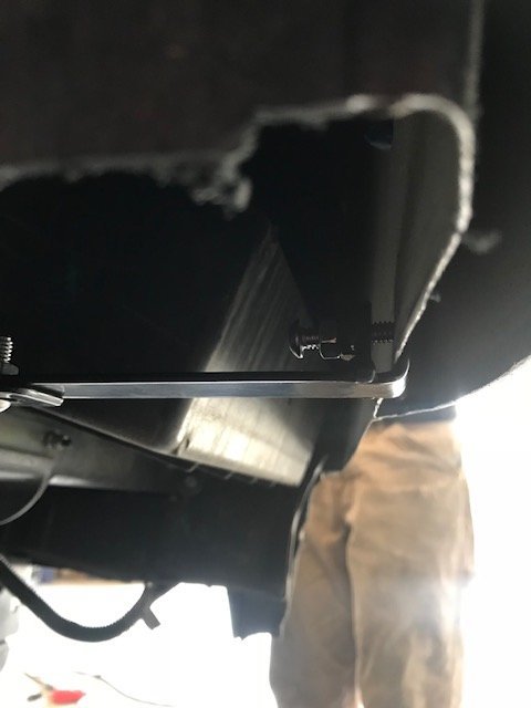

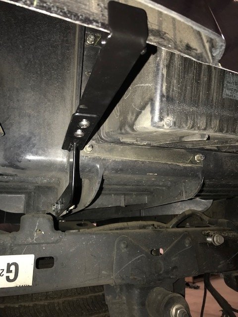

    Bedside supports after you make the cuts

    Emailed billy this morning about install instructions for the HC rear and he sent me a ton of pics

    Now I need to sort through all the hardware haha
    Thanks for the photos!

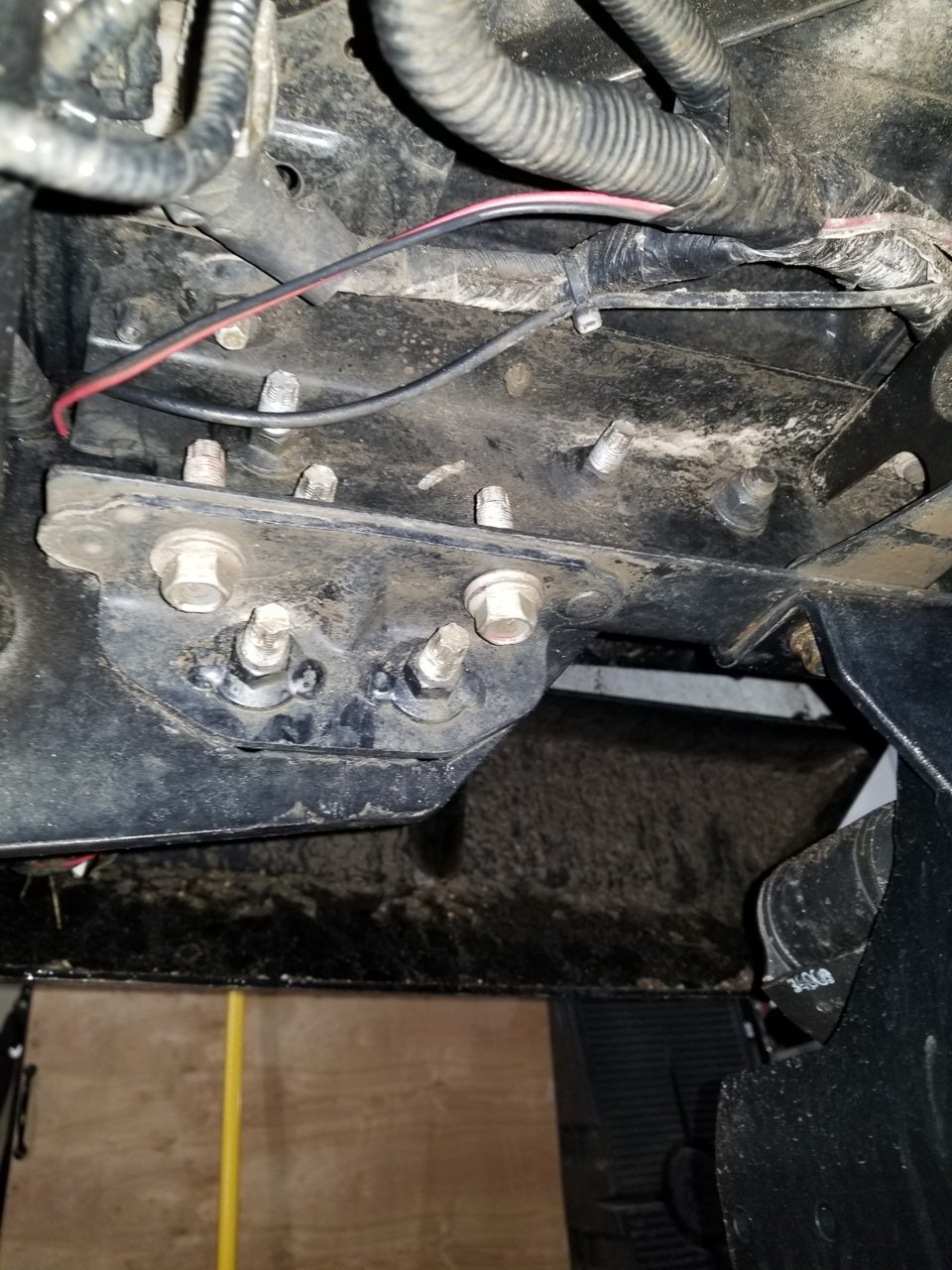

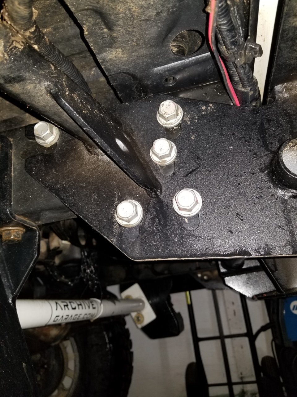

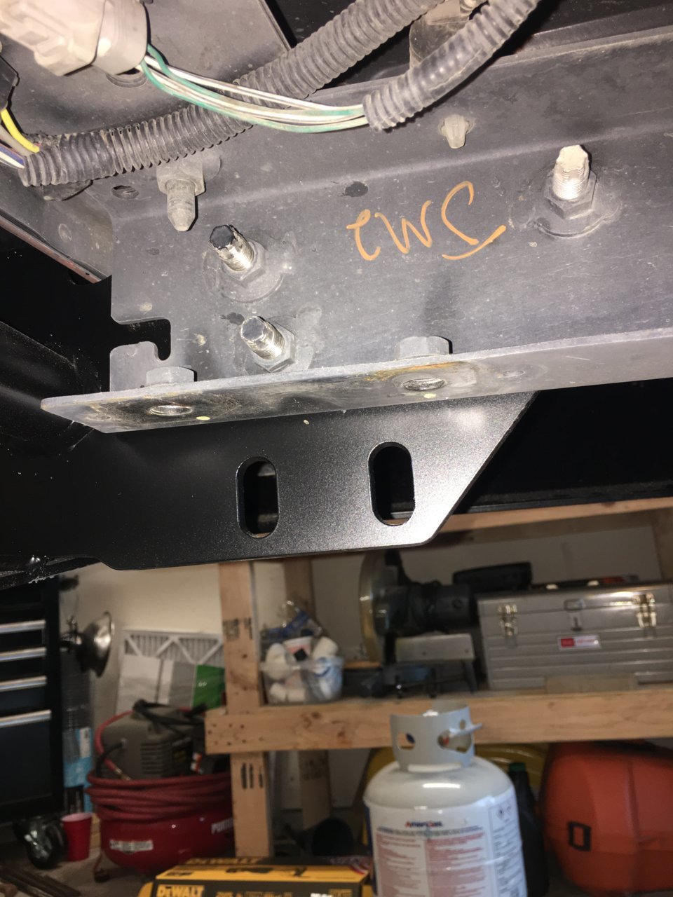

    Were there brackets once here? I had an allpro on before with an integrated hitch, and I cannot find the brackets that I took off.

    Should be a bracket on the frame

    Yup, that’s what I remember now. I can’t find them from when I took them off. Anyone know a part number or do I need to find a salvage yard?

    They look pressed into my frame... Not sure if the earlier 2nd gens were different

    That pressed looking part was basically a pin sticking up through the frame. If you look at my picture closely you can see the holes

    Ahh I see. As a last resort I guess you can get some angle iron and drill some holes and bolt everything up

    Junkyard will have them.

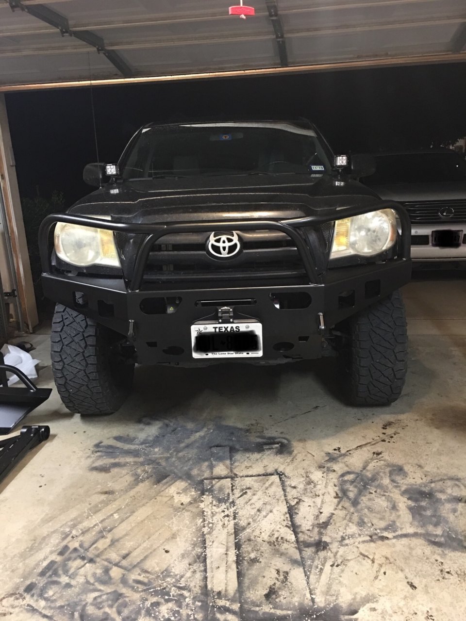

    Yeah, planning on doing that tomorrow. It’s on there though. First cut wasn’t as pretty and straight as it should’ve been but it’s not major enough to pull it off and trim. I’ll make some brackets tomorrow and get the swing out on and call it done

    i had the same issue as you, toyota sells those for 30ish a pop but i had a nice tw member reachout to send me his he wasnt using

    Got the part number, and yeah $30 each. I’ll make my own
