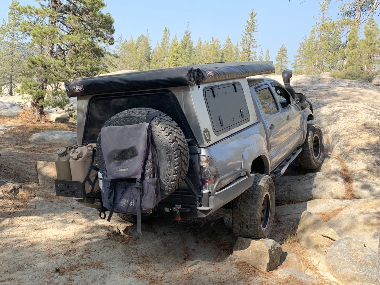

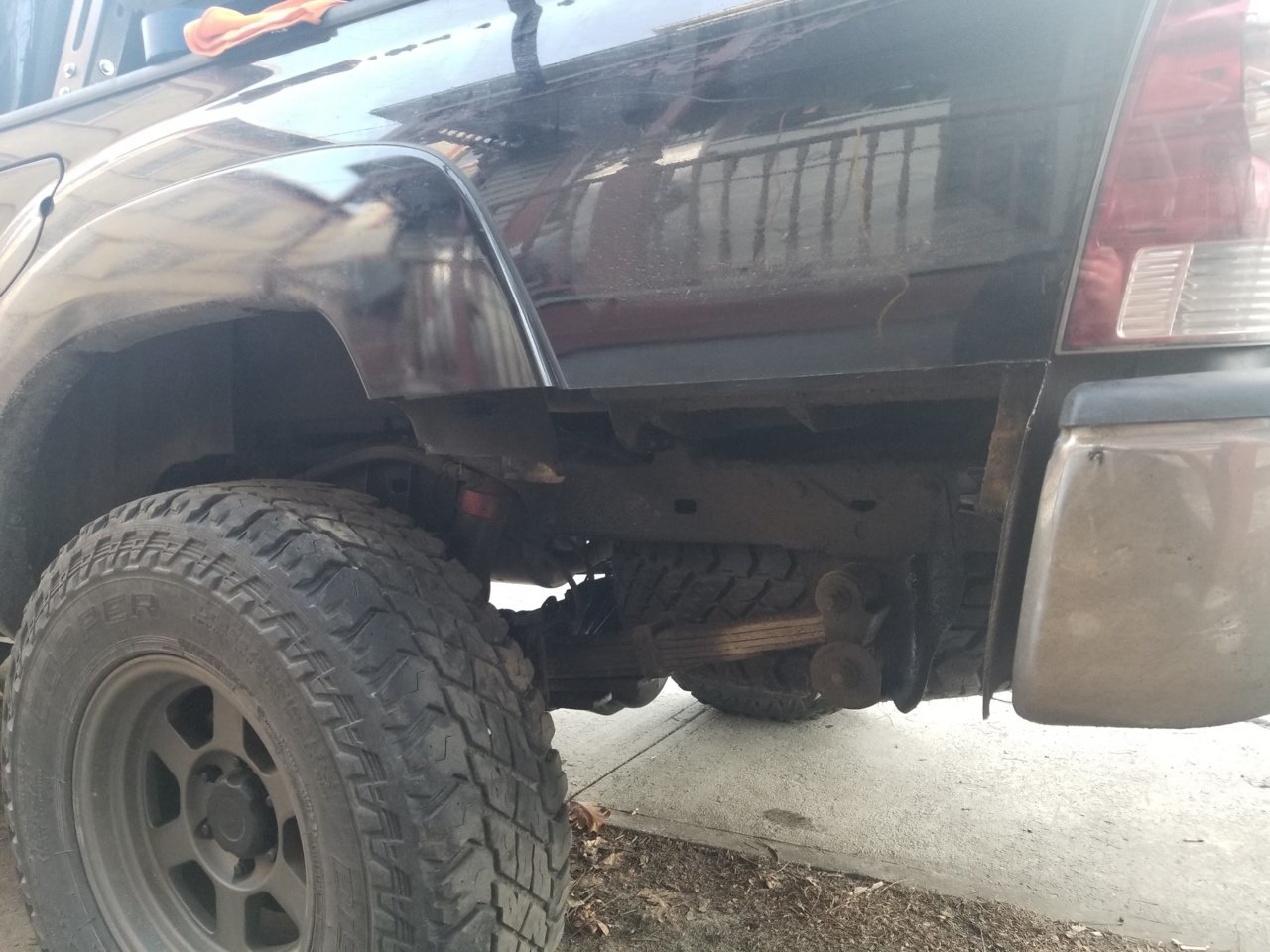

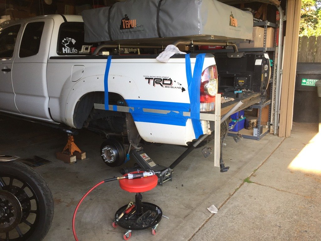

    depends on how shaky your hands are when cutting your bedsides off :D
    mine
    237AC67B-CD4C-497B-A367-3F5B5BFB734E_zps_e42d498dff7af68a87ffe76f642bfd385837fd35.jpg
    3E11EB33-3848-431F-8FF8-3FE1FB519F30_zps_81443b17ead2a68fc226471814cd282be29ee1ab.jpg

  10. Feb 10, 2019 at 1:41 PM
    #3170
    inesshell
    inesshell blah blah blah
    Aug 2, 2011
    #60986
    7,164
    All stock Superwhite 10' AC

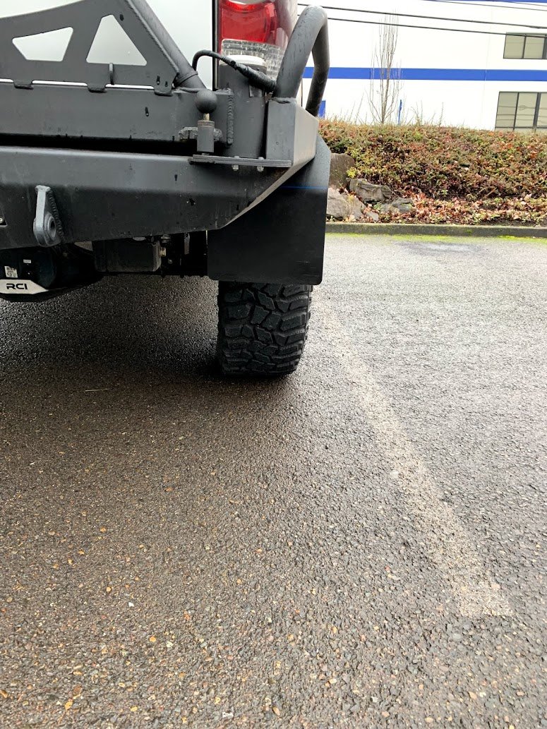

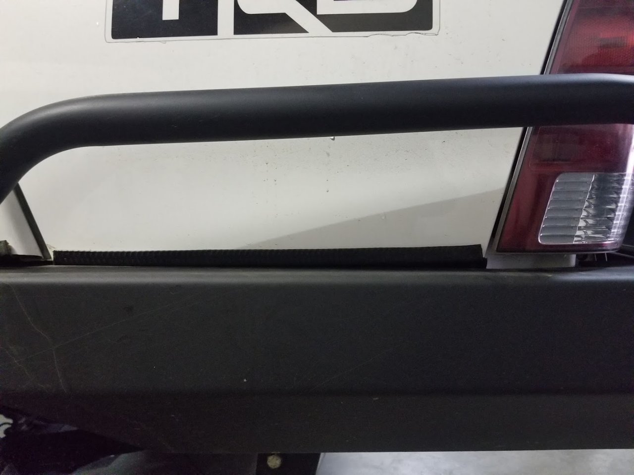

    grind the top of the mounting plate on the bumper so you can bring it closer to the bed, its hard to get pics of it already on the truck, just look at where your bumper mounts and you will see why
    i have edge trim on mine but you get the overall picture
    p_D0nczD1q4tWRB1u2pV7HEHOlFxA1z7yL3vGd76_50ae293ed2440632576619f004d59c3bc845cc9c.jpg
    OverlAnderson[QUOTED] likes this.

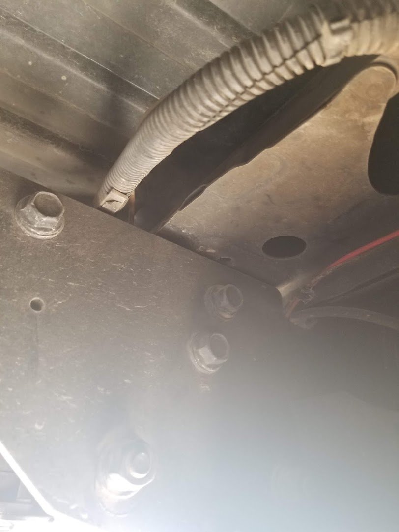

  12. Feb 10, 2019 at 2:01 PM
    #3172
    inesshell
    Aug 2, 2011
    #60986
    7,164

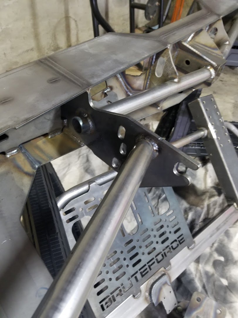

    1MTZO2MWdEllMYAEHmiNB4PEZau_G2CXUyAnTKUy_7e26223a02be02b6d41ae35eae63b7de2544fa4d.jpg
    this is what you are grinding, mostly where the back slotted hole to the side pipe supports is a upper metal plate that stop s the bumper from going higher

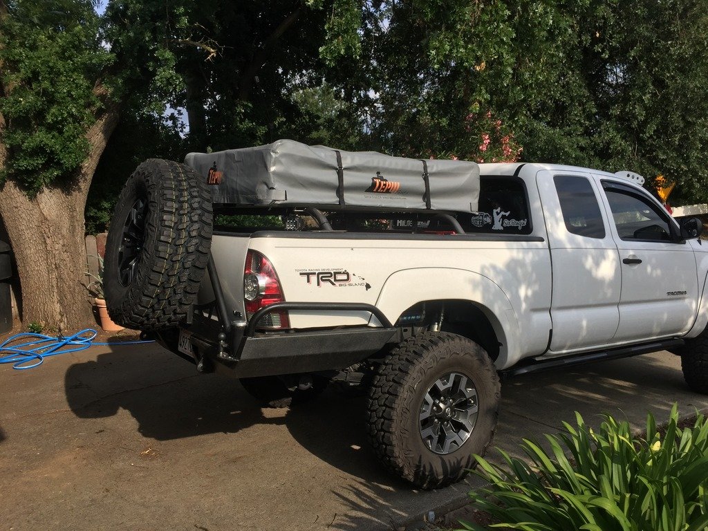

    It all depends on where each person made their cut to the bedside. They will all be slightly different.DC906FAD-F37A-4F69-B618-1FD45F62ABCF.jpg 50023F6B-514B-4B3C-9D5D-812D61501E2D.jpg
  14. Feb 10, 2019 at 2:04 PM
    #3174
    inesshell
    Aug 2, 2011
    #60986
    7,164

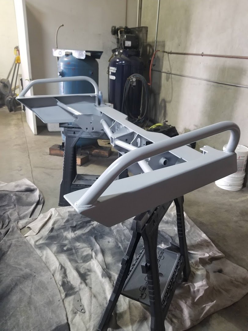

    see how my grind isnt much, but it allows your bumper to move much higher up to reduce the gap between the bumper and light
    3Fw4vymzmt5kt73XHJJB4W2BavmX_NKgB8HCwJ8n_0bde6b3e079e10bc2c81ecf8ea5028df4051a318.jpg

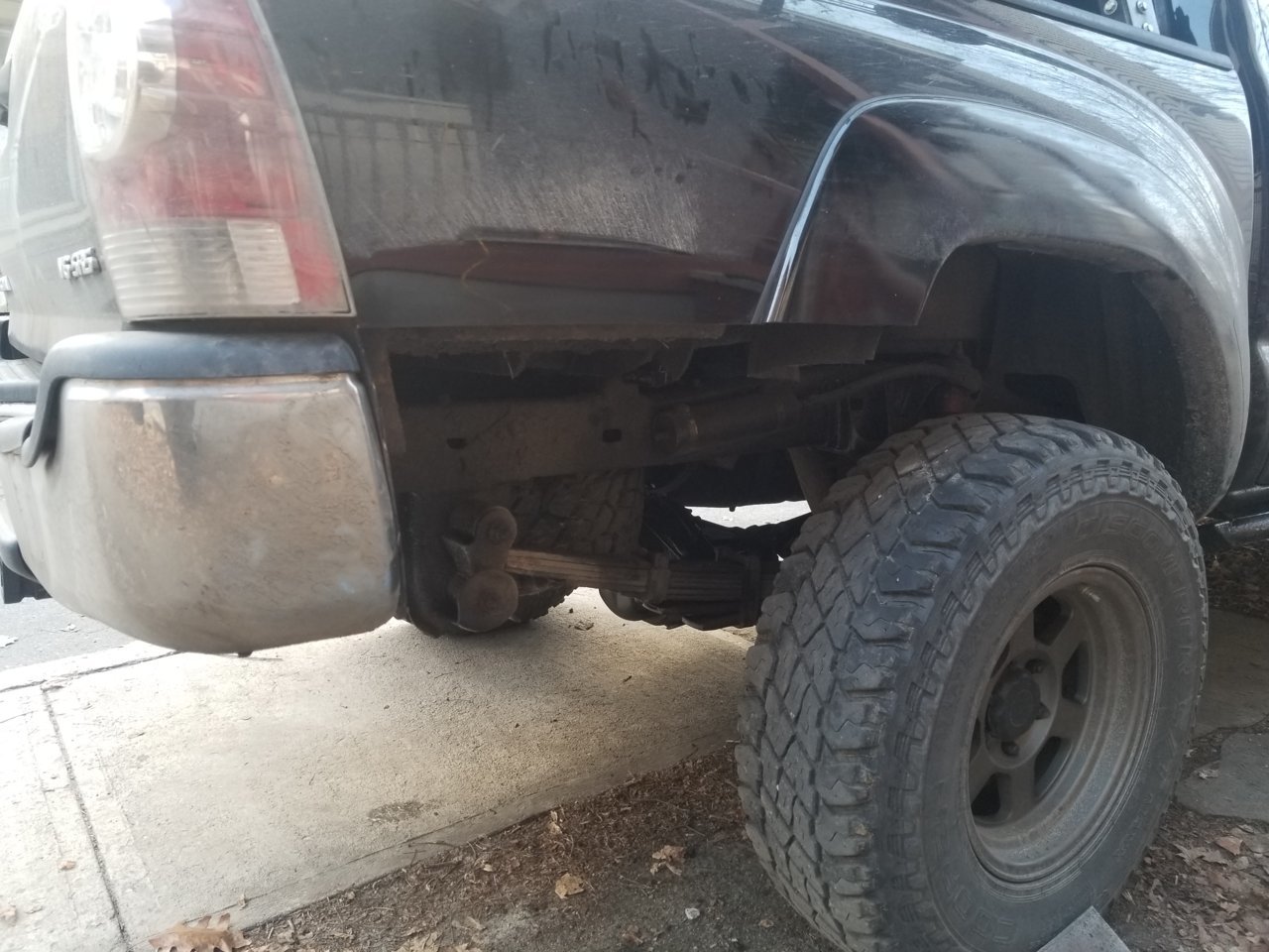

    ive done about 10 hc bumpers for people and on every one this is what stops fully adjusting in that gap.. and most cut flush down with the line of the taillight
    Fjw4Sr4-W6Y5PN1XZav5HbMi4-Y94gXiF3GJR7gn_b4e3a9cf5c045fc15ea3d2f828995473d0cc6770.jpg
    @Mugshot89 i had to dig deep in my cloud to find this photo of my last bumper to show you what im talking about

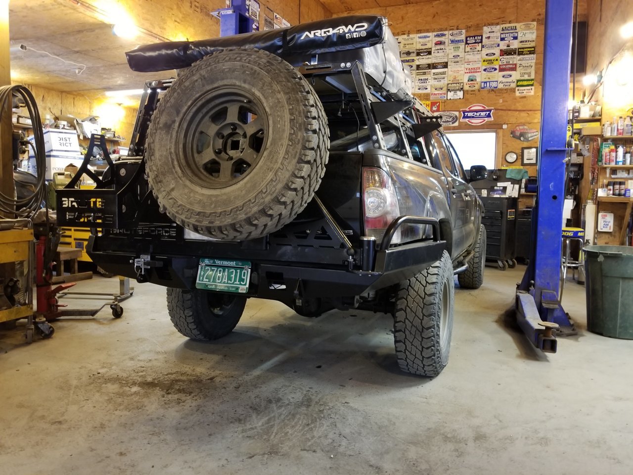

    Just depends on how you cut it like everyone said. I need to add some edge trim but the gap isnt huge. Went by what Billy recommend and went straight across.

  18. Feb 11, 2019 at 10:29 AM
    #3178
    OverlAnderson
    OverlAnderson A dude playing a dude disguised as another dude
    Sep 23, 2017
    #230862
    2,125
    Anderson
    San Antonio, Tx
    14 TRDS DCSB 4X4
    stuff and things
    ah ok this makes perfect sense now. you grind down the piece that lines up to those bolts up on the frame, that is also limiting the up travel because it hits the top part of the frame. thanks for that man ill have to do this when I get mine
    :cheers:

    stuff and things

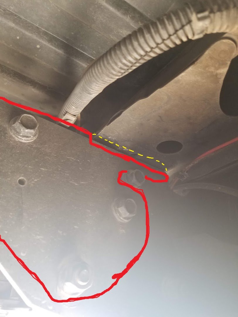

    @inesshell so....when "drawn with crayon" for those like myself who like it simplified this is what you ground down to make fit flush. My apologies for the aggravation I must cause with my over inquisitive self. I just wanted to be crystal... it looks as though the 3 bolts line up a little different than my illustration but I get the jist of it
    tacomgee likes this.
  20. Feb 11, 2019 at 3:08 PM
    #3180
    inesshell
    Aug 2, 2011
    #60986
    7,164
    You would grind off on the back portion since that bar is on the rear of the bed, not the single bolt towards the cab
