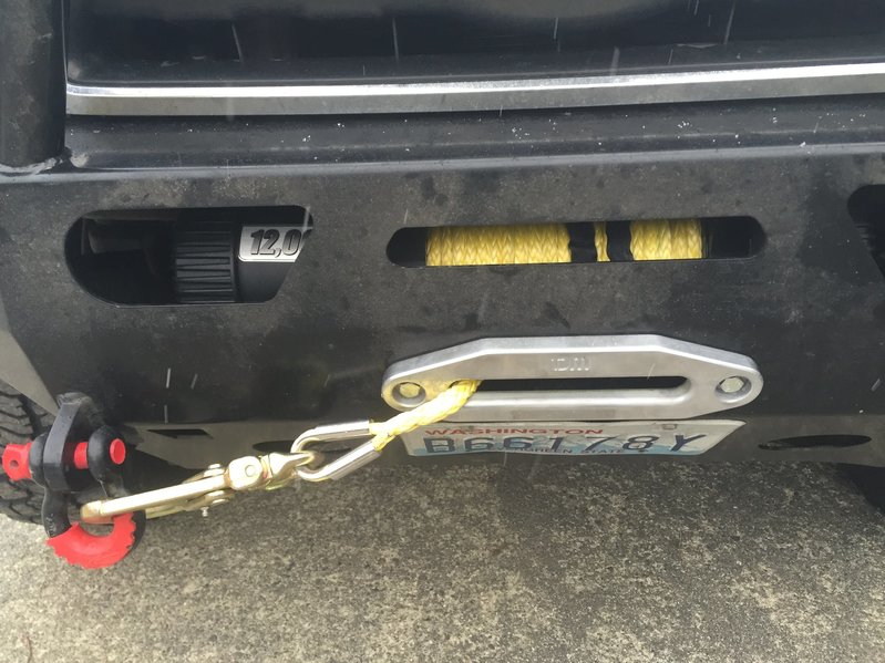

    Mounted a TJM stealth 12k winch today with plenty of room to spare, could fit the 15k if you wanted. Only thing I had to do was relocate the solenoid like every winch, but TJM has the copper plates (supposed to be wires) that go from the winch motor to solenoid so short, had Napa make 30" 4 gauge wires so I could mount the box on the opposite side. Plenty of room! Pretty sure I'm the only one with a 12k pound winch.. that i've seen. Pics tomorrow

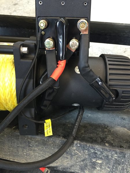

    The 3 copper plates are the lines you need to extend, they have the black rubber boots on them. $30 at Napa for them to extend to 30" in 4 gauge wire. Also the 10 gauge black wire on the top left, other than that it's a direct bolt on. Love it!

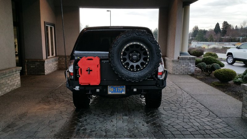

    No winch installed yet, trying to save up so I can have dual warn 10s platinums but soooon. Will Def upload more pics once I get it put in. But all in all extremely happy with this bumper. Did alot of research on the different options for are truck and hands down I feel this is the best looking!

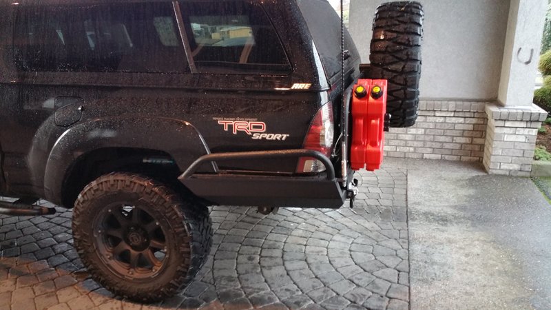

    Is that 2 gal jugs or 3 gal jugs? Looks like 2 to me?

    2 gal
