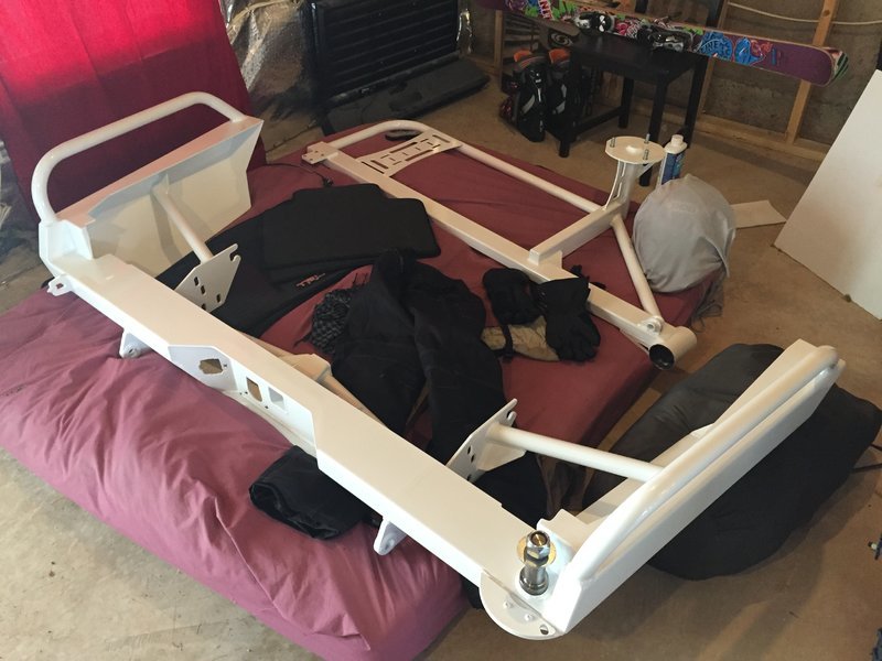

    Is white your final color?
    Did yours ship bare metal?
    What paint did you use?
    Thanks.

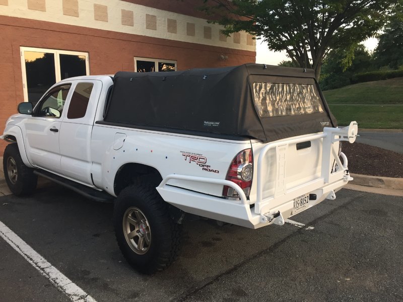

  6. Sep 5, 2016 at 8:56 AM
    #1246
    fatfurious2
    Jun 28, 2014
    #132884
    49,822
    David
    Ashburn, VA
    2010 TRD OR Access Cab
    Yes final color is white. Shipped bare metal, then went straight to powdercoat, its not spray painted.
    ChadsPride, ERMB and Crom[QUOTED] like this.

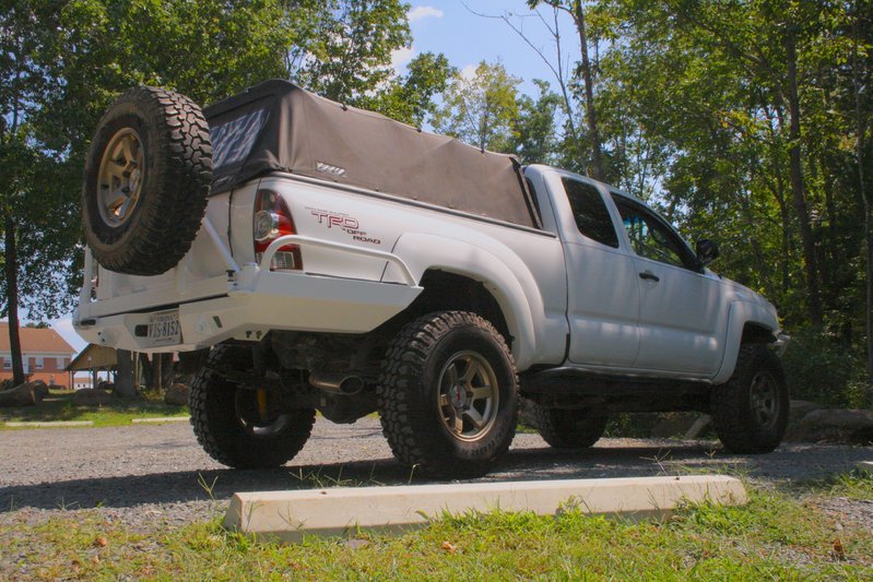

  8. Sep 5, 2016 at 4:55 PM
    #1248
    fatfurious2
    Jun 28, 2014
    #132884
    49,822
    David
    Ashburn, VA
    Crappy photo.. Nicer ones coming tomorrow
    Crom, 4x4Taco09, PPansini10 and 6 others like this.

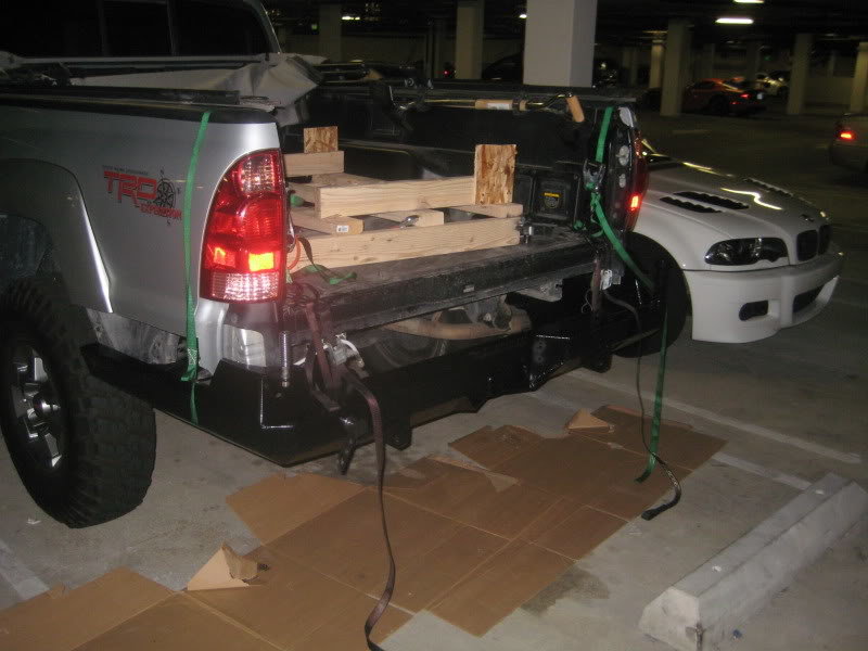

    For the people installing attempting to install a HC bumper on their own. These are the things that I wish I knew before I installed mine and since I didn't notice anyone posting these things, here are my thoughts based on experience.
    Since there is some other good how to info on the forum if you do a search. You already know the basics. Remove your factory bumper, cut rear fenders and install new bumper but here are a few things I didn't recall anyone mentioning...
    1. Recruit a couple of buddies to help! Two strong guys and spotter is recommended. The HC bumpers are heavy! I installed mine on my own with the occasional help with my wife to balance the bumper on a trusty garage jack. I had to go into McGuyver mode to figure our how to get more lift. I'm not really going to get into what I did but it included a pallet and pair of Rhino ramps and was NOT SAFE and NOT recommened. No fun asking the wife to try to balance the HC bumper on the 3 inch jack plate and surprised the bumper didn't fall on my head.
    2. Have a thin/somewhat flexible straight edge available to draw the line for the dreaded "cut". I thought I could make the cut with the flares in place and I spent over an hour marking and drawing lines on the masking tape, wasting a lot of time. The lines ended up looking like I was on crack having a seizure! I ended up taking off the flares and removing/replacing the masking tape and making three marks... the edge of the fender, the middle point and a hair below the corner of the tail light and connected the three points with the flexible straight edge. I used a two by four laid across the top of my bed rails as a "controlled" reference point to measure down as I marked my three points so the line would be parallel to the top of the bed. Easy peasy.
    3. Have new fender flare clips (blue and orange) in hand. You will break most of them when you pull the rear flares off when making the "cut". It will be easier to reinstall the flares after you make the cut (while the bumper is off) to see where you will need to trim the flares.
    4. Linex is cool (to me) but it adds thickness. If you have similar types of rubberized coatings, you will need to grind that shit off since Billy's bumpers fit spot on. Removing this crap from every single contact point is not fun even with a angle grinder and stripper wheel.
    Good luck.

    Thanks for the tips
    That sounds like a crazy install.
    I always liked this self install with ratchet straps:
    https://www.tacomaworld.com/threads/barlowrs-06-taco-expo-build-thread.74926/page-4#post-1955658
    How about a picture of your new bumper?

  12. Sep 6, 2016 at 11:48 AM
    #1252
    fatfurious2
    Jun 28, 2014
    #132884
    49,822
    David
    Ashburn, VA
    Heres a much better photo of mine:
