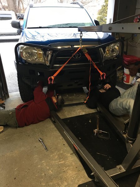

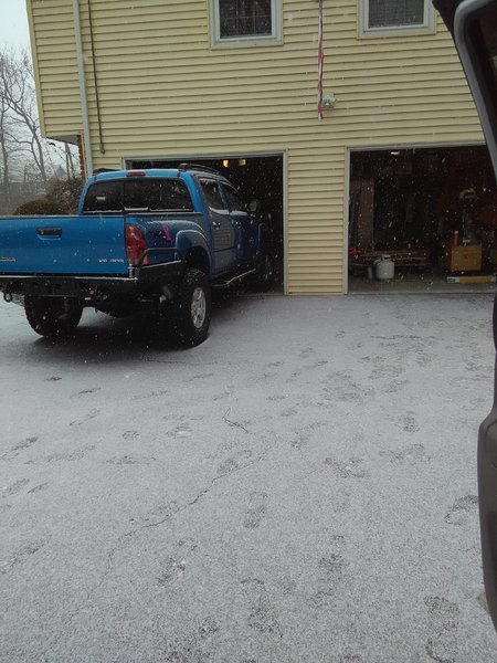

    Installed in 20 degrees. By the time we were done, 3" of snow outside.
    Engine hoist helped a lot! Thanks @HolyHandGrenade for lending this fine piece of equipment.

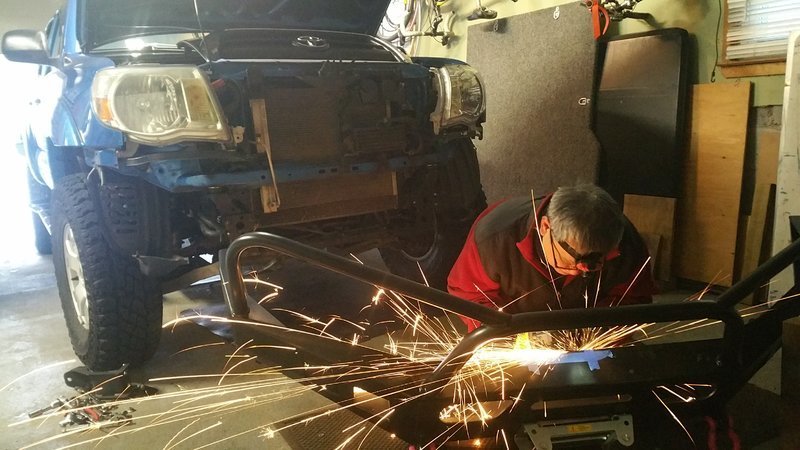

    Had to grind some of the BFF steel to gain clearance for the winch controller.

    You had to drop your skid for install?

    Yup. RCI skid has a upward bend/lip at the leading edge of the IFS skid that interferes with the lower part of the bumper.

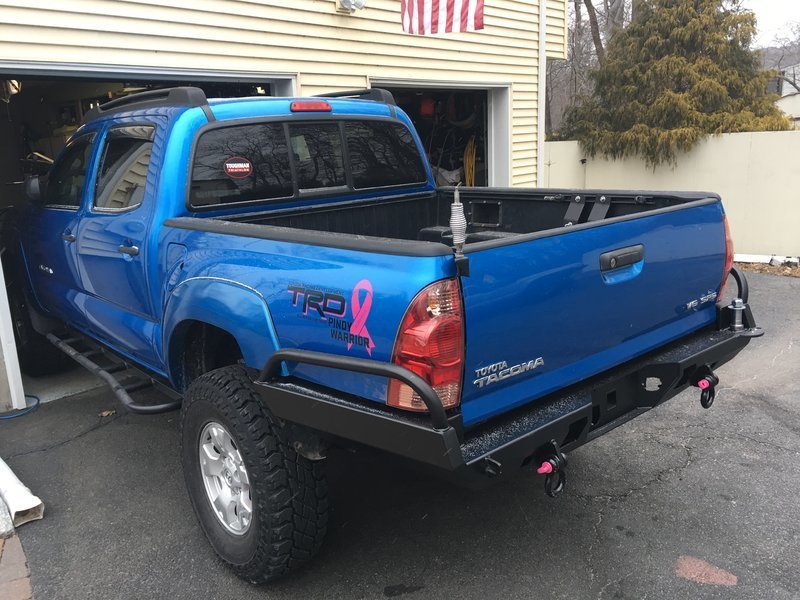

    I rattle canned my BFF Bumpers.
    But didn't do anything to the aluminum fold-down table because I don't have a clue what finish to use:
    1. Because it's aluminum, any type of special prep required. Special primer and paint?
    2. Because it's gonna be a utility table, with camp stove and stuff on top of it, I'm looking for a durable finish that is abrasion resistant and is an easy wipe down.
    Any suggestions fellow BFF fans?

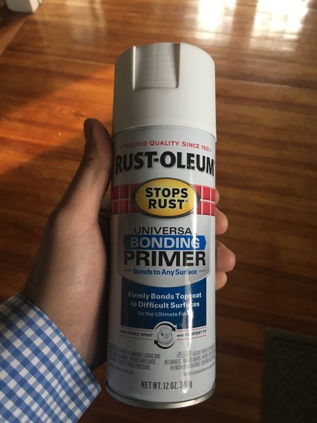

    Rustoleum Primer Enamel. You can find it in lowes or homedepot. Then I'd use the high heat rustoleum for BBQ etc
    I'll attach a pic of the primer shortly

    I personally like the contrast, it being a table in silver and the black being the bumper swing out...
    either way, looks great, love the recessed lights in the rear bumper

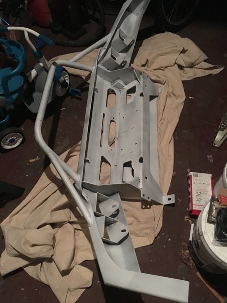

    Primer

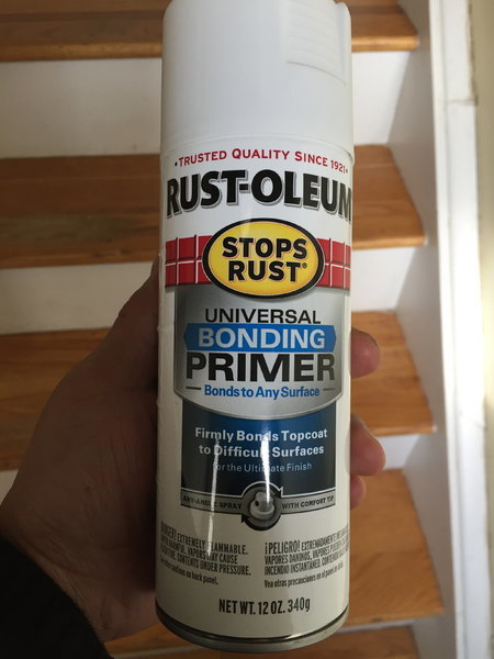

    It's grey when it goes on. This was 3/4 of a coat. I'll be spraying the back of the bumper in its entirety tonight.

    Damn. I have that. It was for a Honey-Do project that I never got around to doing. LOL

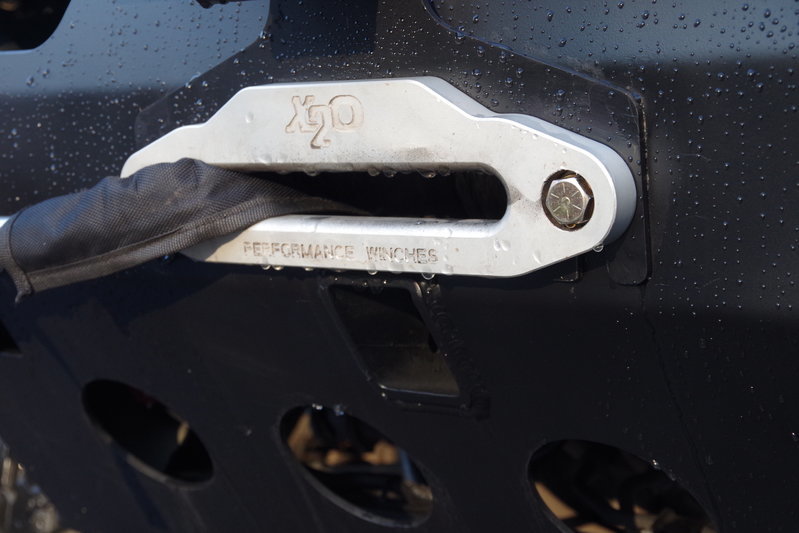

    Look below my Hawse Fairlead. I got Billy to fab up a custom 2" receiver for my front bumper :)
