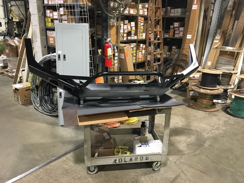

    50% rattle canned I will get more pics once cured

  5. Jan 12, 2017 at 6:20 AM

    Kind of leaning towards rattle canning this beast.
    I just want to get an even finish ya know.

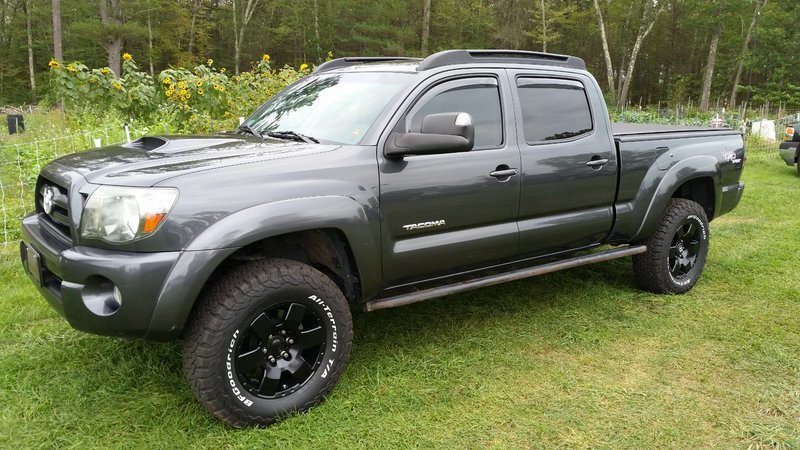

    I do think my wheels came out nice though
