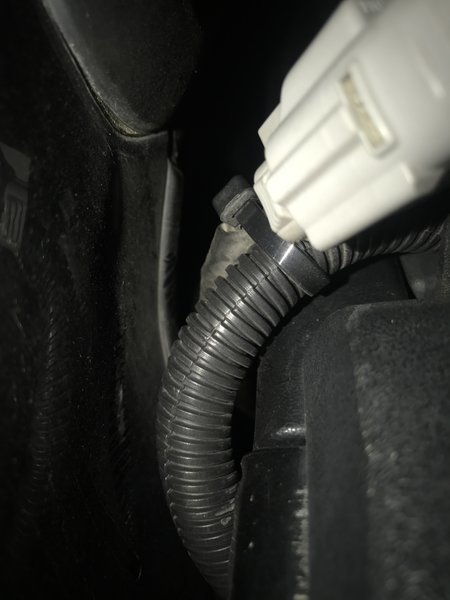

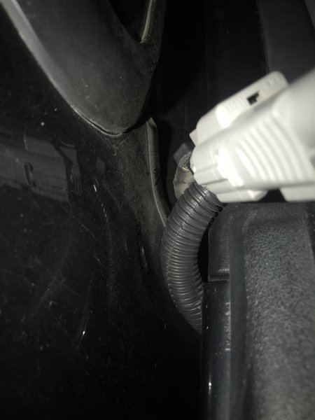

    Take a close look at the top edge of the front of the bed where it meets the cab beneath the rear glass. If there was any flex in the frame, that's where it would show itself. Also take a look at the body gap between the bed and cab and as long as it's an even width top to bottom on both sides, then I'd say you're golden.
    I had a buddy that was rear ended with his steel rear bumper and the bed made contact with the back of the cab beneath the glass and left a small dent. After the accident, it looked fine until he started looking really close at the gaps and noticed the dent.
    I'm not telling you this to scare you, just giving you a heads up on what to check for. Hopefully yours is OK if the impact wasn't too hard.

    Well it's definitely a larger gap. I distinctly remember looking at this area on my lunch and there was no gap. You can see from the pic where the wire harness was touching the cab and wore the paint down. :(:(

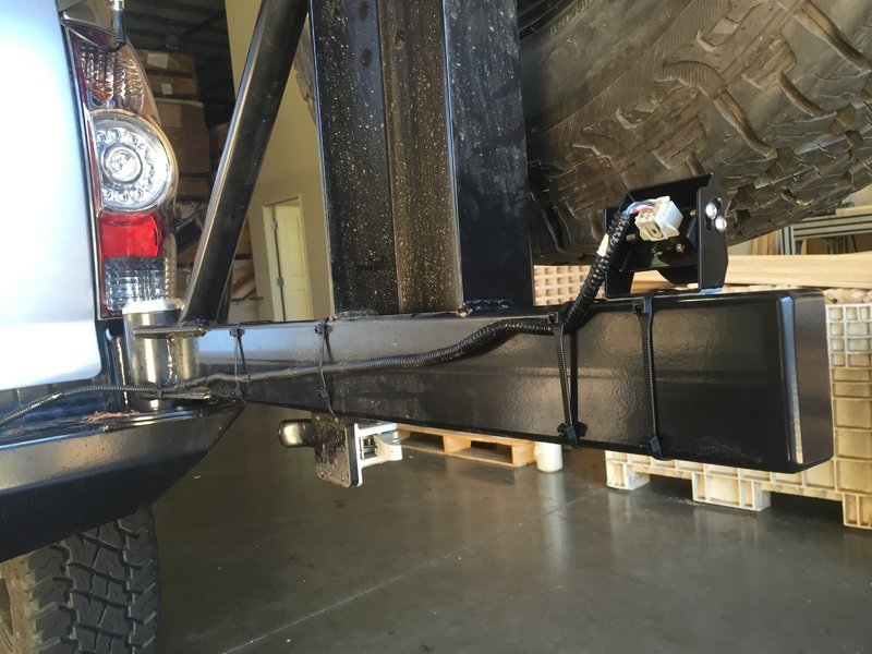

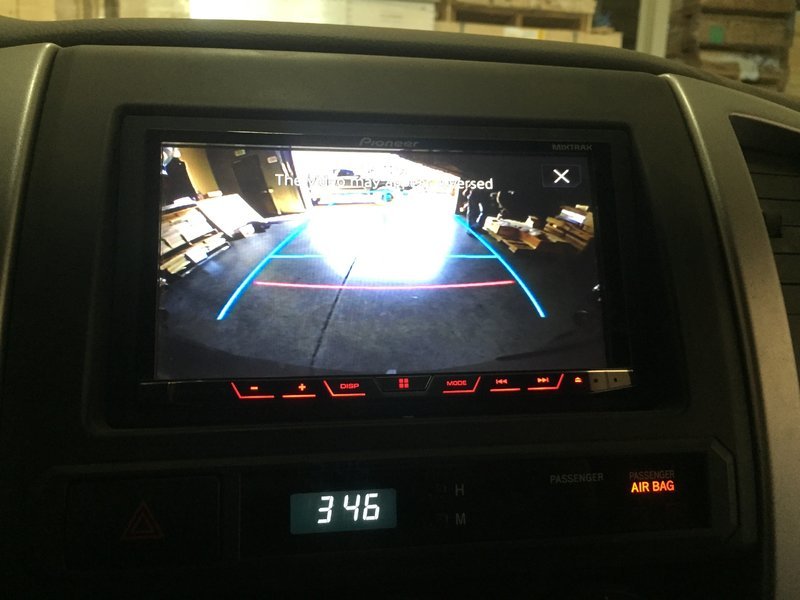

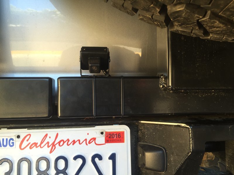

    I have a question for those of you that have a dual swing out. Where are you guys putting your backup camera? (If you have one)

    I used permanent hold double sided tape to hold it. And thre on a zip-tie to help hold it and the wires. Works great. No issues. Just have to adjust it properly.
