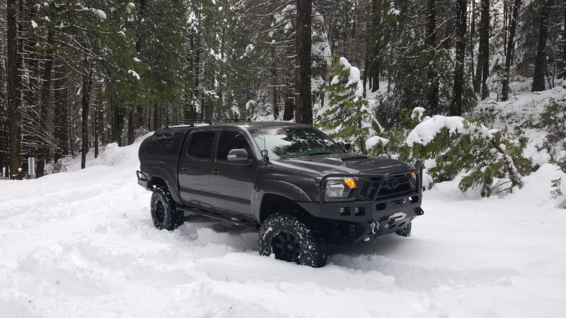

    I have but im local. I wouldnt recommend any products of that size to be powdercoated and shipped if thats what youre doing but i doubt billy ships powdercoated armor knowkng the probable cause of damage during shipment.
    In conclusion im happy with billys powdercoater. I got a semigloss powdercoat finish 20170121_153750.jpg 20170121_153819.jpg
