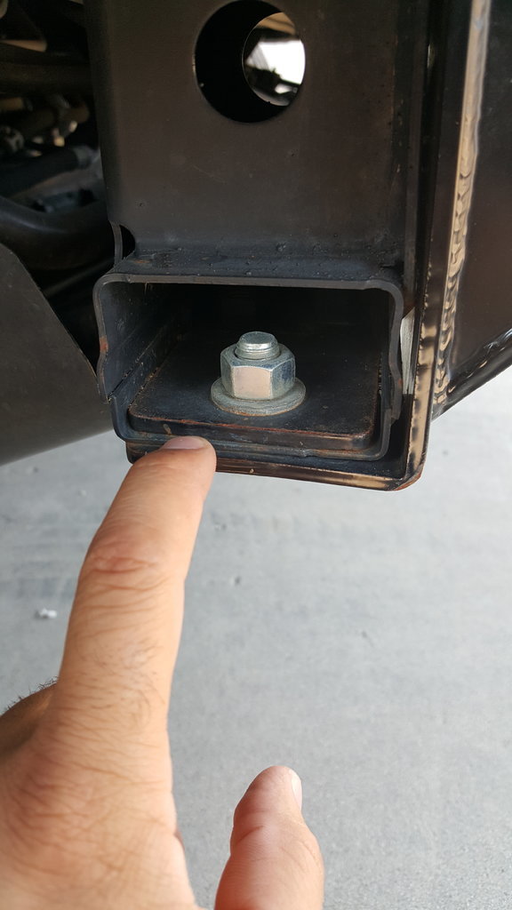

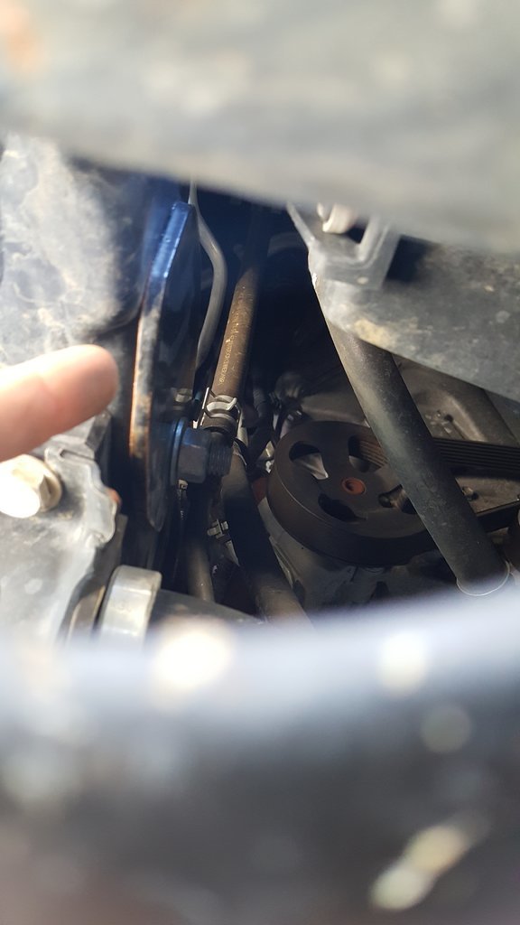

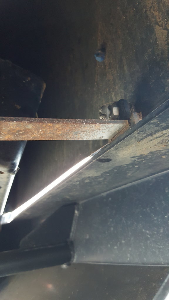

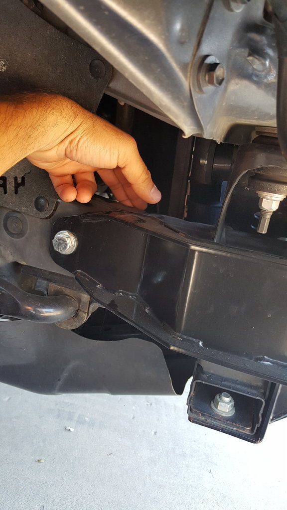

    Hope this helps...
    1 plate that goes on your slider locking pin so you can easily remove it and touch it up with paint.
    2 plates go with your support brackets to support your frame from the inside.
    2 plates support the front end brace of your bumper.

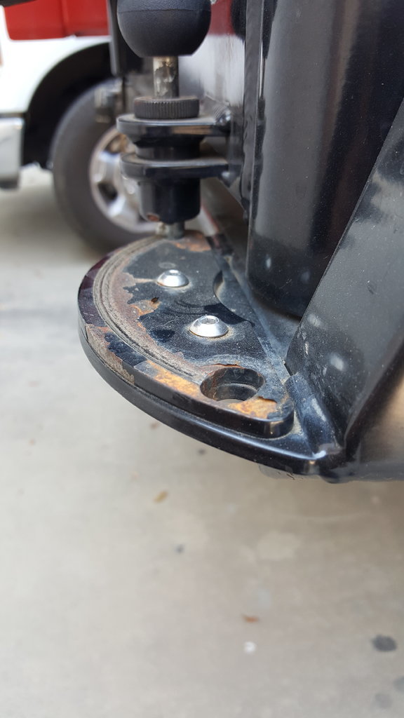

    Almost forgot the fender support brackets

    That's perfect @Alfred pictures are worth a thousand words with something like this
