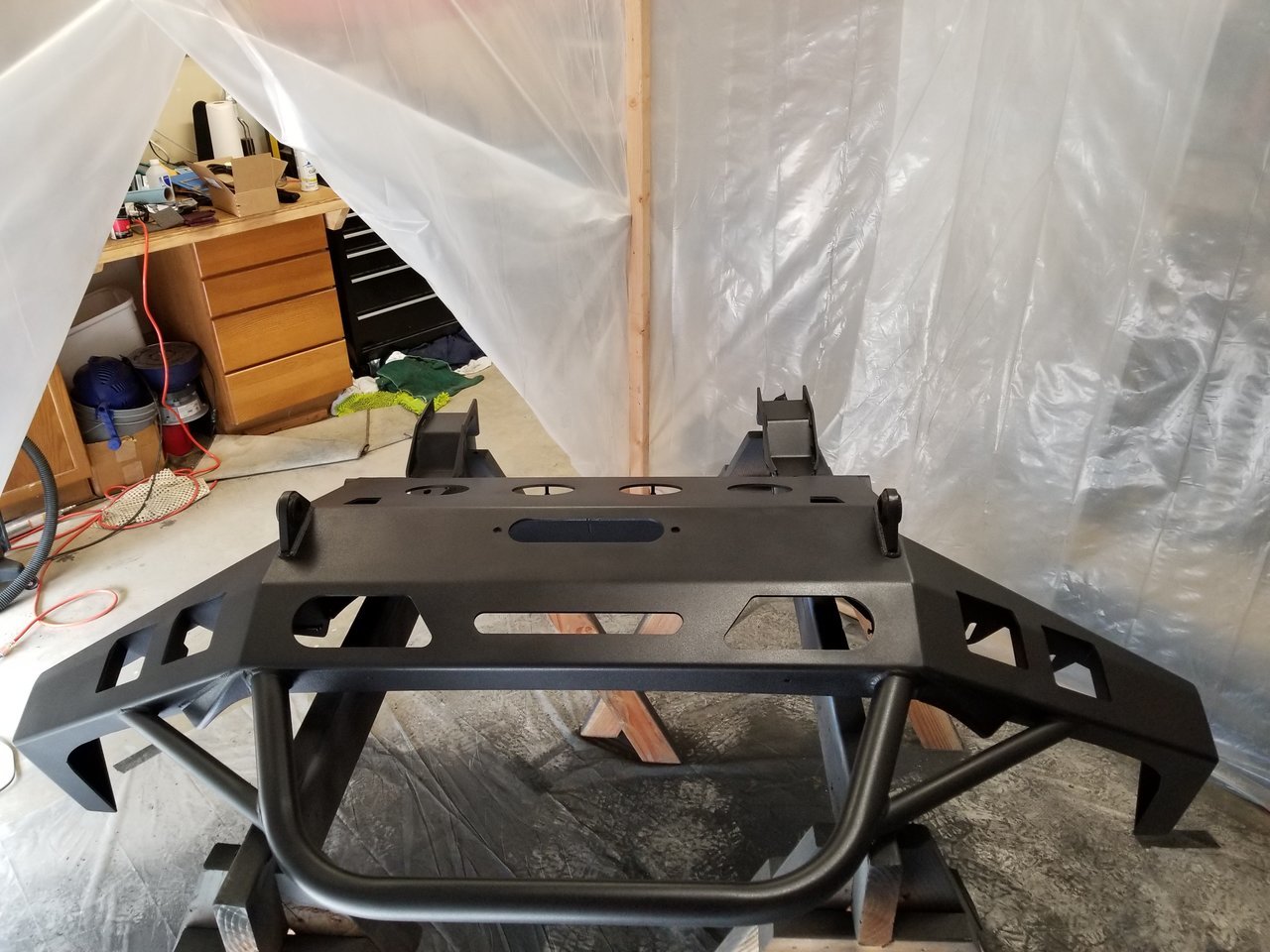

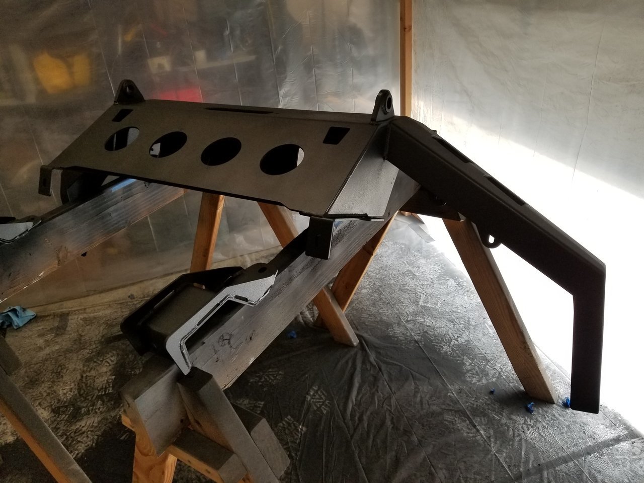

    Yeah, I'm pretty sure I went completely overboard but I figure it's better to start with a good base and when I need to touch it up hopefully it will be minimal. Here are some pictures of the front bumper after the first coat on the face of it this morning.

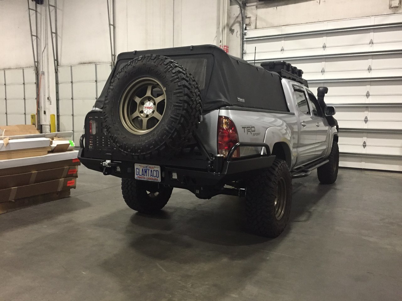

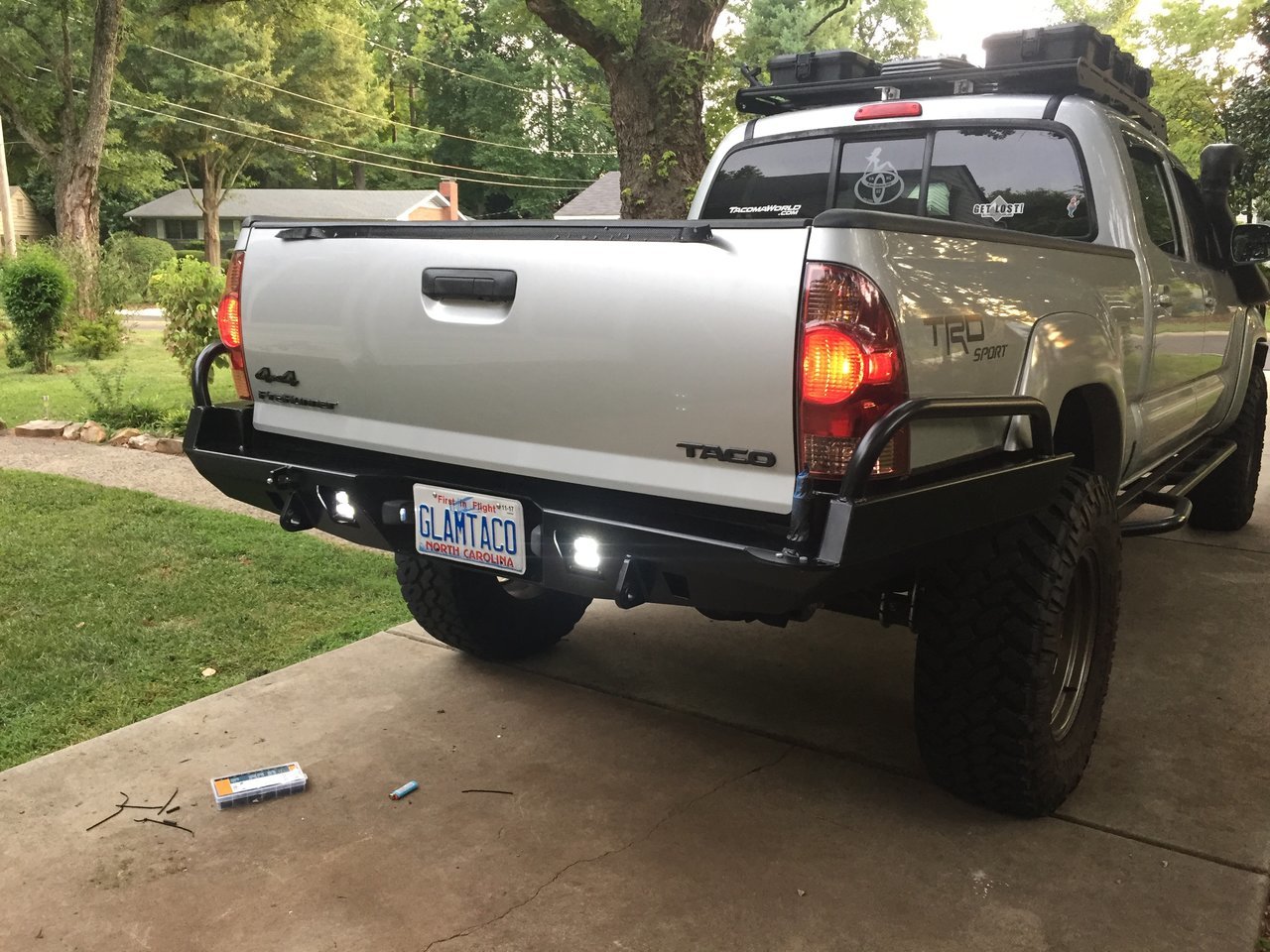

  16. Aug 3, 2017 at 5:34 PM
    #1976
    ajohnson
    ajohnson Glamour Shot
    Apr 19, 2009
    #16145
    8,496
    Andy
    Charlotte, NC
    07 DCLB TRD Sport Prerunner 4x4
    Things and stuff and such
    Got the bumper mounted today. Forget to get a socket for the spindle nut :facepalm: and can't find one local, ordered one and will get the swingout mounted tomorrow. I used a $20 rugged ridge flip license frame for a jeep but the mounting holes are different, had to drill holes for that.
