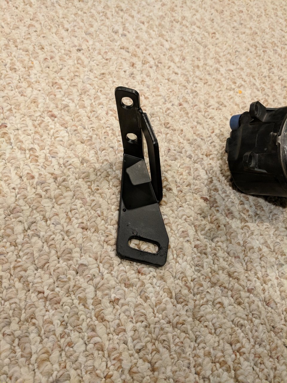

    That is not the correct bracket for a moab 2.0 that bracket can work with the moab but you may not have all the adjustment you need. Give us a call and I will get you the right ones.

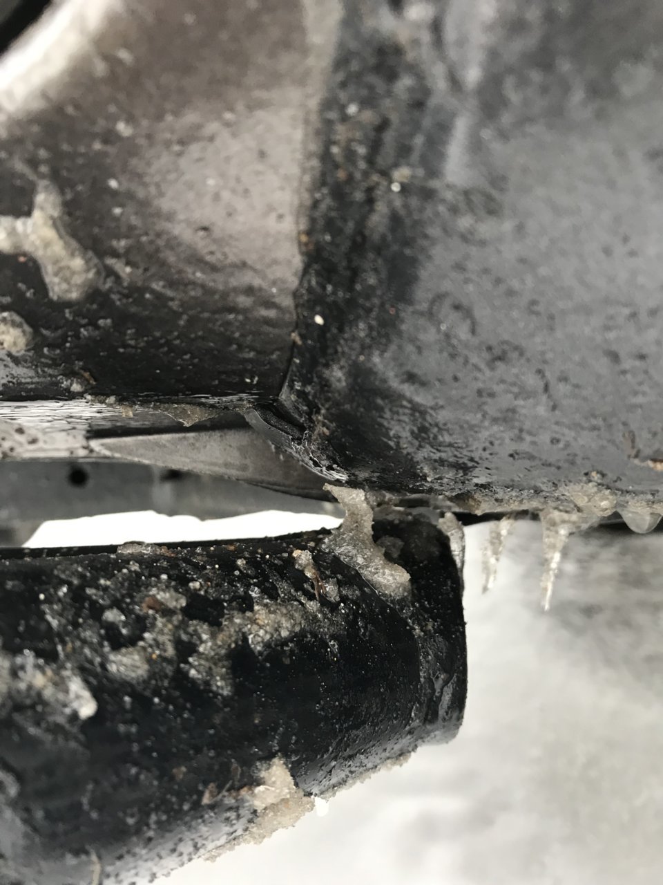

    Anyone else with 2nd gen sliders experience the front corners clunking against the rocker panel on bumpy roads when ice builds up? See photo below.
    I presume this is due to the fact that the shop that installed mine put in every bolt except the far forward one that goes into the boxed in section, so there is just enough play there.

    Could be partly that, but it could also be that the ice builds up in there and then when you are on rough terrain it is the body mounts allowing movement of the body to separate from the built up ice and then come back in contact with it again. I know that is what mine is. My body mounts allow for a decent amount of movement.

    This is true, as is evidenced by my CBI Moab 2.0 rubbing on my Bushwhacker fender flares. My shop is checking into poly bushings for the front end of my truck to help. My sliders are actually from WhiteKnuckle and taper at that point, so I can't comment. But the ice part makes sense!

    That makes sense, thank you!

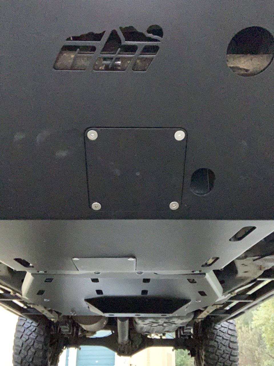

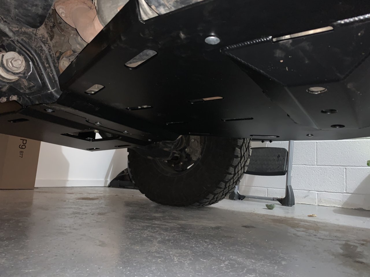

    Full overland skids went up yesterday. Install in my build thread.
