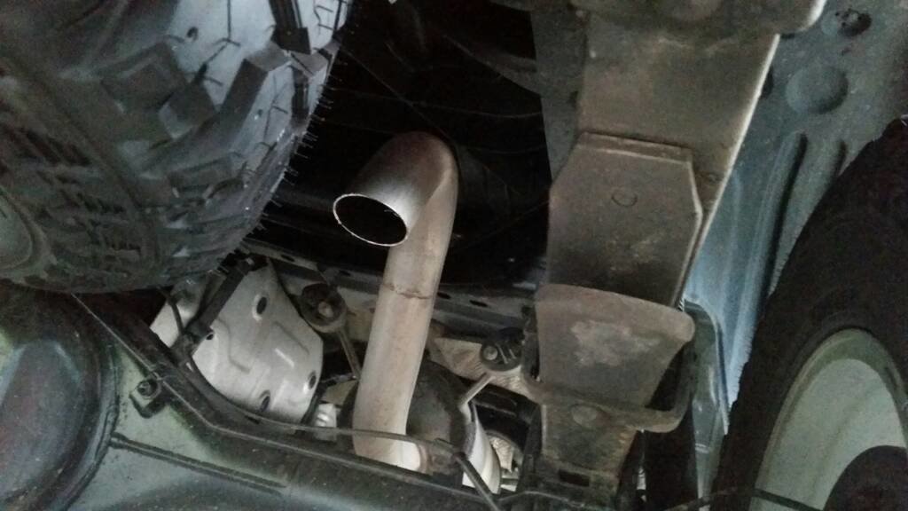

    I bent the tabs down with a big hammer and my 255/80/17 still didn't fit. I was hitting the rear exhaust hanger so I ended up chopping my exhaust and cutting off the exhaust mount

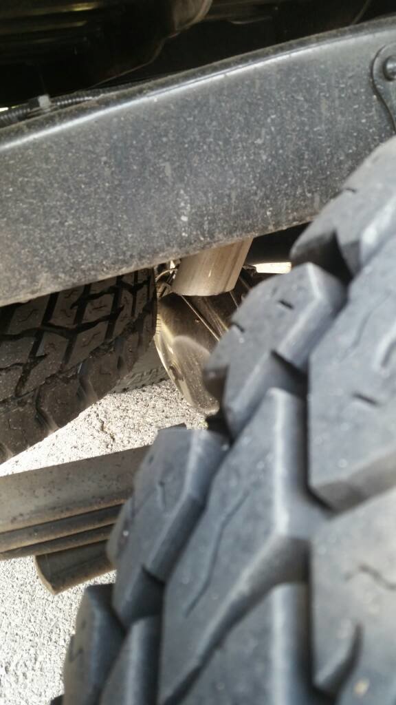

    I had to cut the exhaust hanger mount cause it wouldn't go up in cause of my rear spring mount but with out the exhaust hanger it clears but it's a tight fit either way

    How is your clearance to the back of the diff? Could contact under compression. With 265/75 16, mine is very close. Too close. Hoist relocate mod might be needed.

    It's close I have never had contact with my diff tho I watch this tho. I can't do the hoist relocation cause of my hidden hitch in my aftermarket bumper I did cut a 3/4“ off the back of the hitch for a little extra clearance

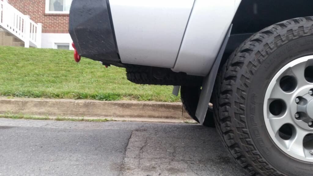

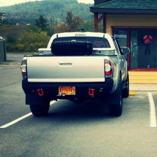

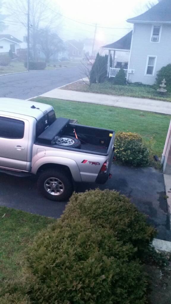

    My spare spends most of its time in the bed of my truck under my tool box but I put it under the truck when needed I have it on a matching aluminum wheel I don't like keeping it under the truck in the winter due to the salt anyway
    Or mounted like this if I need the bed space

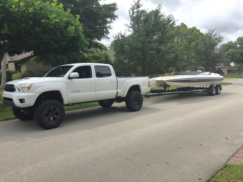

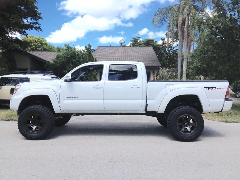

    here's mine with 295 70 17's

    Thanks, they look good!

    6" Lift?

    about 6.5" lift up front
