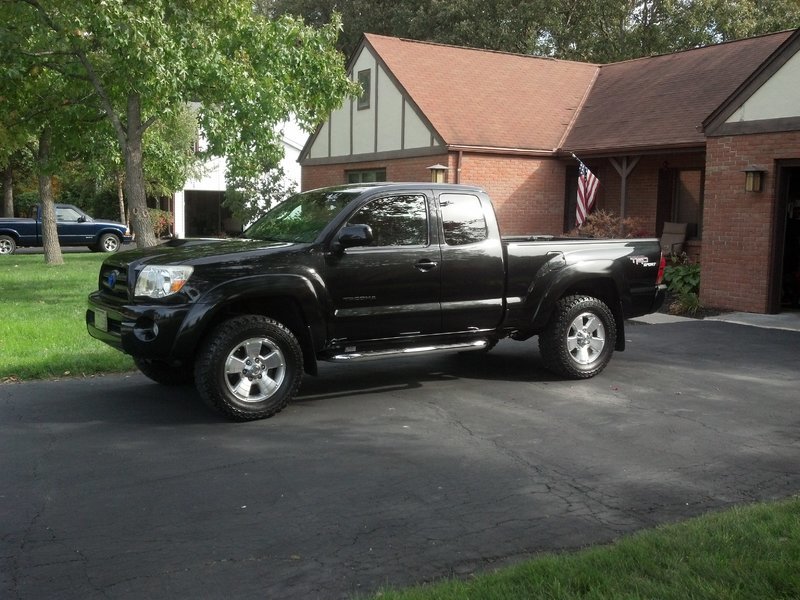

    image.jpg stock rims and tire size on my 06

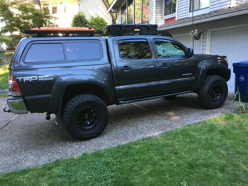

    I have OME lift, here's my truck with ~3", on the same tires and rims. Now that I've had it out and flex'ed a bit I do have some rubbing on the back of the inner fender when the tire is fully stuffed, I'll have to hit it with a heat gun at some point.

    What will you do to fix that? (Sorry for a potential dumb/obvious
    What will you do to fix that? (Sorry for a potential dumb/obvious question) is it just the inner plastic stuf or actual fender?
    Looks really good though!

    I'm not rubbing all the way back to the cab mount, just hitting the leading edge of the inside plastic fender a bit - enough to make a bunch of noise but nothing damaging. In fact, it actually seems to help keep mud and crap from building up in there, but it's a bit disconcerting to hear when going over stuff that I want to make it stop. My initial plan is to pick up an inexpensive heat gun from harbor freight (aka "snap off tools") or Fry's and just heat it up and roll it back a bit. If not, I'll take the dremel to it and lop off the offending bit.
    FWIW, I love these tires. Quieter than I anticipated on-road, and now that I've got a bit of time with them off-road I'm really impressed. They air down nicely, and I've already had a few encounters with rocks and branches that have damaged my new rims, but seem to bounce off the sidewalls of these tires.

    So that must be when you are compressed and turned a good amount. I just wasn't sure if you were hitting your actual fender inside or just that cheap almost pointless plastic in there. (Away from the truck to look at it right now)
    Glad to hear your great feedback. I am definitely set on them and can't wait!
    With the Icon set up and Pelfreybilt armor, I might end up sitting at only ~2". Think that will change anything?

    You are correct, it's when compressed and turning the wheel, although it takes surprisingly little compression and turning to make contact. It is just the plastic I'm hitting, normally covered by the mud flap. In my case I pulled those off while I was still on stock wheels/tires for the same reasons everyone does. I also pulled that silly little plastic lib that hangs down in front, as that was not going to work with the larger tires.
    I can't speak to your Icons, but absolutely the more weight you add the lower it'll sit. I was originally going with OME 887 coils with the expectation of putting a bumper on at the same time, however the bumper ended up on the do-it later list so I opted for 885's, which I think was the right call for me now. Once I get it loaded with skids, bumper and winch I'll re-evaluate coils.
