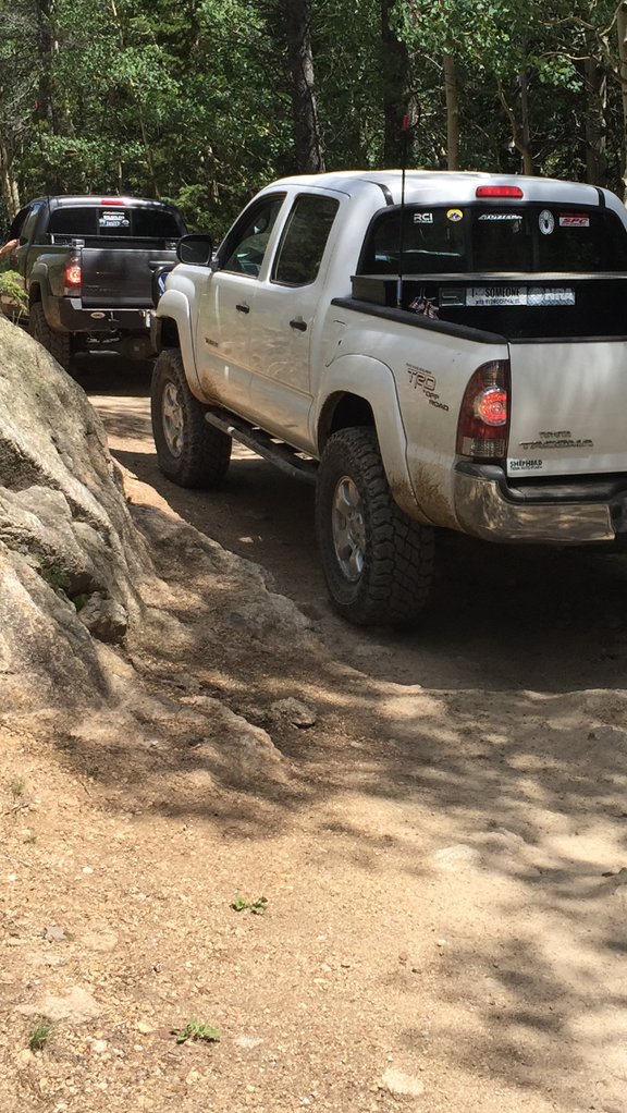

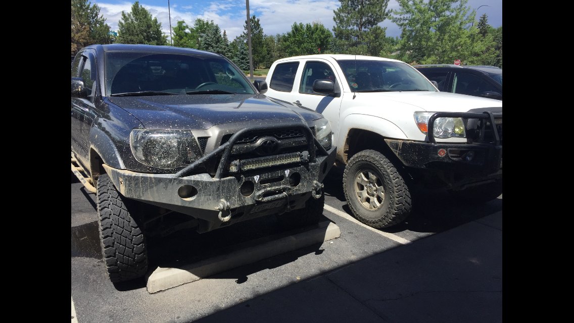

    My old man decided to join the cool kids club with some ST MAXX, we broke them in soon after

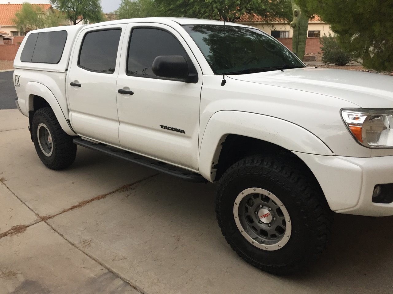

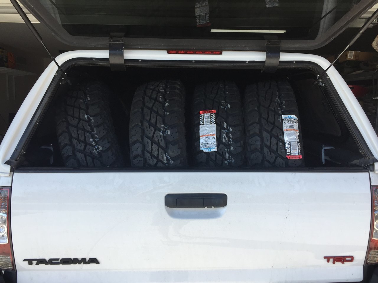

    First impression: love IMG_3189.jpgIMG_3191.jpg

    How do you like the tall and skinny 33's? Any idea how much they're impacting your fuel economy?

    No idea yet how they are impacting the fuel economy, but seat of the pants the truck feels just a bit slower.
    Looks wise, I love them. Definitely fill out the gap of the wheel wells nicely and look like a mean tire ready for adventures. They don't look any skinnier than the 31" KO's the truck came with. No complaints.

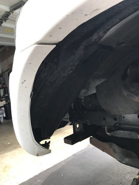

    Not true. I ran 255/80r17 on stock wheels on a stock height tacoma and didn't rub. Even took it on some pretty technical stuff and didn't rub. All I did was unbolt the front fender liner (two bolts and one body clip) and shove it forward out of the way and secured it with a zip tie. Below are a couple quotes from my build thread showing it.
    "Decided to do a little driveway flexing too! Coulda gone higher but started getting sketched out.
    It's mighty close! I know as soon as I hit a bump while turning, it's rubbing. I'm going to undo some front clips and shove the fender back and ziptie it out of the way.
    This is what I'm talking about with the fender liner.

    well then I stand corrected.... that is something interesting. Those are stock Toyota Sequoia rims though right? I know they def aren't Tacoma (probably doesn't make a difference)
    I would imagine speed bumps at speed you'll hear some plastic contact

    Yeah, they're sequoia wheels! The only difference is they are +15mm vs +30mm of the Tacoma wheels. As far as the rubbing of bumps at speed, there is none. I wheeled a really rocky trail a couple days after getting these, and my suspension was stuffed way the hell up there. I was constantly checking if I was rubbing out of curiousity, and I wasn't. It's close in the front corner, but not enough to rub.
