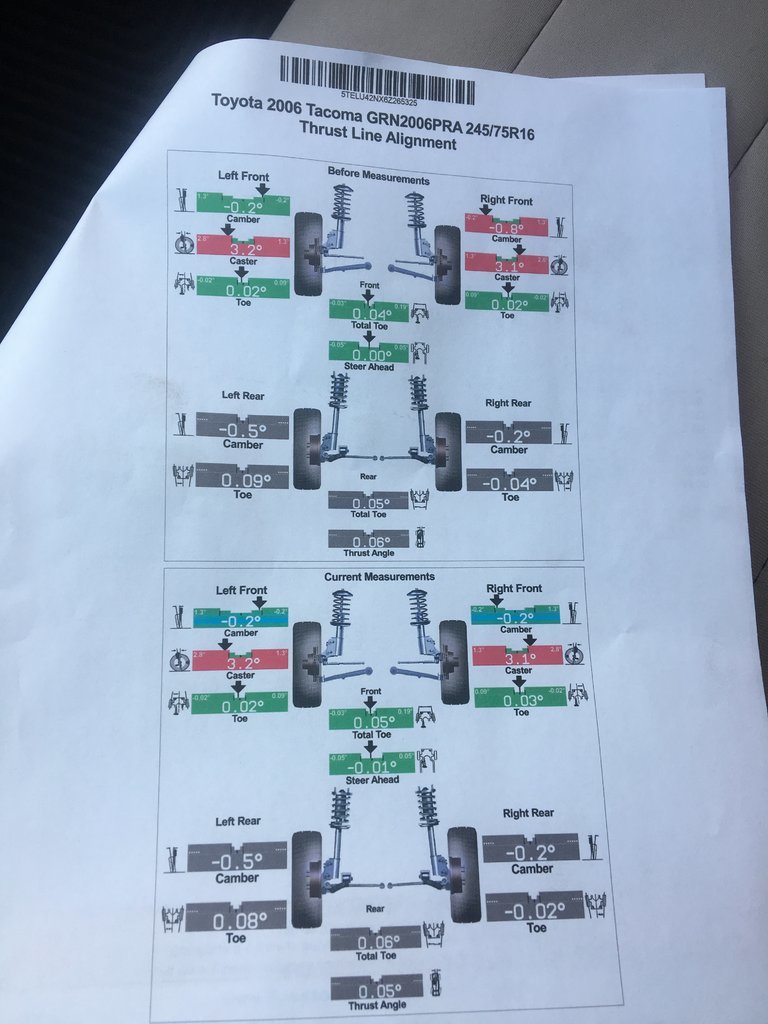

    Nimble9
    Nimble9 visit squareonecreations.com Vendor
    Oct 20, 2015
    #167184
    11,163
    Lebanon, PA
    2006 4x4 DCSB
    enough to have fun
    Need some help on road noise:
    I'm on my second tire rotation and at 10k miles on 255/80/17 st maxx's.
    The noise has gone up considerably since I rotated, and I'm currently getting my alignment checked out (lifetime firestone alignments ftw!)
    The noise / frequency is such that my overhead console rattles, as well as other various plastic pieces in my truck.
    I run a stiff suspension (886s) up front and 35 psi all around. Treadwear looks even as far as I can tell. Will post new alignment specs when finished.
    Any advice would be great!
    Only pic I have with my tire:
    Update:
    After the alignment it "feels" less noisy overall. I think I might play with tire pressure and see if that effects the road noise. These tires were so quiet 10k miles ago! I know it's something in my setup haha

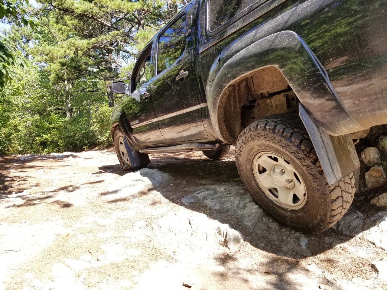

    Trailbutter
    Trailbutter "Percussive persuasion = perfect fit"
    Jul 24, 2017
    #224883
    232
    South East VT/ South coast MA
    2011 Black DCSB
    FOX/TOYTEC suspension RCI sliders Bud Built skids Pope overland RTT
    255/85r16 on stock wheels. About 19psi in this. Front is nice and squishy. Peace of mind with the armor Tek side wall.20170725_101523.jpg
    Only lost one mud flap today. I guess they're not rock flaps.

    Have your tires checked for balance or out of round issues.

    Get them balanced again? I can do that!
    My trucks pulls to the right, even after the alignment. Even on roads that bank left, that normal?

    Check your tie rod end. Sometimes if they are old/bad you can't get a good alignment.
