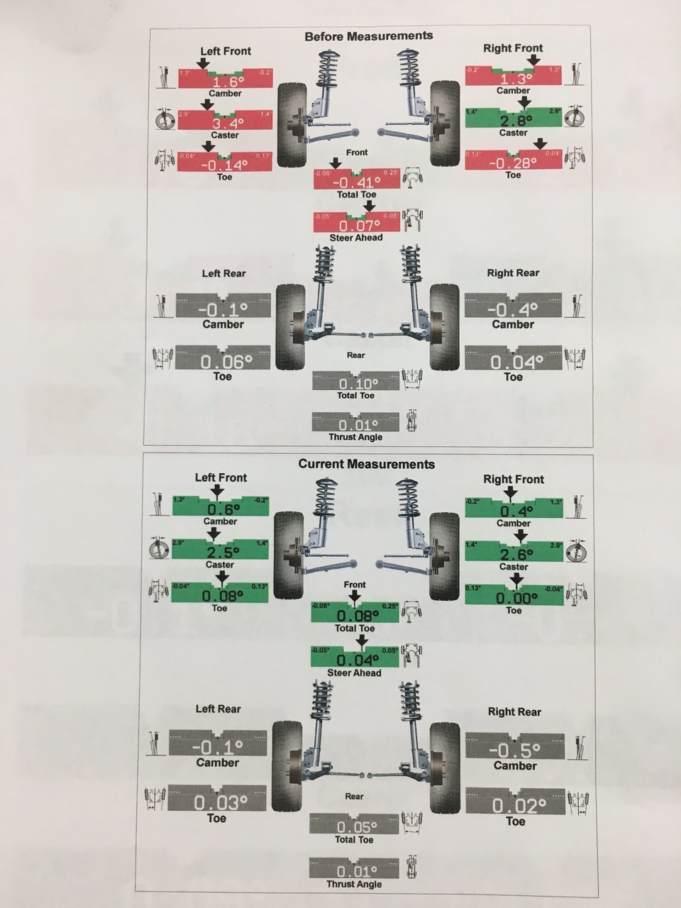

    Curious what you guys are running for tire pressure in these. I did the chalk test with my 255/85/16s on the stock TRD OR wheels today. Started out with 34-36 all around and was getting more wear on the centers than the outsides. Now down to 30 on the fronts and 32 on the rears since I have a good amount of weight in the bed (canopy, RTT, 200lbs cargo). Any issues with running these on road down to 30 PSI?
    Alignment was just done as well.

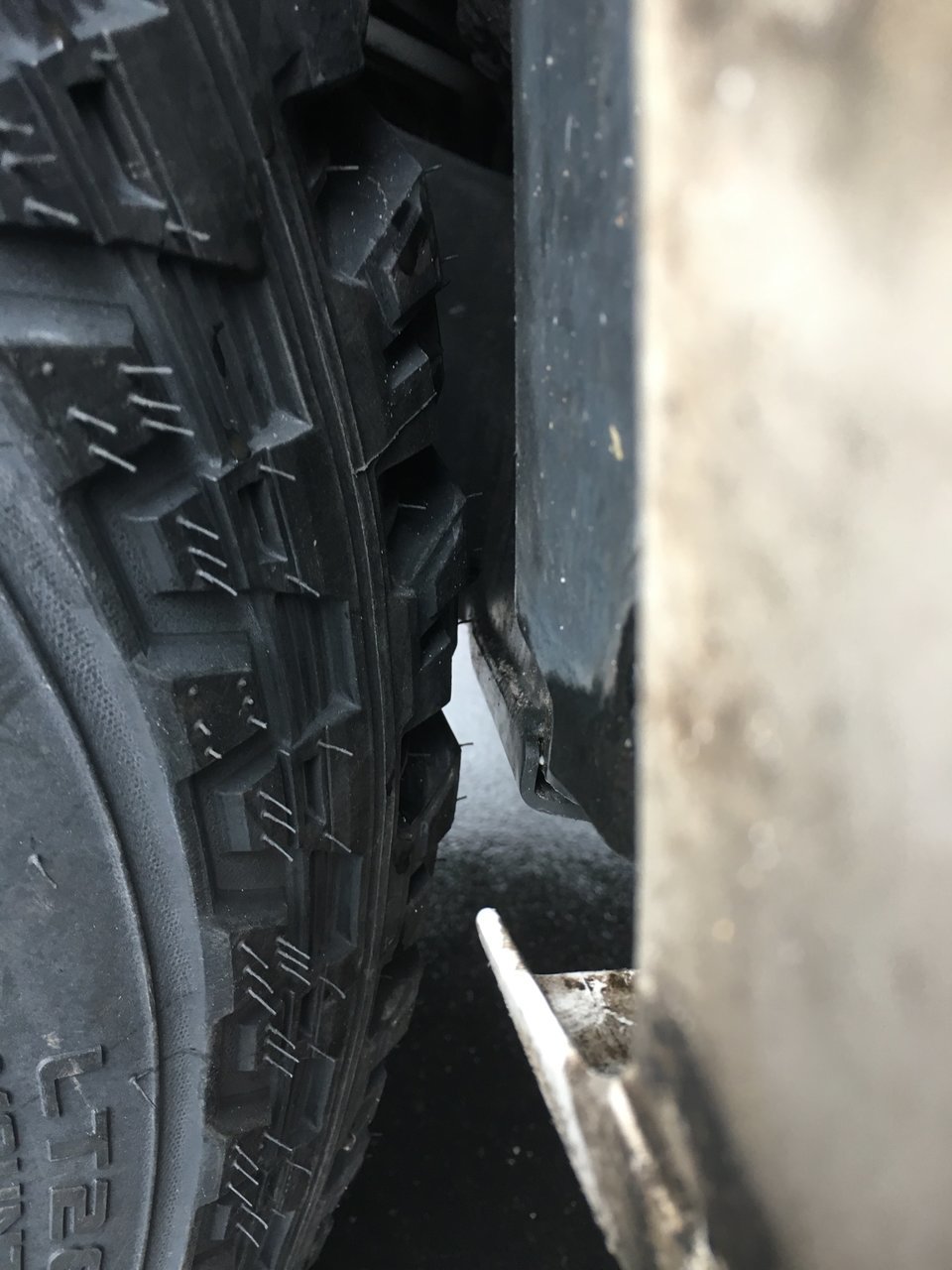

    Is that on level ground? If so, then when you are doing the same while compressing the suspension I suspect you will have interference.

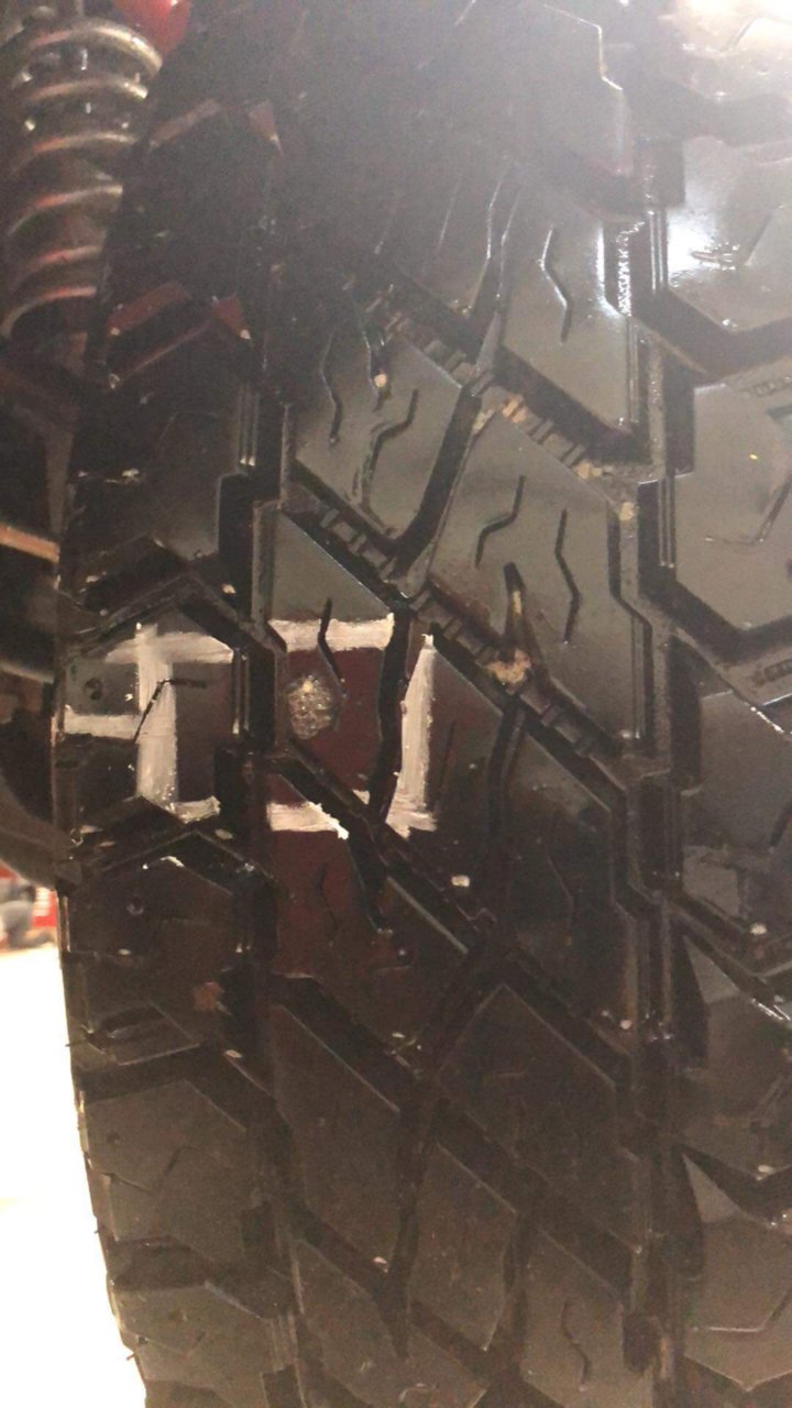

    :annoyed: At least all 4 are covered... easily repairable I would assume. Kinda wishing it was closer to the edge of my tire so I could get a new tire and make this my spare lol
