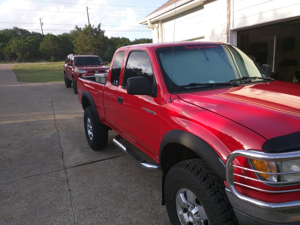

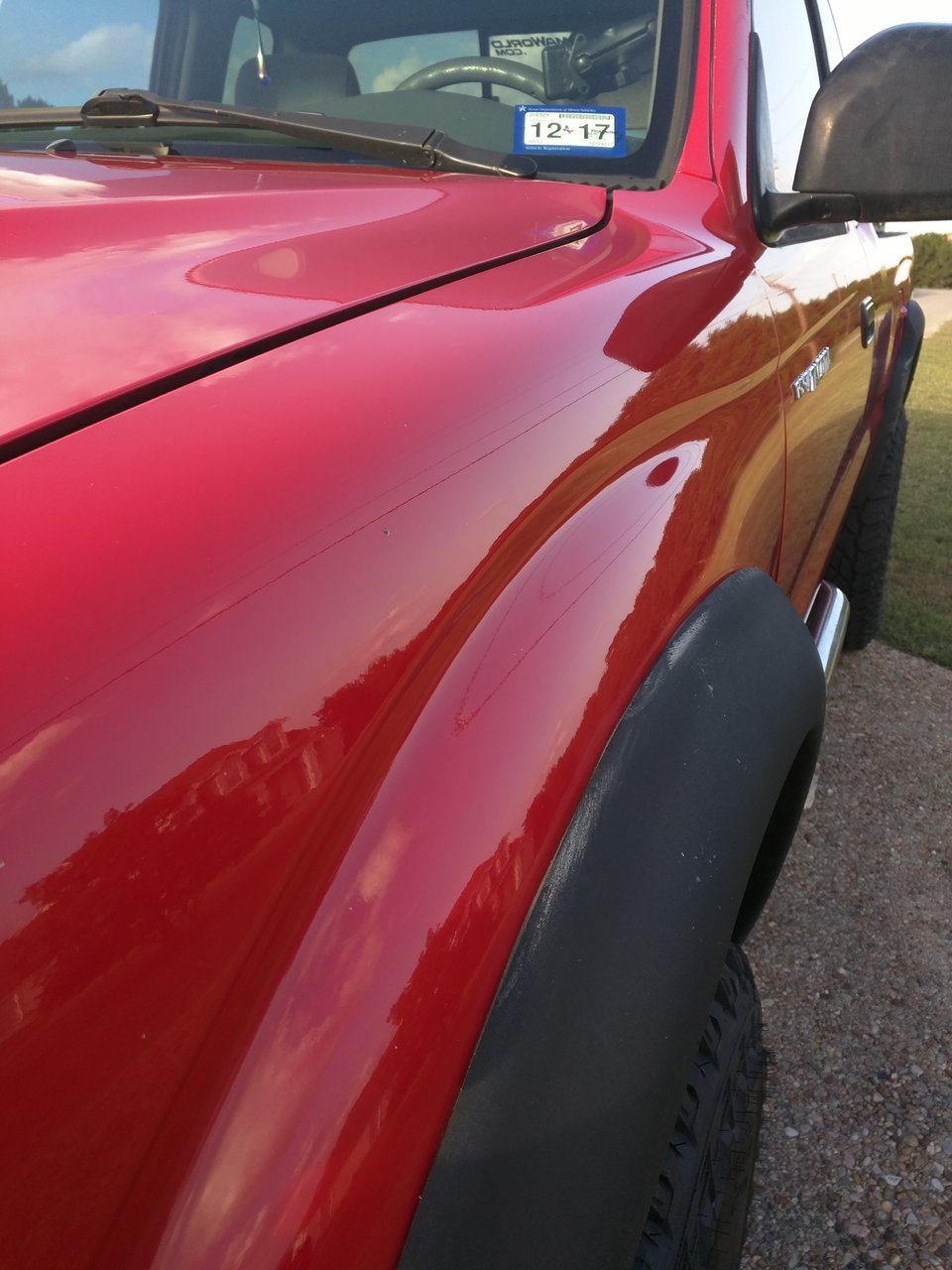

    Here is my first gen on 255/85/16 on 2007 T4R wheels. I also have 1.25" spacers.
    The wheels are 16x7 with an offset of 30 mm. with the spacers, roughly 31mm, I'm at about 0 offset or 4"bs (relatively). This is the closest pic I have right now that shows where they sit, but they are really close to flush with the fenders. Tucked in just a hair.
    Someone chime in if I botched the BS calculation. I always get confused...
