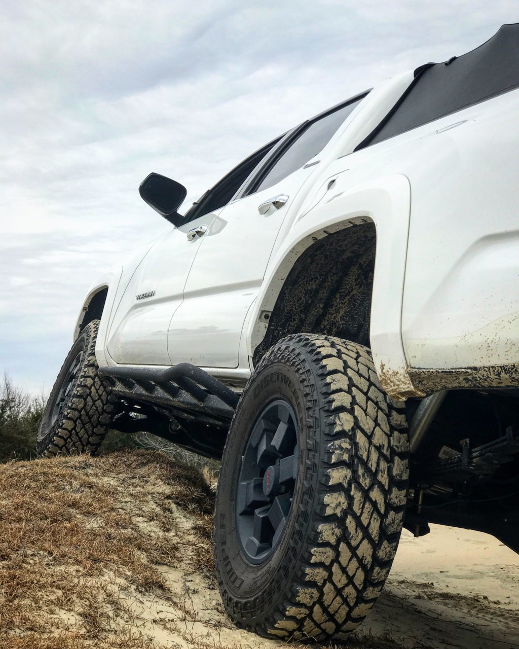

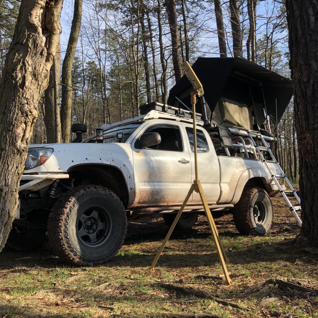

    Here are mine again :drool:

    That flex! :eek:
    Oh, and you have a rock in your tire. Destroyed! :bananadead:

    I still have not been out to fully flex them out, and see if I need to bash more with BFH. Also still need to cut front flares and reinstall. Camping is fun though

    I like these so much I'm going to get them in 35s when my 33s die!!

    I'm still not ready to do what's required to fit 35's.

    it wasnt that bad.. I only cut 2" from the front fender, and took a hammer to the pinch weld.
    Cutting was nerve racking though

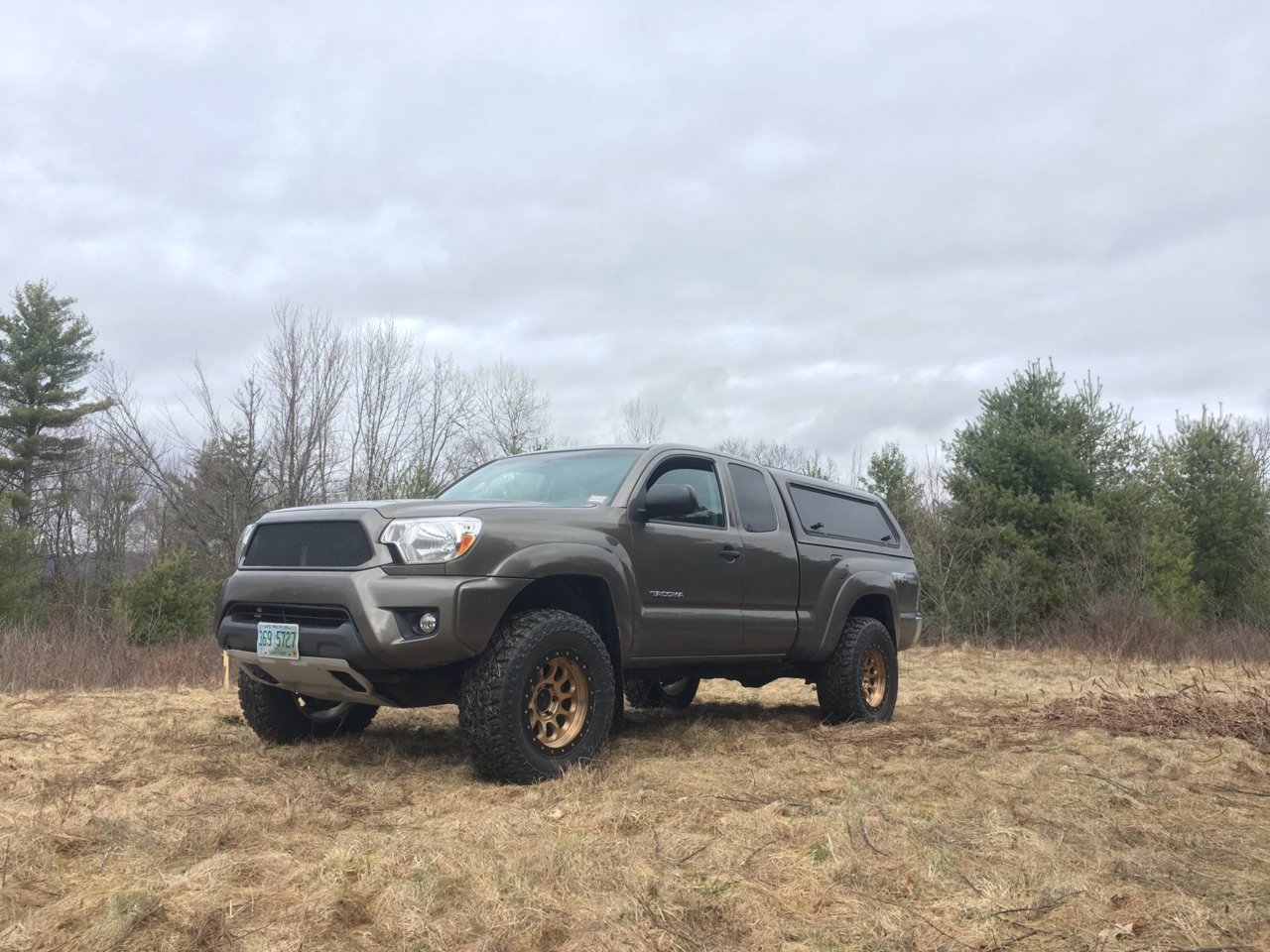

    Still loving my st maxx

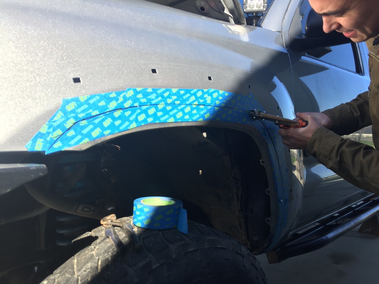

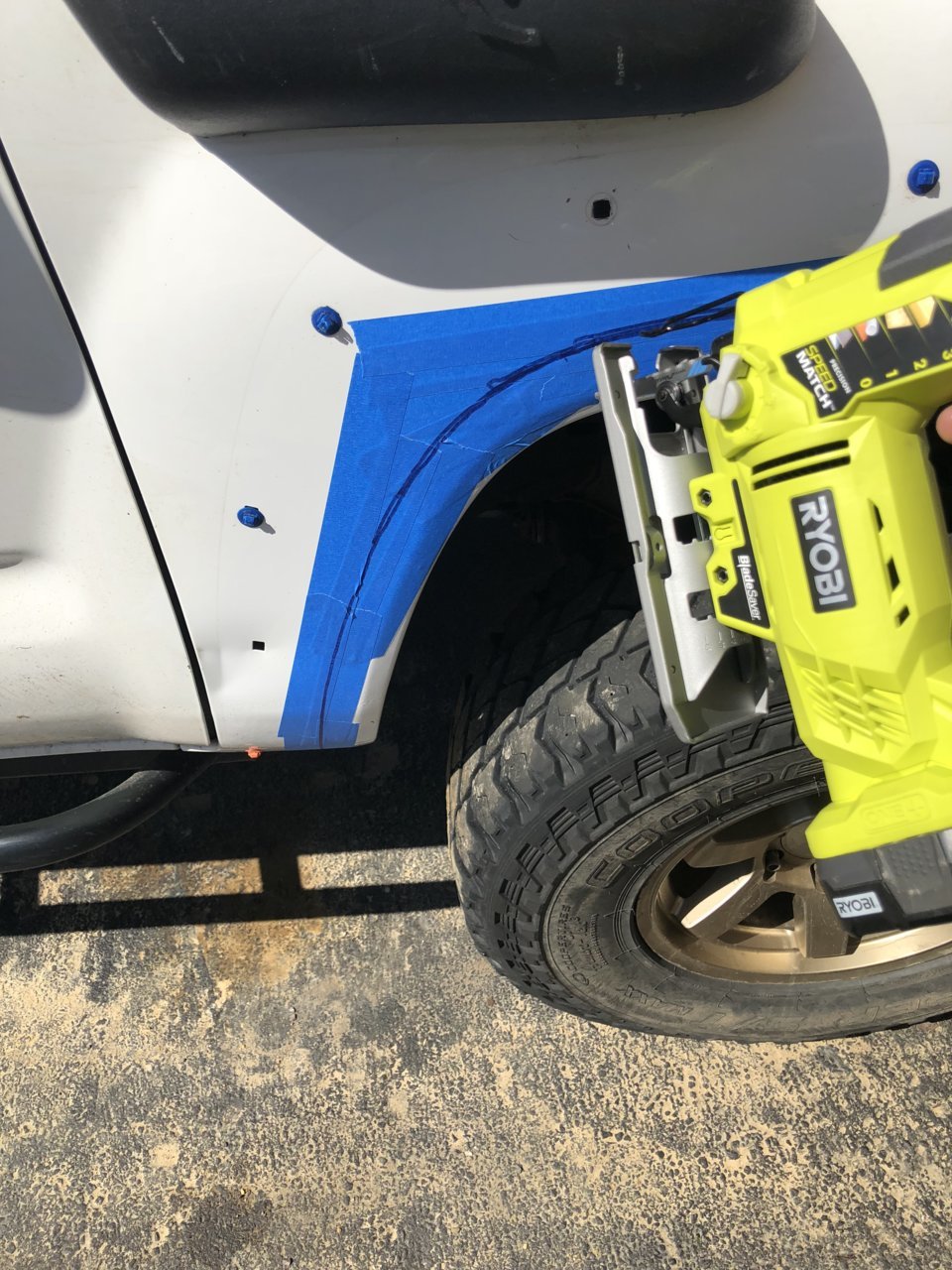

    Its really not that bad. Much easier and cleaner to do with a set of hand nibblers compered to any other tool option.
    Drink beer.
    Mark line with roller tool.
    Cut with nibblers.
    Drink beer.
    Easy

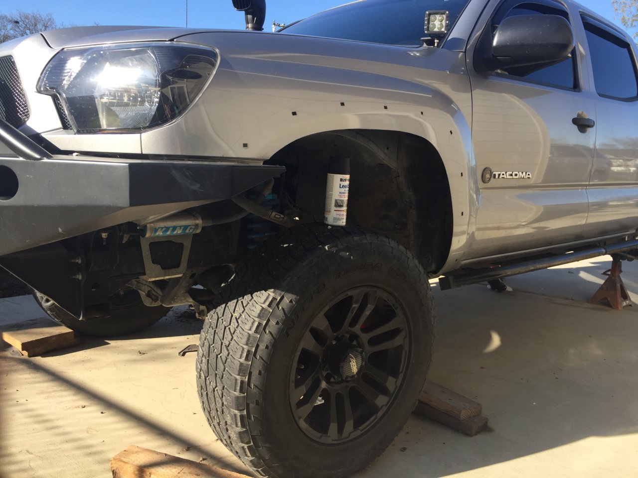

    I think this is a pretty clean cut

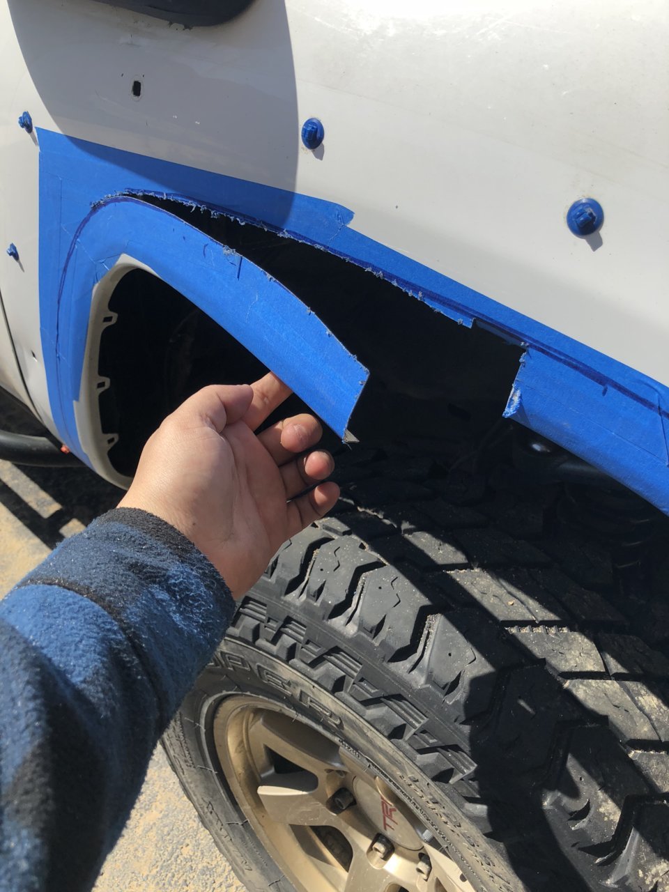

    Ummmm.
    It looks to me like you did steps 1& 4 a few times too many. o_O :p
    This is what it looks like with a hand nibbler.
    CCF0A84E-1F14-42A3-AB72-074FBC6EC217.jpg 1B605278-2C82-407B-AAE1-6B68B00F4ED2.jpg

    255 85 r16?

    but seriously doesn't look bad at all :D

    Yes 255s:D

    Look great, will likely be going that size on my next round of tires.
