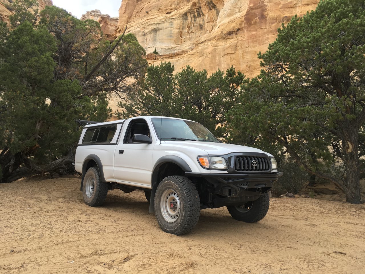

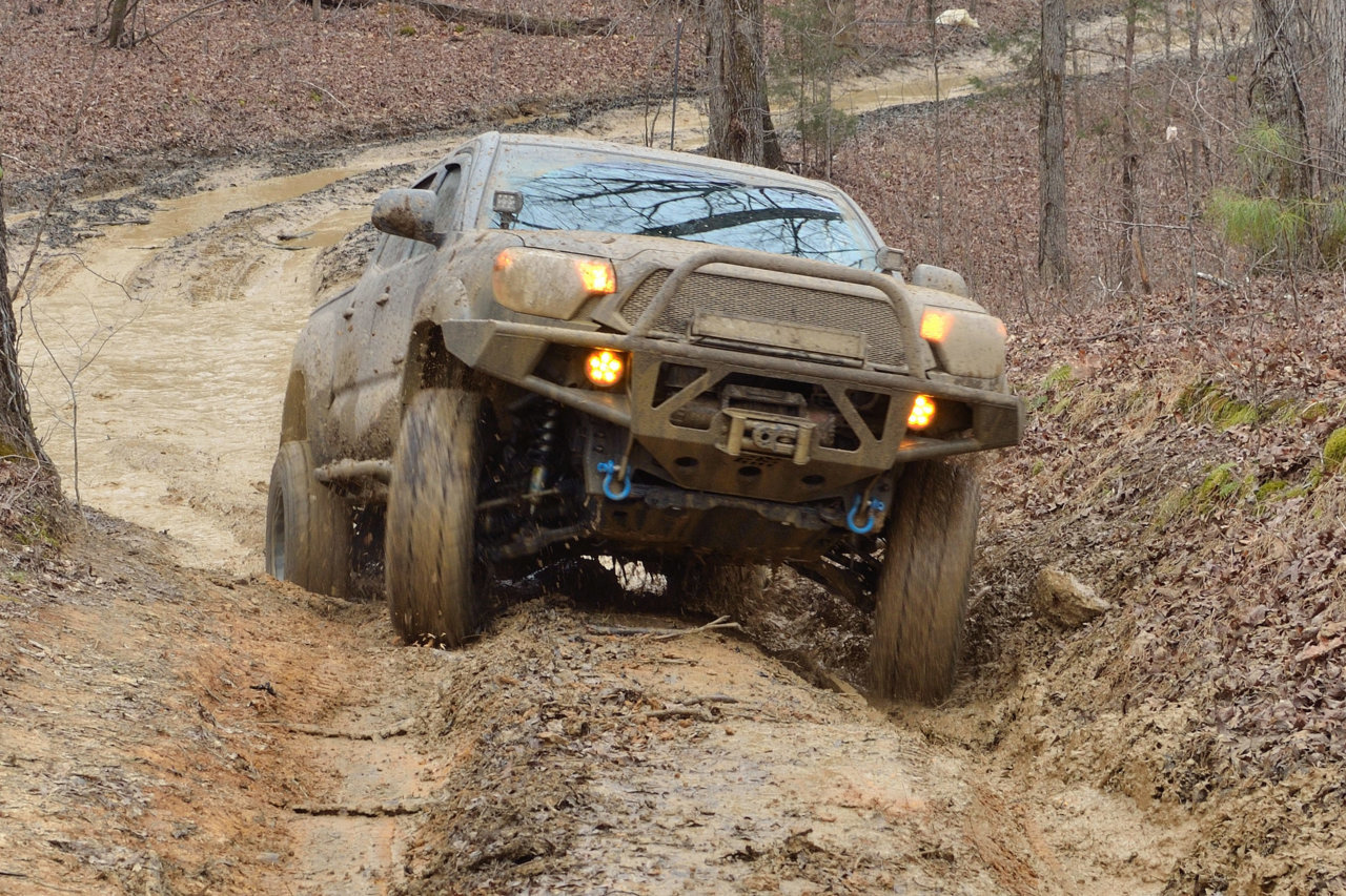

    Only to stir the pot, I run 255 with no cutting and no cmc. That said, I don’t run mud flaps on the front. Also every truck is different, so what works for one person may not work for another. First pic: 20 miles on tires Second pic is at 41,000miles photo cred for second pic @Breezy 7F7A46C0-DF52-429B-806F-A3916913CB48.jpg444E9D26-C701-41CE-AF0D-59F0761CD093.jpg

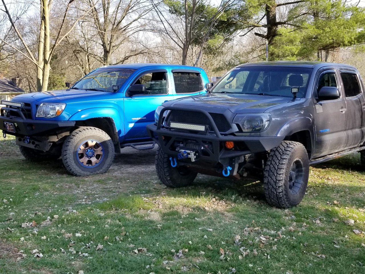

    Edit: side by side of 265 compared to 25595F3E86A-0CB2-4789-885B-4615F6F7C4E0.jpg

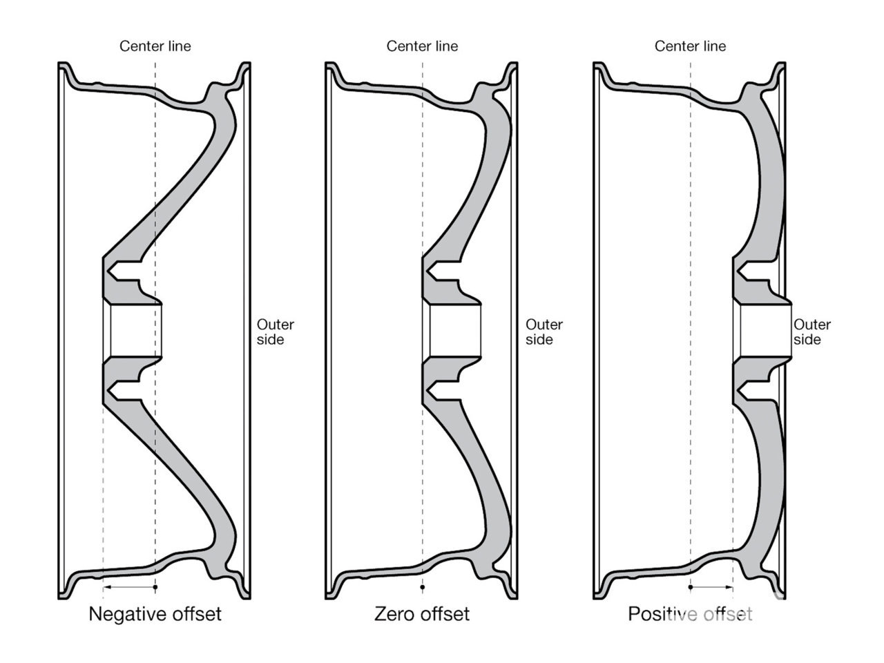

    A negative offset will add more backspacing so that results in a 4.5 backspacing
    https://carfromjapan.com/article/car-maintenance/wheel-offset-and-wheel-backspacing-explained/
    1. Negative Offset
    This kind of offset means, the hub-monitoring surface is closer to the inside edge of the wheel and the wheel sticks more outwards than inwards. This kind of offset benefits the design process by allowing sharp angles, deep spokes and incredible layering.
    2. Zero Offset
    In this case, the hub-mounting surface is even with the centerline of the wheel.
    3. Positive Offset
    When the hub-mounting surface is closer to the outside edge of the wheel, it is referred as the positive offset. In this case, the wheel actually wraps around the hub and brake more deeply. It is commonly found in wheel drive and newer rear drive cars.3E5FE41D-3056-430E-9A3B-211B3401E8DE.jpg
