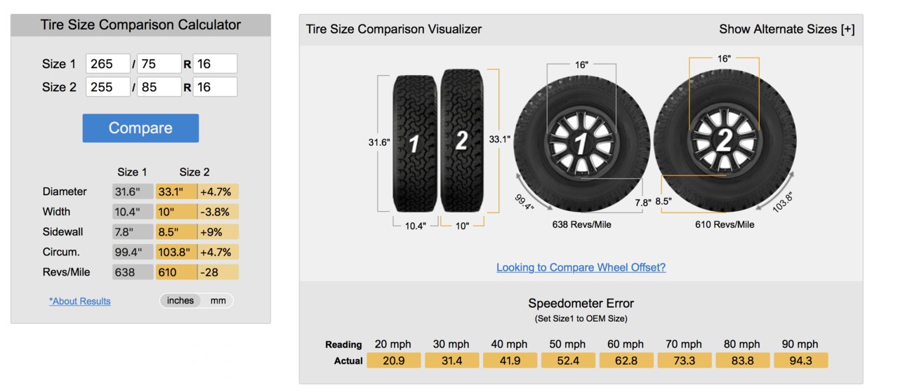

    31.6" versus 33.1...little over 1" actually. But I guess it depends on which exact tire sizes we're talking about

    Since it's a circle mounted in the center, you take the difference in diameter divided by 2 to determine how much more clearance you get. So if the overall diameter is 1 inch more, you gain 0.5 inches of clearance.
    As you know, you cannot go 100% by the tire size numbers because each manufacturer will have a slightly different overall diameter and width.
    From Cooper:
    235/85 r16: Overall Diameter: 31.97"
    265/75 r16: Overall Diameter: 32.01"
    255/85 r16: Overall Diameter: 32.8"
    285/75 r16: Overall Diameter: 32.91"

    1" diameter = 1/2" radius......1" taller tire nets 1/2" more clearance.
    Seldom if ever do any of these tires actually inflate to size the manufacturers specs. Close, but usually a tic under size they list.
    And then they wear....
