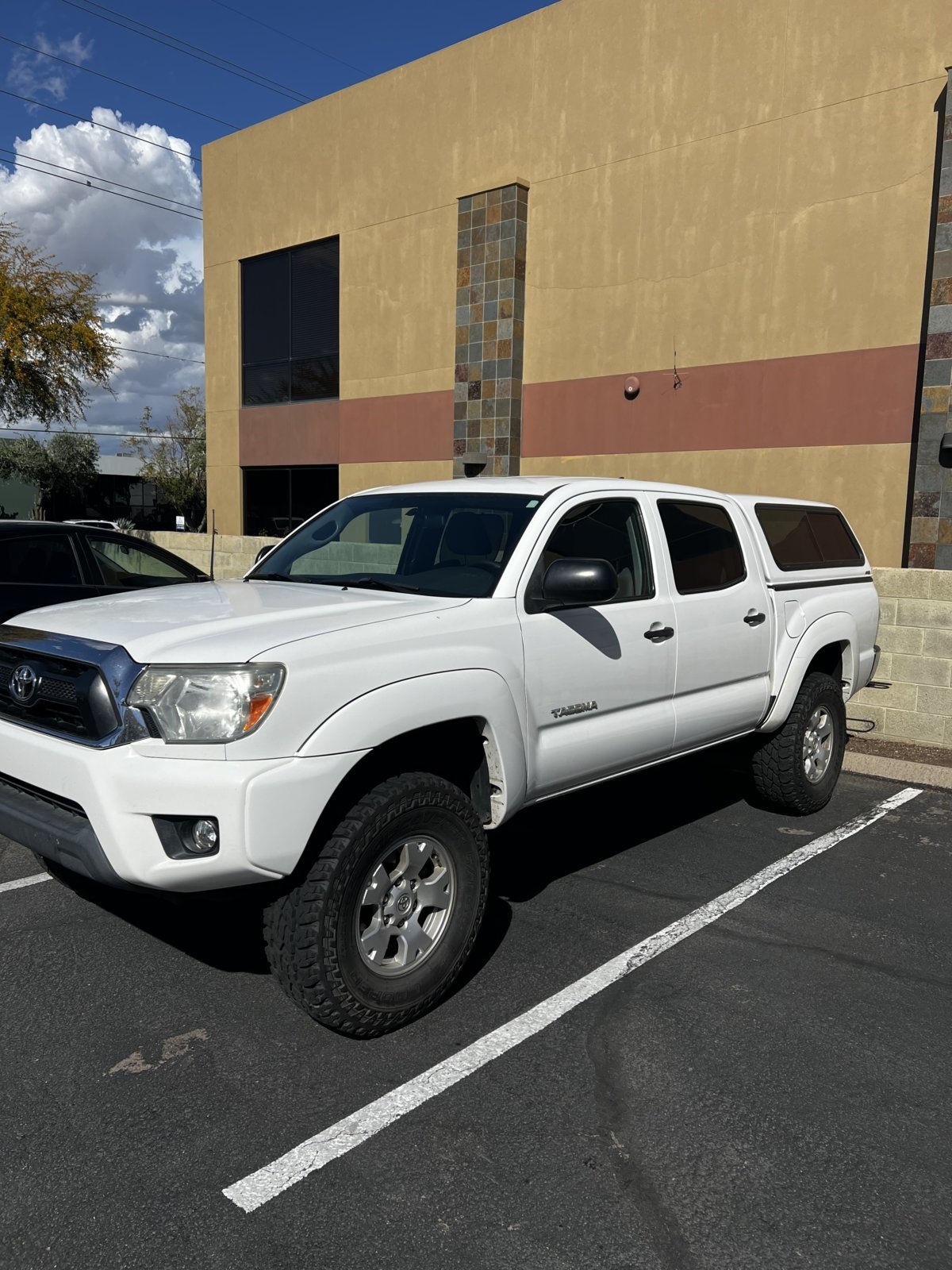

    I have 255 85 16’s Cooper ST Maxx on my 2015. I put Bilstein 6112/5160 combo on it set at 2.5” with an AAL in the rear to level the truck out. Absolutely love the look and the off road capability of my build. I have 2 complaints I need help with:
    1. Tires rub on the UCA in reverse when turning. (I could honestly live with this issue no problem)
    2. My truck was hard to get aligned. It still pulls to the right. I still have stock UCAs I’m wondering if this would be resolved with aftermarket UCAs. Any tips?

    I also have ST Maxx tires and mine pulls to the right as well. It seems to be nature of the beast because of the tire pattern:

    Well that’s unfortunate! I guess I’ll try and let my OCD quiet down about it.

    Yeah if you look at Coopers page for the tire, there are a bunch of reviews on there that say they pull to the right as well :rolleyes:

    Inflate the right front tire +3 PSI and the pull to the right is reduced.
