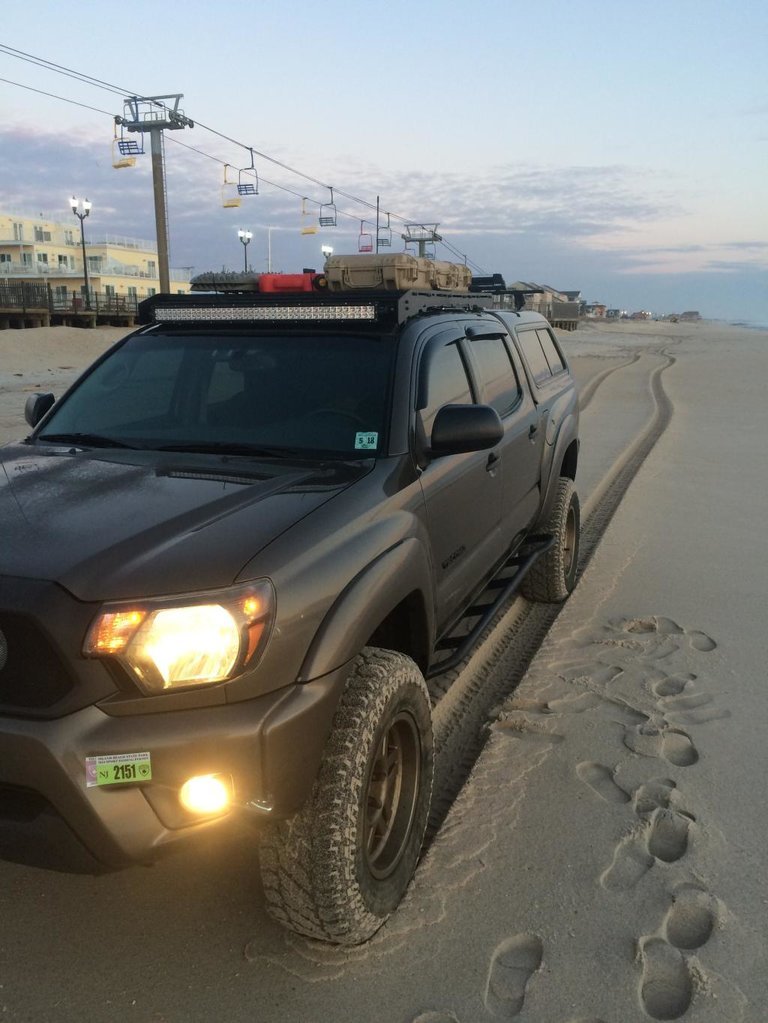

    My 255s do great in the sand, that's a real test.
    ECF70698-1E64-4130-9D3D-3033D1DA0E33_zps_c2914cea447c8359e7faecbf0447f86f8ce1cd56.jpg

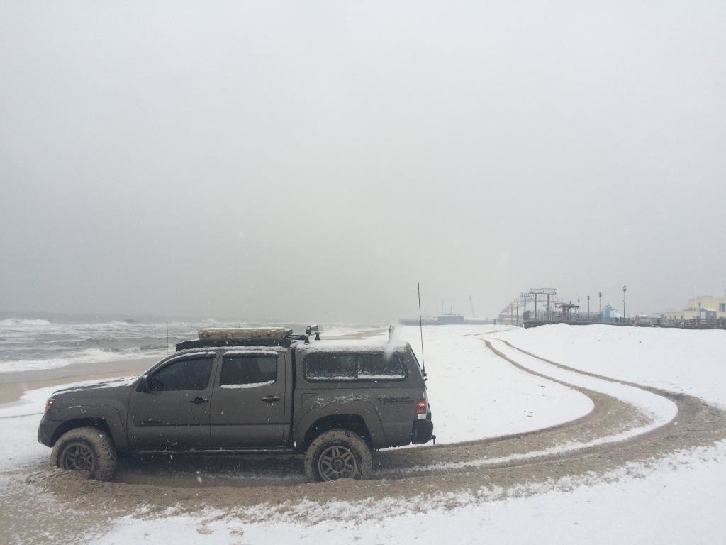

    Snow and sand mix.. no problemo
    A2615E35-2E10-4CDF-A6CE-117B1D660D41_zps_fff968638c6bf796e9a7974292d655fe24e59ae2.jpg

    That looks pretty packed, I'd drive a rental corolla on that, like I did in WA state! Lol the said down here is loose and dry.

    Hah that's just morning fresh tracks, two wheel anything will definitely get stuck. Just tried to grab a good picture of the tires. Being minutes from the beach I drive on a lot. The sand here in Jersey is always changing.. mornings can have dew in the air that makes the sand moist and clogs the treads turning all tires into slicks and making it easy to get stuck even in four wheel if you don't know what your doing, after a few hours of warm sun the sand dries out and allows the maxxs to crawl through the soft sand with the best of them. Hotter days during the summer I air down to 20 psi, this also allows the side walls of the maxxs to get in on the action. Aired down and low gear gets my truck through every deep rut on the beach. Come winter when the sand is colder I don't bother airing down and stay in four high. I am very happy with the tires performance in all scenarios and conditions I have come across on and off road, even in 255s. Just trying to spread the good word.
