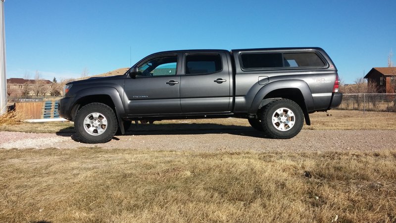

  20. Nov 24, 2015 at 4:43 PM
    #1520
    Wyoboypt
    Wyoboypt Well-Known Member
    Aug 19, 2015
    #162219
    90
    Wyoming
    10 sr5 trd sport DCLB
    1124150956a.jpg 235/85 r16 with new lift
    DustStorm4x4, DJB1 and Chux[OP] like this.
