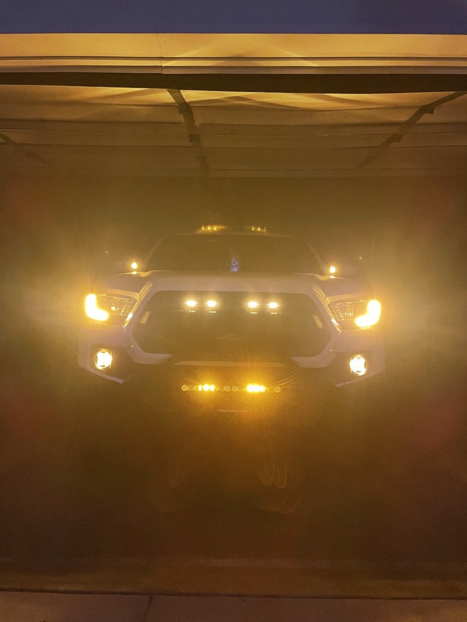

    So finally got my setup where I like it. Lots of amber, isn't for everyone, but it has a nice presence on the road that's for sure.
    Rundown:
    Diode Dynamics Amber DRL boards for the headlights (retrofits)
    Diode Dynamics SS1 Pro's for Ditch Lights
    Diode Dynamics SSC3 Max's for Fogs
    R4T Smoked Amber Raptor Lights
    BD 20" S8 Lightbar
    All lights are white in color temp, it's quite impressive to have quad highbeam projectors, light bar, fog lights, and ditch lights on at once.
    Everything wired into my SwitchPros.
    Everything bought from @memario1214

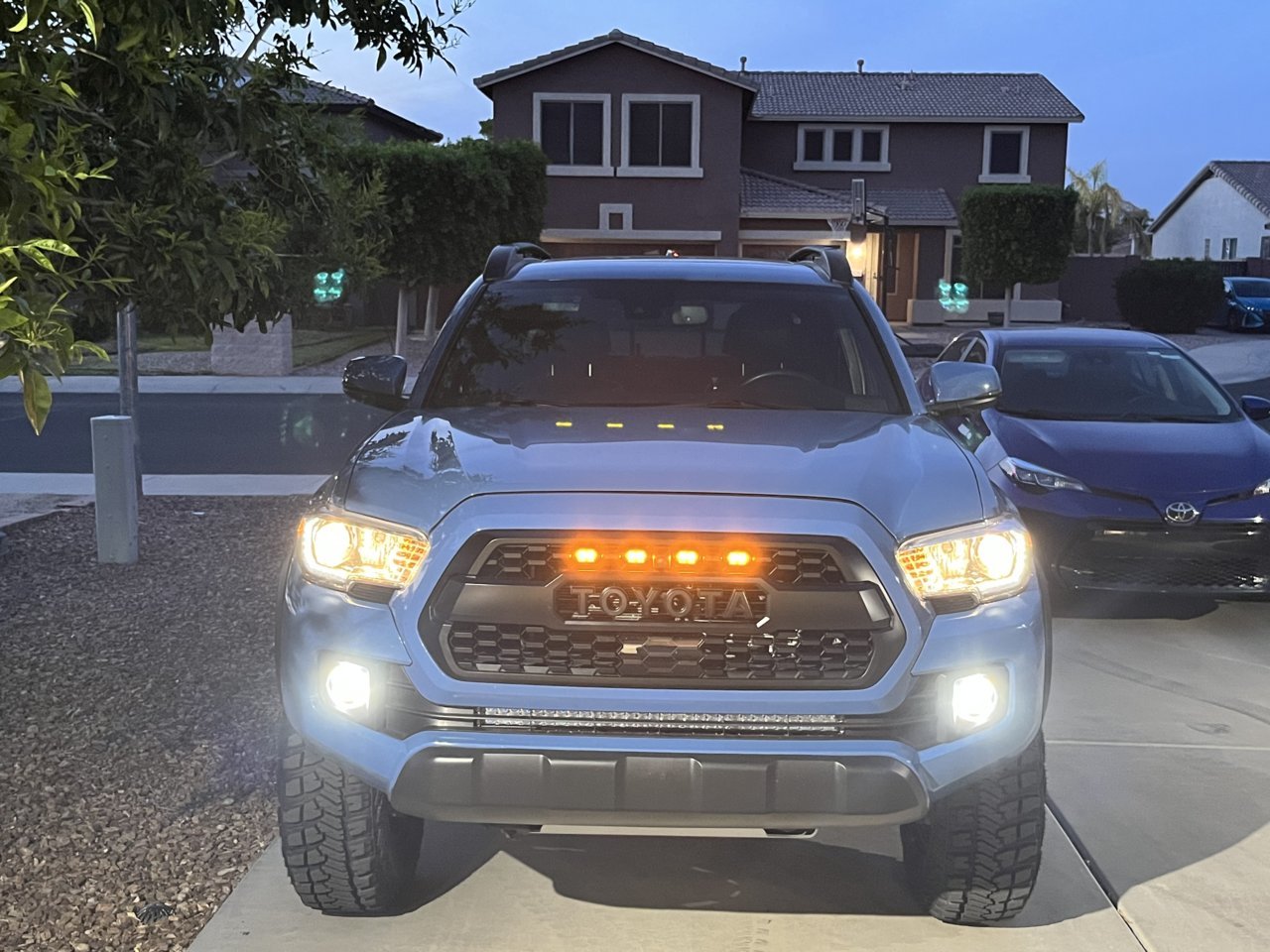

    I opted for white with Amber Backlight and they compliment my headlights so well with its wide angle. Can see really see the turns before you make them or the animals along the side of the road. upload_2022-5-1_23-52-22.jpgupload_2022-5-1_23-53-3.jpg

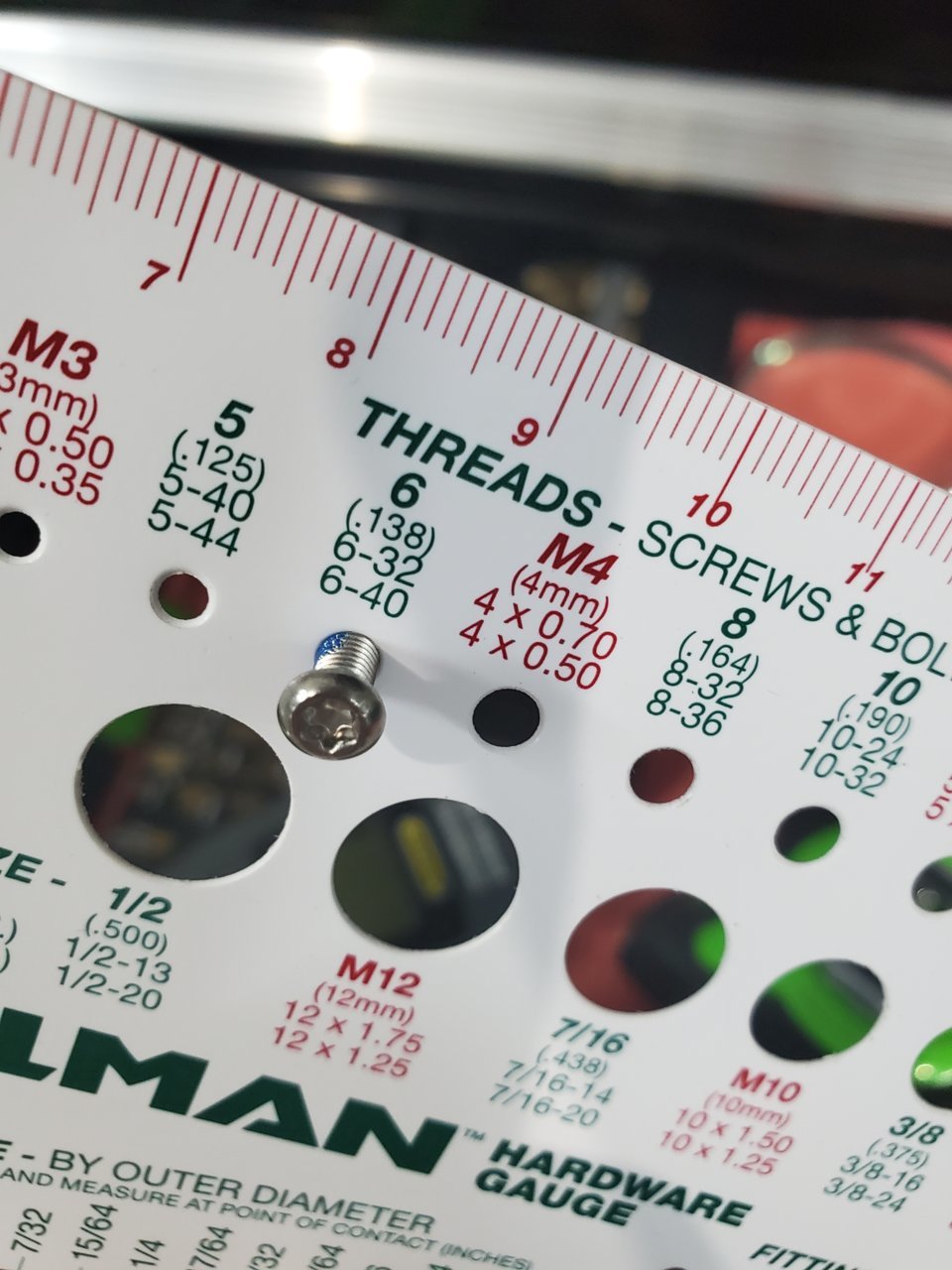

    @Diode Dynamics do you know what size screw is used to hold on the bezel on the ss1 and ss2 lights? None of my gauge blocks has it, and it kinda seems like its a 3.5mm .6 pitch.
    Or does anybody here know? :D

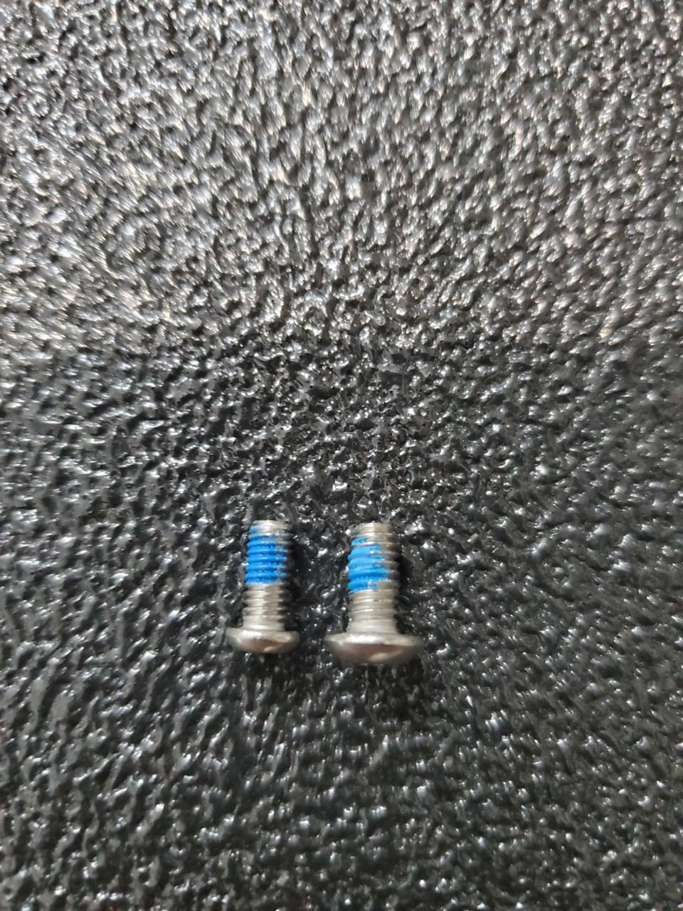

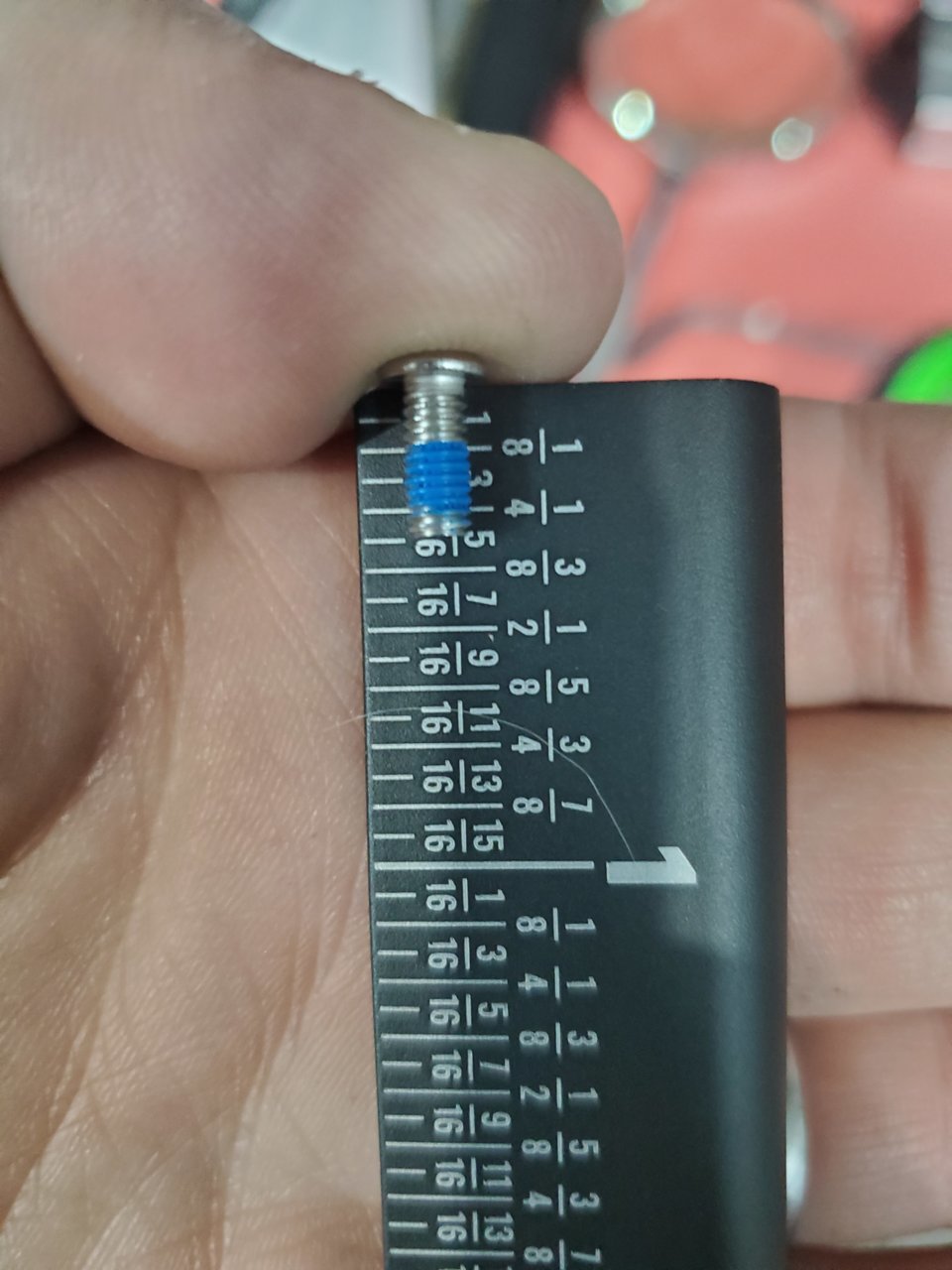

    I think it's 6-40, it's 5/16ths long and I count 11 threads.

    i was thinking that also, but that would be odd as the the ss3 uses a m4 screw. figured they would stick with metric. hmmmm

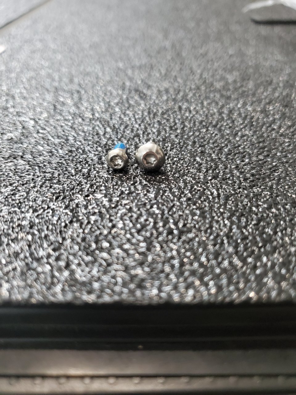

    I think I might have an ss3 screw somewhere too, I'll look

    Hey! It is an M3 Torx, 5-0 thread pitch, 6x8mm button!

    Sounds like I need a better hardware gauge :anonymous:
