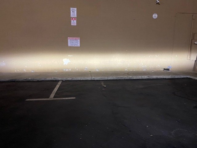

    I can post a picture later tonight after work, but what
    I installed mine a couple of weeks ago and of course couldn't wait to see them at night. I drove over to a local store parking lot that I knew had a side wall without any windows or doors. What I saw was most of the wall lit up. I never took a picture. Tonight I did and the picture does look like everybody elses, but it's not what I see with my own eyes. Maybe I just need new glasses. Lol!

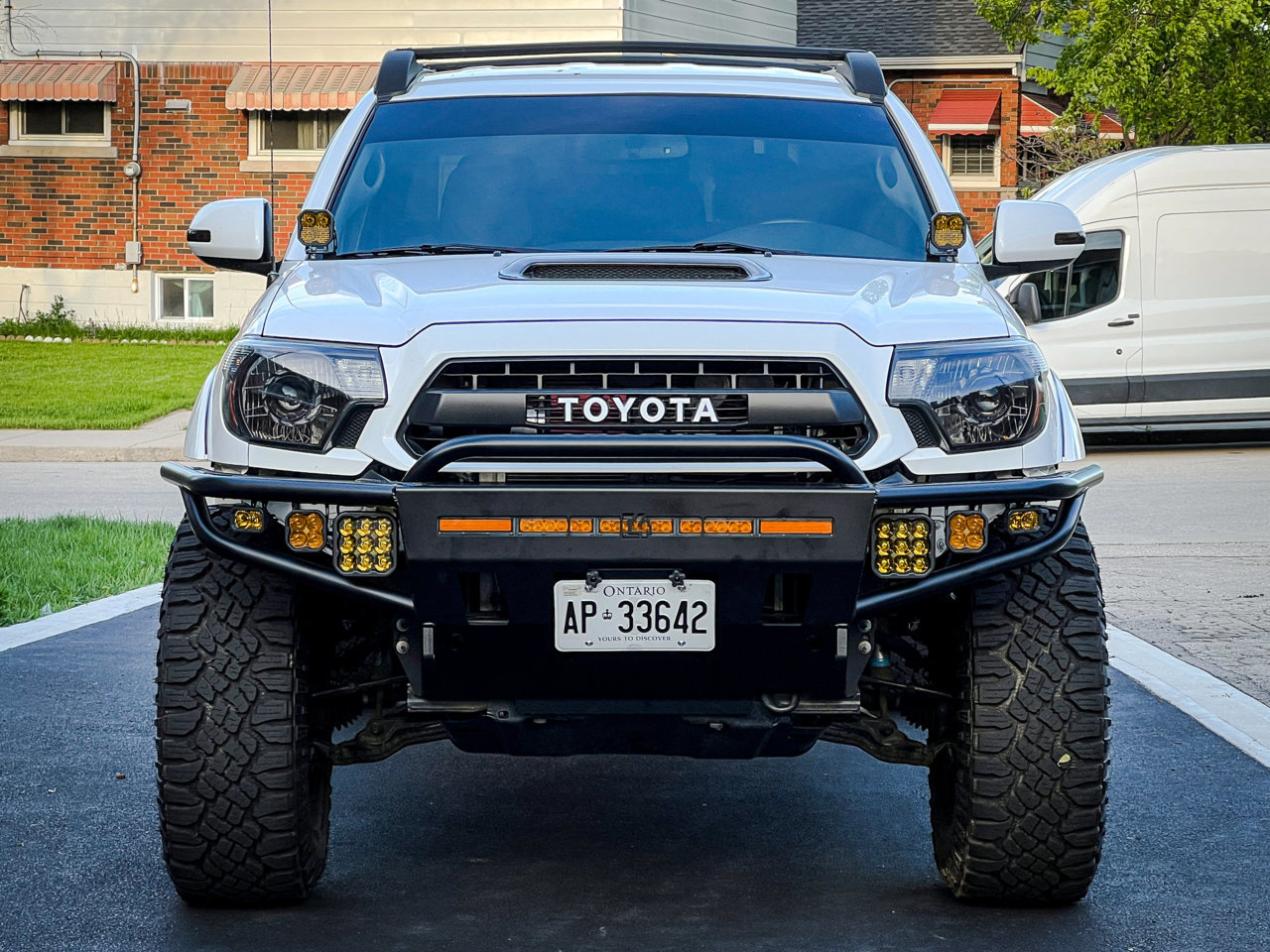

    SSC2 PRO Combo
    SS3 MAX Fog
    SS5 PRO Spot
    SS30 Combo

    Wow! That should be some intense light!

    Who Built the bumper?

    It's a C4 fab hybrid bumper with the low profile grill hoop

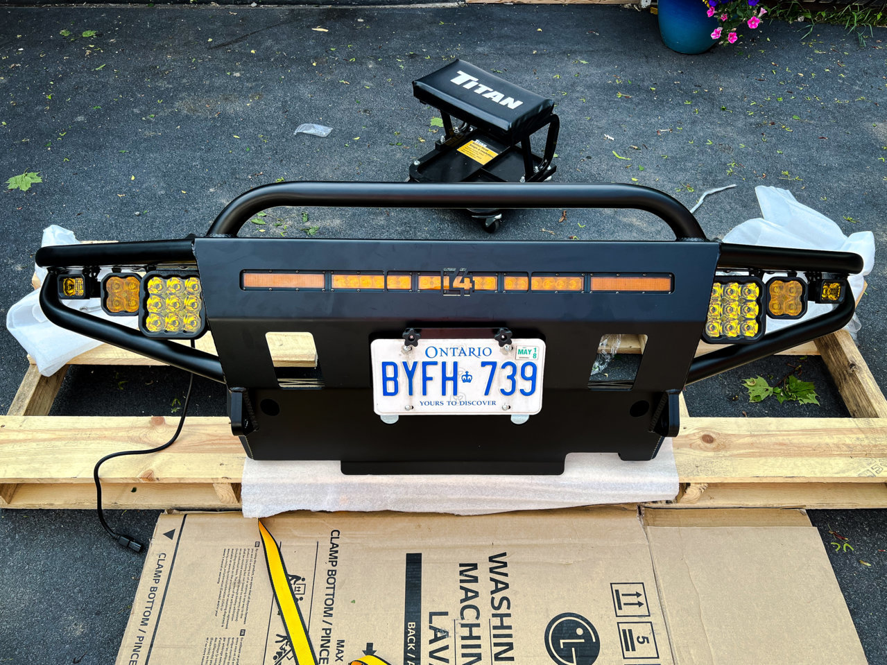

    Well worth the wait time. :)

    DD needs to color match their lens for their light bars with their pods.

    It unfortunately comes down to which chips are being used. The light bars and SS3 Max family of lights all use a 6000k emitter, whereas Pro/Sport pods (when ordered as a yellow light) use a 4000k emitter. The 6000k emitter varieties of lights require a darker lens to bend the light to the correct output color temp. That said, COULD they get the light bars on the same color scheme as the other pods? Yes. Will they do it? I doubt it. I would say you'd see a Gen 2 light bar altogether before they redo the current ones IMO. Unfortunately they don't have the ability to make that move on the SS3 maxes though as that family of chip is only produced in 6000k at this time.
    I don't TRULY know much though. There could be way more LED chip options out there as well that I'm not aware of. I do plenty of things that don't make sense... Even to me.

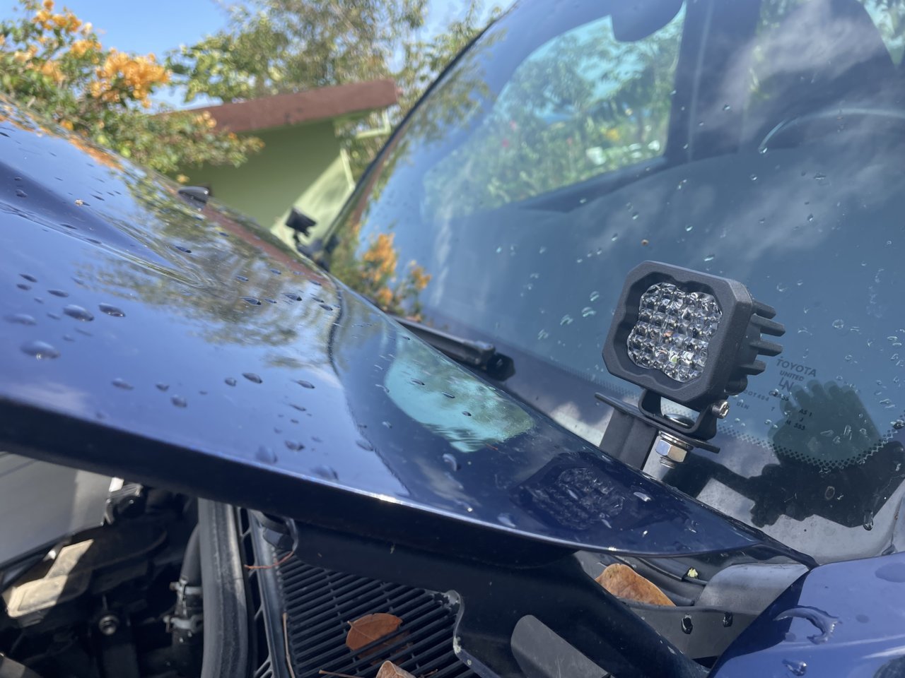

    Speaking of which, installed my SS1 ditch lights today. Still waiting on the switch, relays and wire to get them wired up, but the actual lights are installed on the brackets. I'll post a front end photo once my bumper is installed and full of DD lights :D
