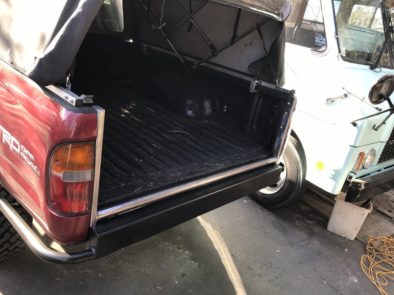

    IMG_0860.jpg Not really armor, but I had to chop up this wilco tire gate that came off a 2014 chevy 1500 so it'd fit my 05 taco. Had to make it 6" narrower in order to fit. Been a handful of years since I've run a bead, and man where they rough lol. Layed em on thick!! I'll post more pics once I get time

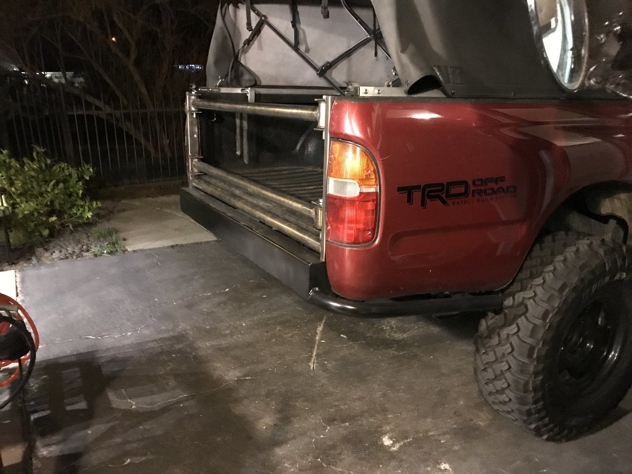

    Beginings of the swingout tailgate

    Whats your plan with having it swing out? Mounting a tire and stuff to it?

    Yeah, swing out tire carrier, using tubing for the tail gate and guna try to see if I can reuse (cut up)my stock tail gate as a cover

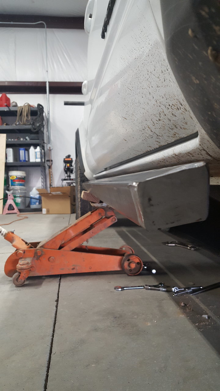

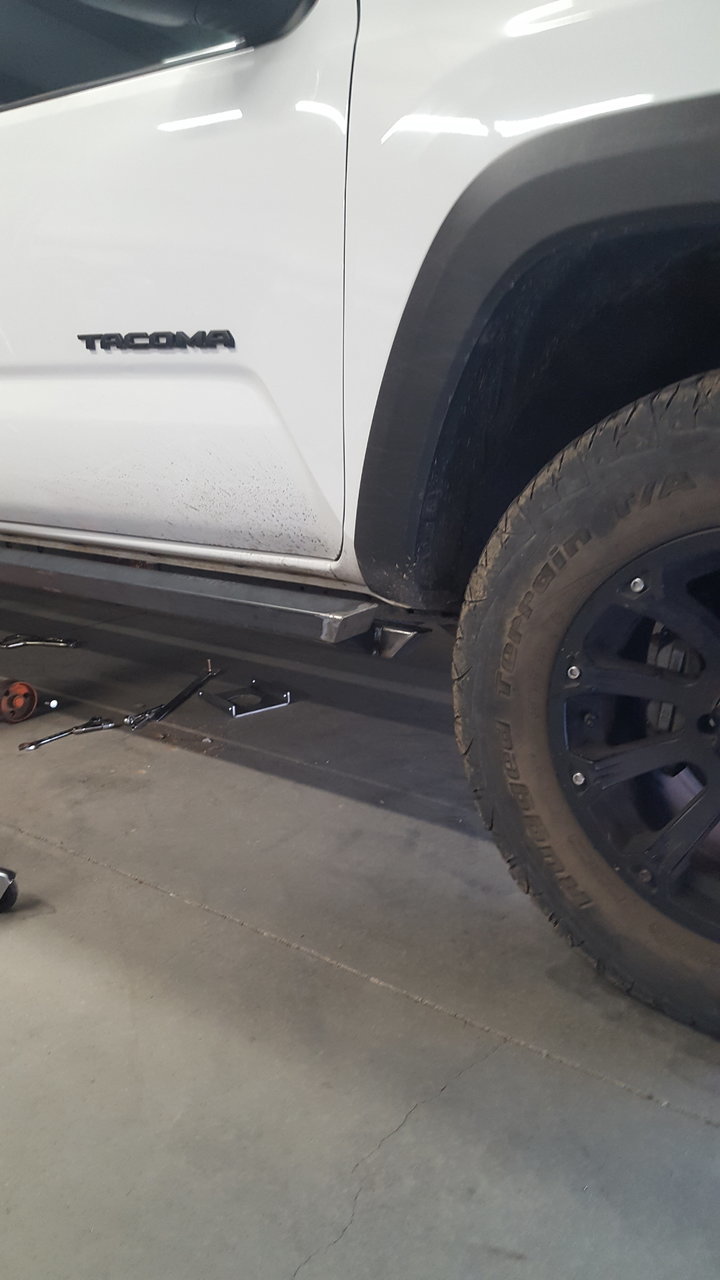

    MOBTOWN Bolt on plates are going to make these the BEST 20180226_082718.jpg 20180226_082729.jpg 20180226_082741.jpg 1 7/8 inch door clearance enough?

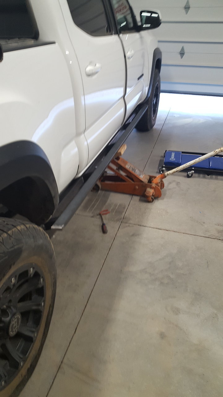

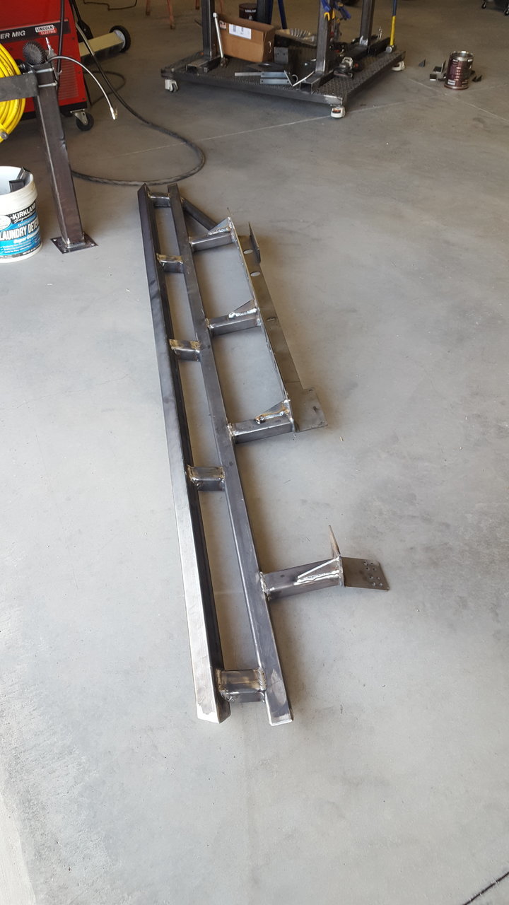

    20180226_085045.jpgthe outer tubes are mounted on diagonal but the 15 degree upward angle makes them a pretty good step? with traction tape of course.

    Any plans on reproduction on the sliders?
    tostada likes this.
  9. Feb 27, 2018 at 6:08 AM
    #269
    Darkgoatracer
    Darkgoatracer Well-Known Member
    Feb 18, 2017
    #210945
    5,610
    Nick
    Northern VA
    2012 trd sport tacoma
    Stock
    7/8 should be fine, just watch the door being open if you jack your truck up by the slider, it may flex enough to touch

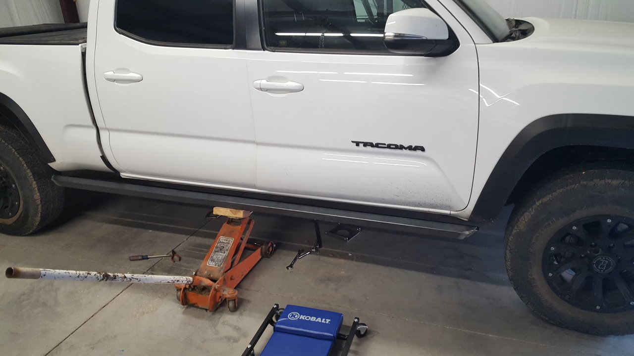

    right side welding complete20180306_120341.jpg fugly welds! never claimed to be a welder though:homer:

    that beast weighs 105 pounds!

    Those are super beefy compared to mine.

    those MOBTOWN plates are 3/16 the standoffs are 2x2x.250 the main tube is 2x2x.188 (or 3/16) depends who's talking the five short spacer tubes are 2x2x.188
    the outer tubes are 2x2x.120.
    I get T-Boned in an intersection I think I'll be fine.

    Swing out tailgate finally coming together

    Still plan on using the tailgate as a cover?

    In the long run yes, right now that guna have to wait.
    Installing today, post some pics later
