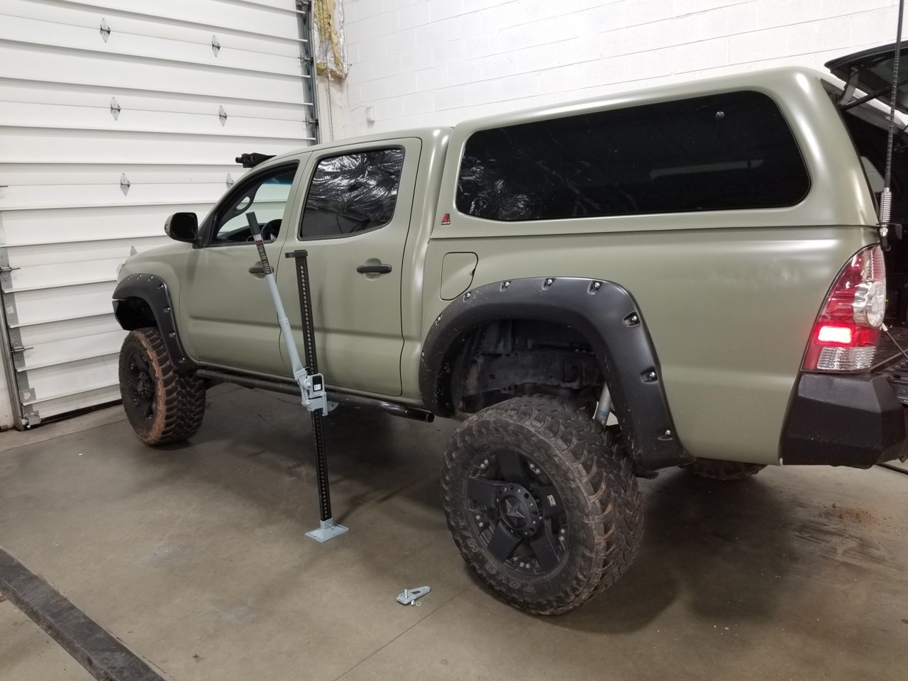

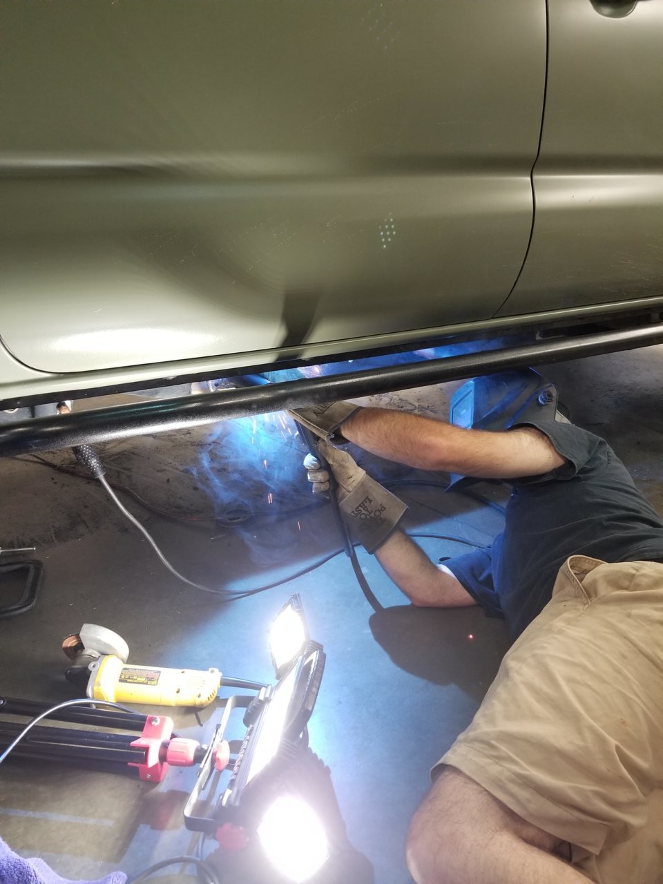

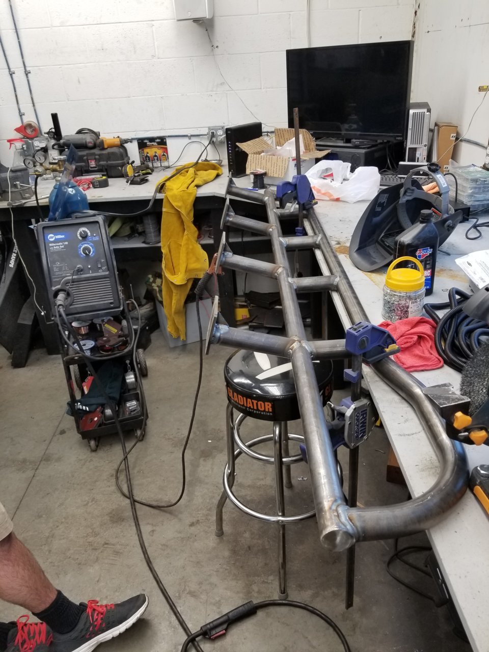

    1.25” school 40 is 1.66 od. And has a wall thickness of .140. My racks, sliders and my bumper are built with it. I know of one set of sliders that have been hit by other cars and no issues at all. I’ll be making a tube bed later and that’s what it will be made of.

    Currently just a $70 Harbor freight kinkomatic, I've got access to a couple fancy benders with all the parts and peices that my hillbilly ass probably can't pronounce. I figure some day I'll upgrade, for now it does all right.

    2in .120 dom is what I have the most experience with, i helped my boss put a cage in his 85 runner. I ended up with over a hundred feet of that tubing. And proceeded to build bumper and sliders for my 84 yota, after one winter of sliding in the snow/mud into trees and ditches and a hitting a couple deer on the highway, there much straight tubing left, so I put a sawzall to it wacked it all off and bought a bunch of Lowe's schedule 40. Now and in future if it's not safety related/roll cage it's probably gonna be made out of schedule 40.

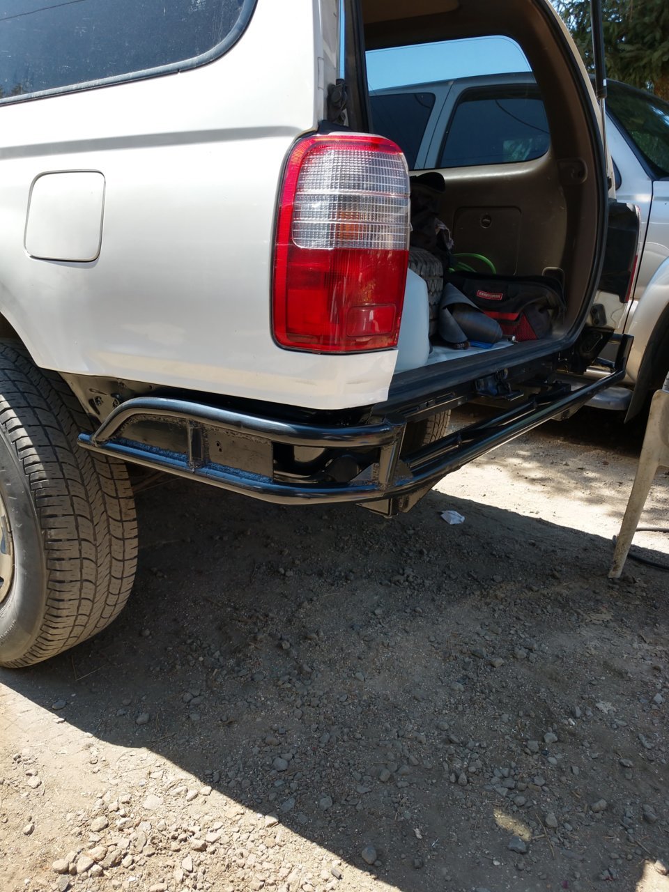

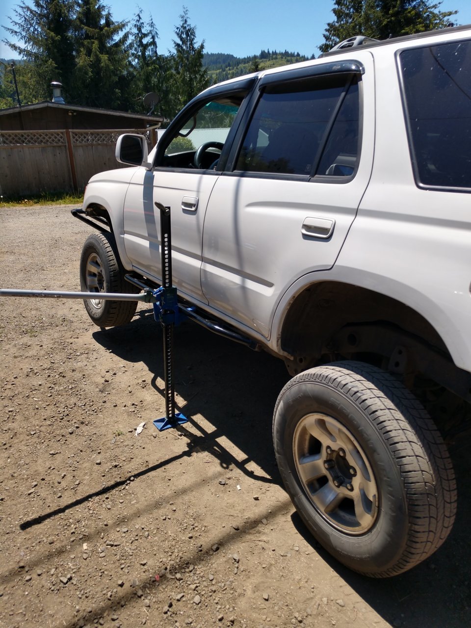

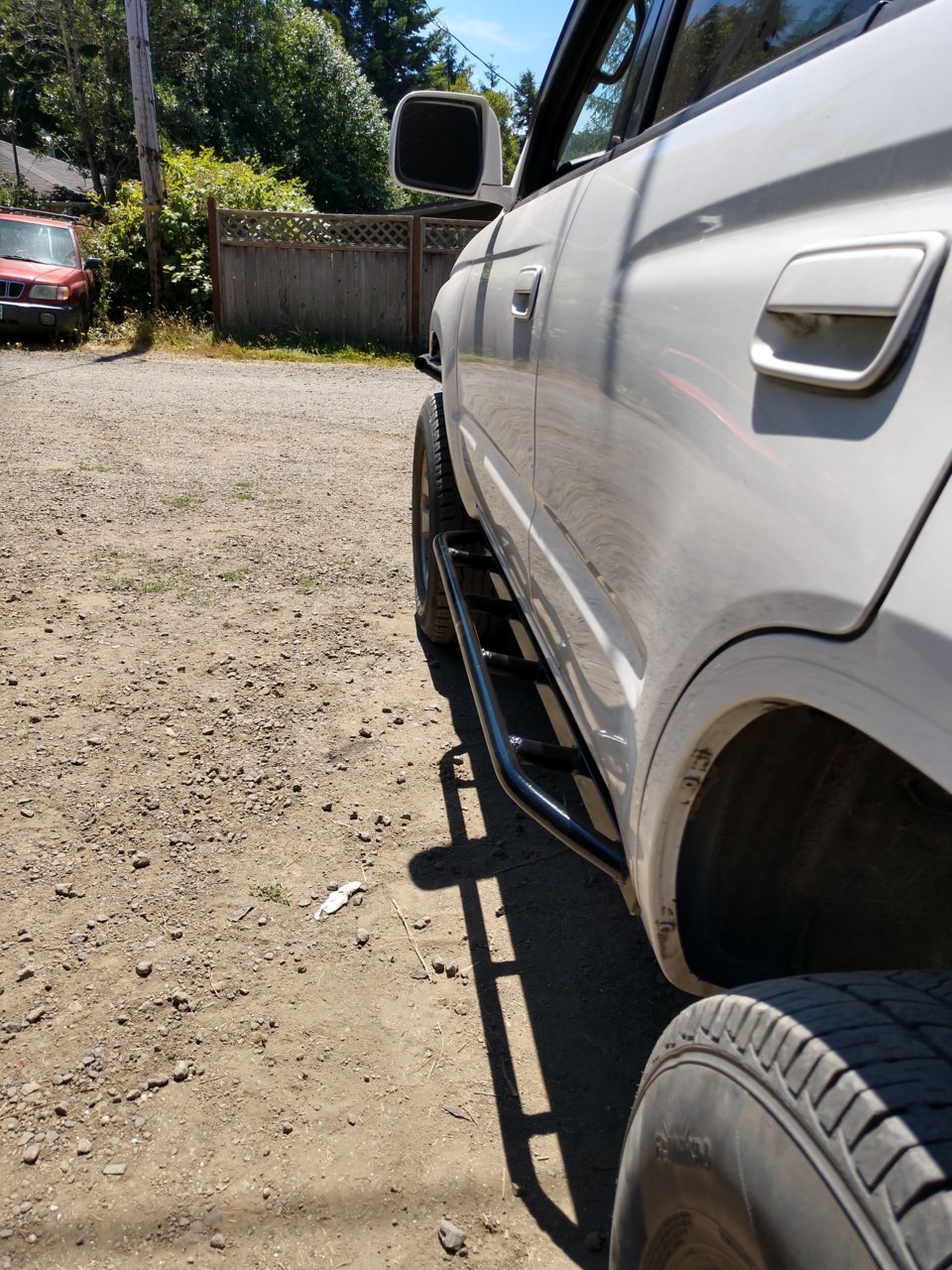

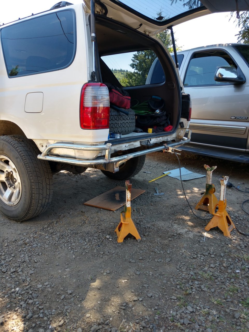

    Finished the my runners rear bumper and built some sliders, all in all I think it turned out not bad for some back yard junk. They'll hold the runner up just fine.

    This makes me want to get a harbor freight bender...

    The kinkomatics really aren't that bad for the $70ish that the 12tons run in my area. Just go slow, tubing/pipe that's at least .120 wall thickness works pretty good. The newer ones have a sticker that says use schedule 40 or 80.

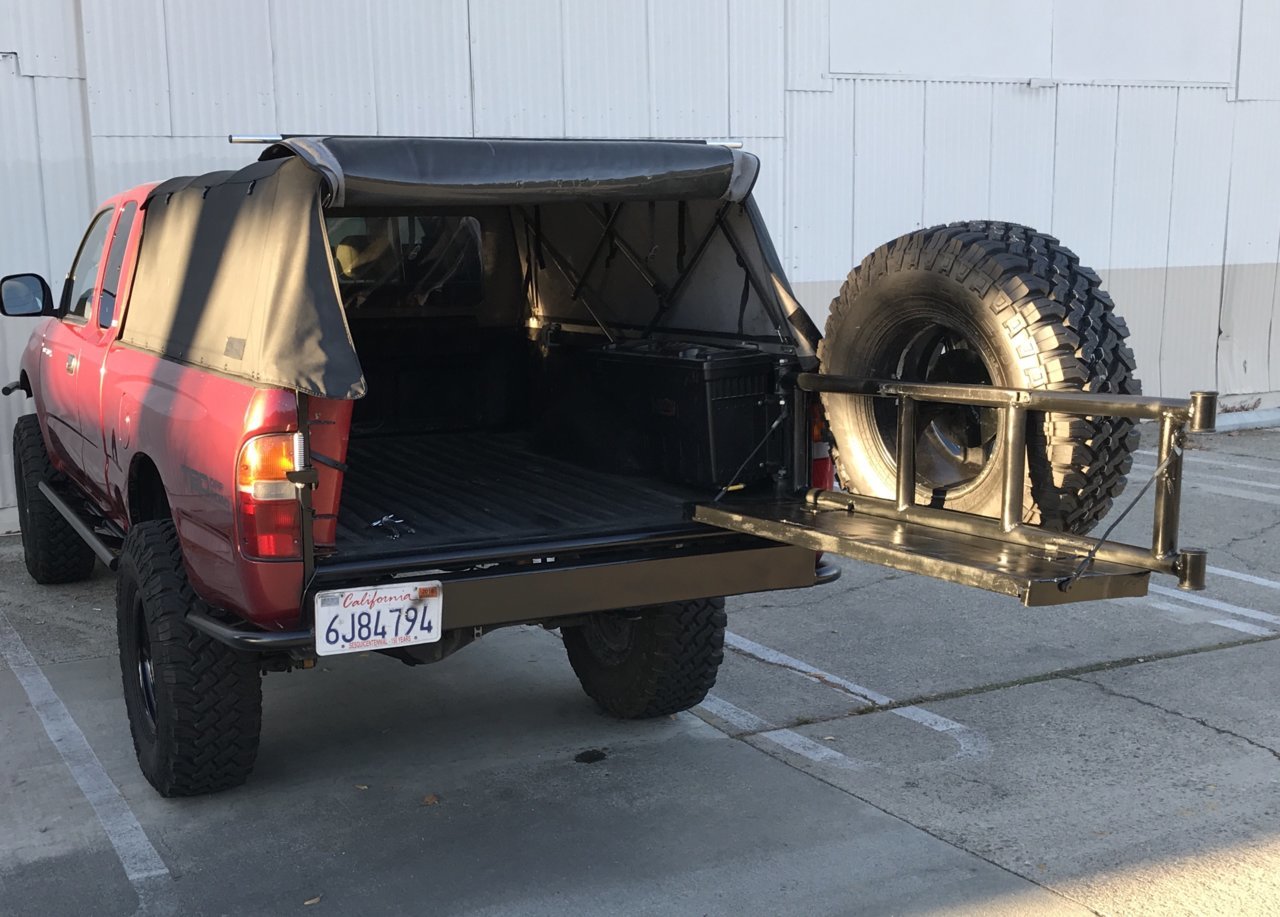

    Thanks, just used the oem tail gate cables and attachments
  13. Jul 16, 2018 at 7:58 PM
    #373
    Fuergrissa
    Fuergrissa If you build it, trails will come.
    Jan 9, 2013
    #94858
    2,119
    Devin
    San Jose
    2000 T4R Limited
    E574735B-8B45-420B-B4A9-9743E0C55BAE.jpg Also repositioned the tire carrier. Moved it as close as I could to the swing out and gave it a little tilt forward
