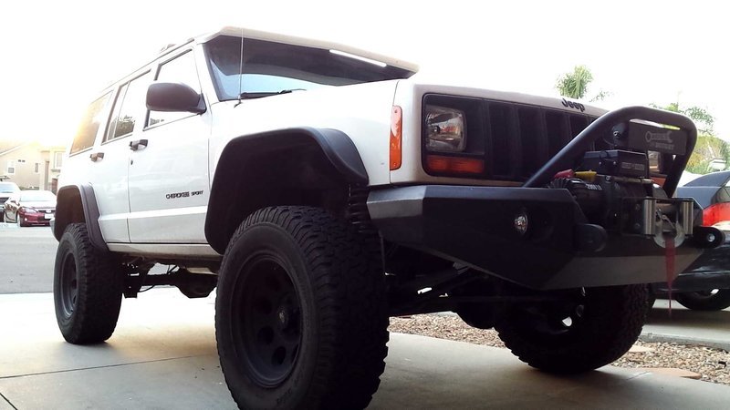

    took me 30 seconds to figure it out. Used a hole saw at went in straight relative to the front of the bumper., similar to how you would notch tube at an angle. I knew the angle the bumper was swept at so i set the band saw to that and cut the tube so it sat flush in the hole, welded and polished it down to make it seamless. for light mounting I just welded on a pre-fab tab i found laying around in the garage that worked perfectly.

    Hard to see from this angle but I was quite proud to declare it.
    and yes, I made the cover too.

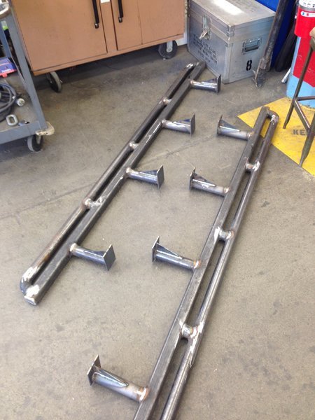

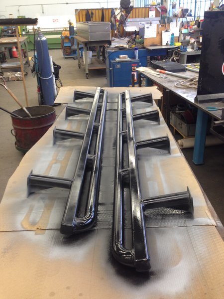

    This armor is so nice. Is it available to have built or one-off?

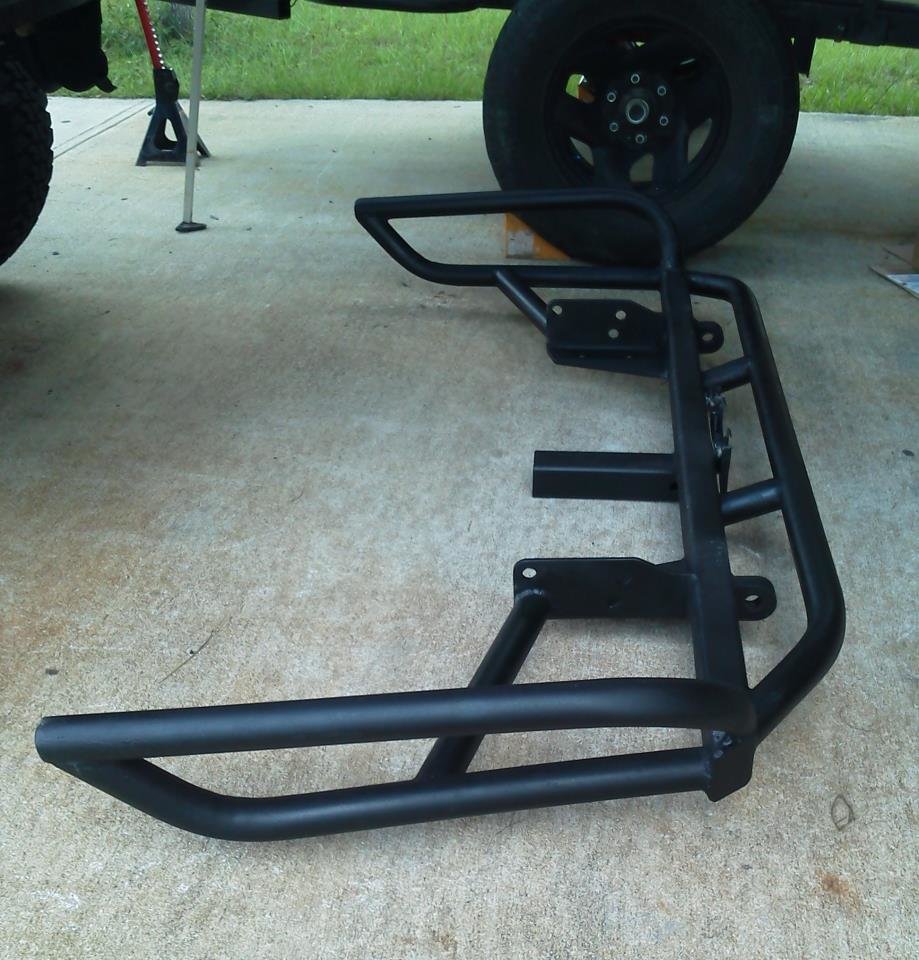

    High clearance tube rear, built in 2012
    this was prior to bracing the hitch receiver
    Great high lift jacking point when you break shit on the trail.

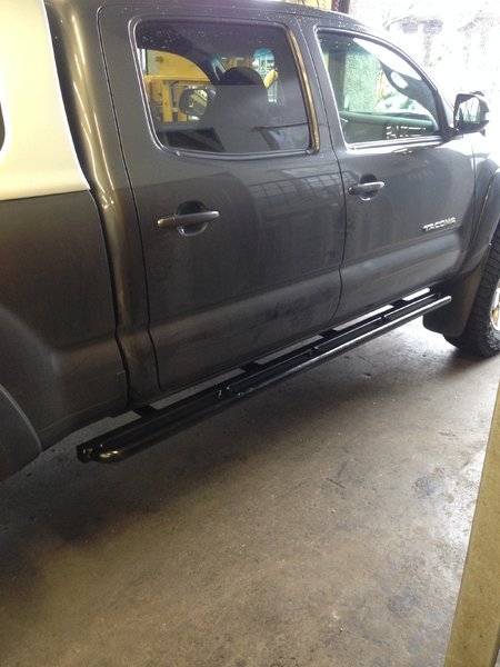

    What year model is the truck in the pictures I have a 2015 that looks almost exactly the same color?

    Got measurements?

    Those sliders are very nice. What type of welding are you guys doing? I can weld with a stick ok but have never learned much past very basic and crude applications. Nothing like yall.

    These were done with mig (hard wire with shielding gas). I am an Ironworker by trade so in my "spare" time at work I screw around with truck stuff.
