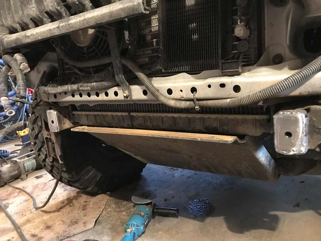

    If you can add some plate cleanly that would be good. Or make some sort of cover with thin UHMW. Could also just paint in there with colour matched paint to it all matches and doesn’t stick out like a sore thumb.
  7. Nov 9, 2018 at 8:05 PM
    #427
    Spoonman
    Spoonman Granite Guru
    Sep 11, 2011
    #63328
    9,810
    Jamie
    Alberta
    I think it could look really clean especially if you added a little bit of plate elsewhere on the bumper too. Make sure you leave a solid gap so it doesn’t smash your tail light or body

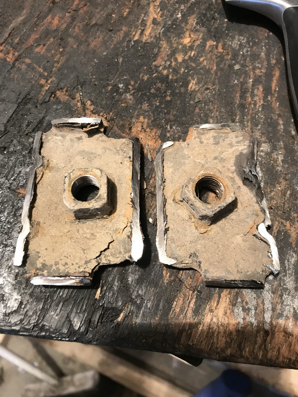

    I think this is a must for 1st gens that have a winchbumper. I just about pulled the bumper off the frame winching because these weak plates started to come out. Bent the bumper down significantly. Should be much more solid now with 1/4” plate in there, welded all the way around.

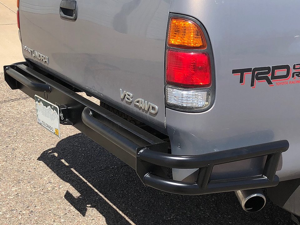

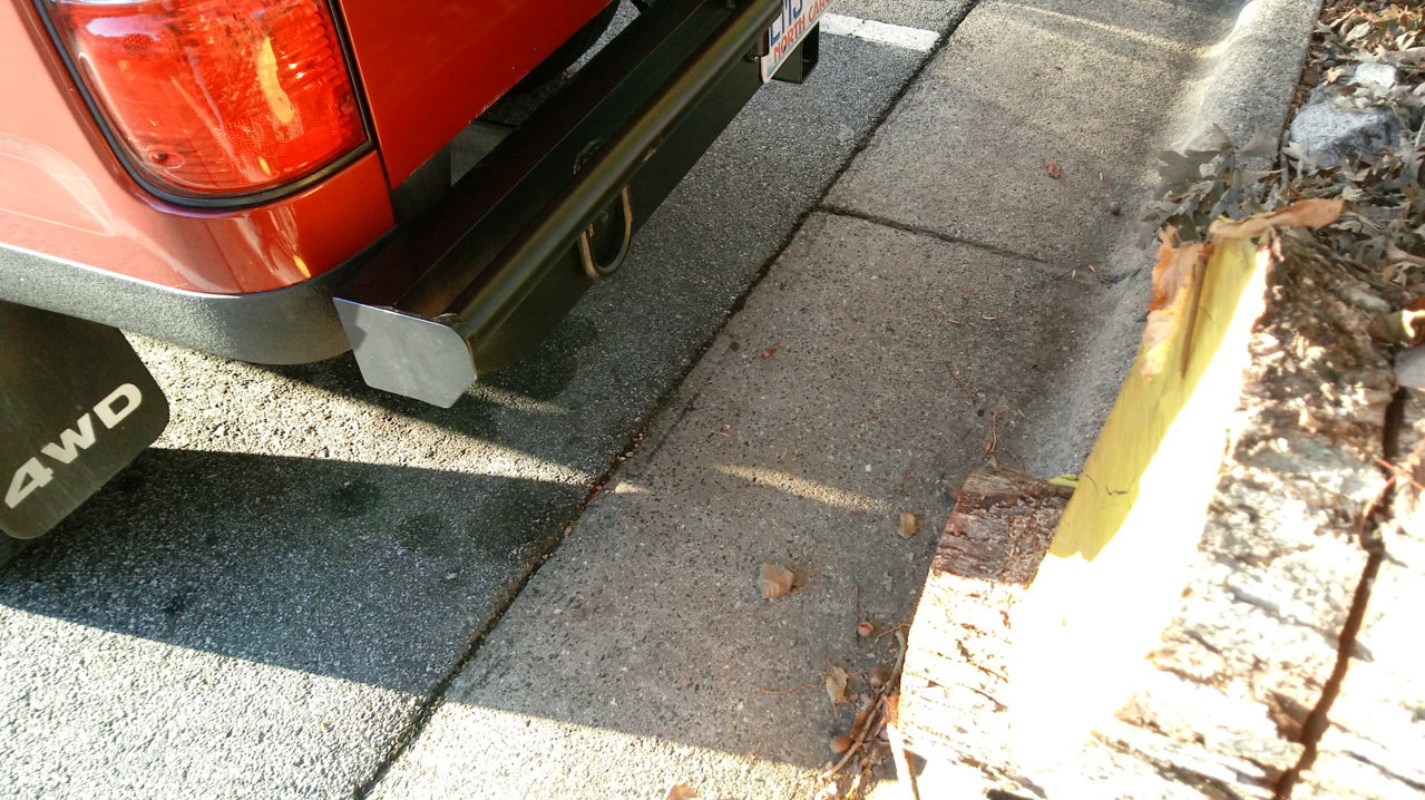

    Yeah, I like the high and tight look. As for a collision, its hard to say. Most cars would go under it, most suvs and trucks would see a lot of damage lol. The way I see it, if I get rear ended to the point where I'm questioning whether or not the truck is totaled, the stock bumper versus my creation wouldnt make a difference. I did back into a tree the other day and the step tube took it like a champ, barely even bent. It was a hard hit too. 1030180835.jpg
    I got the idea for it from Addicted offroads Tundra bumper, I wanted to have the ability to add the wrap around tubes should I ever want to in the future, and I like a high clearance bumper that still retains a step and hitch receiver. 00-06TundraRear_002.jpg
    I didnt like the license plate mount they used so I opted to mount the receiver under the bumper and have the plate be flush on the channel.

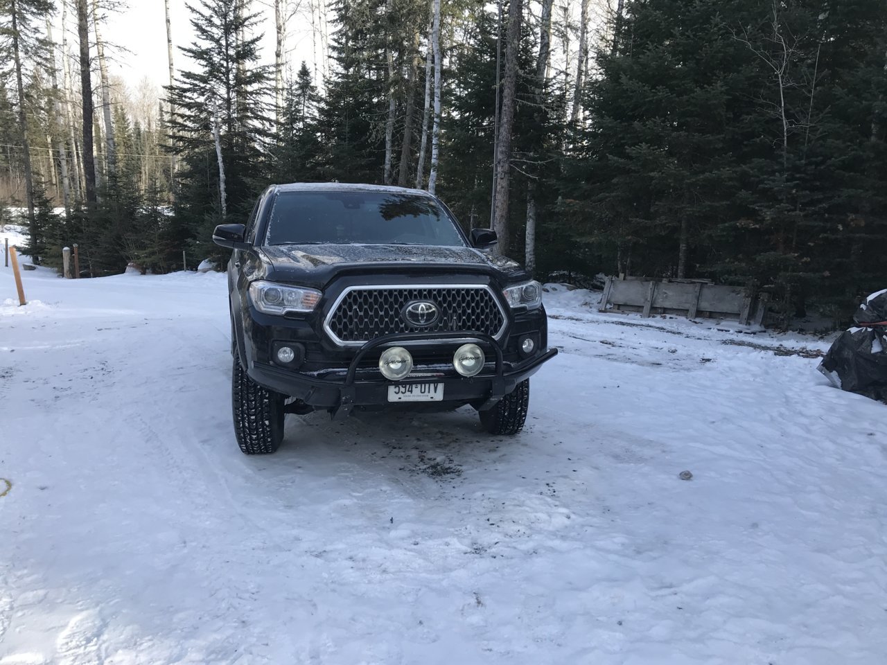

    ‘18 access cab manual

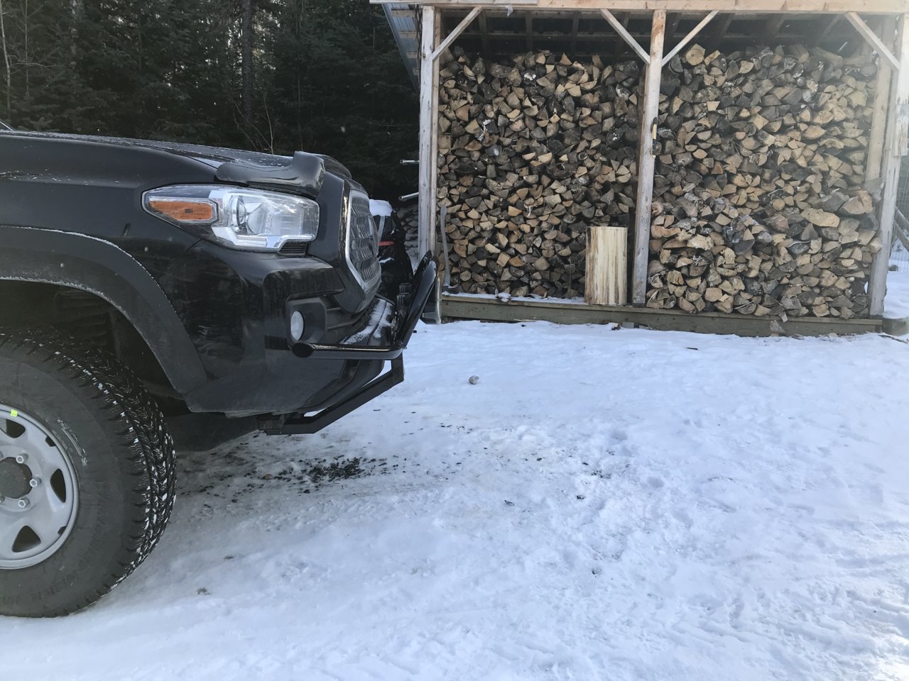

    0D79C4CC-E49A-4C8C-9B78-EDA0FB024BA9.jpg 48AA2B69-6830-41A9-896A-8E2BAD0909EC.jpg Finally got this pretend armour done. Just wanted a way to mount the lights, nothing I saw on the market would fit these rounds.
    The Radar/crash sensor still work.
    Slashaar and Darkgoatracer like this.
