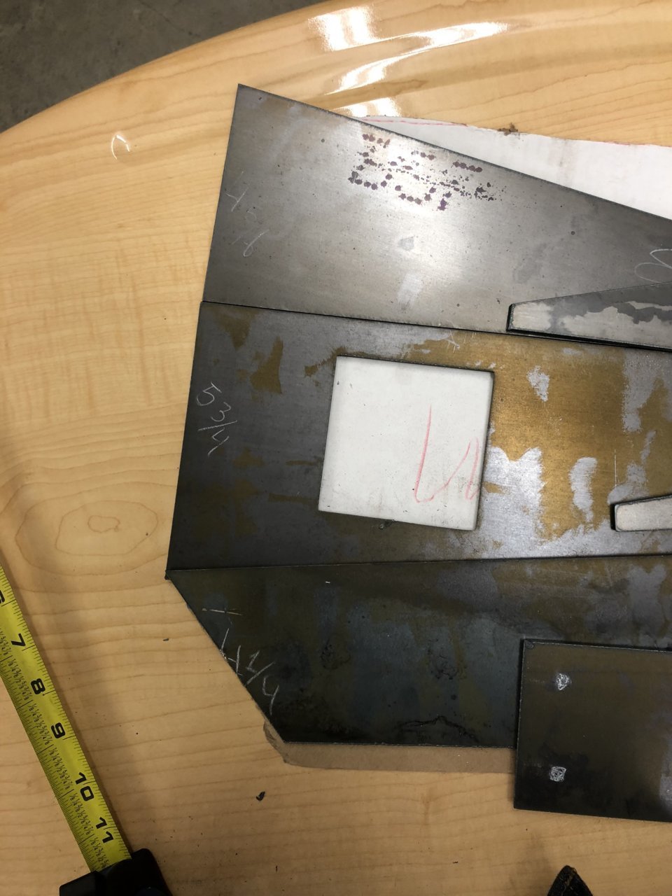

    Getting ready to do a DIY rear high clear bumper and swing out. Question for all the DIY armor makers in here. What thickness steel is recommended for making the bumper mounting brackets that bolt to the frame? I'm thinking 1/4... But I was recently at the BAMF - Pelfry aftermath liquidation extravaganza and it appeared Pelfry was using 1/2 (Damn, that's thick and a pain in the ass to work with)

    That's a lot of weight on there so the thicker the better.

    Ya, I get that. But Class IV receiver hitches don't even use half inch. And the frame rails themselves are only (what) 3/16th?

    1/2 maybe on the frame mounts to shackle location the rest is normally 3/16

    I'd that. Most of the frame is fairly thin.
    Depending on application I'd use 3/16 or 1/4 for frame to bumper connections. Adding bends or boxing makes 3/16ths more than enough. You have to think about twisting and shearing loads (think about winching at a 45 degree angle, up or down hill).

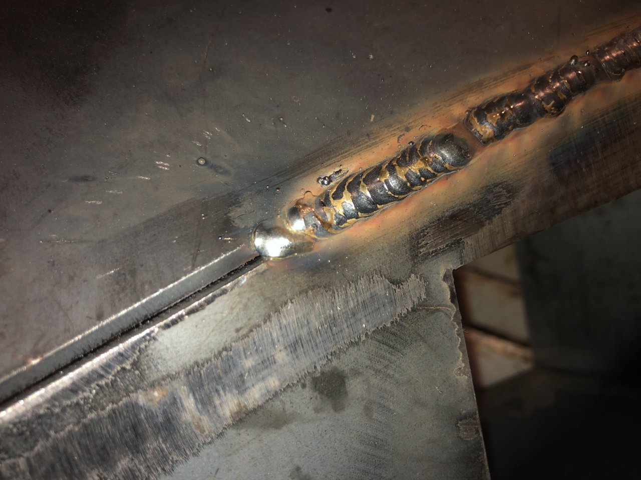

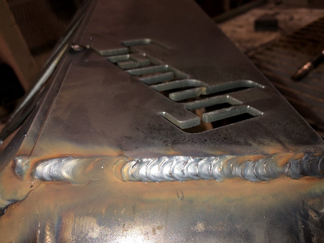

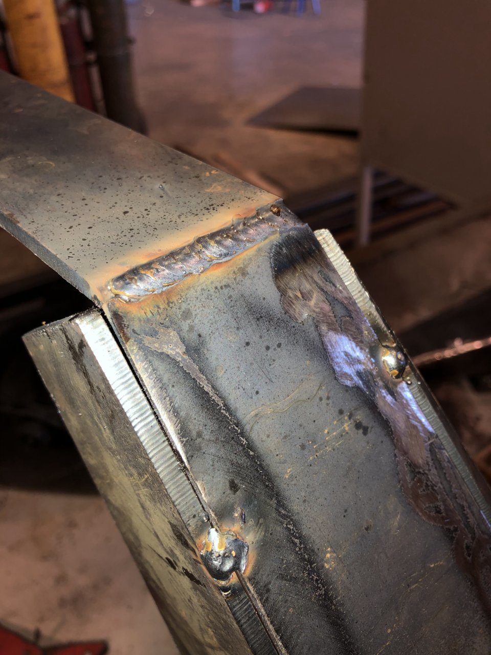

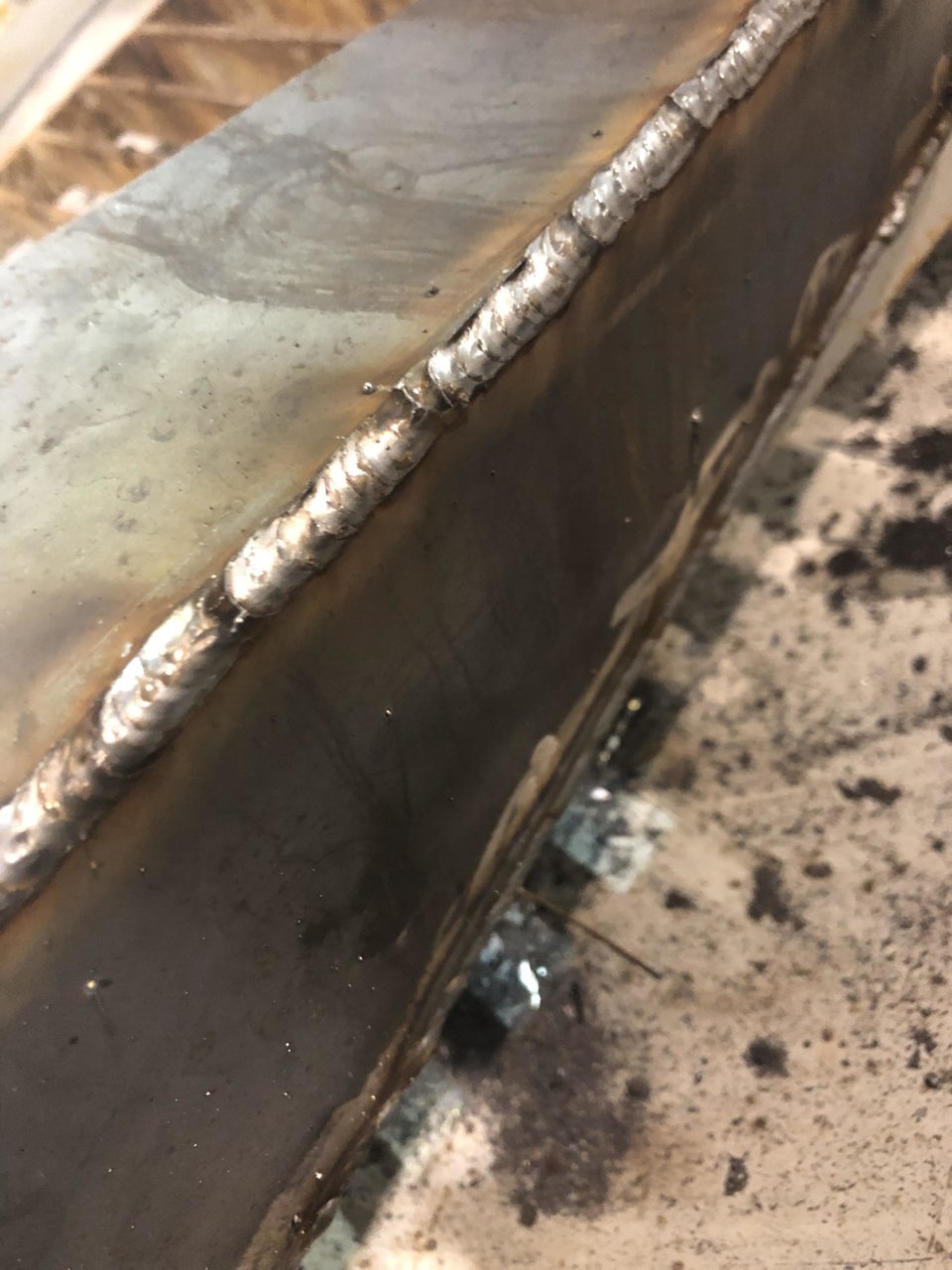

    Sorry For the upcoming spam of photos... here is a short recap of my bumper. I've got 200+ hrs into her, enjoy.

    i used 1/4 angle iron for the frame mount

    Well, started the rear high clearance bumper with swing out. Ended up using 3"x1/2" for the frame brackets. It was just easier to do, and make for stout shackle mounts.
