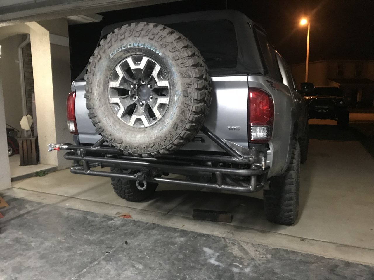

    Anyone on here with a tube bumper and swing out? Trying to get some ideas of what would look good.

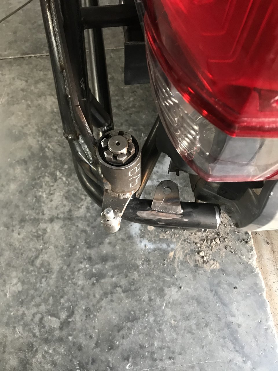

    1997 t4r has super duty axles, 5.13s locked front and rear. 3 link front with 14" kings. Rear 63s.

    How did you make your hinge?

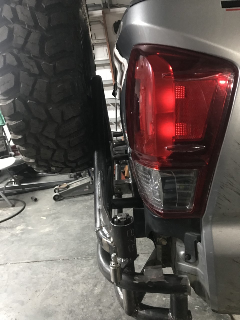

    Been waiting for someone to make a tube bumper w/ swing out! Could you possibly provide some pictures of the hinge/mounting? I want to do something similar but was unsure how much flex I would have with a full size tire.
    Hope these help

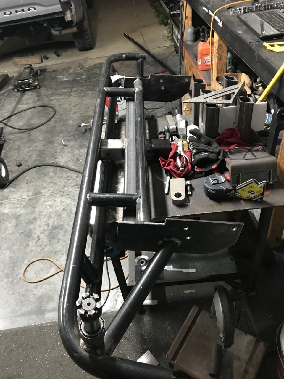

    Used ruffstuff spindle and latch notched our the side and tied it between the two. Also add a brace to the mounting point to help with flex
