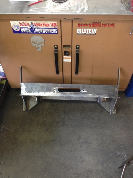

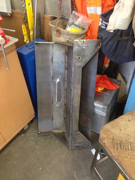

    We have a ton of cool tools at my work. I'm currently drawing parts for my bumpers that I will cutout on the plasma table.

    IMG_0177.jpg IMG_0176.jpg Bumper progress shots.

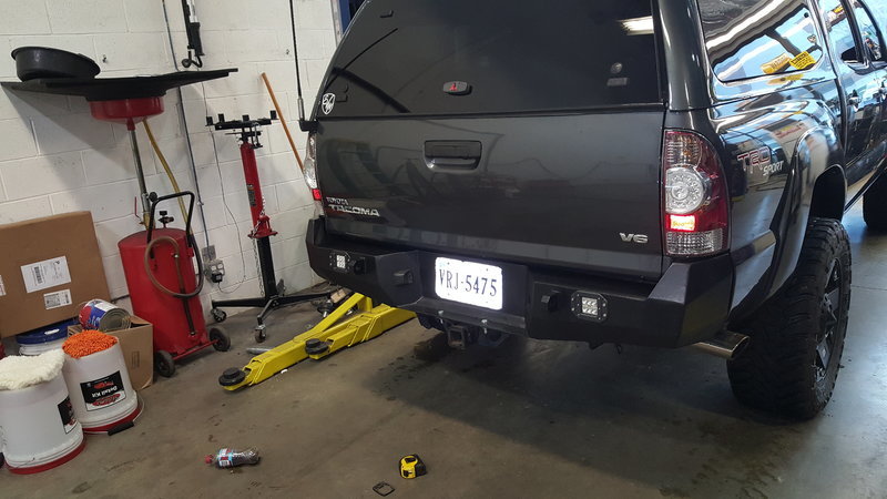

    I have a cad of the front that should be relatively close....nothing for the rear. You want it?

    Here's what i have. I took these measurements after i built the bumper...so some of the measurements may be iffy. This should be a good start for a DIY project though.

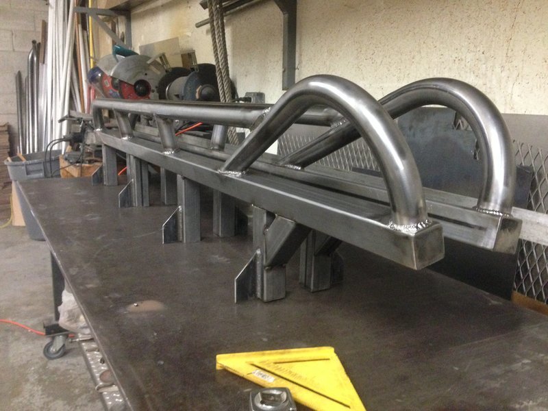

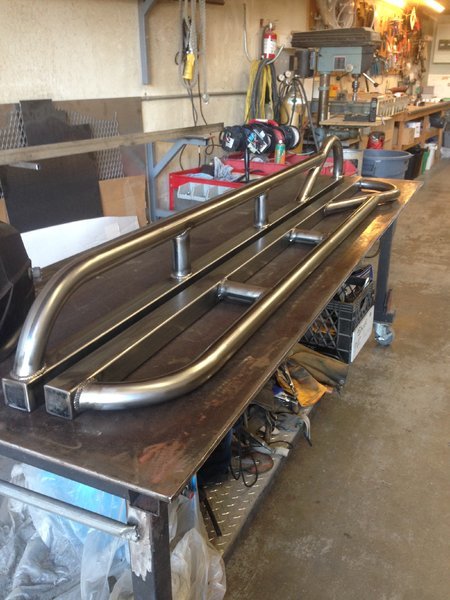

    Almost done with my sliders. Ran out of gas for the welder, I should finish up tomorrow then off to powder coater. I loved Relentless design but couldn't wait the 14 week lead time, especially after smashing the passenger side rocker panel couple weeks ago so I decided to make them myself, very happy with the results so far. I will post final photos after mounted.

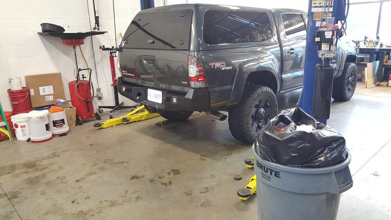

    You did a great job on the rear bumper, that will be my next step.

    I can grab some measurements and make a cad like the front if you want.

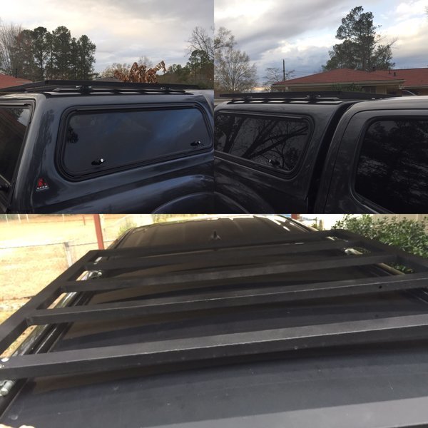

    How's you mount the rails to the cap? Looks good! Is it heavy?
  18. May 5, 2017 at 10:09 AM
    #58
    Thelgord
    Thelgord [OP] The Pantagonist
    Dec 29, 2012
    #94014
    1,165
    Augusta, GA
    '13 TRD (OffRoad, 4x4)
    SOS Rocksliders, All Pro skid plate, Procomp add-a-leaf, Bilstein 5100 @ 1.75", CB, high-lift jack
    Thanks!
  19. May 5, 2017 at 10:13 AM
    #59
    Thelgord
    Dec 29, 2012
    #94014
    1,165
    Augusta, GA
    It's actually very light, comparatively speaking. Around 25 pounds I think. I had some very large "farm gate" hinges laying around that were left over project I did in Colorado, I actually built a fence for a farmer. I cut down the mounting plates and drilled new holes for the "Thule" branded track hardware to pass through. Since the tracks aren't level, they are cantered outwards, I needed a way to makes sure the bolts were strait, but the rack was flat. The hinges solved a lot of problems very quickly, and so far have held up to abuse.

    That would be great if you could do that for me. Did you ever end weighing lbs your rear bumper ?
