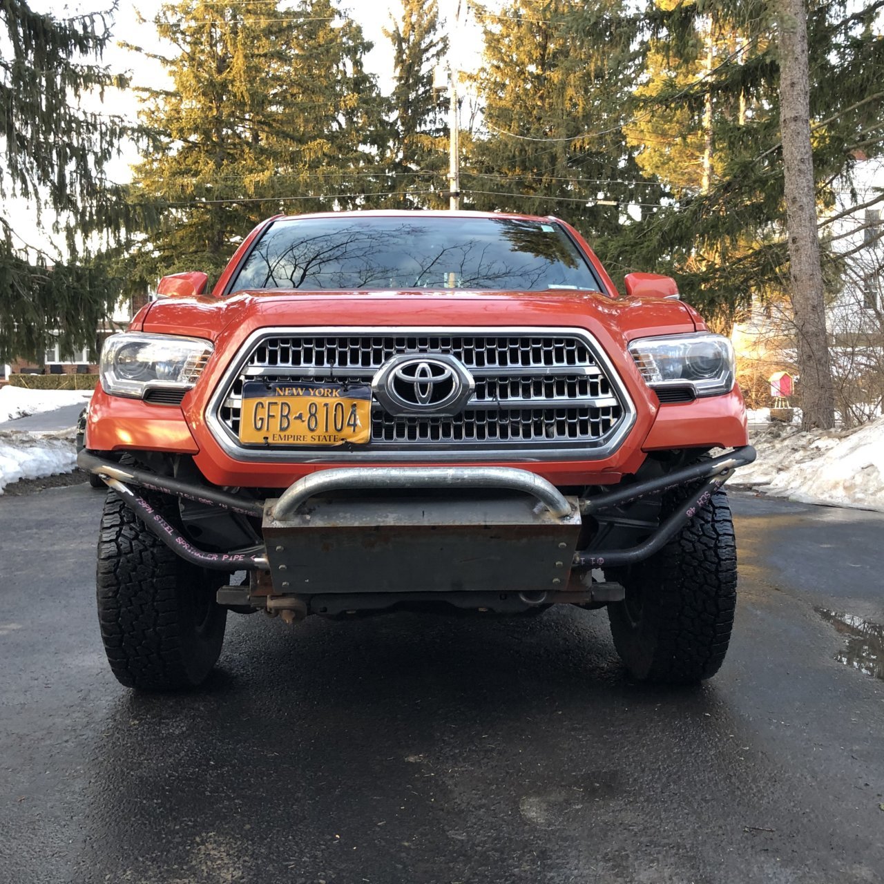

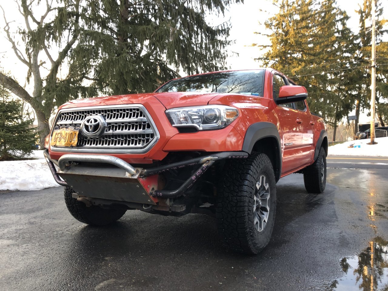

    Progress, learning to use the pipe bender. Can’t wait for the weather to warm up that’s really holding me back.6E3415FD-31DF-4FD6-907B-6284958E536E.jpg7297C3A6-DA46-4E34-83DC-E08CD143422C.jpg

    Can I weld this tubing while it’s connected to the truck? I honestly don’t know how I’ll get it right if I take it off. Just disconnect the negative terminal?
    Slashaar likes this.
  5. Feb 28, 2021 at 1:48 PM
    #585
    Slashaar
    Slashaar Trail Limo Supreme & Certified Hole Massager
    Nov 23, 2017
    #236717
    14,792
    Josh
    Kansas City, MO
    2015 Tacoma TRD-Sport DC LB
    Coastal HC Front, 6112s+650lb King Coils, JD 62 Swap + 14" Fox 2.0s
    Yep, unhook the battery and you can weld on it all day. That's how we tacked up our Coastal bumpers.

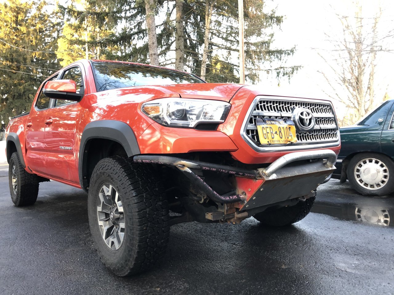

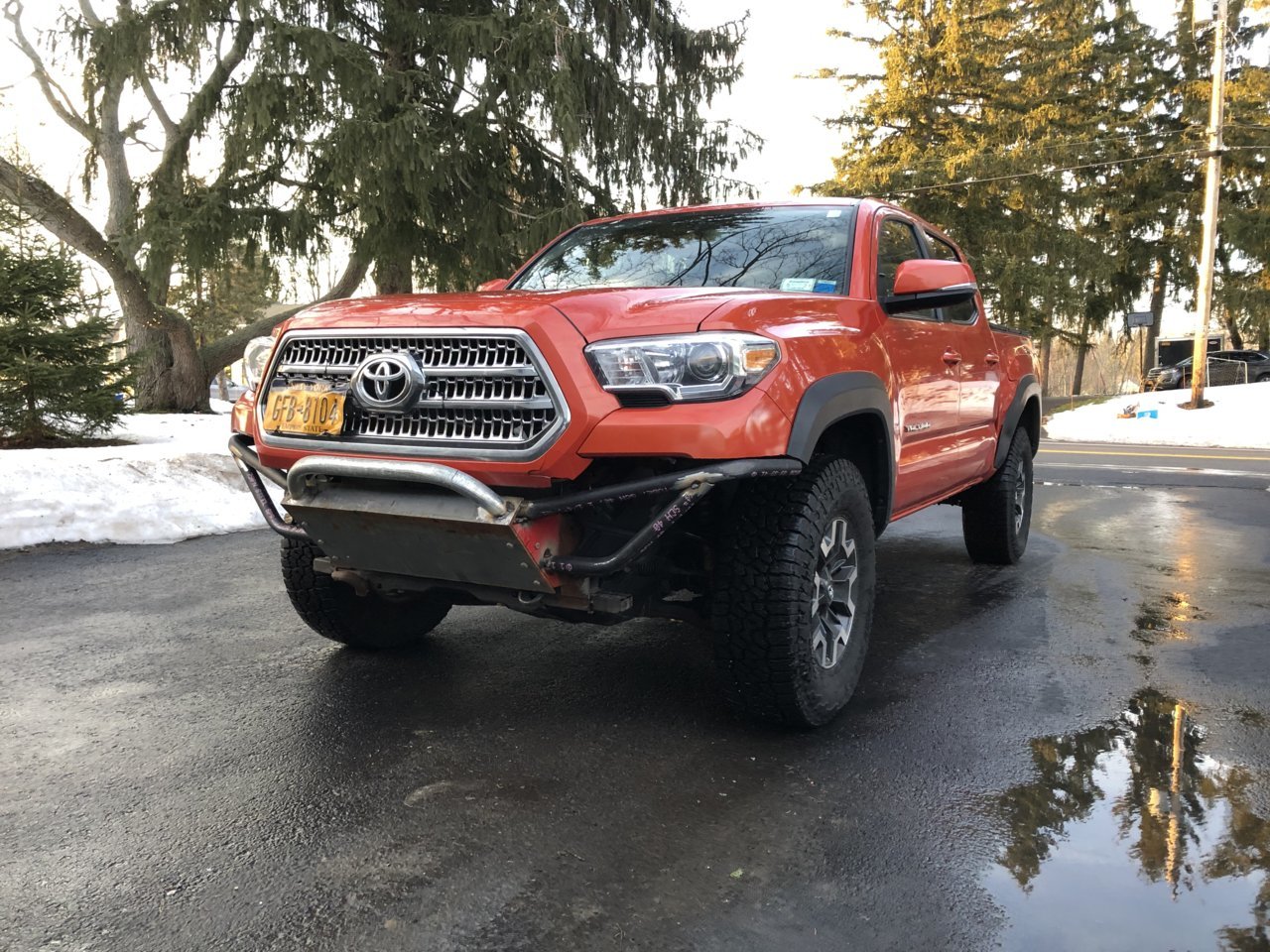

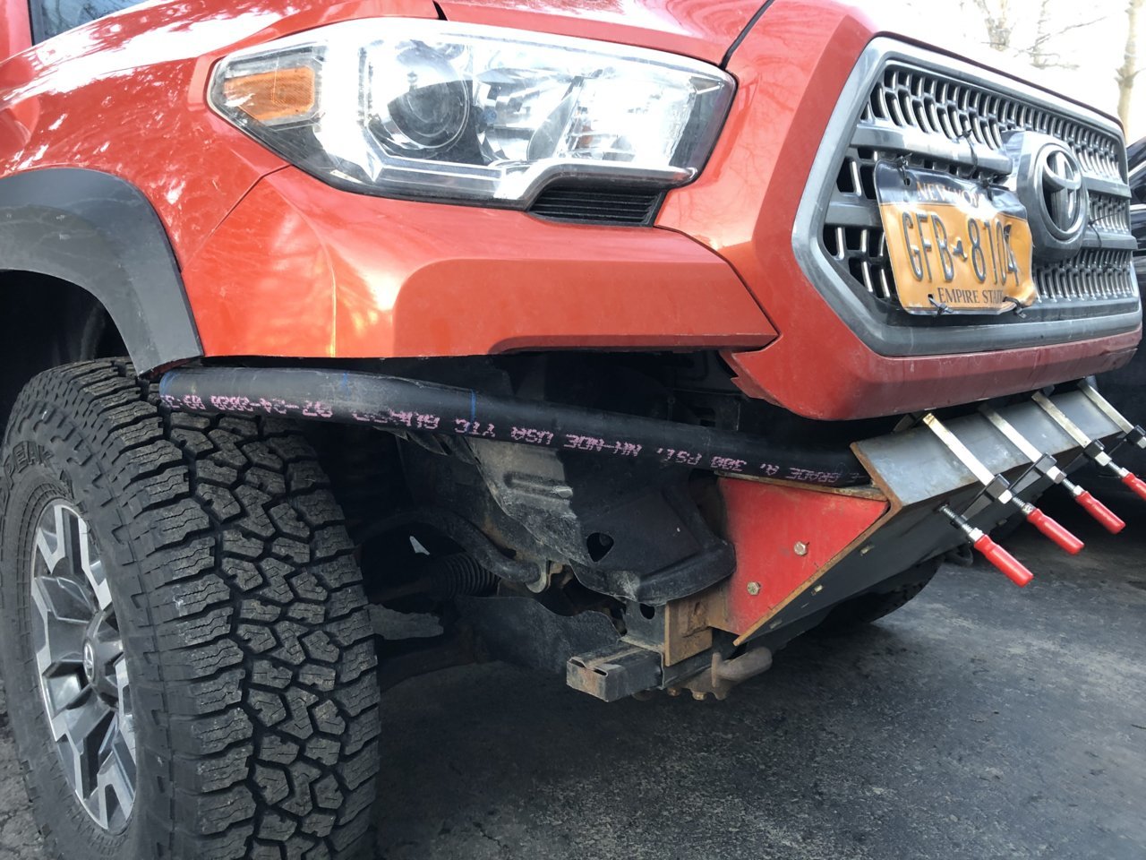

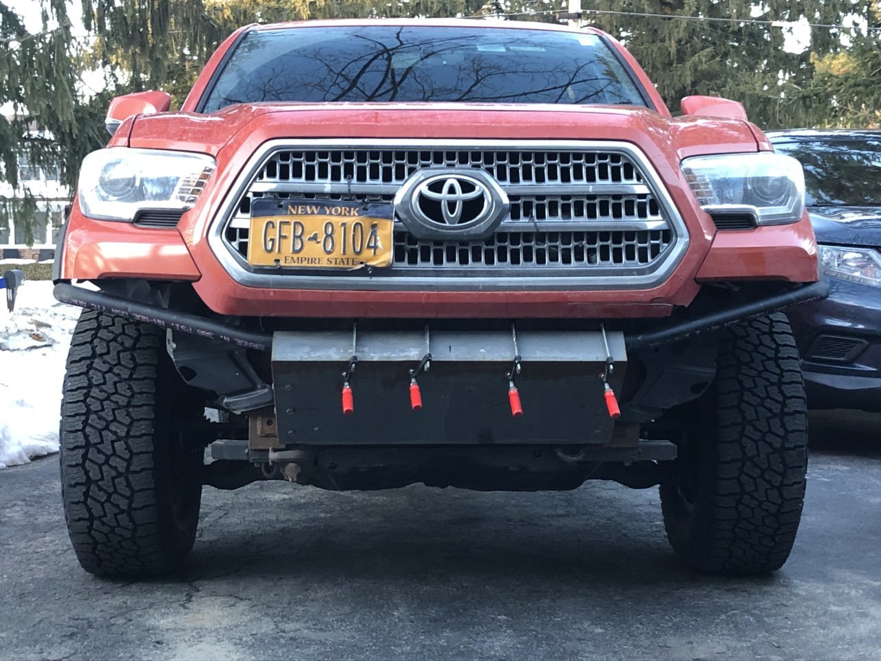

    BF5323A8-7B3B-41A5-9F49-465C76A865AB.jpg I’m all about function over form, but I’m not in love with this yet. Is there anything I should do different before I go to town welding this together? Should I add any more support tubes? FF3BDF87-08E4-4D5A-A815-ED7B3CDAF367.jpg6A35997A-27FF-4E9B-902C-80E5B50E274F.jpg

    Winch mount???
  9. Feb 28, 2021 at 3:37 PM
    #589
    William H. Bonney
    William H. Bonney Well-Known Member
    Aug 30, 2019
    #303767
    234
    2016 TRDOR
    I’m torn between putting a winch in there or just getting a mount and I can take it out, I don’t even think there’s room to mount a winch though, I kept that thing as tight to the frame as I could. I have no way of checking
  10. Feb 28, 2021 at 3:41 PM
    #590
    ovrlndkull
    ovrlndkull STUKASFK - HC4LIFE
    Jan 7, 2017
    #206806
    37,794
    Skip
    Burlington, NC
    2005 DCLB Silver
    63s, XD Machete, Beat not Babied
    You can get the measurements for a winch off the websites and just build a cardboard box of sorts to represent one. It is really tight and probably won't fit one. The only issue with having a removeable one is some circumstances putting that in would not work.
  11. Feb 28, 2021 at 3:45 PM
    #591
    William H. Bonney
    Aug 30, 2019
    #303767
    234
    2016 TRDOR
    this is true, I like the option of being able to put it in the rear hitch as well
