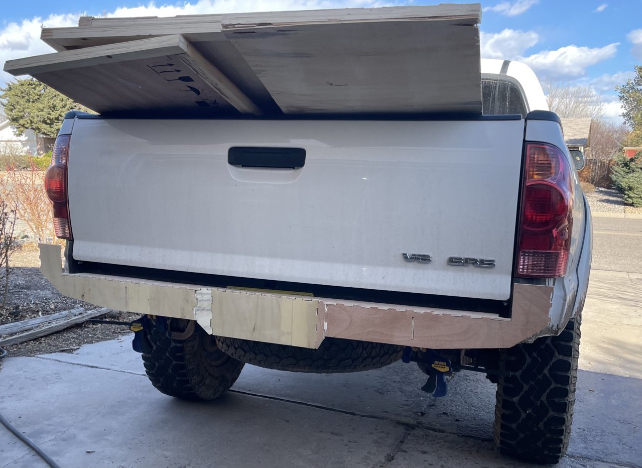

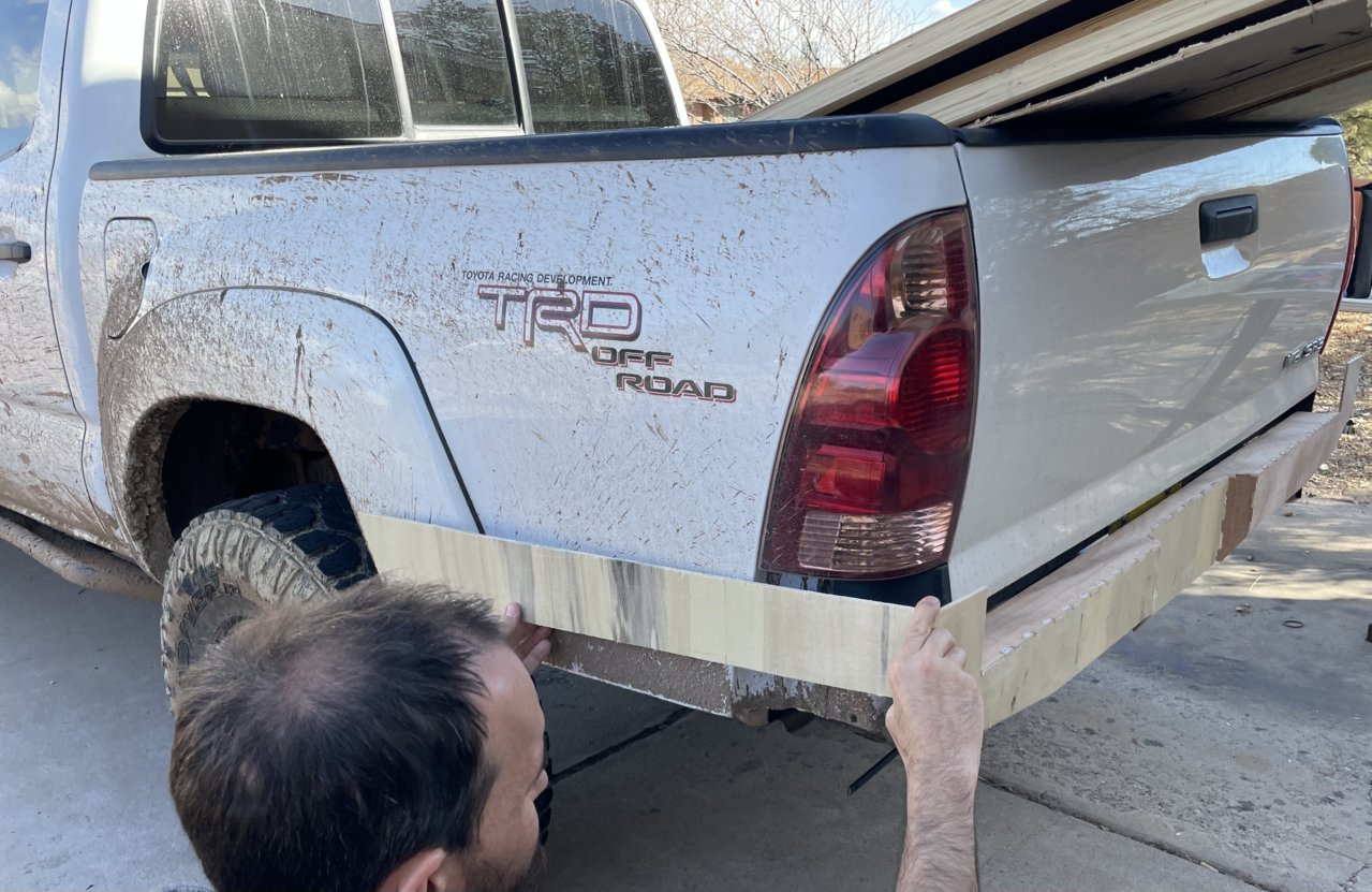

    We CNC routed some pieces of the bumper in plywood yesterday, still 70% of the pieces missing here but all the crucial components fit.
    Next step is to CNC some steel and start welding:bananadance:

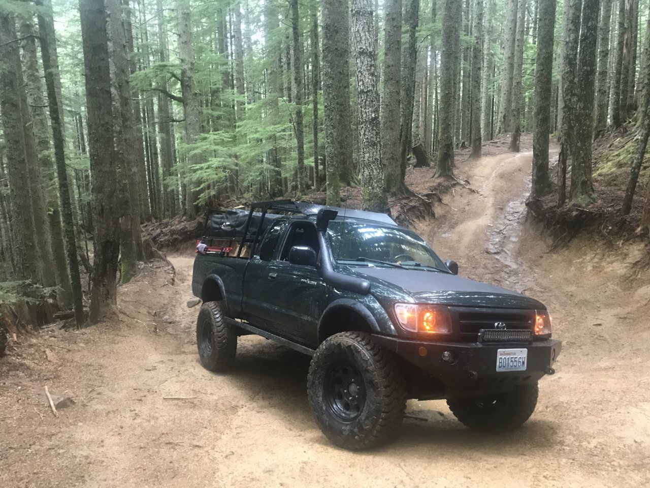

    Fox 2.5 DSC resi CO's w/ 700lb King Coils, Camburg uca's, T-100 rear leafs, 13WL Tundra brakes, 1" 4crawler body lift, 295/75/16 Hankook MT, Ruff Stuff u bolt flip, 10" Fox LSC resi shocks turned back on custom mounts, home built rear high clearance bumper with dual swing outs, Diode Dynamics SSC2 Pro rear floods, Skid Row front and transfer case skid, home built transmission skid, Mercerfab sliders, home built front bumper, Badlands Apex 12k winch with synth line, 4.56's, ARB rear locker, home built rack with CVT Mt. Shasta, eBay snorkel, Sierra LEDs 20" dual amber/white light bar, Diode Dynamics SS3 Max amber fogs, Mini D2S projector retrofit, Blue Sea ML-ACR, dual Odyssey PC1200's, 100 watt solar panel, 20 plate heat exchanger/home built shower kit

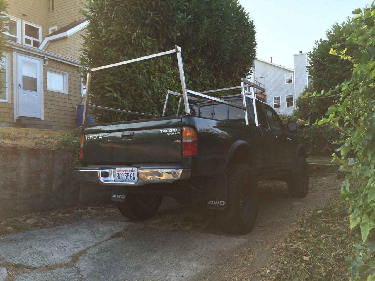

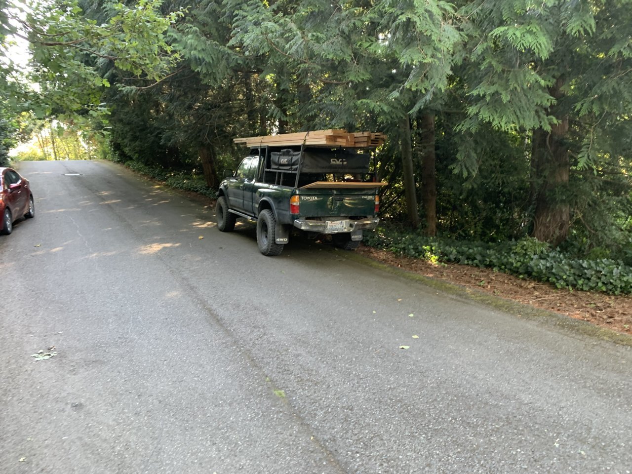

    BumperE126A7E6-EED9-463D-B755-0DB58A1E6BC2.jpg C8050B4F-3845-4043-BCC9-27286A96E9F3.jpgLumber/tent rack
    ED321E52-00EC-4FC6-BF01-C79BD735168B.jpg Doing it’s thing9A929B39-C729-41DC-BBDE-3E8E0A04DF8B.jpg think I need to build my rear bumper?
    transmission skid between Skid rRow tcase and front skid4A7E3E6A-43F8-40DE-BCC5-72AFFA7876FE.jpg26E5E339-804C-4F66-860F-422AAA828987.jpg

    that rack is genius!

    Thank you- needed to be able to carry materials and keep my tent mounted and safe at the same time- helps keep the center of gravity lower and cuts drag on the highway and less of a target on trails having the tent mounted lower

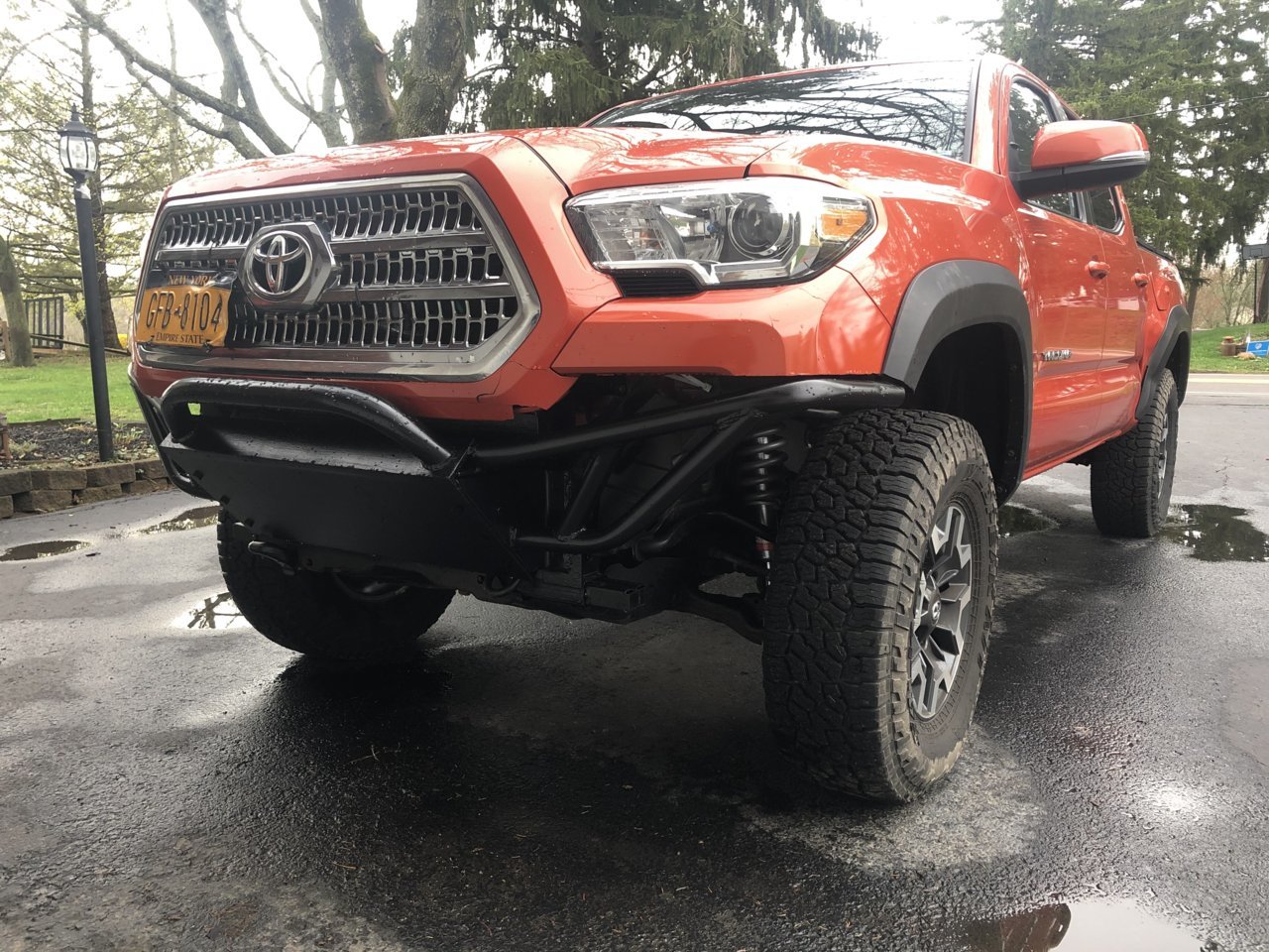

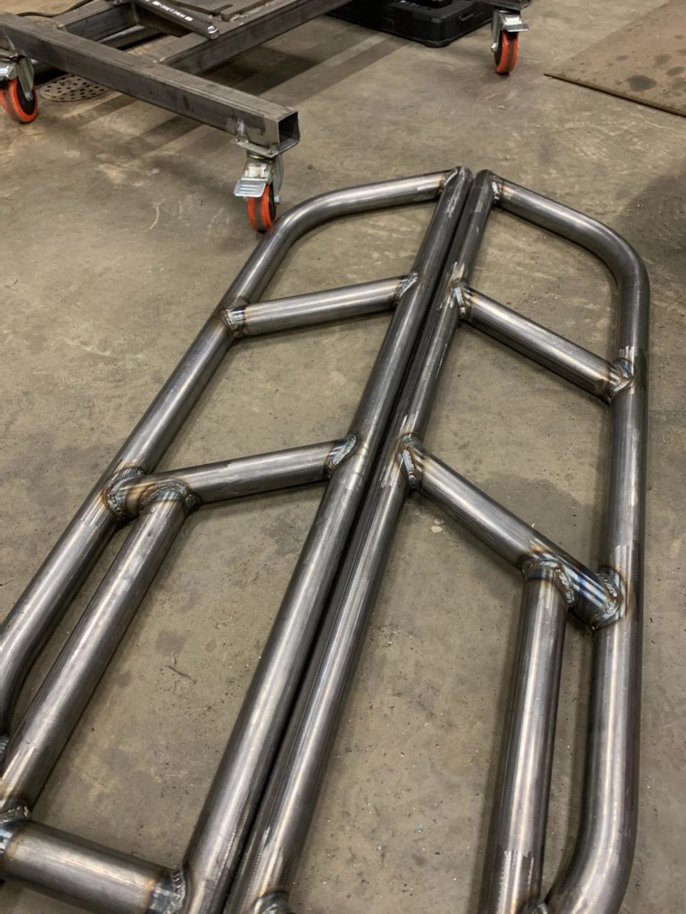

    Well she’s finally finished(I think)and installed!9A7865AF-D10C-4713-85EF-6B8A928CA278.jpg8CEFB705-537F-40D8-A14A-0F48FFA312A1.jpg

    That looks badass, nice job!

    got some good work done on the HC rear bumper, coming together nicely. more pics in the last link in my signature

    That looks awesome, did you cut all those pieces by hand?
    EDIT: Duh, nvm, I actually read the link in your bio

    What was cheaper the plywood or the steel lol
    Slashaar and Darkgoatracer like this.

    The plywood was free.99, they were throwing out a freight shipping box at work so I took the good pieces off of it

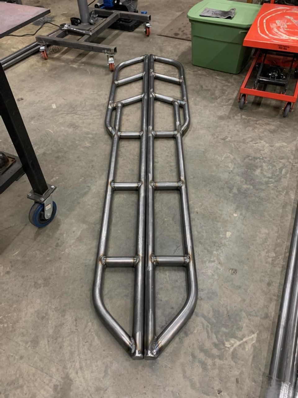

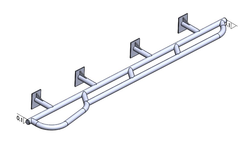

    When making rocksliders, is it good practice to drill weep holes for water drainage?
    Also with sliders, why do people make sliders with a square tube towards the middle of the truck then round towards the outside? I am thinking making them all round.

    As long as you seal the tubes water won't get in to need weep holes. You can build them all out of round tube my new ones I had built locally are

    Those are beeefy, here is the my design for my DCSB as of right now. I still need to figure out the attachment to the truck, I am not looking to weld on but I am not afraid to drill holes
